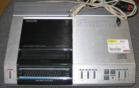

I just bought this wonderful (and working) Philips CD101 .
I plan to use it as a transport and plug it to a DAC via the I2S output.
My question is :
What do you think is the best solution :
Build a great case for the CDM1 transport or leave it in its original case ( I love the its design).
My first idea was to take the transport off its case but it is really looking great and moreover the original case is so well build and heavy I think it will be fine.
Edit : By the way guess how much I paid for it ? 11,4 euros !!!

There's no way you could make a case that cool at home; there's even a graph of its frequency response. Leave it as it is!
Actually - you'll probably find there a several boards wired together inside. Given its age, these get a bit twitchy if you start playing inside/ moving the guts to a new case. It might never be the same again, so If it works, just enjoy it 🙂

But you don't have a CD304 MK2, you a have CD101 and that may well mean the SAA70x0/TDA1540P chipset and that is something completely different.

CD101 uses SAA7000 / 7010 / 7020 / 7030 chips with 2xTDA1540 (14 bits DAC)
After all my research I2S is not possible
