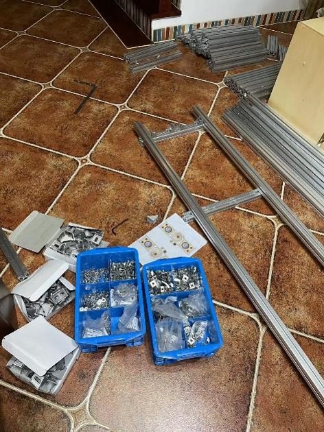

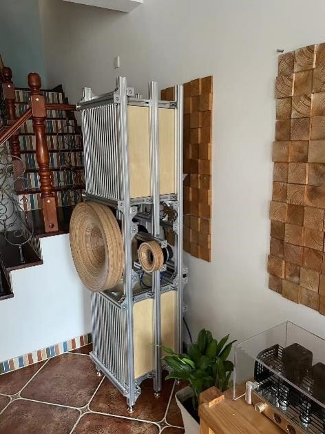

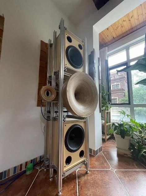

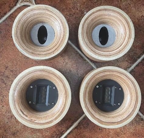

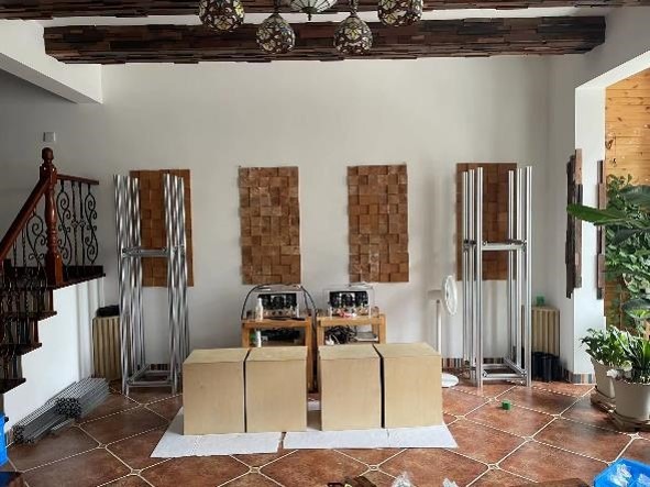

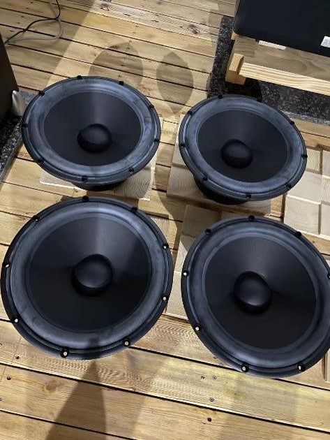

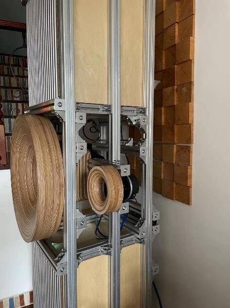

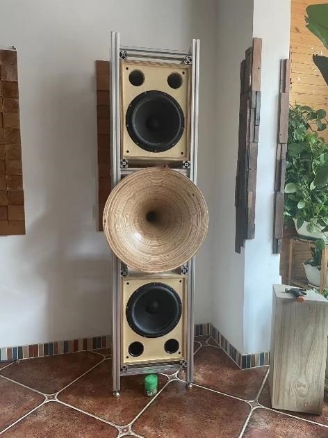

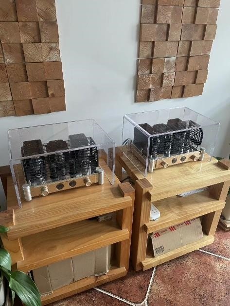

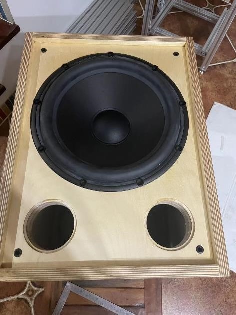

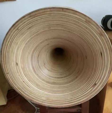

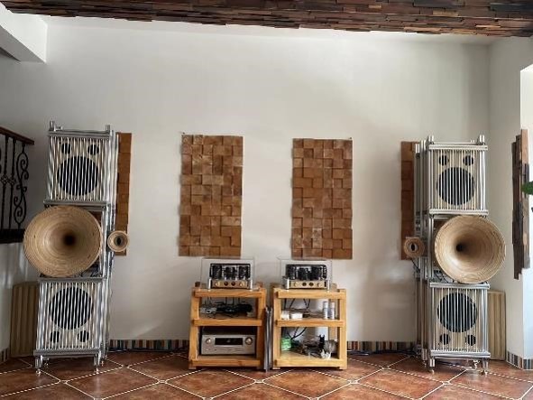

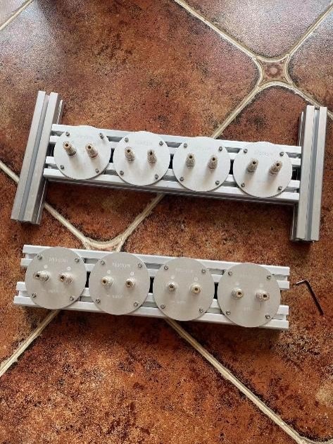

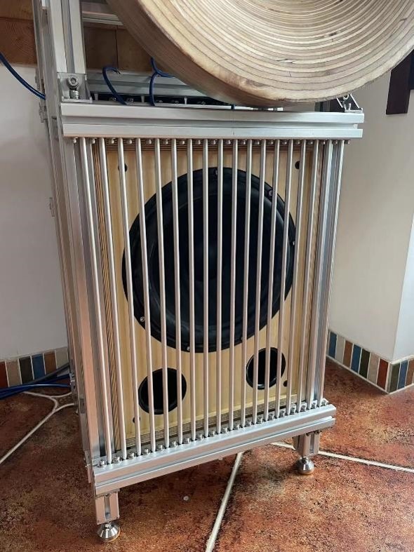

after some years study, I decide to make my first loudspeaker, here start......
any commnents, advise, suggestions...... are alwasy welcome......
-Design and Concept
5 frequency division speaker system
-330Hz-1200Hz-5600Hz-12000Hz-
Scan 8878T01

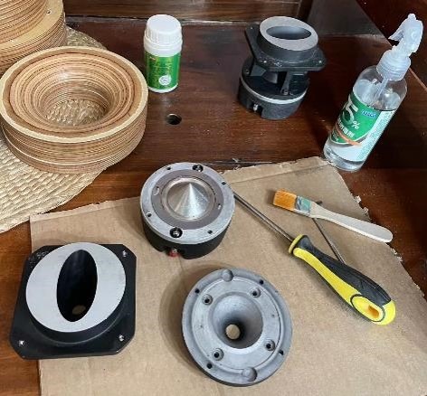

JBL 2450
RCF ND350
JBL 2403/076
FT Neo3.0
AP 650W
KT88
300B
300B
wide 4600mm
deep 4200mm
high 1950mm

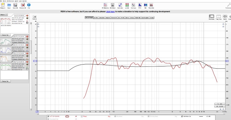

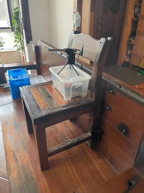

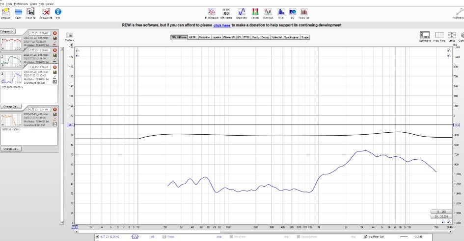

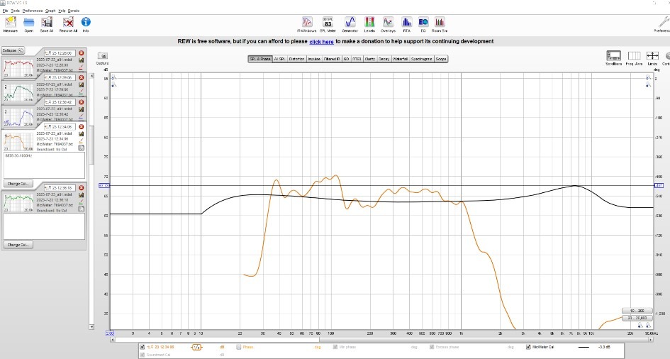

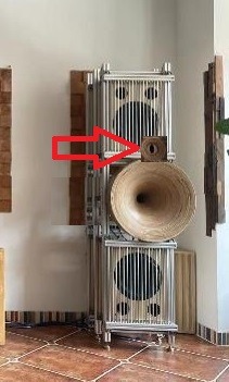

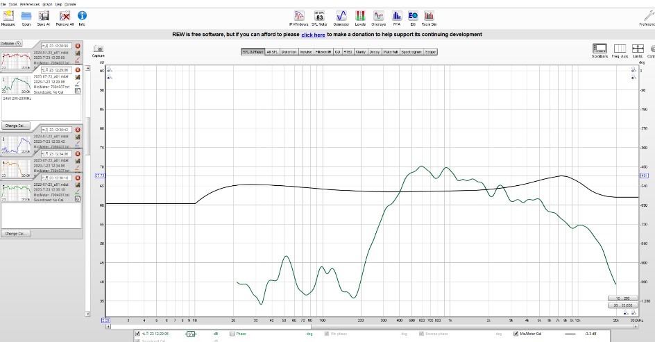

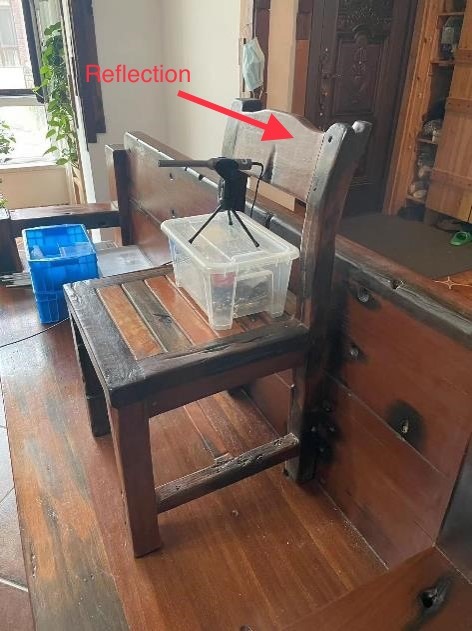

It would also be an idea to measure at your exact listening position. At least the height of the mic above the floor does not look correct to me.
An other thing to consider is to have the tweeter on the same vertical axis as the other drivers, like this:
