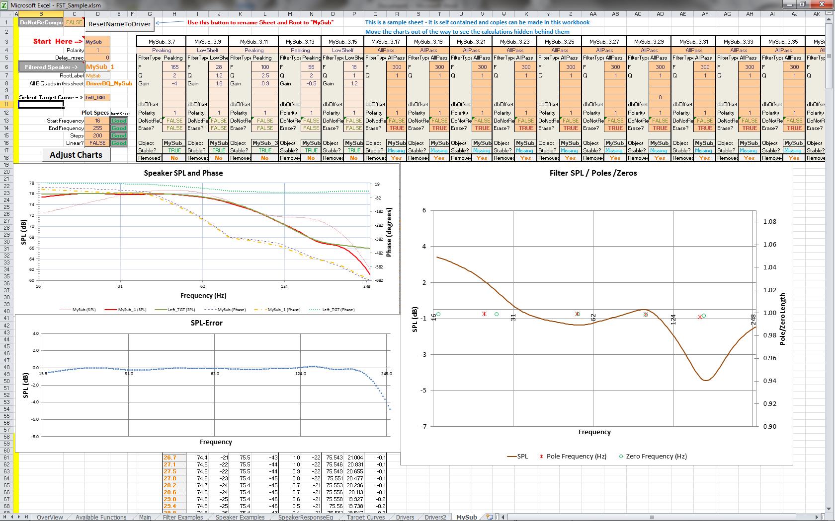

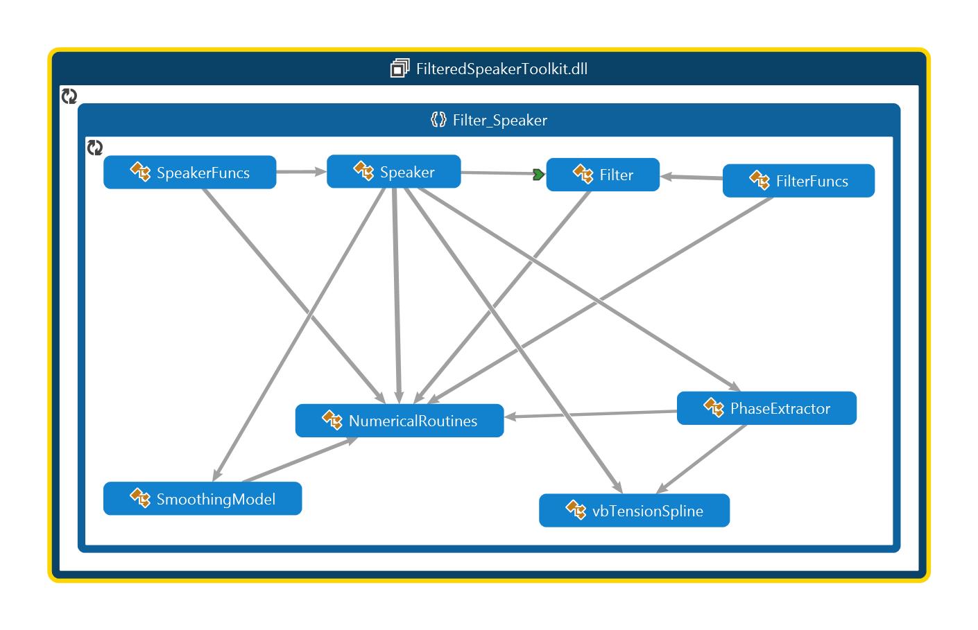

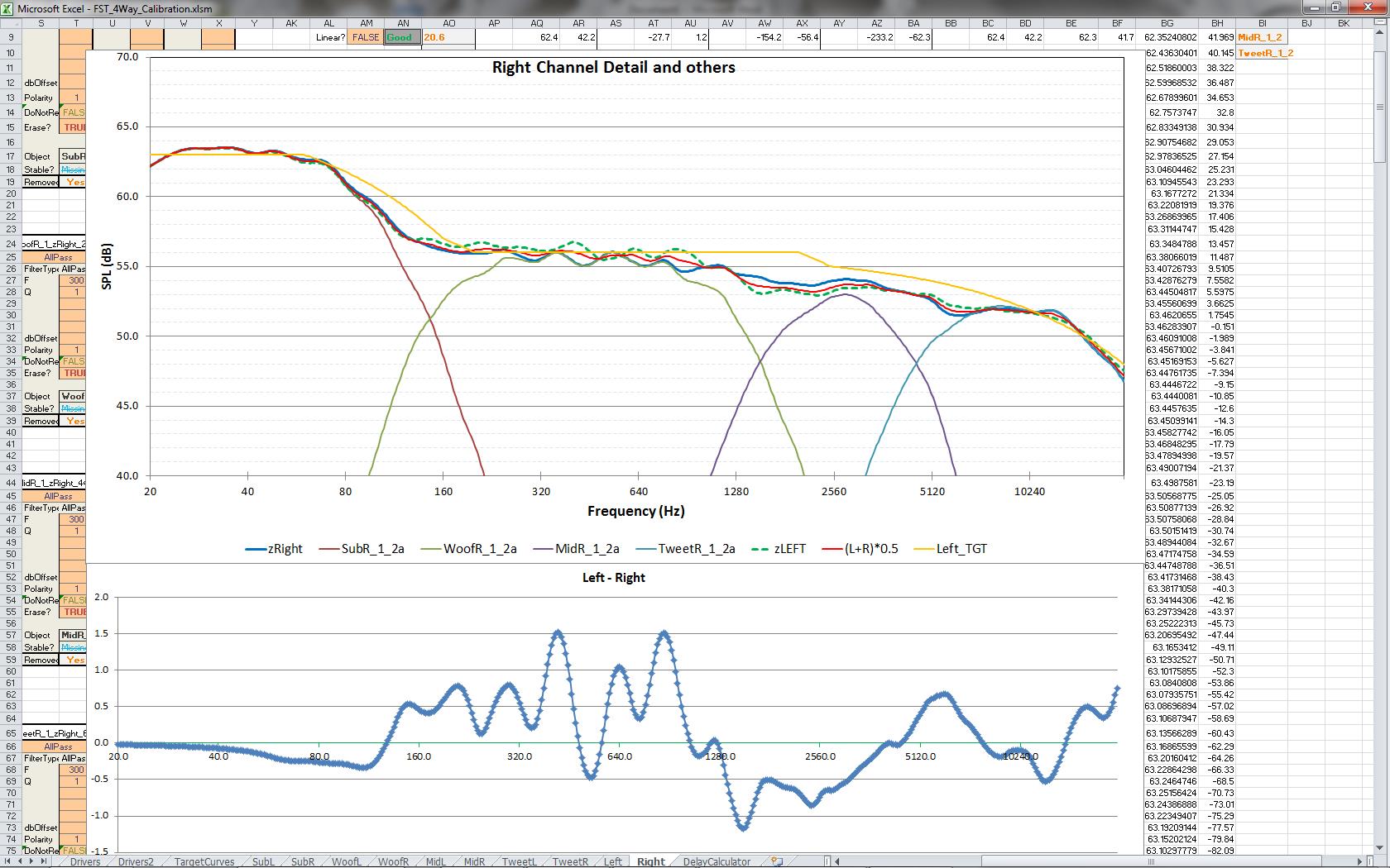

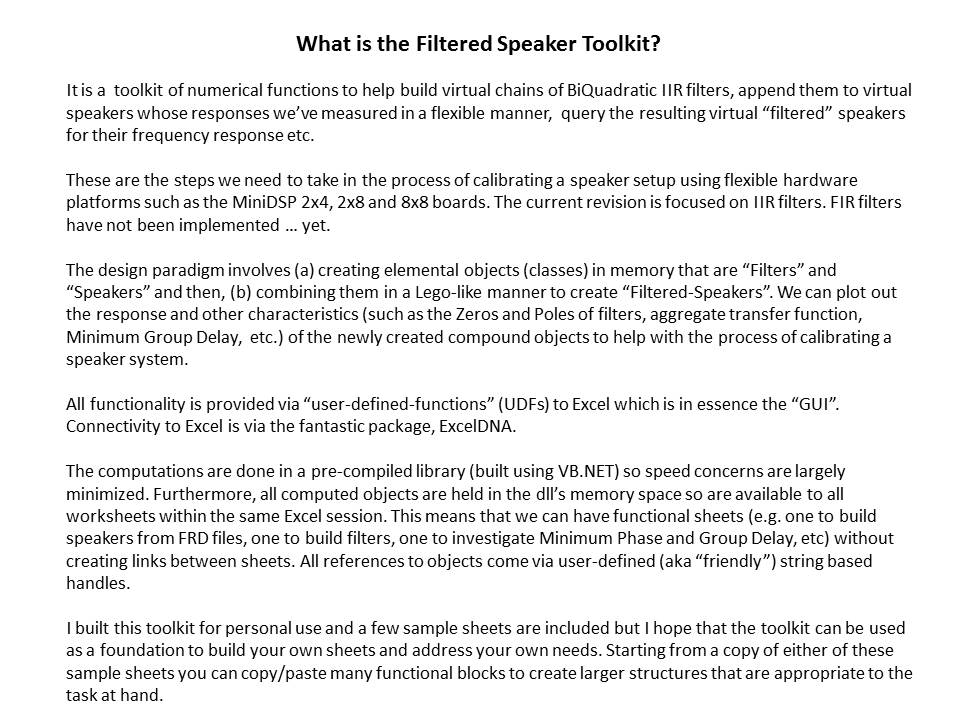

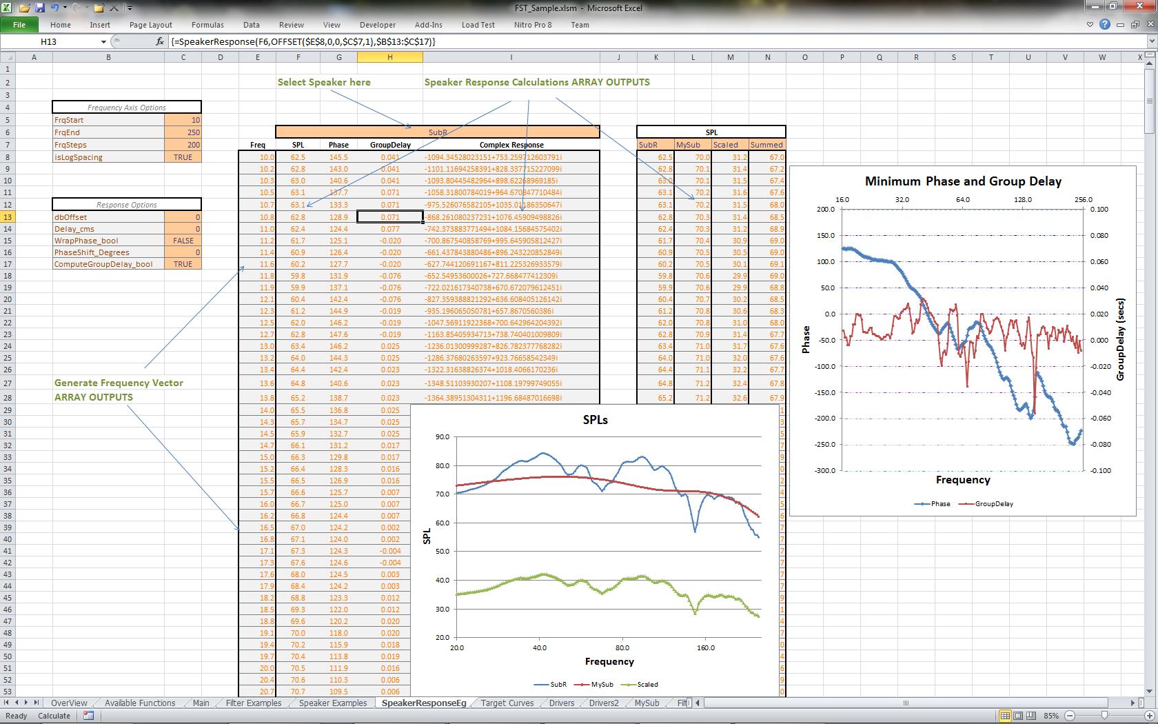

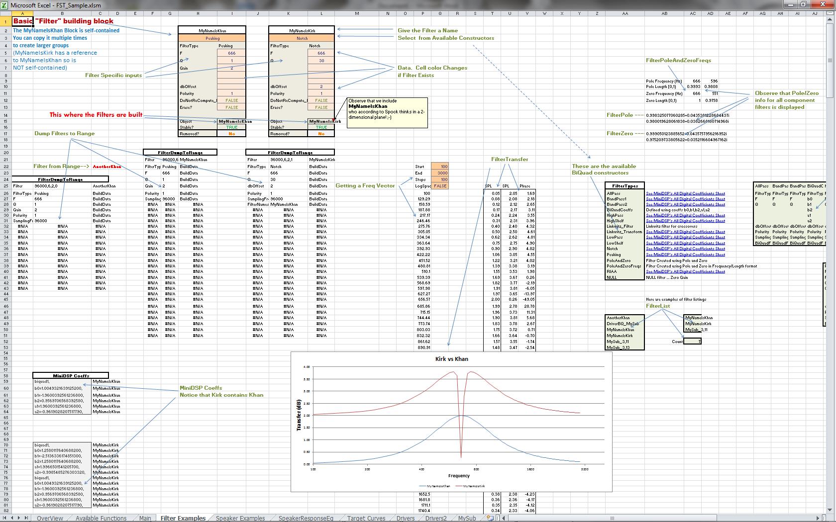

The result is the Filtered Speaker Toolkit. This toolkit does NOT measure speaker responses, etc. For that you will need to use REW, HOLM, etc. But once you have the response in an FRD file, the toolkit will allow you to try a variety of filters, combine speakers, etc. in a flexible manner. Tasks such as extraction of Minimum Phase are built it. All computations are done in a .NET compiled library (using Visual Studio) so are less subject to the speed/computational restrictions that arise with using VBA/Excel for the calculations.
The design paradigm that I've settled on also allows me to expand the toolkit over time to incorporate new computational units. For example, including new filter types/constructors and/or response-smoothing algorithms is straightforward since the functions work off a Name/Value configuration of "Options". I'll just need to expand the range of options and directives that the toolkit "understands".
I have tried to document (what a pain!) a lot of the functionality as best as I can. This was the hardest part and took the most time! It all seems to make sense to me (of course!;)) but I hope it also helps other diyers in using these tools.
The current version does not include optimizers to automatically select the best filters etc. But the toolkit does allow for the manual selection of filters to best match (visually by viewing plots) the desired response (i.e. "target curve").
Check it out and see if it is useful to you - and if not, let me know what you'd like to see implemented. No guarantees that I can get them in quickly - I have a real job too - but I'll try. :)
I'm attaching a few images to satiate your initial curiosity - you'll find more on the web page.
