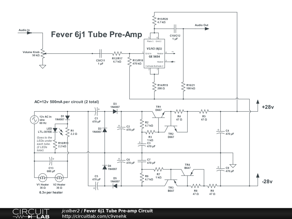

Schematic of the amp in picture. And i am aware of the output resistor to ground error in it as well. I was able to remove the hum with a modification to the filter cap circuits, and into my fosi buffer and the yamaha s801 in the den, it sound phenomenal. So i'm pretty motivated to get the thing right for my bedroom/desktop power amp. The fosi x4 handles tubey imaging duties in the den just fine already.

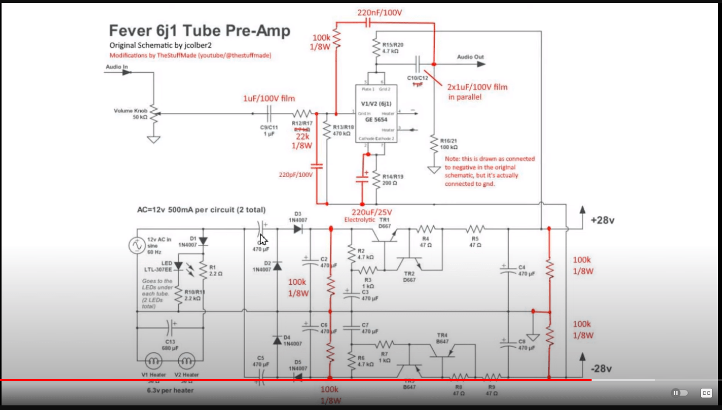

First pic is preamp schematic, i do believe you've input the correct values. Second pic is what i plan on doing with it currently, im under the impression doing so will have this preamp adequately driving loads as low as 4-5k as well as cut it's bandwidth from roughly 5-500k to roughly 20-100k.

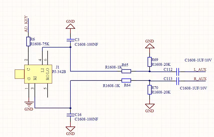

Third pic is the analog input of the power amplifier as schematic. The manufacturer says any preamp will see 20k as the load, but my results seem more on par with a 1k load. Which is obviously abysmally low. I'm not super experienced here, yet anyway, but i would think 20k would only be the load if referenced to ground with a multimeter and the amp powered off? (total guess)
And its a dual tpa3255 chip amp, one chip is bridged to provide subwoofer output, and one chip is stereo with a 100z high pass.
Would the fact it's two chips running in parallel maybe cut the 20k assumed load in half? (i have o idea how ill-informed this observation may be)
The modded preamp schematic design was made by TheStuffMade on youtube for credit where it's due.

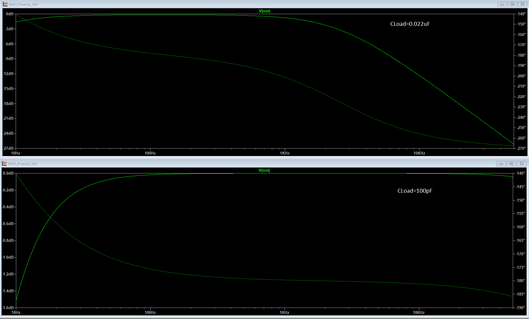

The lowering as frequency rises curve on your first graph is a pretty damn good representation of the response curve im getting plugged into the class D amp honestly.

Would removing or changing the value of those capacitors cause adverse reactions in the amplifier? My dac, my interface, as well as my fosi preamp have no issues driving this analog input at all, there is no high frequency loss detectable by ear at least. Same gain and eq settings sound basically the same on the 47k input yamaha, and this class d amp. MAYBE 1 or 2 db lower output, if that.

I have no idea about modern DAC outputs, but I assume some of them are of fairly low output impedance to drive 0.1uF. It could be that the capacitors are part of the DAC integrator, I'm not familiar with modern DAC designs. But if they are the integrator caps, then your DAC will stop working properly, I think.

Only issue, is theyre small surface mount caps, im not confident i could put it back on properly. Got no gun, only an iron. I would think the it wouldnt damage anything to do so, just maybe increase the noise floor, but no confident assumptions here for me though. Im good at soldering pcb's, never messed with surface mount components before though. Pretty sure i would learn something if i pulled em and plugged the preamp in though. And somewhat certain it wont damage anything on the amp at least lol. I can manually lower the opamp gain in an app that controls this amp. Wondering what pulling those caps, then lowering the opamp input gain would result in.
The impedance of the preamp is so high, im guessing those caps are functioning like the tone pot in a guitar bleeding high frequencies of the high impedance signal to ground, in a guitar removing them slightly increases noise floor, but very effectively brightens the sound and you can tune the bbase high freq rolloff by changing the value of the cap even when not messing with the associated potentiometer. I do have some 0.01uf film caps, but no idea how i'd go about putting them on a surface mount board with pads that small. Got a feeling i may end up abandoning this power amp even though i really like it lol.
Actuay there are two curves, amplitude and phase. The one that rises and goes then flat is the output signal level, showing excellent response. The one that goes down is the phase shift, reaching - 180 deg as expected.

Im going to complete the modification, and if it doesn't improve enough ill mess with lowering that cap value, maybe raising the 20k to ground resistor value a bit (would this cause more loss through that input filtering cap though?) and dropping the opamp gain. I dont think ill destroy anything, and worst case scenario ill be abandoning this particular tpa3255 amplifier anyway. I'm thinking that feedback cap/resistor loop to the output of the pre will probably have the biggest positive effect on output impedance. But really i have no idea.

Problem solved, i finished the mod and it brought a good bit of the high end back in, but not all of it, was still a little pretty dry to my ear, but listenable. I dropped the value of c3 and c16 to 0.022uf from 0.1uf and that sealed the deal. Sounds as fantastic as i would hope, and honestly my phono pre and my DAC/interface sound a little nicer as well now, why the hell they decided to use those values for bypass is beyond me. Seems quite pointless tbh. Definitely improved the airy feel of reverb decay and cymbal strikes. Also got rid of all background ac mains hum in the supply circuit of the preamp by bridging the outer leg of R9 to output ground with a 680uf 50v electrolytic (470 was recommended to me, but i had a 680 and it worked just fine).
Even running the power amp without those capacitors at all seemed to cause no adverse reactions in the system, and installing the 0.022uf films in c3 and c15 didn't seem to change anything about how the amp responds to input or noise compared to no cap at all. Makes me wonder why they bothered putting a bypass filter cap on the inputs at all. A 0.047uf mylar seemed to still pull some sparkle off the preamp, tried it first, 0.022 seems to be the highest value i can run where i suffer no appreciable losses across the wide band with whatever impedance curve i landed on.

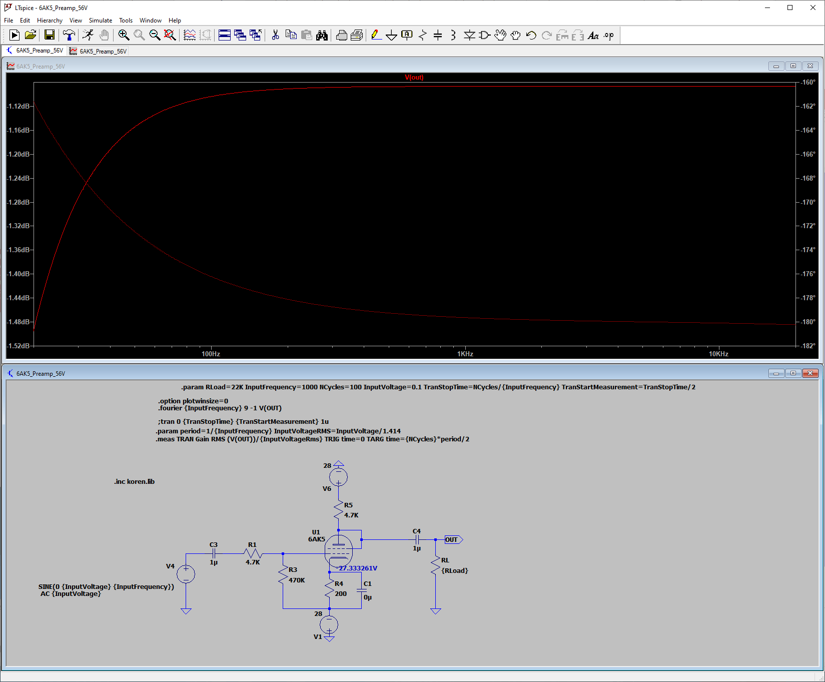

Great, well done, glad to hear everything went well. I have been looking at several tpa3255 schematics on the net, and have never seen one with 100nf in parallel with the input signal path. I have seen RCs with 100pf in some schematics, which of course is a very different proposition. Maybe you could check with the amplifier supplier the reason for those caps.
PS: I would really replace the 0.022uF for 100pF. I added a load capacitor to the simulation. Have a look at the bandwidth with both options. There is still a big impact on the highs with 0.022uf.
Yea i didnt have the legs of the new caps soldered properly to the surface pads. Tinkered some more today and soon as i got good contact, there goes the high end again. All my sources sound better with those parallel caps being gone completely.

Interesting note i meant to mention, the rec out on a yamaha avr i have is 1.2k ohm buffered. Which should be almost exactly what this tube pre is sitting at with the mods i did according to source of the mods, the pre was still all bass going in before the cap removal, but run through the avr's buffer that should be a very similar impedance it sounded fine into the class d's input, as the pre running thru the avr buffer still does post cap removal. Both the preamp kits i built and modified react the same way to everything i've done. Most of which still isn't making much sense to me.

I completely missed this. Those 0.1uf caps are probably a low-pass filter for tbe subwoffer channel. Makes sense.

Are you sure that makes sense though? (i just want to make sure i understand if it does) The knob that controls my subwoofer crossover frequency and the level knob both are not responding any differently then before, i still have it set to roughly 100hz and i didnt notice any change to the low end at all removing the capacitors. The signal is split for the two chips somewhere after this input circuit, any low pass filtering on the input affects both chips wouldn't it? Correct me if im wrong, but reintroducing high frequencies after they were removed with analog circuitry would introduce noise to the signal wouldn't it? There is also a 100hz high pass on the non bridged chip, whatever circuit handles that is definitely not at the input. The tone controls on the amp are sub freq, sub level for the bridged chip, and bass and treble for the stereo chip, and master volume. It's spec sheet is essentially identical to the fosi bt30d pro. I wouldn't be surprised if it's the same circuit ripped off, with only a few mild changes, mostly to component quality, id imagine. And personally i think it sounds better then the bt30d pro (most of the time) if i were to be honest. It definitely has a lower noise floor and i prefer the way the high freqs come across, so i think i just prefer whatever's been done with this amps output filtering. And without those caps, i like it even more to be honest.

Is there a possibility those caps were SUPPOSED to be 100pf? But the 100nf caps may have been used by mistake thanks to an error when designing the schematic/boards? Seems very within the realm of possibility knowing what little i do about chinese manufacturing. I wouldn't be surprised at all if those caps were there to suppress super high frequency noise on resolving enough setups with certain sources? I'm using GRS ribbons that are dead flat in response and impedance both all the way out to nearly 40k. If i had to guess the sound he's hearing was likely between 18-22khz based on what he was describing (Dude's almost 40, what a lucky bastard lol) My focusrite interface that isn't making any high freq noise outputs at like 95ohms, idk if thats useful information or not. the phono preamp is 250, and the new tube pre is 1.2k ish. The new preamp makes the most high freq noise, followed by the phono pre, then none at all on the focusrite, or it's just too high freq to hear. idk if that's coincidence or implies something.
