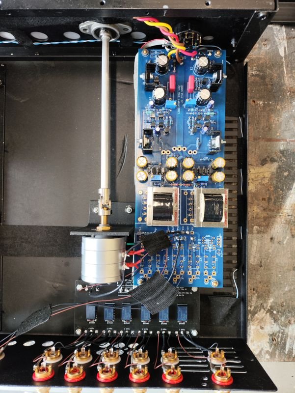

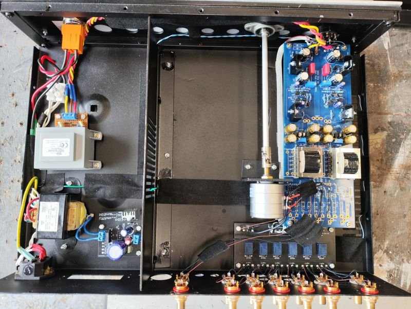

I should probably have added a bit more information about the iron pre build. It is standard enough, from the group buy here. The Eizz pot is 50k mounted at the rear near the input jacks and the only other non-standard thing is I used my own source select board because I like 6 inputs rather than 4 as standard on the Iron pre. Good quality small signal relays from Panasonic were used for this and wire runs were kept short as possible.
Iron Pre has 5 inputs standard.I like 6 inputs rather than 4 as standard on the Iron pre.

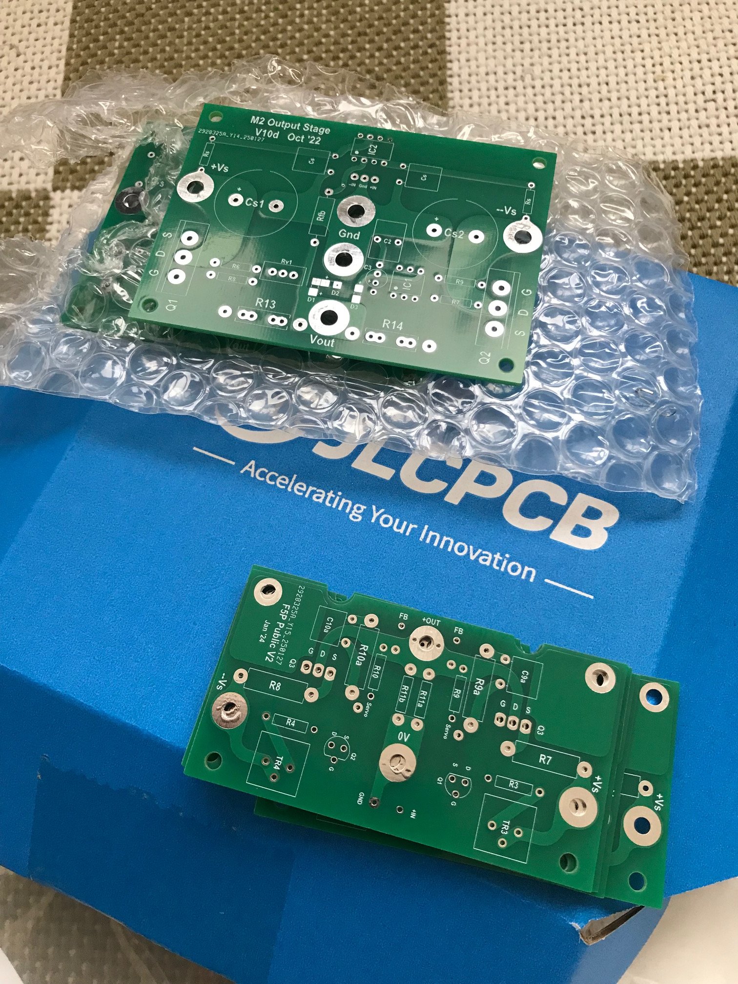

Yup, the boards arrived some time ago. I started slowly populating the preamp boards...So some are still watching.

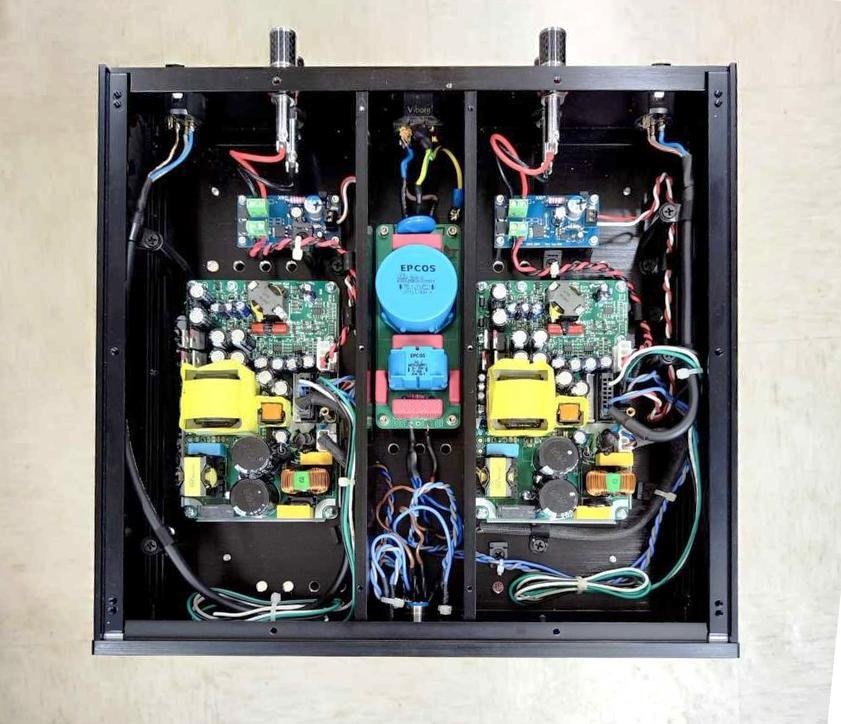

Ideal as a balanced preamp for the NCore NC250MP, in the same BZ3207 case :
