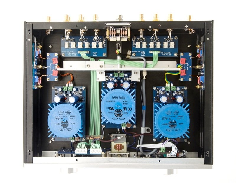

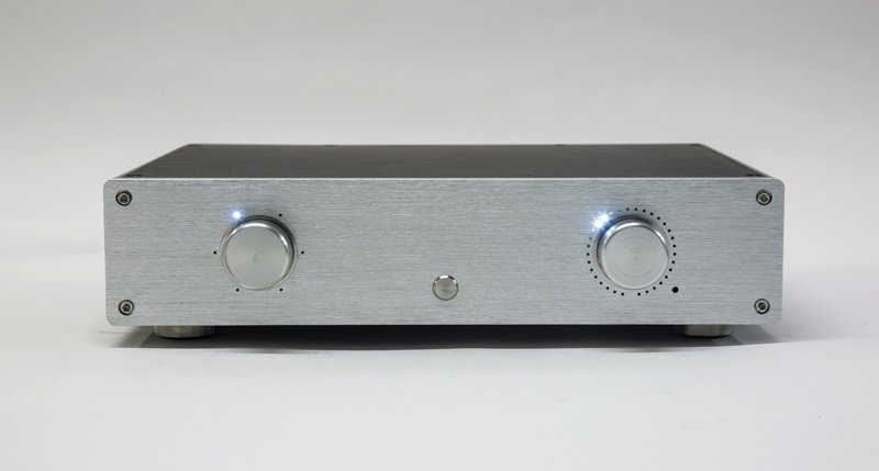

I am the fortunate one to be able to listen to this preamp and that is my messy bench in the video below!
Early indications are that the sound quality is very good indeed, but I need some time to listen with a few different amps and a few different sets of speakers, and likely a few friends as well. Lots of detail, great soundstage, tight firm bass, no harshness..... need I say more. It takes time though to listen really critically for a while, so bear with me while I do that.
The build is very neat indeed, as you would expect from a master, and functionally covers all the bases. Personally, I like to have 6 inputs as I run a number of different sources in rotation, 6 inputs covers all my needs. The left hand knob switches source and the right hand knob has the rotary encoder for the attenuator as outlined in the PDF in the first post. There is no turn on or turn off thump to speak of with my setup and nothing gets much above room temperature. The other thing is the silence - I was listening this evening to some tracks and at the end of the song there was some tape hiss - then the track actually ended and the silence was just that. I think that is one of the things that gives such great detail.
The interesting thing in that video is the Ring LED on the right hand side.
We are using the W-ONE relay ladder attenuator with 128 steps and 3-digit 7-segment display.
The latter is based on the MAX7219 LED driver.
With only 32 LEDs around the ring, each LED has to be assigned to 4 steps.
To partially get round that, we implemented an intermediate state where 2 neighbouring LEDs are on with half the intensity.
That means now we can now have 63 states in total with 32 LEDs.
Fran called it "Chasing LED".
I think it is a nice name.
Patrick

There are details you don't see.
Like the mains cable is shielded, but run through the centre to the front switch inside a thin-wall aluminium tube.
So double shielding if you like.
And if course dual mono, fully symmetrical.
Patrick
Patrick

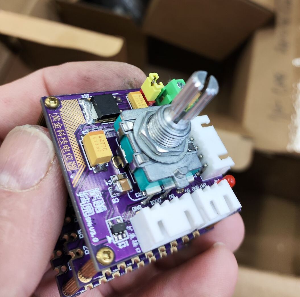

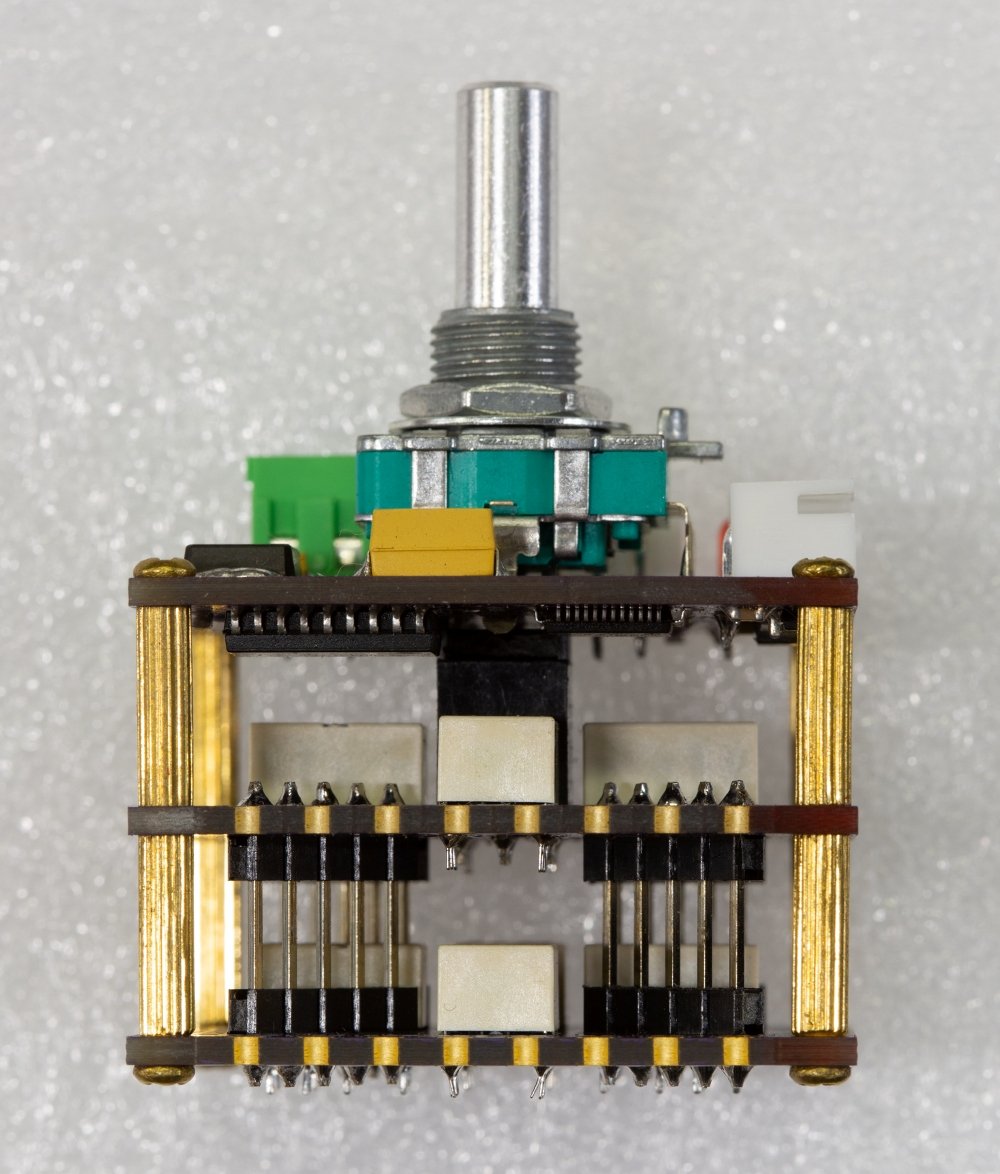

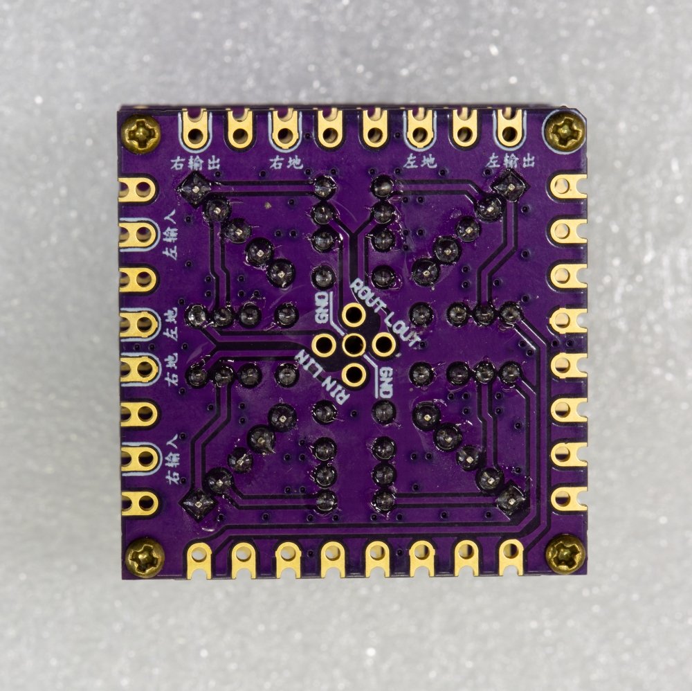

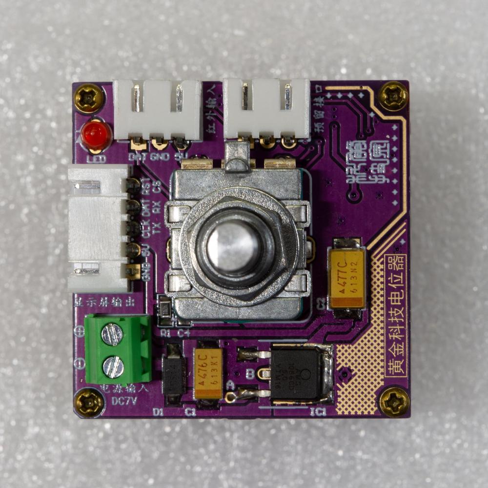

Here some pictures of the unit we have.
Stock version is 50k Rin, has Chinese made Omron G6K relays, and common Gnd for L & R channels.
We have replace the two relay boards (detachable from the MCU board) with our own 4-layer boards
They allow us to use Japanese Omron G6K's, Dale RN55 resistor set for 10k Rin, and separate Gnd's for L & R.
Essentially, we only use the MCU board.
Patrick
Patrick

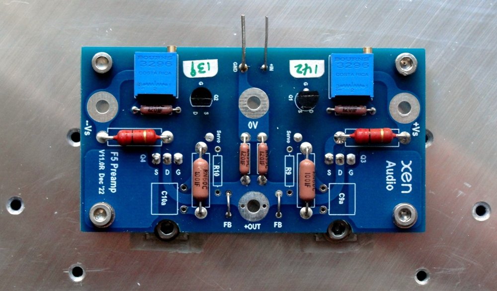

As mentioned in the pdf, the basic modules in the Preamp cones from the F5Pi.
The necessary changes are already explained in the article.
We are using 2SK246/2SJ103 BL, and FQP3P20/3N30 .
These are our preferred devices.
You can most likely also use 2N5459/5462 and IRF610/9610, if they are easier for you to get.
We even published a spice file before :
www.diyaudio.com/community/threads/the-f5pi-f5p-voltage-gain-stage-m2-output-stage-perfectly-integrated.406024/post-7538513
We could have also used 2SK2013/2SJ313, but they are even more difficult to get.
The reason for using higher Idss JFETs for the input stage is that they allow higher value resistors to be used in the feedback network, so as not to load the output stage excessively.
There is no absolute value for bias to follow, rather a matter of taste.
So one can download the spice file, change the device models, and play with the values and different load impedance.
Or just follow the circuit of the BA3 and adjust the gain to suit your needs.

The power supply is nothing fancy, just standard Talema toroidal and LM317.
It fits the layout perfectly, and allows complete dual mono, plus separate supply for the auxiliaries.
I am sure other people will have different preferences.
Like R-Core transformers, super regulators, ...., etc.
May only need more space in a larger case.
But as Fran has reported, it is dead quite as is.

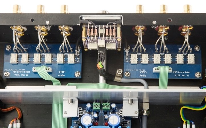

For the source select and ladder attenuator, one can just use the standard Relaixed which is fully in the public domain.
www.vaneijndhoven.net/jos/relaixedpassive/
www.tentlabsshop.com/DetailServlet?detailID=1580
It will even fit in the current layout, but we don't like using a SMPS in the preamp.
And the Relaixed will need a milled front panel for the LED 7-segment display.
So we choose to do it differently, as also explained in the pdf.
