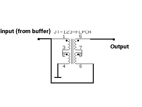

There's a lot I don't understand about them...didn't you say you got 6dB more gain like this? In F6, I understand there is no gain from transformer, but from solid state bits, while in M2, solid state bits are buffer, and gain is from transformer.....yet your method gives 6dB more, right?

Yes, 6db gain per this diagram (stole from Zen Mod). Here's the spec sheet on the Jensen transformer if you need it: https://www.jensen-transformers.com/wp-content/uploads/2014/08/jt-123-flpch.pdf
It's important to drive this arrangement with a low output impedance circuit for the best possible result, hence the buffer you always see in front of them. Wayne's discrete op amp has a fraction of an Ohm.

No, not used in this way. It's a single winding with one side grounded. A tiny amount (few mV) is fine.

About gain needed which is always part of F4 discussion.. I've found with my own situation, 18db in this linestage (12db SS bits, 6db iron) is almost spot on. I don't use any resistive attenuation at all. The digital attenuator in my DAC is not throwing away too much at my normal listening levels. I think gain structure is really important. Some of my old systems had "hair trigger" volume controls before I knew any better.
