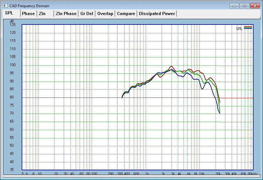

Hi Nick
Keep in mind that the front panel itself affects the response in addition to the Waveguide, so the example below is on the front panel of Elsinore Mk6.
Note that the smoothest response is 15 degrees off axis.
Red: On axis.
Green: 15 degrees off axis.
Blue: 30 degrees off axis.
Frequencies below 350Hz and above 24KHz have been digitally edited out and the responses measured within those frequencies are essentially anechoic.
______________________________________________________________________________________________________________________________
Please note that the Crossover flattens the response significantly as it suppresses the Waveguide's rise below 10KHz by about -5dB when summed with Midrange and that Coupling Capacitor value is about 1/3rd than what is required when no Waveguide is used. This is also partly the reason why a Waveguide greatly increases power handling and if the Crossover point is not lowered, then also distortion is lowered by 3-4 times.
Cheers, Joe

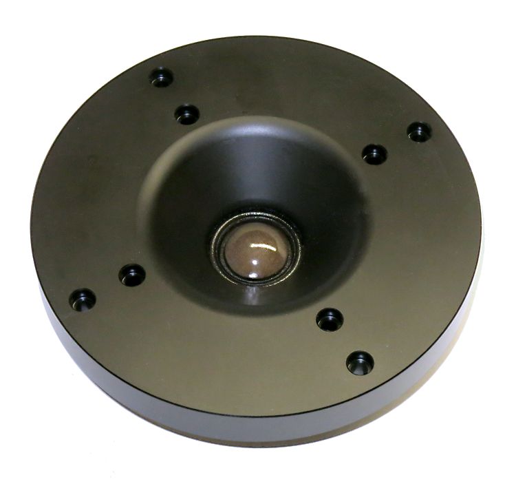

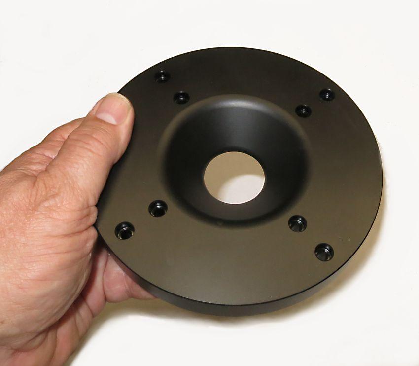

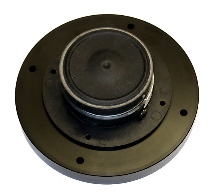

Hi Guys
Prototype Waveguide photos below:
The new Waveguide made of Acetal. They feel like an extremely light metal, but they are half the weight of Joel's Waveguide, being each 395gr and that means packed they should come in just under 1Kg.
Click to enlarge.
When witting Waveguide on top of the HDS Tweeter, the improved fit inside the bevel of the Tweeter is a much tighter fit, so much that shown below it virtually centers itself into position.
Click to enlarge.
Finally the Rear View:
Click to enlarge.
They made be made just before Xmas or else early in January.
Cheers, Joe
