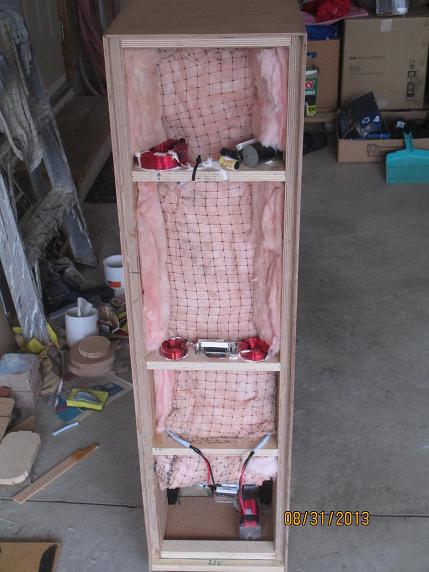

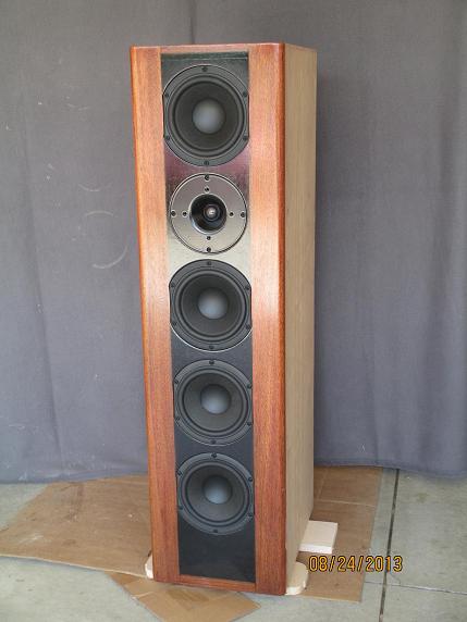

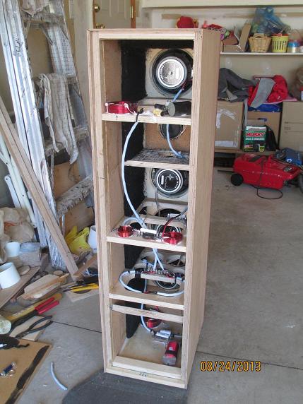

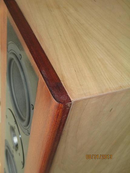

well they are not quite finished yet, but they are singing 😀. at this time i have them braking in in the garage. low Qms, high Fs maybe hard to brake loose since once in the room they will never play to high volumes. one sounded good right off the bat. the other one started harsh with some crackling noises but improved after 2-3 hours. Thank you Joe! I found your approach to design quite agreeing with me, very logical. using four of the same kind calls for a good driver though, but since Troels G. also recommended them for their ability to reproduce vocals, that made up my mind. they are a bit over 65L that I was looking for, mine are over 80L, but hopefully they can make it inside the house without my wife pushing me out. getting them breathing space away from the back wall will be a chalenge though 😕. I attach a few pics for the record. the back veneer and stain are still to come.
not sure why the pics did not show after i uploaded the attachments? will investigate tomorrow. it's too late for tonight. sorry.
re: bracing
well actually it was Joe who strayed away from the conventional. this makes for a stiffer box, especially if the back gets glued all around and to the braces as well (like these will be when finished). as an added bonus the XO coils can be distributed along the height for minimum interference. normally the chamber behind the tweet would also get stuffed but that does not jive well with Joe's bass concept where all drivers should communicate with the port at the bottom. I also took a risk with an added brace at an angle and moving the port lower and violating a rule there, almost chickened out
, but it seems to have worked out well. I am enjoying them. Eventually I may engineer an upgrade to my low end B&W setup to compare against these and see which one is a keeper but I have another project to do before that, so Elsinores should not be contested for the next two years.

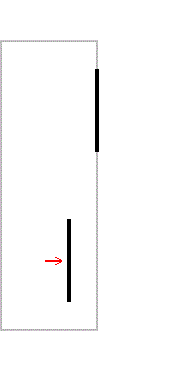

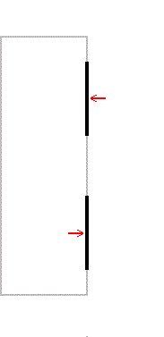

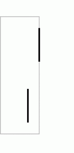

Joe Rasmussen Approach to Crossover

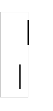

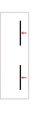

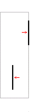

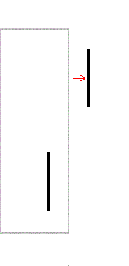

Hello to everybody!
Although a member for some time, this is my first post. I take the opportunity to say "thank you!" to all of you participating here for a better audio experience and understanding!
Having read many times Joe Rasmussen's article "Joe Rasmussen Approach to Crossover", I believe that a different set of sketches, concerning drivers' movement when they are connected to Butterworth crossovers, may show in a more accurate way what the author is proposing.
1. Rest point, no comments! 🙂
2. In Joe's sketch, both drivers are moving forward. Since there is the BW characteristic 90 degrees phase lag, I propose the alternative sketch. Is there any reason the lag appears in the second quarter of the signal's cycle?
3. In the third sketch the mid driver is still moving forward, its excursion is doubled, although, I think, it should return to its rest point. Therefore, another sketch proposal.
4. The 3rd cycle.
5. The 4th cycle.
6. The fifth stage of movement, concerning only the mid driver as it returns to its rest point alone, since the tweeter has already reached its own in the previous stage.
Do I miss something important?
I would appreciate a lot your comments, especially Joe's.
I just hope that I do not duplicate someone else's same or similar thoughts already posted here. I could not locate something similar in this long thread.
Best regards
Dimitris
I am not sure what the question is?
The sketches you posted do not match what is on my website.
The fact that one driver starts from a resting position equal to the baffle and the other does not, it has to be understood what is represented is a slice in time, not just a signal burst of one cycle.
Let's say that it is a 3KHz sine wave and the crossover is also at that frequency. Let us also say that both MidBass driver and Tweeter have the same Sd, the total surface area (in reality they don't, but that need not concern us for this excercise) and that one driver has a high-pass filter and the other a low-pass filter, single-pole. Then the representation is correct.
This is NOT the starting point of excitation - this is a constant sine wave already in motion. This is a "book-ended" cycle.
Both drivers move forward, being excited by the same signal, but with different but complementary filters. The top driver is now at it's maximum forward posistion. Because the other bottom driver is 90 degrees out of sync, it will be in the middle position and continuing to move forward as the next quarter cycle demonstrates.
The upper driver moves backward and the bottom driver continues to go forward. While in the first quarter of the cycle, where both drivers were moving forwarding, they were summing positive (additive). But in this cycle, they are not adding, but are cancelling. Zero output results.
The next cycle the will again sum.
While they are now moving backwards together, the are still summing - not cancelling.
Now we have the final quarter.
Once again cancelling and back to the original position. We have gone through the entire 360 degrees of the cycle.
So Butterworth cancels out half the output, every second quarter of the cycle results in no output.
But that is of course only the beginning, because in real life the MidBass is starting to beam considerable at 3KHz and it is part of the Tweeter's job description to fill in the failing off axis response in the MidBass, and it cannot do that with any degree of success. So with Butterworth, we can only aim at a flat response on axis, whereas off axis there will be a considerable lack of energy. This means that Butterworth cannot have a flat power response into the room. And yes, it is very much audible, it also cause a perceivable discintinuity between the two drivers. To use fellow loudspeaker designer (and long-time friend) Brad Serhan's wonderful description, "it is about getting the stitch right" and if you get that right, you end up with a crossover that virtually does a disappearing act.
There are other considerations as well. Note that, in the above example, when the first quarter of the cycle, the perpendicular axis is aiming down, and in the third quarter it is upwards? Now consider that indeed the Tweeter and Midbass do not have the same radiating area, can you see that Butterworth also has vertical symmetry problems.
All I am demonstrating is why I avoid doing Butterworth designs.
Cheers, Joe
I regret the above were not clear to me...
Now I fully understand and agree with your thinking.
Thanks for the clarification!
Best regards
Dimitris
