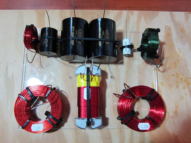

Initial layout of the crossovers...
I was originally going to build and mount the crossovers in a fancy external case that matched the cabinets. However, I decided against it as I have a feeling I might tweak the layouts and components a bit going forward.
So, while my ugly-*** NEMA enclosure is in the paint chamber, I took a crack at an initial layout of the crossover components. I still have to place another 33uf cap and add the resistors, but, this looks to be my initial layout. The large horizontal air cores are 20cm apart and the rest have been oriented to minimize interaction between the inductors. The base they are mounted on is approximately 8inches by 11inches.
Comments are welcome. I will probably not get a chance to work on them anymore until the weekend.
Based on your allotted space and needing to fit that 18mH iron core inductor in amongst the air cores, I think your layout is pretty good. In particular L1, L3 & L4 probably couldn’t be placed any better. There may be some better options for L2 & L5.
Layout (A) – your initial layout
- minimal coupling between L1 & L5, and L2 & L3
- considerable coupling between L4 & L5, and L4 & L2
Layout (B) – alternate option 1
- some coupling between L1 & L5, and L2 & L3
- minimal coupling between L4 & L5, and L4 & L2
Layout (C) – alternate option 2
- coupling between L1 & L5, and L2 & L3; more than (A), but less than(B)
- minimal coupling between L4 & L5, and L4 & L2; critical angle alignment needed
If you tone test your initial layout for coupling between coils you will find L4 coupling considerable energy into L2 & L5. Positioning them flat as in (B) will minimize this coupling with L4, but coupling with the larger air coils L1 & L3 will have increased considerably. If instead L2 and L5 are rotated to angles similar to those shown in (C), coupling with L4 can be minimized, and coupling with L1 & L3 will be less than in (B). The only issue is that the angles will need to be determined by tone testing to find the null as they will depend on exact location and core dimensions/properties of L4.

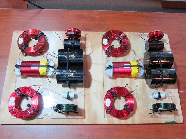

Thank you for the feedback bolserst. Very much appreciated.
Now that I look at my initial layout with the value of a second set of eyes, I do see how the layout exhibits the problematic symptoms outlined by Troels in his diagram #5.
Looks like I have a bit more work ahead of me. Option B is of course, very attractive due to the elimination of finding the critical angle. Although, I have access to the proper test equipment. The case I am using has some overlap room (overlap of the bottom plate shown in the pictures). I might be able to get the core centers of L1, L2, L3 and L5 closer to 20cm in separation in all directions by pushing them out.

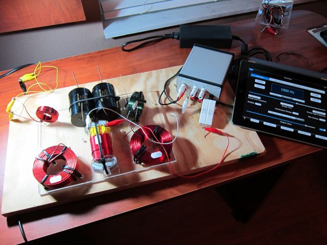

Wow, what a revelation!

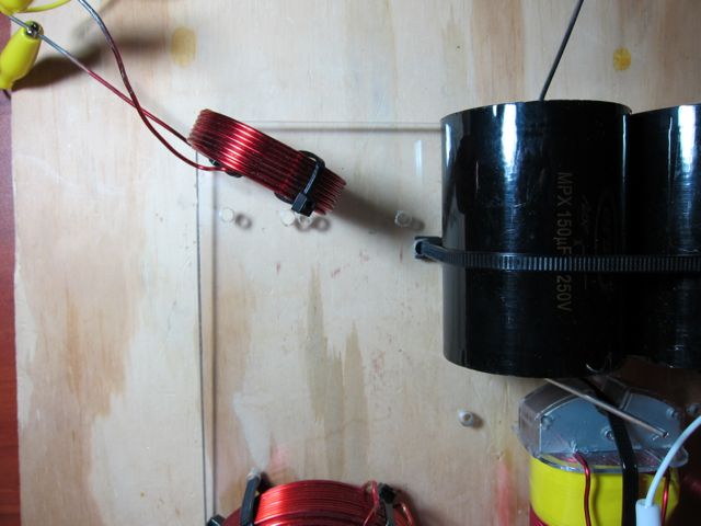

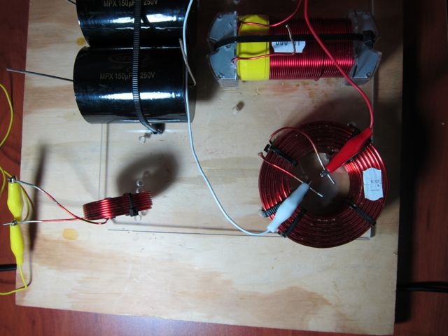

So I went ahead and hooked up the audio-based test setup that bolserst recommended. I figured that would be most reflective of what most people could cobble together without any issue. I sent the output of my iPad into a small T-amp I own, that output into the resistive load and into the inductor to stimulate. I attached my old sony test phones to the inductor under test.
All I can say is WOW!!!
This was a truly eye-opening experiment that I highly recommend folks try. It was extremely easy to set up and really lets you experience inductor coupling first hand. You really do not need any fancy test tones either. Simple music out of an iPod works just fine. Perhaps even better as the test tones get a bit tiring to listen too. 🙂
In any case, there is most certainly a critical angle for each inductor pairing. On the attached picks, the second pic shows the best angle to minimize L4 coupling. The third shows the angle that minimized L1/L3 coupling. Neither angle works perfectly for both inductors.
The correct placement of the inductors instantly becomes a game of compromise. I can see now why bolserst builds separate clusters for each driver and mounts them physically separate. There is really no other solution save for distance. We are not talking about small amounts of distance either, we are talking large amounts unless critical angles can be exploited. In my layout, even with critical angles being exploited, there is coupling of some level between all of the inductors. You really have to decide what you want to try to minimize and why.
So, now I am at sort of a crossroads. I will definitely go with inductor layout B that bolserst recommends. Long term, once I have decided the values for the crossover are acceptable, it will be mighty tempting to make the crossovers individual clusters for each set of drivers and mount them internally at the maximum distance possible.
In the meantime, I highly, highly recommend you give the bolserst test a go. It will blow your mind and teach you more about inductor layout than you could learn from a thousand books.

This was far more fun! 😀
I actually had an o-scope and signal generator ready to go. That combo or an LCR meter would probably be a better choice for optimizing between multiple inductors as relative levels could be compared far more easily.
Still, it was a hoot listening to tunes travel across inductors. 🙂

I did think of two other coil layouts you might consider which should allow minimizing coupling between more coils simultaneously. Both involve moving L1 & L3 to the opposite side of the board. Since this will move them into an area of higher flux density from L4, it will be more important to make sure the midpoint of the height of the coils match the midpoint of core of L4. See Figure (F) in attachment for details.
Layout (D) has L2 & L5 oriented vertically and placed on the centerlines of L3 & L1 respectively, thus minimizing coupling. L2 & L5 are also placed parallel to the core of L4 and at the midpoint of the length of the core. This minimizing coupling with L4.
Layout (E) also has L2 & L5 oriented vertically and placed on the centerlines of L3 & L1 respectively. But unlike (D), the coils L2 & L5 are placed as close as possible to L3 & L1. Then their angle of orientation is adjusted by sliding them around L3 & L1 to a point that minimizes coupling between L2 & L5 and L4. Coupling with L3 & L1 will still be minimal since the coils stay on a centerline with L3 & L1.

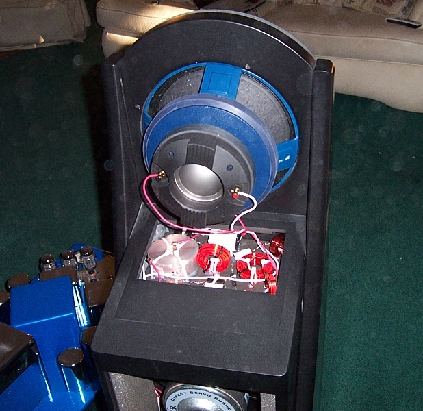

What it does show up is that many commercial and quite expensive speakers break the rules completely.
Not exactly Elsinore related, but stumbled on this pic showing the crossover coil layout for the GR Research Super V.
Looks to have had some thought/experimentation put into it.

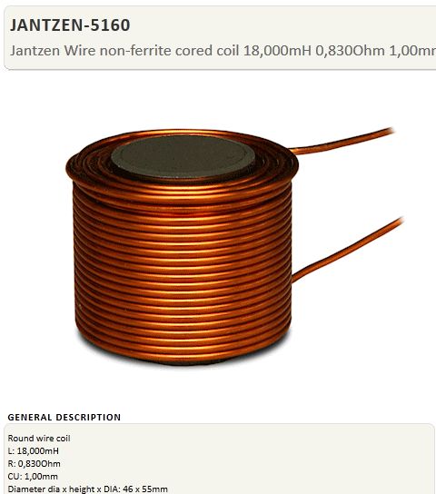

Opinions from anyone that has listening experience for the following
For the 18mh coil we're thinking of getting Solen 14gauge air
What can we expect to hear - Iron vs air
Thanks, Joel
Thanks, Joel
bolserst,
Thanks for taking the time to diagram the additional inductor layouts. They are certainly worth exploring. Layout E is especially intriguing. At this point, as of last weekend, I started to build up layout B. That will be my starting point for going forward.
irext,
I am close, but still a bit further out from firing them up. Unfortunately, I ran out of the wire I was using for the point-to-point wiring of the cross over. I should have more available by the weekend to finish the job. Measure twice right? I look forward to your inductor experiments.*
Joel,
I am using a Erse Super-Q, 16AWG, laminated 18mH steel core. You can get them directly from Erse (ERSE - Super Q). I ordered all my inductors and all the film caps save for C1 directly from them. Be advised, even if they indicate something is out of stock, it usually isn't (or at least not out for long). BTW, Jantzen makes a big ole toroidal air core in that size. (Jantzen 18mH 14 AWG C-Coil Toroidal Inductor 255-844). Far from cheap though!
irext,
Joel,
