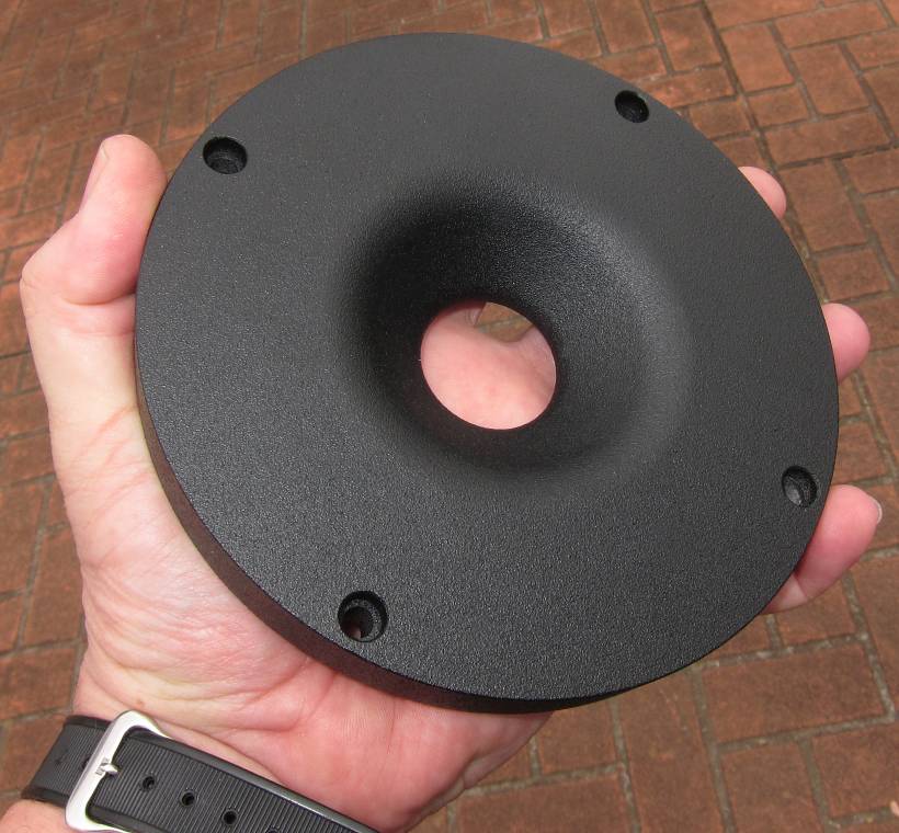

Question on your tapping the waveguides. What was the reason you decided to tap completely through the guide? No enough material or just thought there would be added benefit and strength by tapping completely though the guide?
Most of the guides in the picture are just tapped at the back so you can decide which way to use it. Bottoming tap used so its threaded close to the face.
I have three that go through the front. I prefer to make them this way because there is a bit more play to perfectly center the dome and easier to mount the tweeter as the bolts are inserted through the guide and spacers placed around the bolts but if decided not to mount the tweeter this way then theres four holes showing..
If mounting the tweeter to the waveguide was the standard I would havethe waveguides made so the tweeter faceplate rests over Aluminum(more land at the back) and spacers would not be needed. With this, Mounting the tweeter to the subfront would not be possible.

Hi Joel
Received the Waveguides today, beautiful work.
To others, I can certainly recommend them. You really have to see them to appreciate what Joel has done and also pay him for his efforts. They are also surprisingly heavy when you feel them in your hand. I saw how much the postage to Australia was.
Also, the Waveguide has been designed so that the HDS tweeter can be mounted first to the Waveguide and then into the box. This is a definite plus as it adds mass at a very useful place.

I guess my question here is more for Joel. Joel, with your waveguide, is there a gap between the tweeter front plate and the back of the waveguide? Is so, how much of a gap and why?
I guess I do not understand the rationale for a gap (even if the resulting dip in frequency response is audibly pleasing).
The gap causes a mechanical dip in the tweeters respose essentially removing the tweeter from the audible output below about 2K without using electrical components. The midrange/woofers are the dominate speakers at 2K. I think the tweeters must be a little rough that low, the fact the signal is out of phase and our natural tendency to be sensitive to those frequencies (Got to do with the length of wave and how wide our heads are) all combines to make this tweek work. I have always been one that judges my system by how it sounds. If something sounds better I use it. In my set up the music is much more involving and the emotion is conveyed better with the gap, so I use it. I have some o-rings that are just the right size to fill the gap and I occasionally slip them in for a comparison but I usually don't get through a whole cd. I will probably get some of Joel's guides to see if this holds true with them. Do you still have a pair available Joel?
The gap is small. I wanted the tweeter faceplate mounting area to make contact with waveguide back before contact is made at the concave around the dome. I'd guess the gap is around . 2mm.

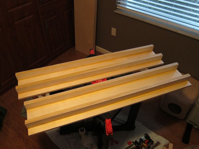

Let the gluing begin!

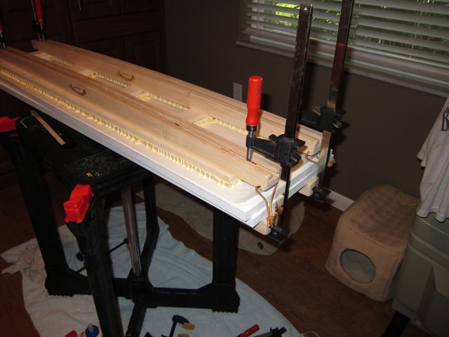

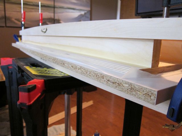

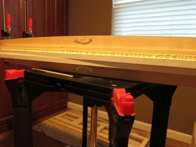

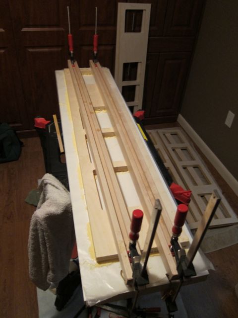

Finally got some time to start gluing together the sub panels and braces.
Decided to go in a somewhat different direction with the clamping method. I picked up some bowclamps. They are precision manufactured cauls that work really well with long pieces such as these panels. Once you get used to them, they make short work out of the clamping process.
Through a bit of trial and error, I found the caul-sandwich worked best less you induce bowing into the final product. If you have a nice heavy duty table surface to clamp against, you could probably get away with two less bowclamps.

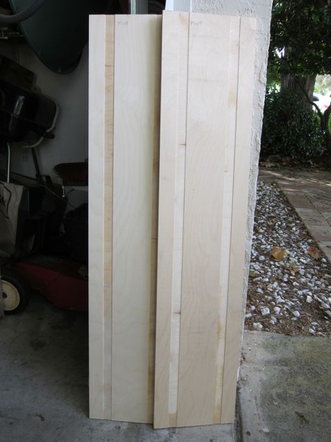

Back Panel assembly

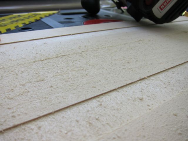

After looking at Joel's handiwork, I decided to over-size my cuts by a few millimeters in order to use a shallow through dado to ease assembly (thanks Joel!!).
By shallow, I mean the depth of a single ply. This really worked well as nothing moved around during the glue up. Broke out the bowclamps again for the actual gluing.
I am going to use this technique again on the main side panels. Main cabinet gluing starts tomorrow.
