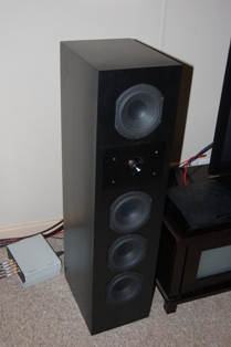

Liquid gold in my ears
Hey Guys
Just spent large portion of the weekend listening to MK5 (the missus a little bit cranky!!)
Some old favorites, some new ones!.......
Its just like I got a new CD collection ...again
Lower register is tighter and more defined...but still dynamic...clear, tight and deep.
Music sounding more "3D" than ever
Thanks Joe, you've done it again....
For what its worth, my reference is Aja- MoFi Gold (try and find one!). It will take you breath away on the Elsinore MK5's. Production values on this recording are killer.
Go forth and listen.😀

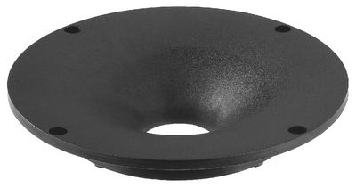

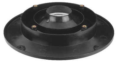

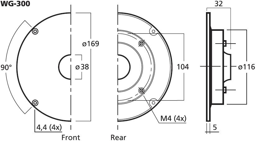

attached pictures Wavegiude from Monacor
I have a pair of those Monacor Waveguides here. I actually have then with the monacor DT300 fitted to the Linear Current Loudspeaker (which was supposed to have become DIY and now has taken on a commercial tangent).
This Waveguide is OK for larger domes and this is not suitable for the Elsinores. Also they are two deep and the offset (how far they are mounted into the box relative to the position of other drivers) is too deep.
But it would have been nice to have bean able to buy a WG of the shelf, and I did look around.
Mind you, if I was doing the Elsinores from scratch, the Morel CAT378 did catch my eye as worth trying. It is 8 Ohm and sensitivity looks about right, so does the Z plot. It would have made the front panel construction of the Elsinore boxes simpler too.

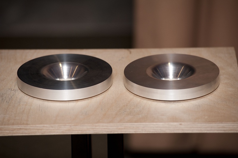

ALUMINUM WAVEGUIDE

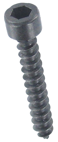

Have to take back for recessed screw holes. should be fine for machine screws as well. wood type screw for plywood is good but not so good for MDF

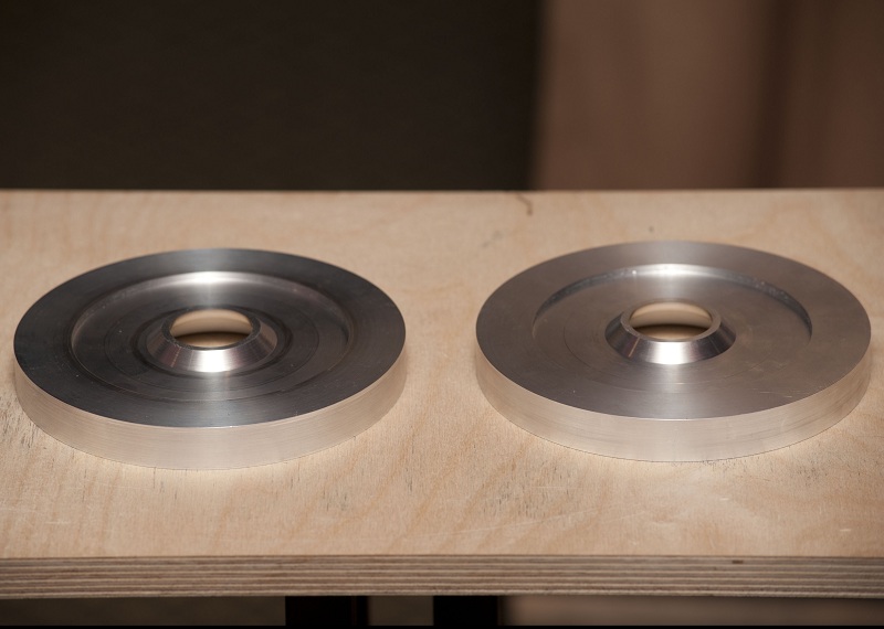

waveguide
Hello Joel, I posed a similar suggestion to Joe on this same dilemma, the back portion to match the tweeter flange contour. It was to think of the tweeter flange as an inclusive part of the waveguide and not something that mounts to the guide. In this respect one could first machine the back face that would accept the tweeter in the same fashion the tweeter accepts the (original Peerless) flange, and by doing so the plate (aluminum) can be flipped back over to machine the mouth, throat and flare at the exit. This I think will eliminate the additional attention to the tweeter/flange matching the guide. In essense the tweeter (without flange) would mount directly to the waveguide!
I could include a drawing if you do not see the image in your head!
Francis
Francis
waveguide
Hello again Joel, I was a little to anxious to reply to this post as the images were slow to come online! It appears you have the fix already. Good work. With that said I would like to be on the list to order a pair! Sorry for the mix-up!
Francis

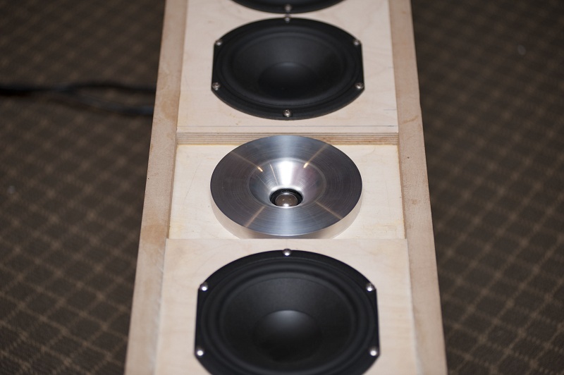

It will take some time but I'd like to see the first pair finished. Nice paint coat. Fitted in filler board
At this point I could take the orders and have them made and painted all together
Unfortunatley the weight of AL is more than I guessed. The total will be more like 2 or 3 KG
Planning a Hamlet build for center so extra Waveguide is needed. Hopefully the new xover will come out.
Joel
Joel
