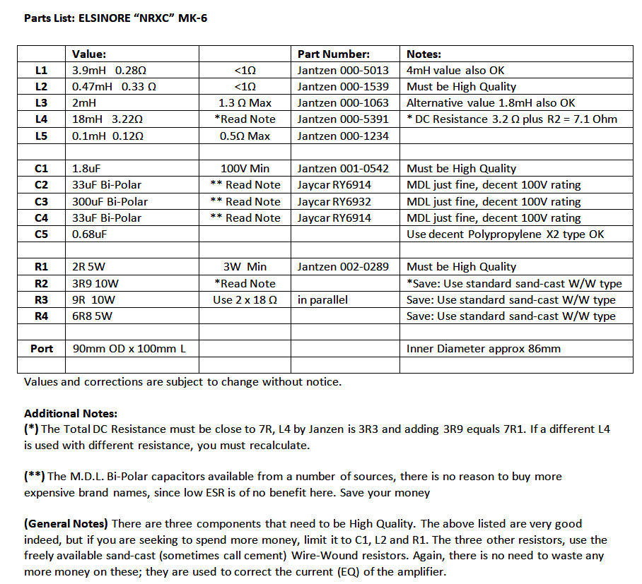

You don't need to worry, any changes only affect the electrical side and refines the EQ of the current of the amplifier.
It is mainly the components for the high frequencies EQ, first the Zobel consisting of R4 and C5:
The 6R8 (R4) will be the same.
The 0.47uF (C5) is changed to 0.68uF and if you change that value, you must also change (R3) from 9R to a more standard value 8R2 10W Ceramic.
Those are the only two values affected. But if you change one, you change both.
In your case, 9R and 0.47uF match each other and are OK, so no need to change them. We are simply talking about minor refinement and is the result of the co-development with the Hamlet Mk6.
Hope that helps.
Cheers, Joe

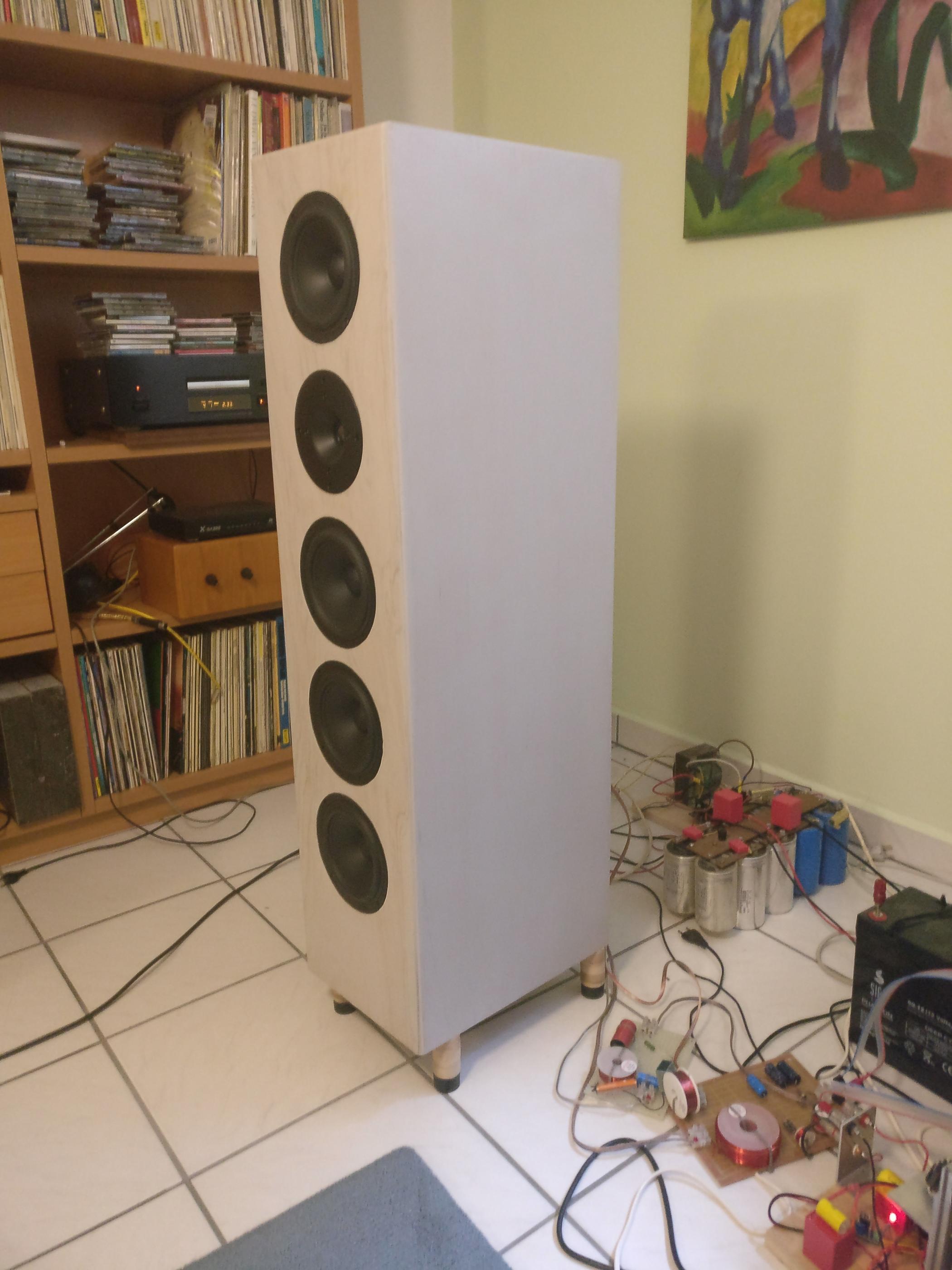

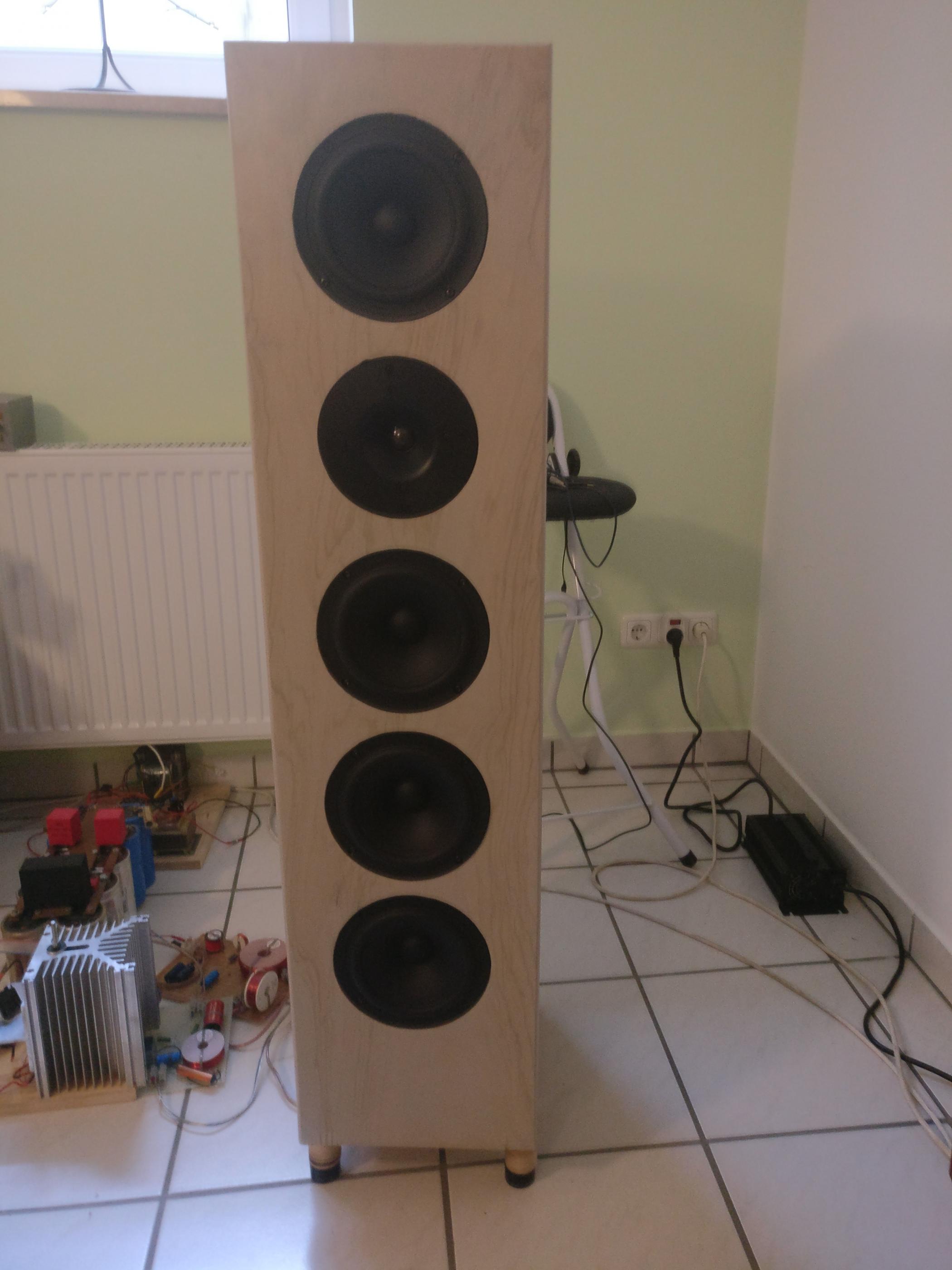

Helmut,
Thank you for sharing the pictures, and your speakers are looking good. If you have done most of the work, you should be proud with your achievement.
Smart decision of using what you had on hand; you can change the feet anytime if you want to. Now, enjoy! 🙂
Well, I am no carpenter, thats visible. So I am not excessively proud on my speakers. especially the feets need to be replaced, I used what I had on hand.
-feet do look bad, BUT they also lift the speaker up some which is often desirable. (..in fact if it were me I'd make a small stand for the loudspeakers that lift them up about twice as high as what you already have.)
The rest of the loudspeaker however looks really good. 🙂

I built with NRXC, in the crossover is no C5 nor a R4. I suppose, this are the optional part 6R8 and 0,47 µF?
Yes, you can add those, 6R8 and 0.47uF. They keep the impedance flat up to beyond 100KHz and even more importantly the current phase angle flat as well. Yes, they were considered 'optional' at the time, but for the sake of consistency, they are now included. They are not hard to add and to make them optional just confused people.
I have a current source amplifier here and that definitely needs it or else you will get a rising treble response. I published the design and if any Elsinore owners are able to make this amp, they are welcome to.
Link: Joe Rasmussen "Trans-Amp" - 40 Watt Transconductance "Current Amplifier"
WARNING: If you build this amplifier, only use with your Elsinores as they can damage normal speakers!
So the added two components forming that Zobel network is definitely required here and many tube amps have high output impedances and would be a good idea too.
What about solid-state amplifier? These usually behave as voltage sources and have very low output. Here there might still be an audible improvement by keeping the current phase angle flat and that could be good for the Class A to B transition.
Try it and let us know if you hear anything worth reporting? But it is now standard fixture in the three Parts Lists that I will shortly post here.
Cheers, Joe

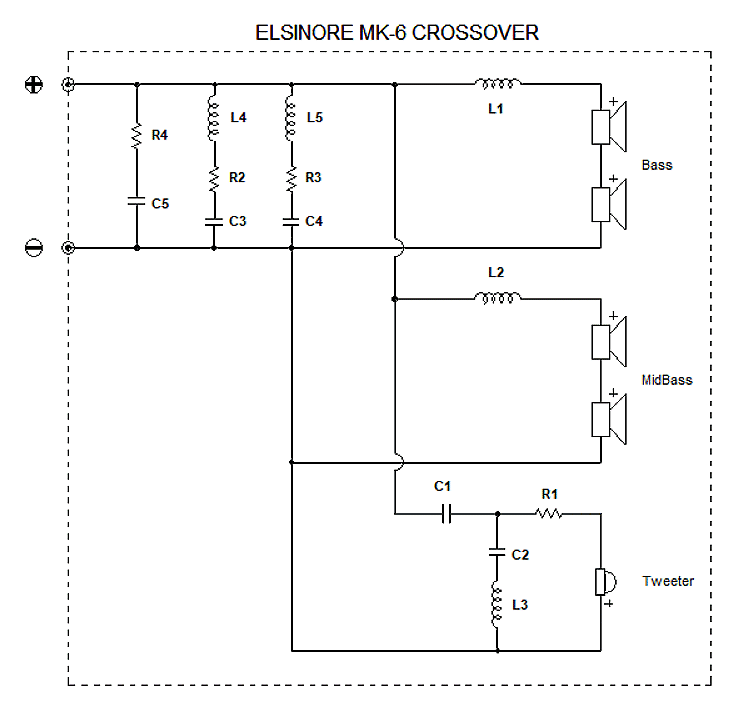

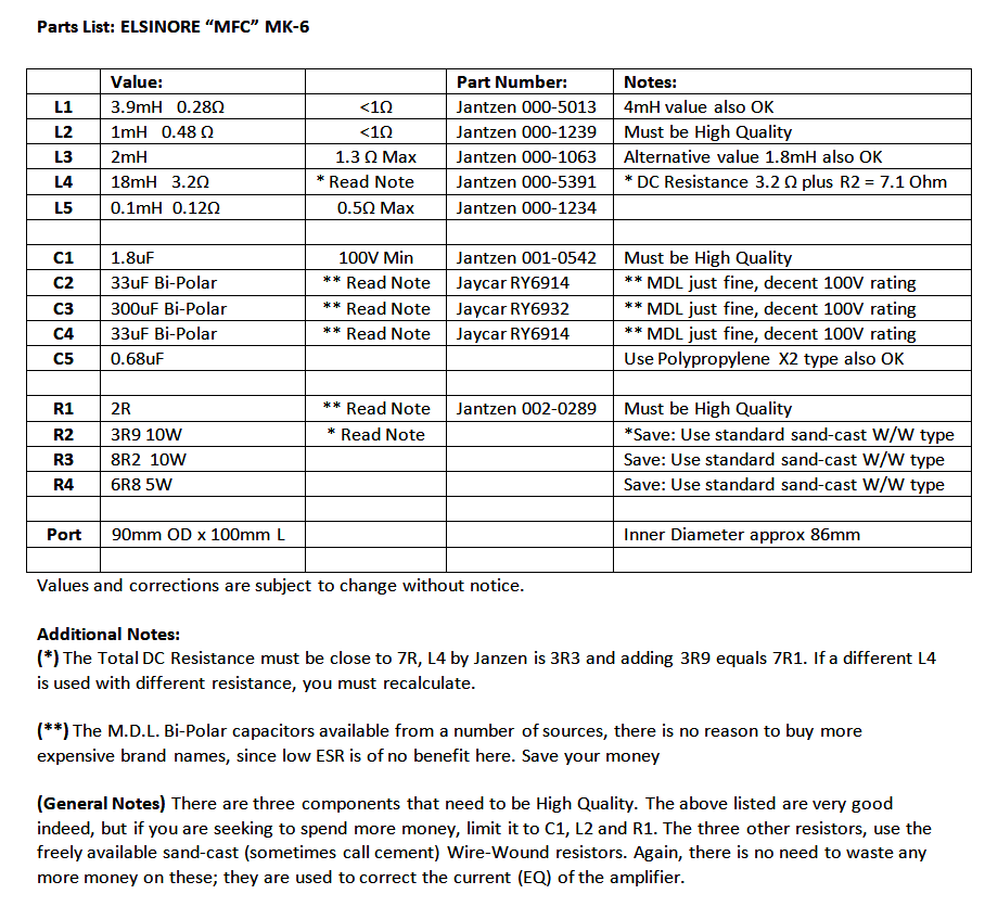

Crossover Layouts:
The two versions of Elsinores, MFC and NRXC, use the same layout, the Part Lists are a little different as will be shown.
EL-6 (MFC and NRXC):
Hamlet Mk-6 (MFC only):
