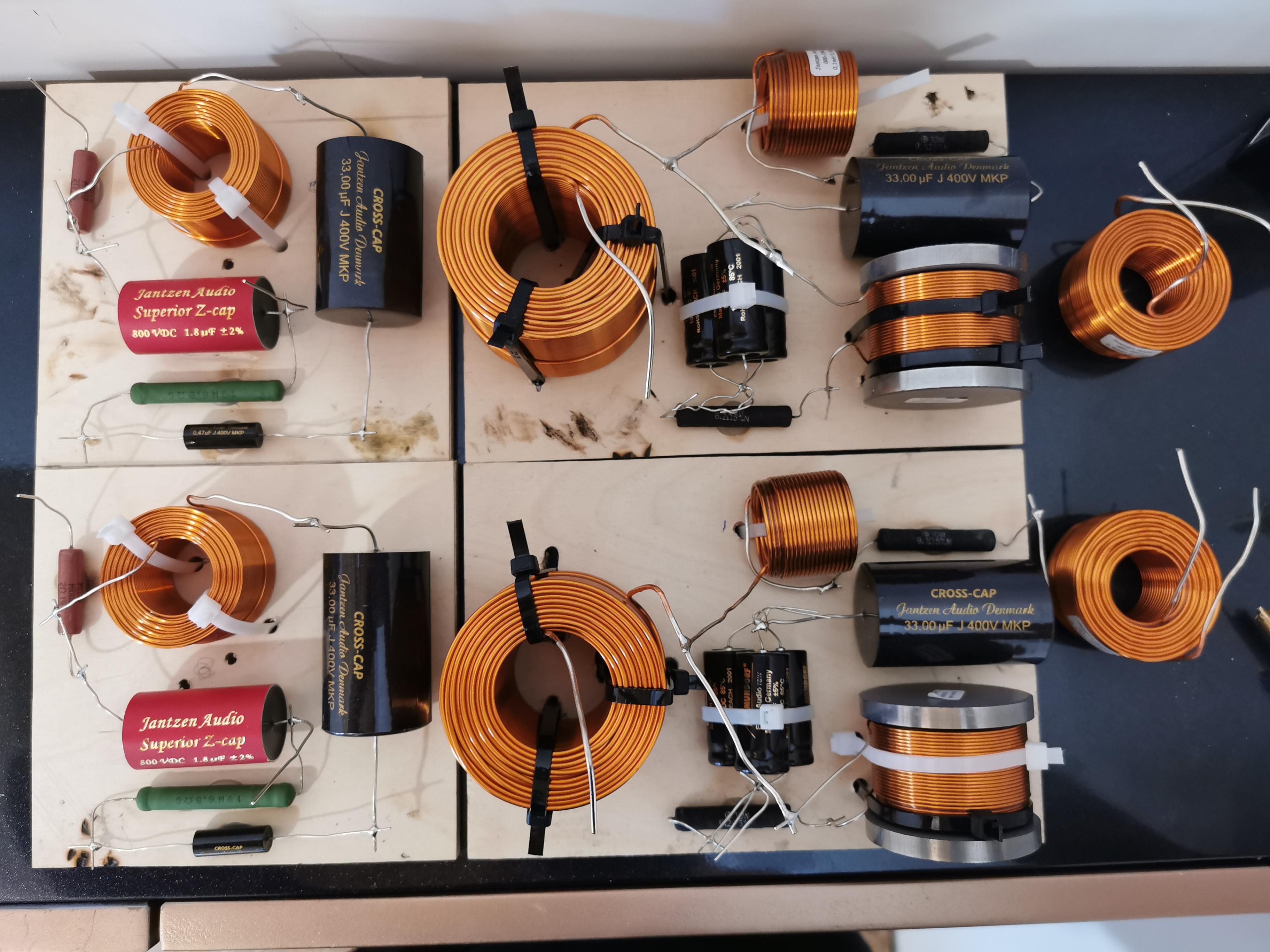

Interesting -- I'd be less inclined to use a crossover pcb if there was adequate room to spread the big coils out, but your pcb could be very beneficial in a more compact environment, such as the Hamlet.
That said, I'm a little surprised that a crossover pcb suitable for the Elsinore would also be appropriate for the Hamlet. You are a wizard.

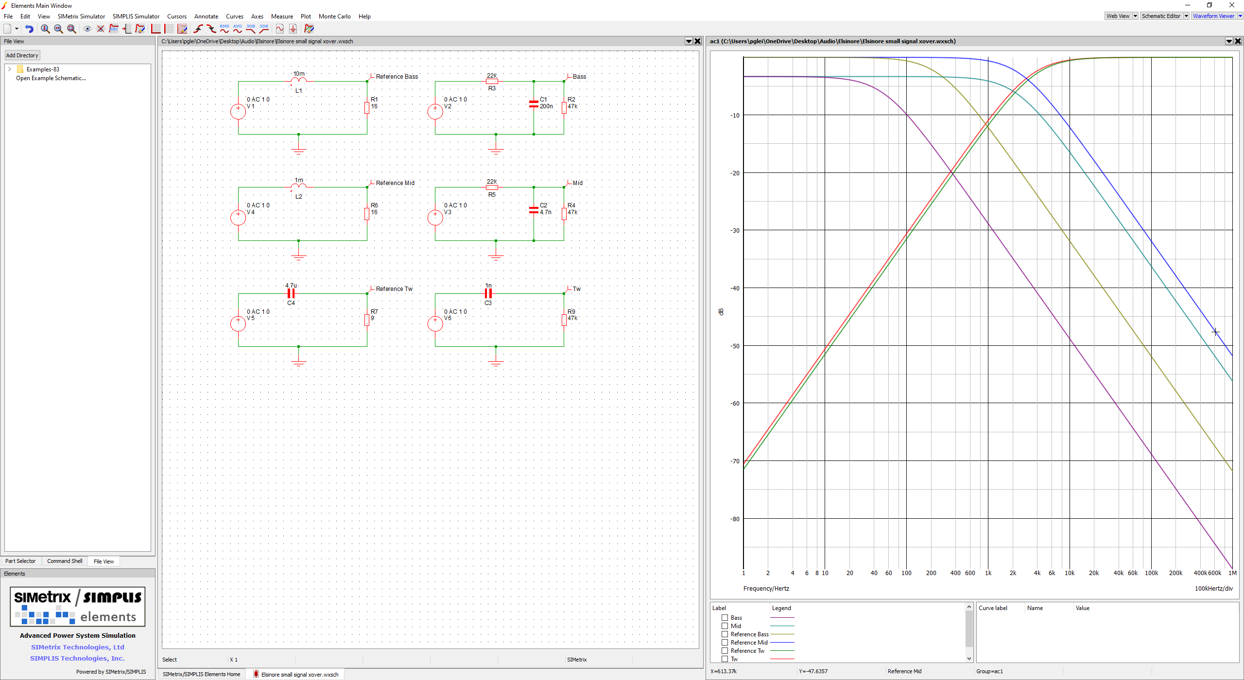

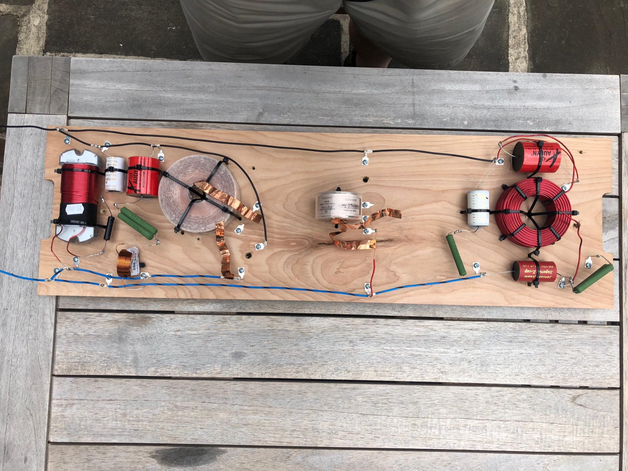

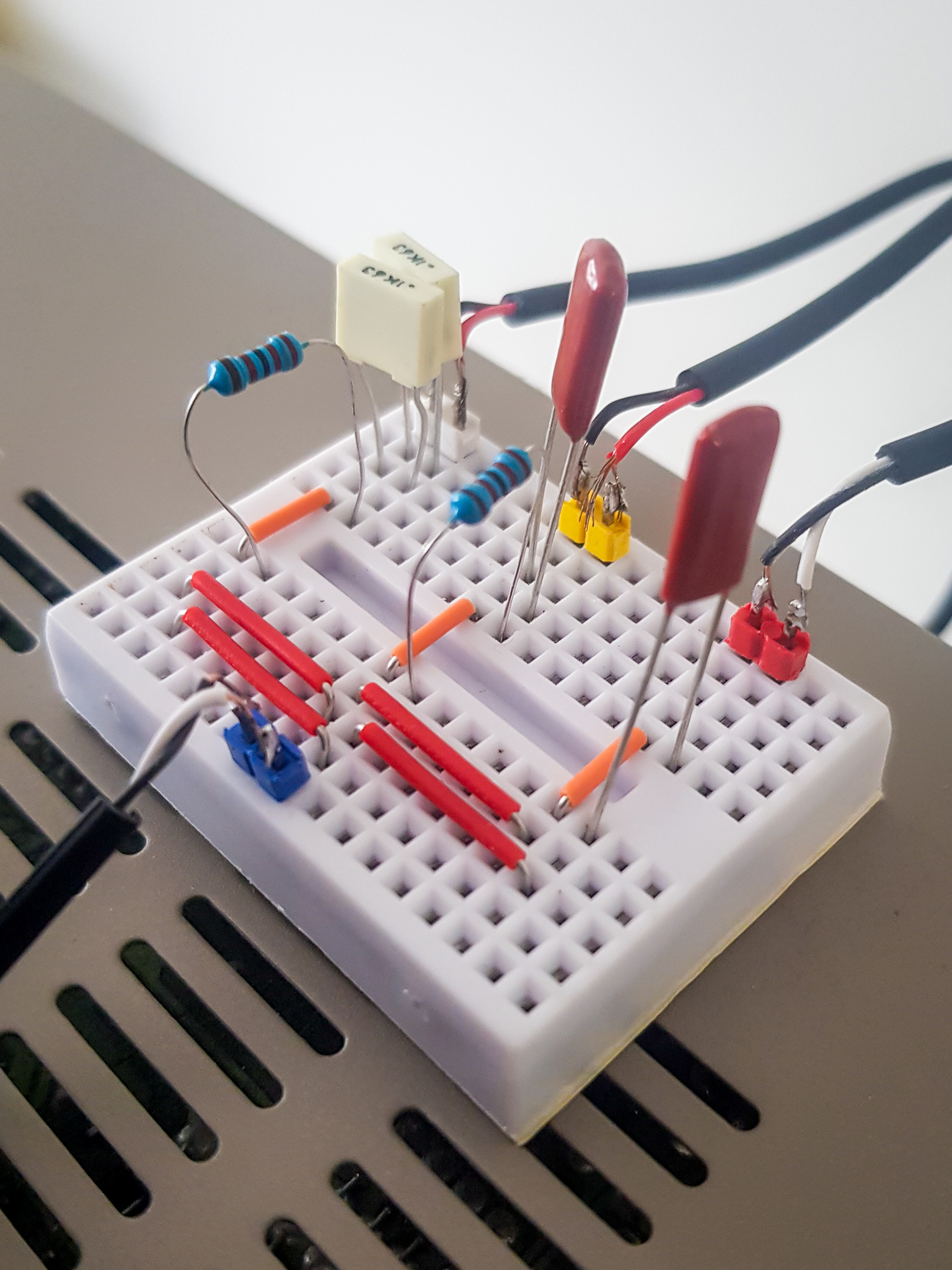

Pic of sketchy crossover attached.
It's there's one for each speaker running into separate Denon POA-F100 amps, which each have 3 channels. This allows the tweeters, top 2 drivers and lower 2 drivers to be on separate channels and thus alter the frequency response before amplification rather than after.
The amps were eBay finds and turned out to have slightly dead input op-amps. The origination (NJM074) chips seemed hard to get unless I want 50 or to trust eBay again, so went with what seemed an upgrade (TLE2074). They work so it'll do.
Have attached the schematic as analyzed in SiMetrix. It shows an experiment in rolling off the lower drivers earlier. Since then, the capacitance has been reduced to raise the cutoff. The stock response reverberates the room a little with the current speaker placement, hence the tinkering.
The input to all the mid range drivers has been reduced as I've wired them in parallel rather than series for a 4 ohm load for the amp stages (can't do this the the tweeter, so it remains ~8 there).
I do long for the day when I can build my dream valve amp and make the crossover as it should be. But this'll do for now. No measurements taken as yet (I do have kit), but have a good enough ear to iron out glaring things. Sufficiently pleasing to have lost a good number of hours sitting in front of them.

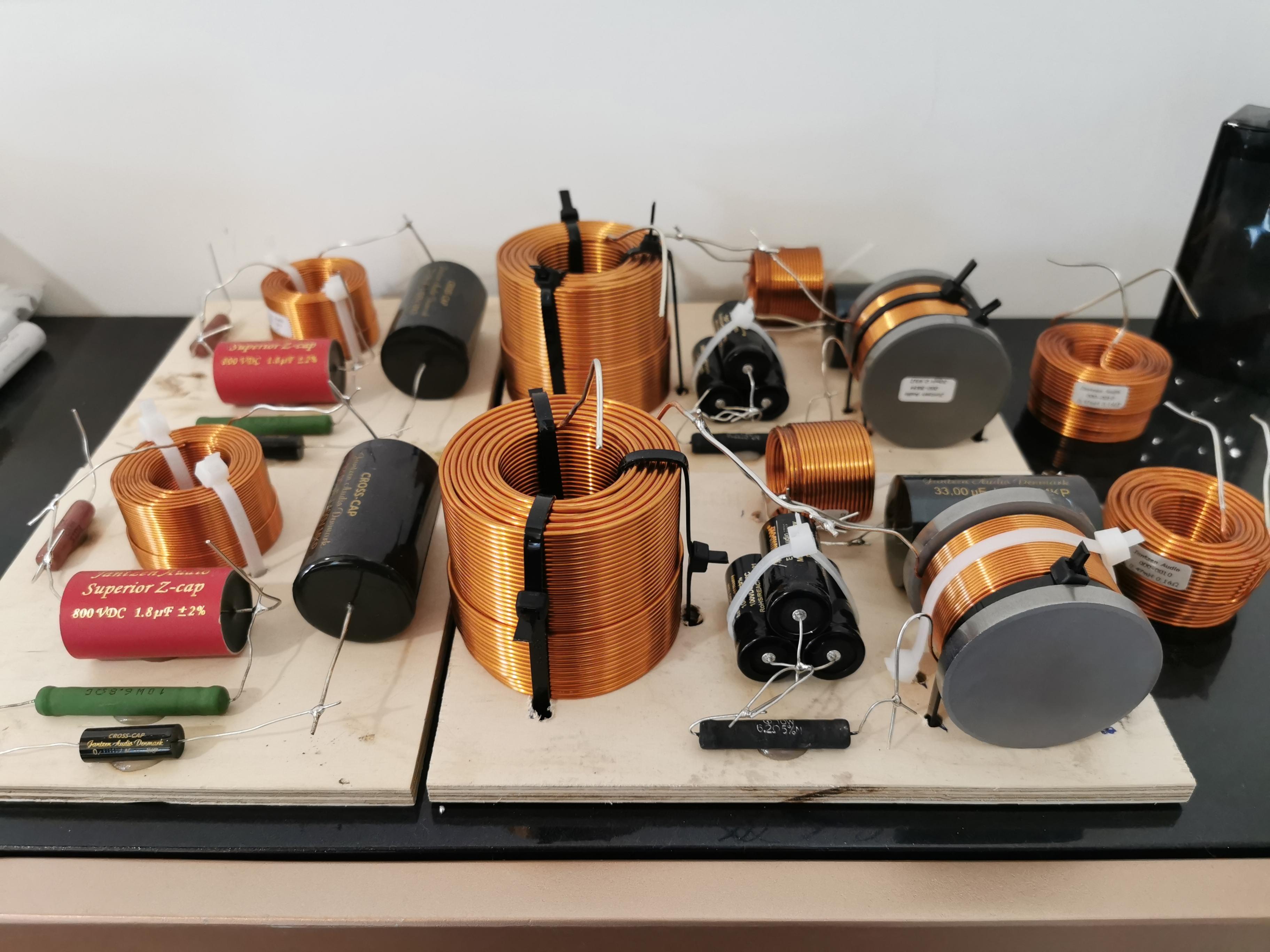

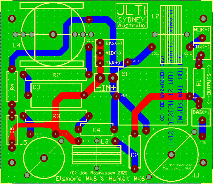

MAY 25, 2021 HAMLET UPDATE:
Both the computer modeling is nearly done and looking good as well as the PCB for the Crossover.
As mentioned earlier, see the below attachment, the PCB will be the same for both Crossovers, Elsinore and Hamlet.
The main difference is that "L1" is not used for Hamlet Mk6 which has 13 components where Elsinore Mk6 has 14.
IIt means the Hamlet Crossover will use the same parts designations as the Elsinore Mk6, the only difference will be the values, but even here some are the same, such as "C1" is 1.8uF for both, so is "L4" as 18mH and so on.
The Crossover is shown below. It may yet get a few tweaks before being ordered this week, but that is what it will look like.
I am also getting some 18mH "L14" inductors that have higher DC resistance and hence not so big and massive and more reasonable price. I am getting 30 of those, but I believe another 30 will also available from speakerbug.com.au for those in Australia.
The parts list will show all the Jantzen parts list numbers, like all the inductors, and info on sourcing, etc.
So we really are getting things very organiised and yet have some flexibility. 🙂

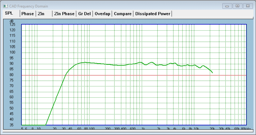

Very pleased with the modeling.

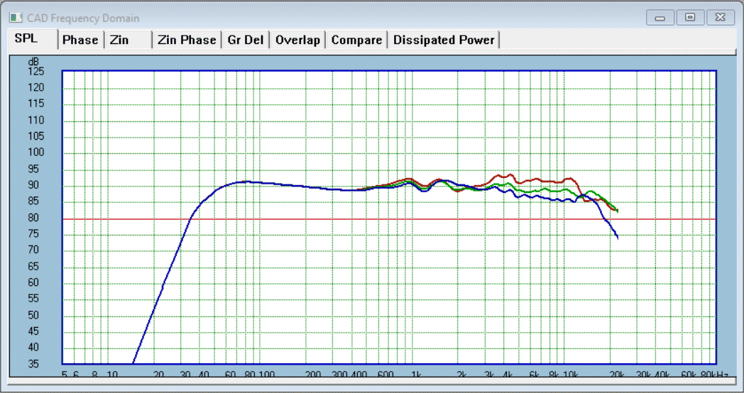

Below is the graphic with just a Green colour. This is 15 degrees Off Axis and hence 100-20 degree Off Axis is the ideal listening position, with the idea that angling in and out to control the brightness tonally. So toeing in increases brightness and toeing out the opposite.
This is demonstrated by the second graphic plot, where Red in On Axis (not recommended for listening), Green for 15 degrees Off Axis (recommended for listening)) and final Blue is 30 degrees Off Axis. This Blue plot approximates the Power Response and what I see here is very pleasing with a slope that looks just right.
Next is getting parts together and do the Crossover and then see how well the modeling has worked. Some final tweaking of the Crossover may need to be done, but in some cases in the past, if the modeling is spot on, there will be no further changes. But we shall see.

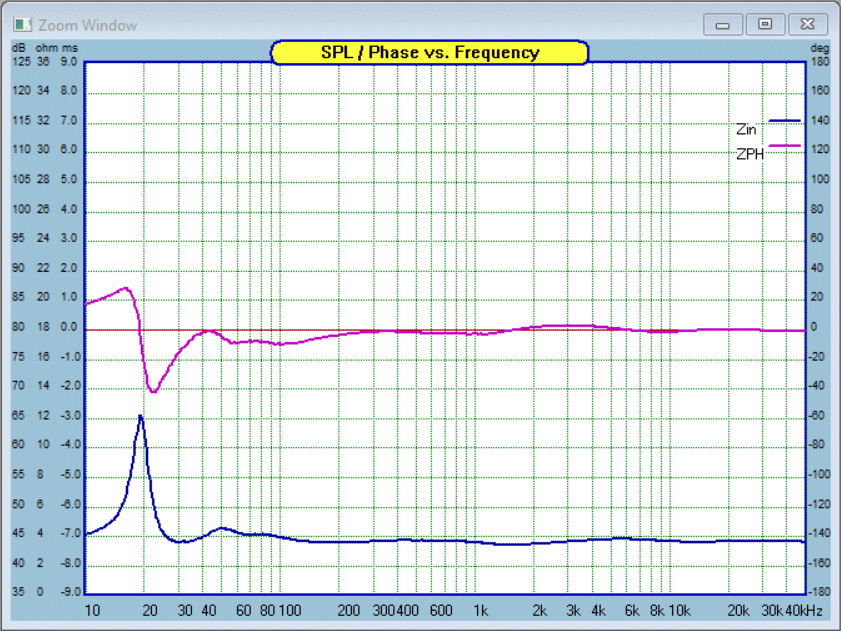

EDIT: Final graphic added, impedance and electrical phase angle. Flat impedance just under 4 Ohm and a very easy load for nearly every amplifier.

This measurement would seem to ignore the effects of lobing and if so may not be a good approximation for power.
I am old school and making a generic statement quoting Vance Dickason, that a quick approximation of the power response, look at the response 30 degrees off-axis. It is merely an indicator and also based on my experience. I meant no more than that. Lobing is not ignored, don't forget this is simply an update going from the HDS Nomex driver to the new SB17MFC35-8 driver and that the tweeter is the same, so I am not reinventing the wheel here. I have that crossover built already and now ready to make the changes to it, and all is in hand.
No, it's the measurement that I was saying that has in this case ignored lobing.
By the way, lobing is dependent on the crossover so if you change one....
Oh yes, it is indeed.
But that is why I mentioned that this is an adjustment of the design that was previously done and the same tweeter/waveguide combination. At the end of the design cycle, the final result will be checked via 1/6th Octave RTA measurements in-room.
But I assure you, it will check out OK. Note that the graphs I posted a few msgs back are not real measurements, they are the results of modeling after exhaustive pseudo-anechoic (time edited windowing editing out reflections and done outside) at 2M.
As you understand the technical aspects, the dB-SPL referenced to 1M/2..83V, but in reality 5.65V stimulus to compensate for 2M and hence nominally 4W instead of 1W.
These farfield measurements were coupled with nearfield measurements of the MidBass driver (less than 10cm) and rear port (1ocm) that are summed and merged into a single response and done 0 degrees, 15 degrees of-axis and finally 30 degrees of-axis.
So three models are made and changing the crossover to one, you need to change the other two, and so on. Because they share the same Z plots, when any changes to one crossover is made, then changing the other two, only the acoustic responses should change and you can use the system Z plot to make sure that it has not changed. That prevents potential error. It is a beautiful thing when it all comes together.
