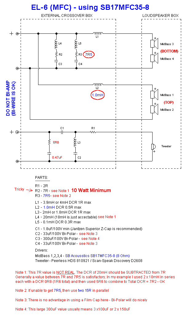

4) Reviewing my crossover layout, Im not sure if I made a mistake with my tweeter circuit. I figured I would never bi-amp and could alter later if I changed my mind.. That said I have only 1 input to the crossover (from the amp) and since my crossover is rather tall, had no concerns with cross talk between L3 and any other inductor so I ran a large (10 or 12 gauge) common through the crossover.. I have read since then that signals can run back through the wires (or something like that) and interfere with other things..
The attached pic shows how I laid out my crossover. I can fix reasonably easy, but would rather not tinker if there would be little to no benefit... Would anyone care to comment on my layout being an issue?

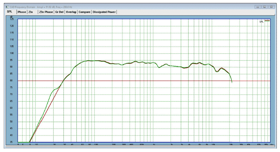

Since the tuning port subject is resurfacing, I had a question. I've been talking to a builder who really likes what he sees in the Els design. He did have some questions about the port tuning. His impression when running it through his program is that the port should be 100mm ID and about by about 200mm long to achieve the tuning goal. What is he missing? Is the tuning done by testing a completed speaker or by programming based on box size? Rookie question I know....just curious.
Since the tuning port subject is resurfacing, I had a question. I've been talking to a builder who really likes what he sees in the Els design. He did have some questions about the port tuning. His impression when running it through his program is that the port should be 100mm ID and about by about 200mm long to achieve the tuning goal... just curious.
I am not sure what he is meaning that the port ID should be 100mm and 200mm long? That would give you a tuning I would estimate around 28 Hertz and too low. Keep in mind that port ID 90mm, to get 28 Hertz tuning the port length would need to be:
28Hz: 100mm ID, 200mm L = Vent Mach 0.23
28Hz: 90mm ID, 150mm L = Vent Mach 0.30
Note that we don't need the vent to be so big, a smaller vent will also do, but the peak velocity will be higher in the 90mm ID versus 100mmID
But we want to be nearer 33 Hertz:
33Hz, 90mm ID, 91mm L = Vent Mach 0.26
Vent Mach estimate is based on 70 Watt peak. With lower power, it will be even lower, low is good. At 50 Watt it will be 0.22 and with the Elsinores, that will be VERY loud.
Generally, allowing for some minor variations that a 90mm OD PVC pipe, that 80-10mm will work fine. Perhaps choosing 90mm is not a bad choice/compromise.
The Elsinore alignment is fairly benign, especially compared to Butterworth. It is closer to a Bessel and hence it is quite tolerant, even to the output impedance of the amplifier. With current EQ applied, it is almost totally tolerant to almost any amp, whether solid-state or tube. Even a current source amplifier can be used, I have one here with a 270 Ohm output impedance.
See attachment below. There really is no such thing as damping factor here, but saying that can get you into a low of trouble.

This may be of help to others, it is well known that I use Jantzen Xover parts and I thought the following list could be useful. There are plenty of Jantzen parts suppliers out there, the following is from such one here in Australia SpeakerBug - this is the list below.
NOTE: This list is for the MFC version.
2 x Superior Z-Cap 1.8uF 001-0542 AUD $28.00 AUD $56.00
2 x P-Core 18mH 18AWG 000-5160 AUD $30.00 AUD $60.00
2 x Air-Core 1.8mH 21AWG 000-1466 AUD $10.00 AUD $20.00
2 x Air-Core 1mH 18AWG 000-1239 AUD $11.00 AUD $22.00
2 x P-Core 3.9mH 17AWG 000-5013 AUD $23.00 AUD $46.00
2 x Air-Core 0.1mH 18AWG 000-1234 AUD $5.50 AUD $11.00
They also have suitable 2R resistors, but they are not Jantzen:
2 x 5W MOX 2 Ohm 002-0289 AUD $1.50 10 AUD $3.00
Total: AUD $218.00
Additional Parts, this is from Jaycar Electronics:
4 x 33uF Bi-Polar @ AUD 3.65
6 x 100uF Bi-Polar @ AUD 7.65
There are some additional resistors, they are used in the current EQ parts, so use 10 Watt & 5 Watt minimum as per the Xover list below.
Standard Wirewound Resistors.
These are available pretty much anywhere and in the values you need.
Recommended: To get the 7R5 value, use 2 x 15R 5W Resistors in parallel.
The HF Zobel, use standard 6R8 5 Watt resistor, the recommended 0.47uF, use X2 polypropylene is recommended:
2 x 0.47uF/630V @AUD 4.30
X2 Class Polypropylene Capacitors

And a question.
I've seen a few speakers now that divide the tweeter from the bass/mid.
Why not do it as bass separated from the mid+tweeter ?

I've repaired a few speakers over the years.
Normally if they've been built as bi wire from the factory,
The two sets of terminals will be split to feed the bass section, or the mid + tweeter section.
Terminal one -> bass.
Terminal two -> mid + tweeter.
Lately I've seen newer speakers going the other way, like your diagram above.
Terminal one -> bass + mid.
Terminal two -> tweeter.
I was just wondering if there's a technical reason for doing it that way ?
If it was a bi amp system, you'd run a big amp for the bass, then a smaller amp for the mid/tweeter section.
Yes bi amp is different from bi wire. So thought I'd ask the question.
Is that any clearer ?
So it is a question whether to bi-wire or not?
You can bi-wire, but not a good idea to bi-amp. The current EQ, where the aim is to draw the same power at all frequencies and attain a near zero current phase angle of the amplifier, that does not work when bi-amping, but should still work when bi-wiring. The Xover 'split' does need to be done intelligently. 😀
