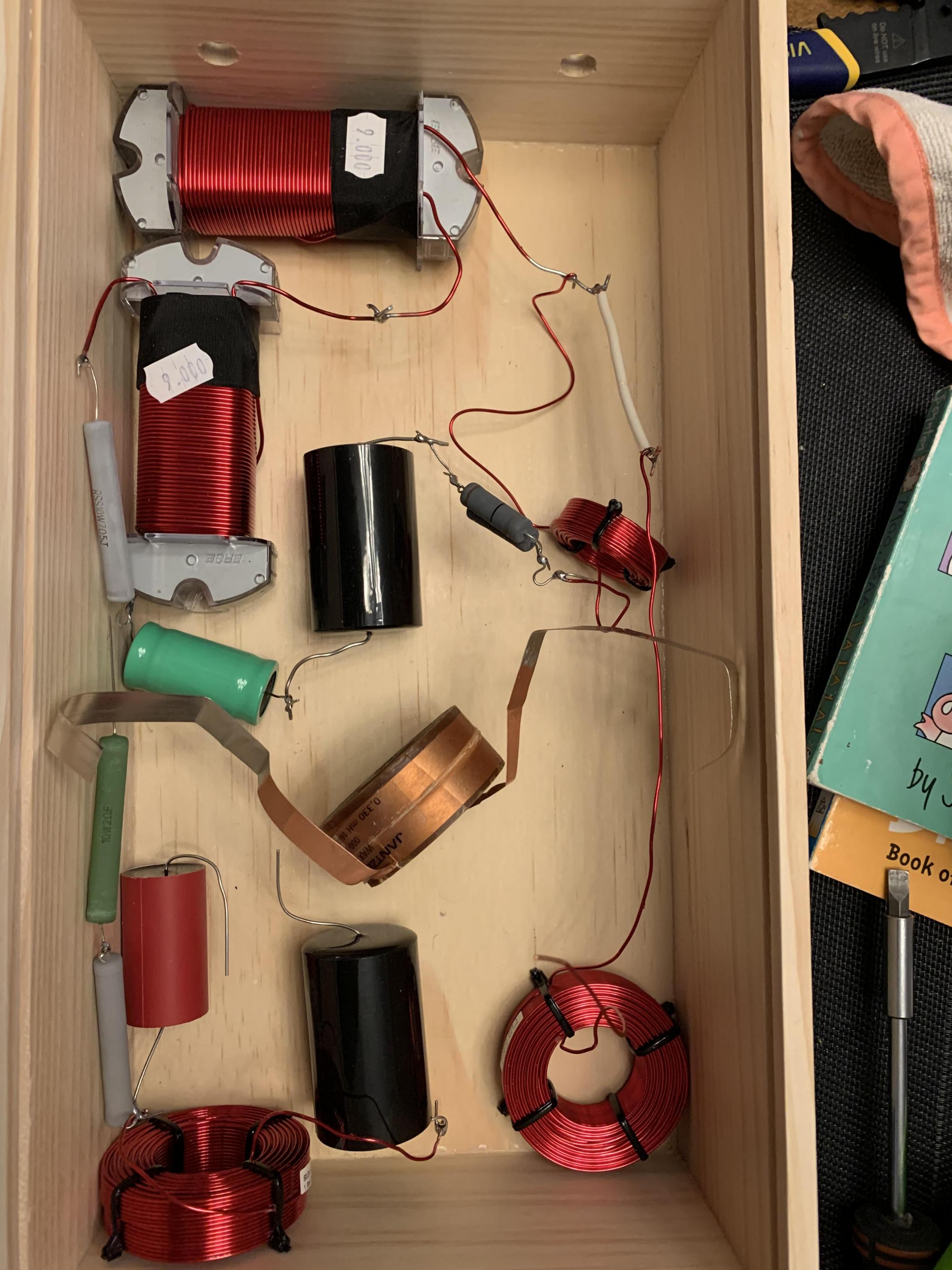

Hey - just putting together my crossovers for a Mark 5 build and trying to figure out a good inductor arrangement... Any comments or suggestions on the attached picture?
Also - my understanding is that Elsinores are not meant to be bi-amped, and therefore on the crossover box I should be able to place 1 set of binding posts with 3 wires to each crossover section from the same originating source?
Thanks a lot everyone,
Vic
