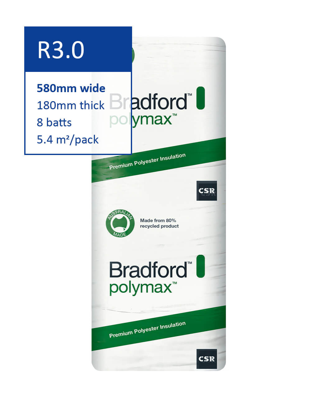

When I run out of the wool-blend I have here, I will likely use the Polymax polyester. It should work. In my soundroom I recently had to get the carpet replaced as it was twenty years old and it was a wool-blend. But you can't get that anymore, so I went for a slightly thicker underlay and only slighter thicker shag carpet... in the end I was very satisfied with the result. Yes, it was all polyester. So there you go.
See attachment below, it comes from this website:
R3.0 Bradford™ Polymax Thermal Ceiling Insulation Batts
It is also used in walls to insulate against sound, like you would in sound booths. I also notice it is made of 80% recycled product, a good thing in my book. It looks highly teased (very thin fibres) and that is the key to its thermal properties. After all, inside the speaker boxes this is designed to turn acoustic energy into heat.
Keep in mind that basically you want most of the rear of the cabinet behind the main brace to be filled, but not with too high density. In front of the main brace, you want to cut it into 25mm approx thickness and line the side and tops internally. It is not brain surgery to figure it out. What it does is make the box look more resistive than what it would normally a lined vented box. Measurements indicate that the internal 75 Litres volume now behaves more like 100-110 Litres, and this is the effect we are aiming at.
But keep sharing what you are using, local knowledge and all that. If you have built Elsinores successfully, then especially share.
Cheers, Joe

Polymax availability
Hi Joe,
You can buy Bradford Polymax (Product Code 126362) as a special order through Bunnings Warehouse too. It works out slightly cheaper than through the insulation supplier you mention.

Good to know. I will keep that in mind too.
Here is the PDF file:
https://www.bradfordinsulation.com.au/-/media/bradford/files/polymax-thermal-datasheet.pdf
Note the part that says: "Ingredients: Organic, long chain synthetic polymer"
