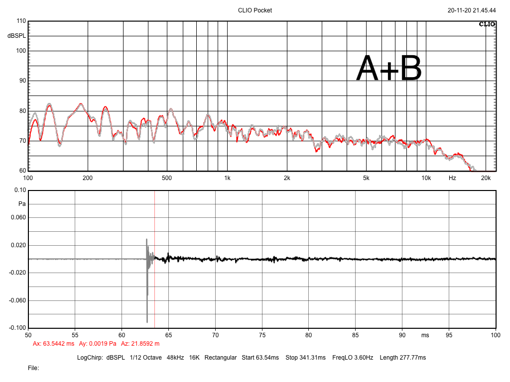

Yes. I am able to get some differences in the measurements. Are they audible? Despite what I wrote about earlier, I am not sure now. I will keep checking it. The very fact that I change something can have an impact on my judgment. My opinion is not enough.

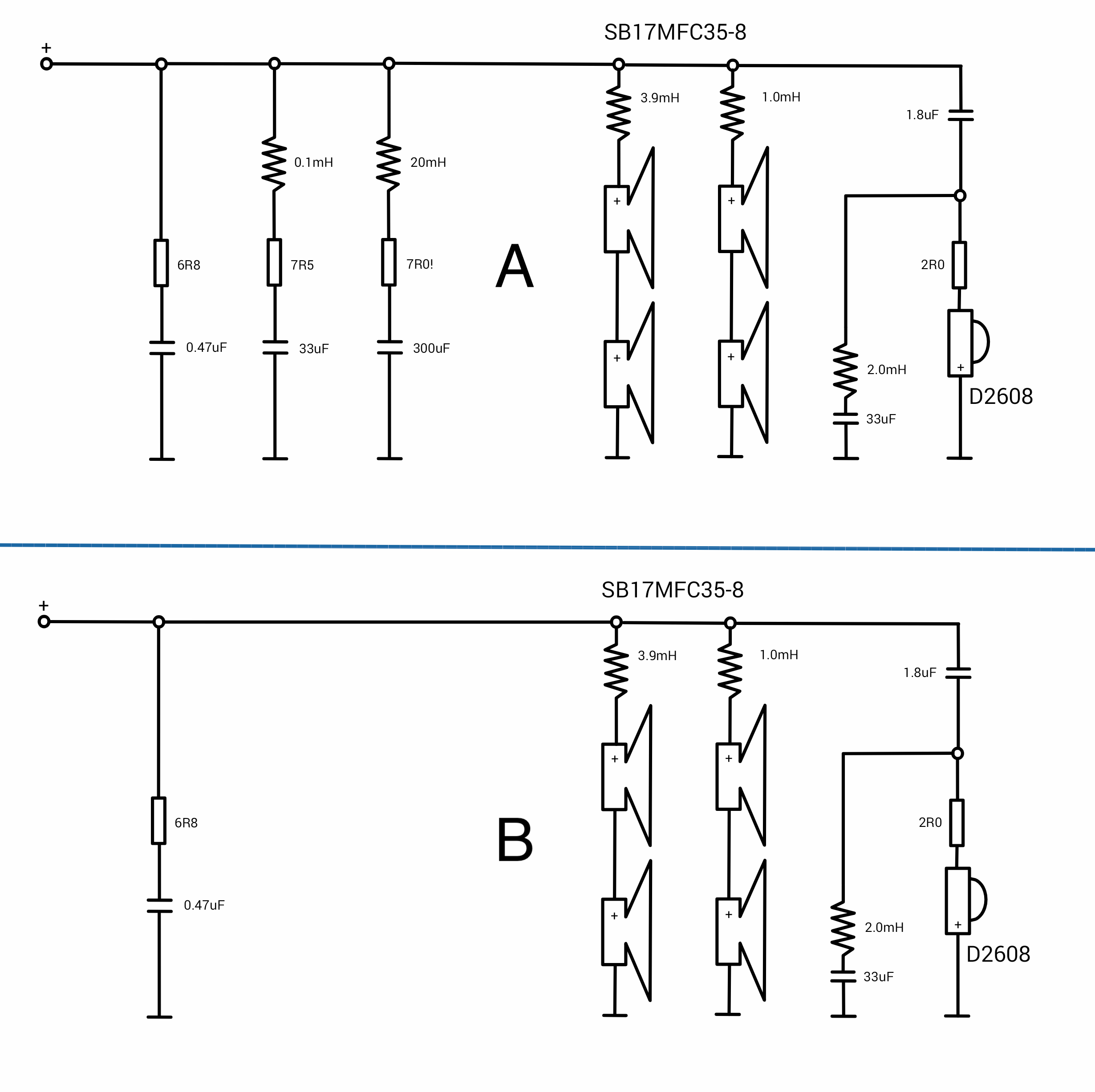

Crossover. A and B

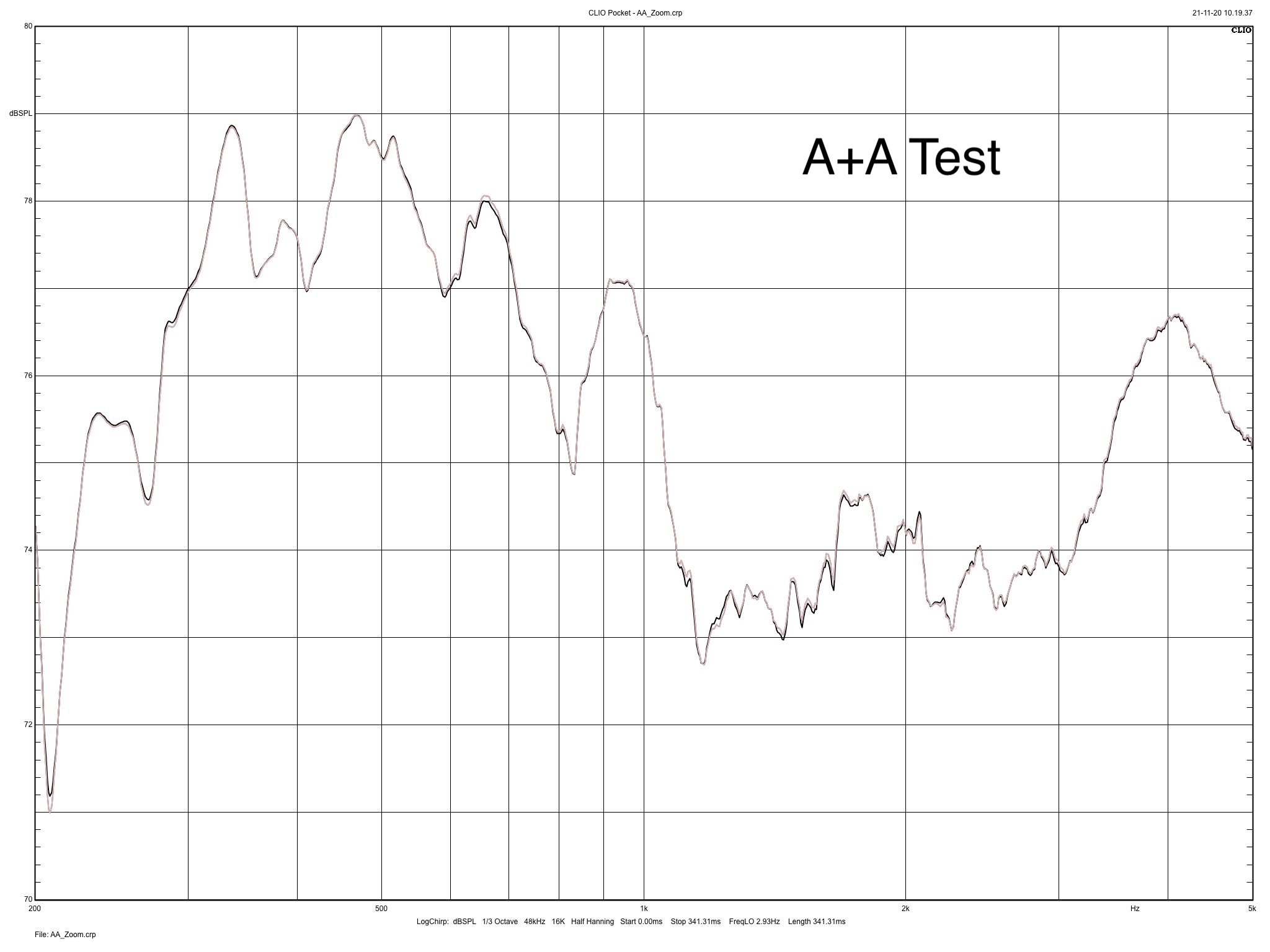

A + A Test. Enlarged. These are two measurements with the same settings. You can see the same waveform. Overlaps.

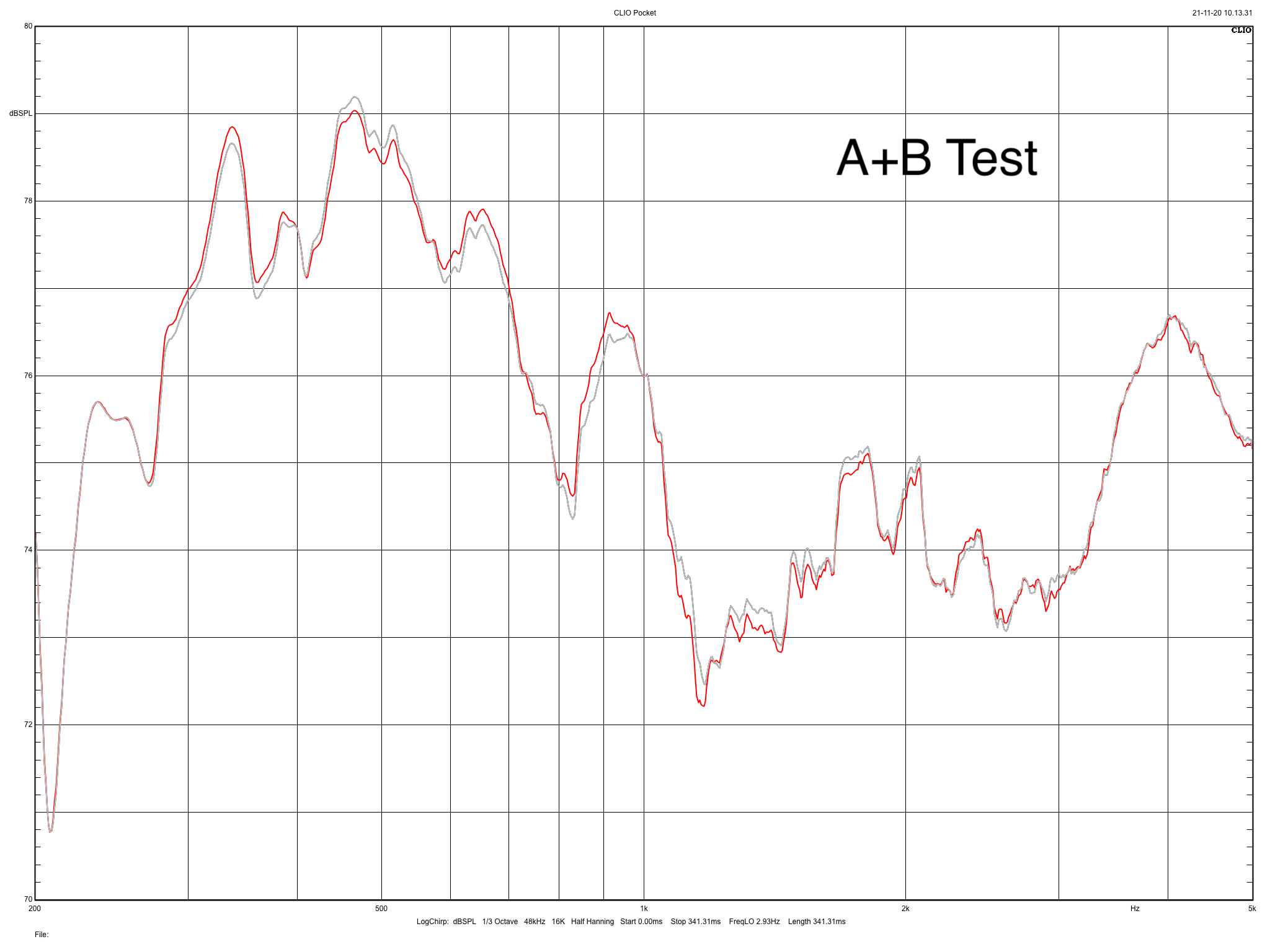

A + B Test. Enlarged. There is a difference.
A + B 100-20K. A wider range of.

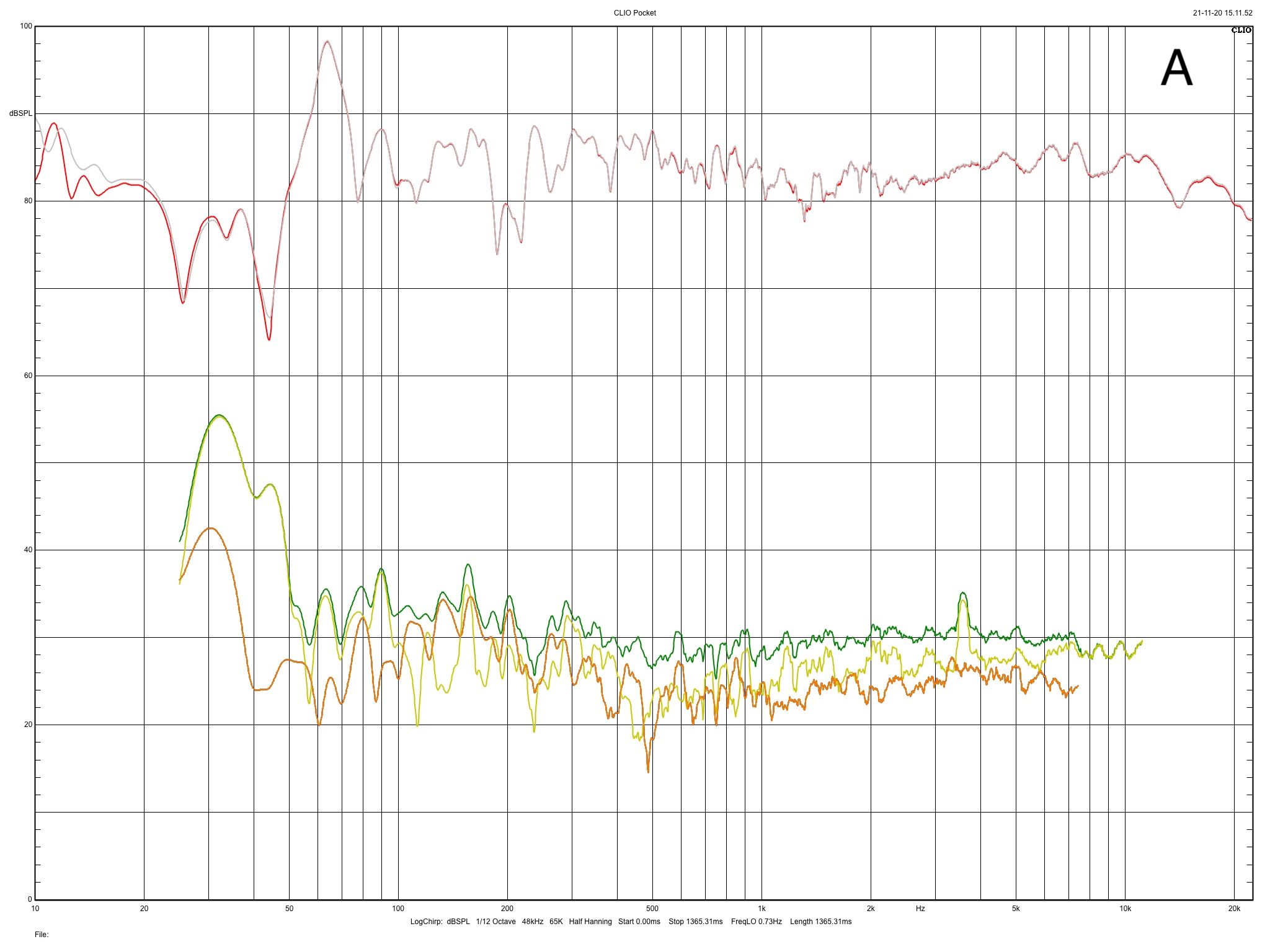

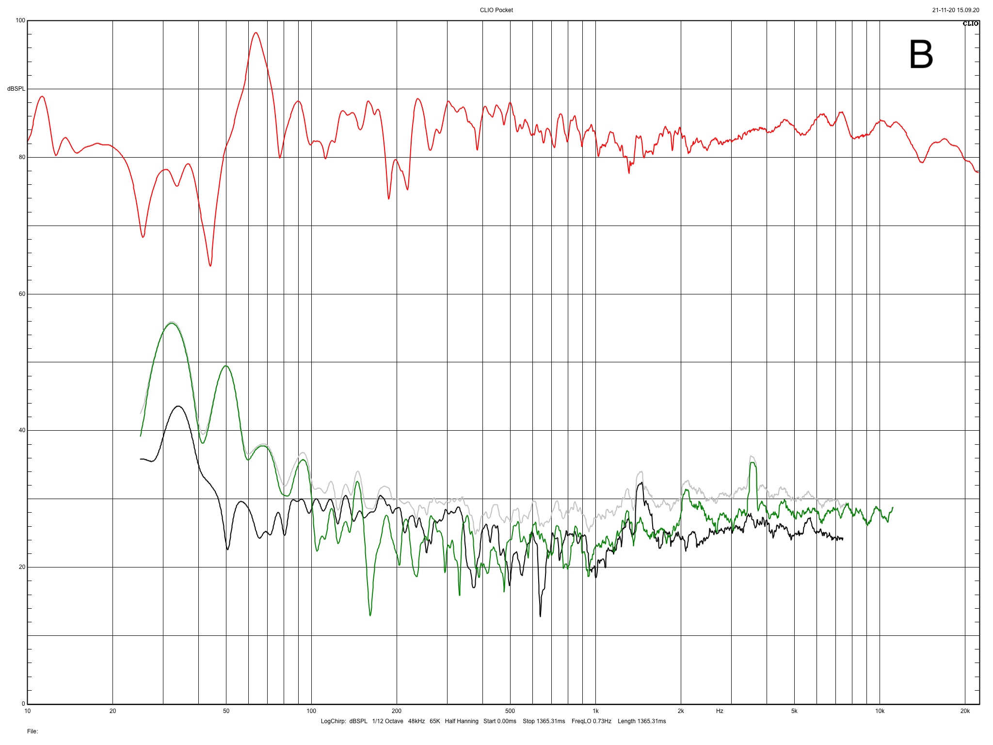

Edit. Oh. Measurement in a living room. 25m.
Hard to say. The differences are small and there is a bit if noise in the data. That said, half a dB difference over a wide frequency range can be very audible.
You could measure the electrical transfer function at the xover input. This should have much less noise and wiggles, and might be more conclusive.
Distortion measurements would be interesting, too.

Hold on... the current phase shift at the amplifier terminals!? Of course this will change if impedance compensation networks are added. But that is irrelevant, because the amplifier current is the sum of the currents passing through the xover/driver(s) and the compensation networks. However, the sound produced by the driver results from the current running through the voice coil(s) only, which is not changed in any way by adding impedance compensation networks.

...that holds as long as we can neglect the amplifier's output impedance (or resistance) into the equation.However, the sound produced by the driver results from the current running through the voice coil(s) only, which is not changed in any way by adding impedance compensation networks.
IF the amplifier's output resistance is somewhat a fraction of the load impedance, such RLC networks would mofify the amplifier's output voltage significantly and this will absolutely be audible.

With such an amp, there should be no influence adding these networks or removing them, unless...the amp feedback is not 100% on voltage but a mix (voltage+current) feedback. @JarBar: Do we know smthing about it?
