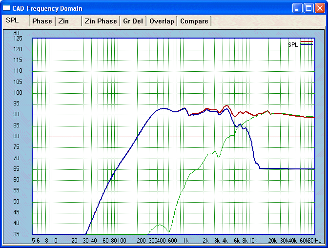

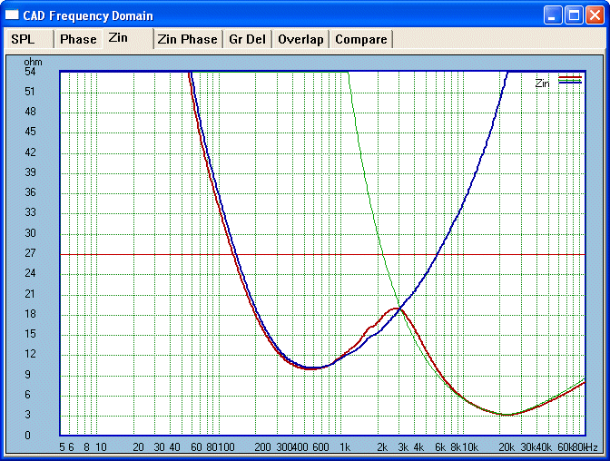

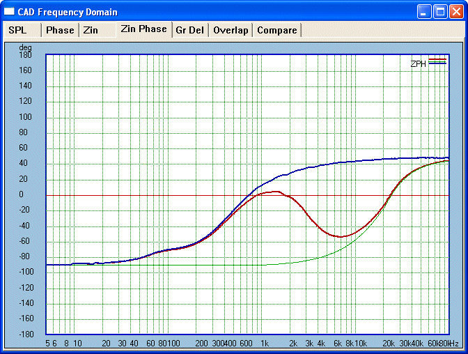

But if I may shift the topic to something that is still related and has also influenced me, but it is an issue that concern low order, specifically first. The above example I gave, with 10" Bass, 2 series connected 5" Mids plus Tweeter - 3-Way. The negative phase angle that is caused at and below the crossover frequencies is of particular concern. I shall try to expand on this.
I have to split this up and explain as I attach Gif files. So on to next post.
Please see attachment below.
This just set the picture to what follows. These are the family of responses but without the 10" Bass driver (it will cloud the argument). The mids are in series and on an open baffle. The Tweeter in the centre between the mids and it is minimum phase.
Blue midrange, it goes negative as it approaches the high pass frequency of the crossover, the Green tweeter does likewise. The combined plot shows both.
HIGH PASS 1ST ORDER FILTERS CREATIVE A MASSIVE PROBLEM - NEG PHASE ANGLES.
Much can be learned from studying those three sets of graphs, but it does illustrate that IF we do first order/minimum phase type of speakers, this is of particular concern. For this reason I would like to have the system Z at 8 Ohm rather than 4 Ohm - the higher Z can tolerate negative phase angles so common of low order speakers, and I am speaking as somebody who also does amplifier designs.
Now come back to the above same design, the tweeter in this case was an XT25. The system sensitivity is up around 91-92dB and the XT25 has no series resistance. The Z drops to 3 Ohm (I did not have the 8 Ohm Peerless HDS then) as the full output is needed, so only a series cap and a 500 Hz LCR trap.
Yet because of the high Z of the series mids I was able to jig things so as to make the system more amp friendly. The worst neg angle is at 6-7 Khz, yet the combined Z was high a 9 Ohm at the same freq.
(A similar picture also emerge at the lower crossover freq and its high pass filter causing the same type of problems. Crossing over to something nominally 16 Ohm mids likewise helped.)
Maybe now it is also more obvious, my enthusiasm for the 8 Ohm (nominal) Peerless HDS Tweeter. I sure could have used it here. In the Elsinores the negative phase angle is at 2KHz and is no more than -20 degrees combined with a system Z of 8-9. In the Mark 1 of the Elsinores using XT25 it was significantly worse, but even then I had to be careful and the series connection in the mids of the Elsinores helped remediate it a bit, but the HDS was much better still.
Hope I am painting a clear picture here, but for those doing sub 90dB sensitivity and high order crossovers don't have to deal with this and many who do 1st order speaker systems don't tackle it as deliberately as I do. At least that is my experience. And the dominace of 4 Ohm (many are 3 IMO) doesn't help much either, as you end up with little or zero Ohm series resistance.
But that HDS Tweeter, I love it. 🙂
So John, appreciate any comments you may have.

Joe Rasmussen said:Blue midrange, it goes negative as it approaches the high pass frequency of the crossover, the Green tweeter does likewise. The combined plot shows both.
All high pass filters have an impedanc ephase that goes to -90 degrees in the stop band.
Red = 1st, green = 2nd, blue = 3rd, purple = 4th. Fc = 500 Hz.
Note that the higher the order the more rapid the phase changes and it asymptotes to -90 more quickly.
Obviously the magnitude of the problem this creates will depend on the complete crossover design, not just the Z of the HP network. And the impact will depend on the amp used to drive the load. In any event, as you note, it's not really a problem unless the impedance is low as well.
I generally try to keep the impedance phase between +/- 30 degrees if possible, with an upper limit of +/-45. Still, I don't think impedance phase is a real problem because, for example, you could correct the phase, and make the impedance magnitrude of your speaker more uniform though the mid/tweeter x-o region by adding a conjugate network across the input terminals of the speaker as shown below. Red = with conjugate network, blue/purple = without. That's a plus regardless of amp type.
So this is really a problem resulting from the choice of tweeter. 😉
Cheers.
Joe R.

john k... said:
I generally try to keep the impedance phase between +/- 30 degrees if possible, with an upper limit of +/-45. Still, I don't think impedance phase is a real problem because, for example, you could correct the phase, and make the impedance magnitrude of your speaker more uniform though the mid/tweeter x-o region by adding a conjugate network...
Classic example you show. Let me comment on that.
I do use conjugates to help a flatter overall Z, being tube conscious, to reduce the amplitude response being modulated with tube amps that may be as high as 3 Ohm output Z.
But in my case, to suit my approach, I don't use conjugate networks in this instance when it comes to tweeters. Not that I am not saying that it may happen sometime in the future when a good reason might arise.
As your perfectly good example shows, conjugates lower/reduce the Z, they also do reduce neg phase because they draw positive current. The point I am making is that they add to the load and thus reduces Z. So the conjugate only really works beneficially when (if?) we have a high Z to play with and high Z and low phase angle coinciding at the same frequency is pretty OK already. The conjugate really neither helps nor make things worse, as I see it.
This is the rule I follow: It is where the two coincide, low Z (say four and lower) and significant neg phase angle (say well above -30) at the same frequency, this must be avoided (but conjugates are still an important tool). But coming back to the example where I used series 5" mids, it helps when they are a high 16 Ohm Z and you have that XT25 tweeter, that series element helped overcoming the XT25 by avoiding that coincidence. When phase was bad the combined Z was still above 8R. I could have use a conjugate but ended up with 4R? The improvement in the phase was offset, so no real gain. In other instances your suggestion would have to be considered.

Joe Rasmussen said:That is an interesting set of plots. I have a significant overlap and more than an octave below X freq (500 Hz in your above example). It is partly because I use 1st order and also use the lower passband of the tweeter to fill in the off axis of the midrange below the X freq. This is more likely to be in the 3-5KHz range, I aim to have the tweeter to contribute to as low as 1500 Hz in some cases. Add to the fact that I don't do Butterworth filter and I sum at -6dB rather than -3dB. This -60 degrees vs -45 degrees. So I am more exposed.
I really don't know how to reply. You comment was catagorically that 1st order high pass filters were bad because they have negative (impedance) phase. My reply was that all high pass filters have negative impedance phase. It is not unique to 1st order HP filters. And I don't think it's is an issue at all. What matters is the impedance (mag and phase) of the complete speaker. The amp isn't driving the tweeter network alone.
Well that is the point. Large negative phase with higher mag Z or lower mag Z with better phase. Which does the amp prefer? I think the beneficial aspect of one vs the other is dependent on the amp used, at least if it's a tube amp.But in my case, to suit my approach, I don't use conjugate networks in this instance when it comes to tweeters. Not that I am not saying that it may happen sometime in the future when a good reason might arise.
Well we agree that the phase isn't too important is the mag of Z is also high. But what does all this have to do with first oder HP filters? If you look at the different HP filter types you will find that actually 1st order is the least offensive. That is, if you look at the point where the phase is -60 degrees for various order HP filters, the 1st order filter has the highest impedance magnitude when thephase is -60.
As I say, I've made the problems for myself, but I stand by the results I've been consistently getting and also getting tube friendly speakers to boot.

john k... said:
I really don't know how to reply. You comment was categorically that 1st order high pass filters were bad because they have negative (impedance) phase. My reply was that all high pass filters have negative impedance phase. It is not unique to 1st order HP filters. And I don't think it's is an issue at all. What matters is the impedance (mag and phase) of the complete speaker. The amp isn't driving the tweeter network alone.
Fair enough, but I was trying to paint a scenario, high sensitivity, too many good tweeters that are usually low Z that gets fully exposed because of that etc. Under those circumstances - and maybe you have to be there to experience it. Perhaps my initial comment came across a little too sweeping?
