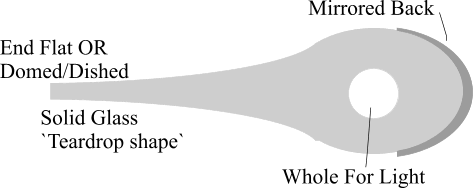

Me2! Would this shape work to focus the light, or would this again give multiple light images, cos this was the principle that I was thinking of. It would prolly be too expensive to produce, the heat may fracture etc, but it would look good if it worked. and yes I know I spelt Hole wrong!. The glass would `in theory` work as a light guide.

The same solid light guide has occured to me and probably everyone who has spent time trying to figure these things out. Basically a fat fiber optic idea. I dont know if it would work you would have to ask a physicist. It's a light guide. This falls into the realm of non-imaging optic theory which is a huge topic. Its study would take you far away from projectors.
Problems i see would be material purity, cost of manufacture.
anyone else got thoughts on this?
As I understand it, that teardrop shape would work well for concentrating a jet of liquid, but would not work for concentrating a beam of light. It's apparently impossible to concentrate a beam of light in that way.
Basically, you can't reduce the cross-section of a lightbeam without increasing its divergence-angle.
With that teardrop shape, we'd be trying to reduce the cross-section from the circumference of the lamp arc (white circle) to the smaller nozzle tip... ~5? times smaller (*)... , AND reducing the divergence angle from 360 degrees to the angle of the teardrop... ~20 times smaller? Apparently this is impossible.
Even as I write this, I think it must be possible. I mean, a bulb in a mirrored box with a small hole in it... all the light must eventually come out the hole, right???! I just tried it in a ray-tracer, and yes eventually all the light comes out (some after 100 reflections)...
Yet from what I've learned in theory:
- A beam of light from the sun has very small divergence angle. One can focus that beam's cross section to a very small area, using a lens... but, the divergence-angle will increase by at least the same factor.
OR
- A light bulb filament represents a small cross-section, but large divergence angle (it sends light in all directions). One can decrease the divergence angle, using a deep parabolic reflector... but, one will find the beam's cross-section has increased by at least the same amount.
OR (more obviously)
- One can decrease cross-section and divergence-angle, using an iris / aperature... but the lumens will decrease.
The basic principle is known as http://www.google.com/search?q="conservation+of+etendue"

Thats not the whole story. What you say seems true in standard optics theory.
When I thought up the same thing he drew I researched it for a few days before I gave up on it and there are 2 fields, one you have discussed (also see the Feynman Lectures for a good discussion of it) and the non-imaging optics field.
For more than twenty-five years, the University of Chicago Nonimaging Optics/Solar Energy Group has been developing novel concentrator designs and optical.elements that achieve performance thought to be impossible under the limitations of imaging optics.
http://hep.uchicago.edu/solar/NIoptics.html
This is a nice summary:
Imaging optical systems like lenses in microscopes and cameras redistribute light so that an entire pencil of rays originating from one point of the source meets again in one image point of the target. For illumination tasks the source is homogeneous, i.e. all points of the source are equivalent and it is unnecessary to distinguish among them. Therefore non-imaging optics require that all radiation from the source, which is intercepted by the optical system, is finally transferred to the desired target. Dropping the unnecessary correspondence between origin and target enables new degrees of freedom for designing illumination devices. Thus, methods of non-imaging optics lead to solutions for many problems that are impossible to solve with imaging systems.
I gave up on it for practical reasons -cost- not because its not viable.
