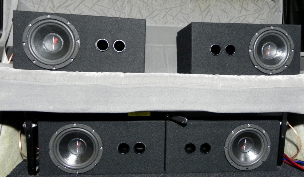

I'm trying to get a more precise understanding of how much of an affect a vehicle plays in figuring the bass response you'd get from an enclosure in it. Is there a general 'rule of thumb' of how much gain centered at what frequency can be expected? I would imagine it would be different in a small car vs a truck with woofers in the bed with a connected camper shell. Anyone have any data/experience with this. Its awesome when it works in your favor but its a PIA when it works against you.

In a large vehicle interior location is key. I can tell you that sub placement in a van is more critical than I thought. I have two 15" subwoofers in a 4.5 cf enclosure @800 watts per and assumed that at this power level it really wouldn't make much difference where they were placed. I was wrong, its actually very much the same as dialing in the perfect sub location in a typical room in your house.
Placed in the center of the van, I get almost nothing out of them. Might as well have two 10's @100 watts because thats what they sound like in that location. Did some research and the consensus was that subs only work efficiently in a large empty van when placed at the rear, within one foot of a wall.
This is because a 40hz tone has a wavelength of 28 feet. The average compact car has a (roughly) 12 foot long by 3 foot tall interior if we include the trunk. A small vehicle like that exhibits greater cabin gain. Frequencies below approx 80 - 90hz in this space will have greater amplitude due to cabin gain aka transfer function. 12db gain per octave is the number I've read and that seems about right based on what I've seen on my various installs.
Moving the subs to the rear in my van results in >12db gain at all frequencies under 90hz measured with my old cheap Realistic SPL meter. Frequencies under 40hz gain closer to 15db.
I can fire them at the back doors from about one foot away or fire them upwards with box placed as far back as it goes. Either orientation produces the same db levels but firing backwards is louder outside the van vs. upwards which produces slightly cleaner/tighter bass.

I definitely can confirm your statement. Like you, I'm using quite a bit of hardware regarding the sub-woofer system in my suv; 4) JL 10's (partitioned) in a 3.5 cf sealed box and two JL HD-750 mono-blocks... 2-10's per amp. I have the box anchored (strapped) directly behind the second row seat, dead center; two drivers face the back, and two face upwards: http://www.diyaudio.com/forums/attachment.php?attachmentid=405771&stc=1&d=1394765072
One day just out of curiosity, I moved the box to the left rear corner hoping to capitalize on some "corner load" gain, as well as some extra space in the cargo area. To my surprise, not only did I lose some low-end with this experiment, I lost an AUDIBLE TON of of sub-bass from the system! I couldn't believe how drastically just moving the box a couple of inches affected the sound; it was like (no exaggeration) losing three of the four 10's, or 10db's of cabin gain, that's HUGE!
Needless to say, I quickly moved everything back to the way it was... "before my brainstorm!"

I would have assumed the same as you since corner loading a subwoofer is usually is good for at least 3db gain. But the bigger the interior volume, the trickier the speaker placement seems to be. The interior volume of my van is 280 cubic feet. Really, the only typical "car stereo trick" I've been able to use in this install is mounting tweeters in dash and bouncing high frequencies off the windshield. Everything else I know about car stereo speaker installation just doesn't seem to work the same way in this van. If your SUV is fairly big I would assume you are facing similar challenges.
I have my two 15" subwoofers all the way back against the rear doors as I've described, then over the rear axle I have a bank of four 8" mid-bass support in individual custom enclosures firing forward. I designed them using an online speaker enclosure calculator over the winter and just finished building/carpeting them.
Interesting part - and pertinent to this thread topic - is that the mid-bass speakers sound best in the center of van.
I intend to add two (or maybe four) more but first I need to build two 5 cubic foot boxes for my subs so thats my next project. They aren't performing at their optimal level in the pre-built (Atrend B-box). Bbox's aren't terrible, they are good enough to run tests with and perfect for temporary installs. But in the end I feel its always worth whatever time and effort it takes to design and build a box that properly matches your drivers, whatever they may be.

Jon Whitledge (whitledgedesigns.com) did an excellent job on examining low frequency reproduction in a large (Sprinter van) vehicle interior using a scientific methodology.
Best and easiest way to figure out a good placement is to put the bass-enclosure (Box) on your driverseat and find a spot by your ears where the best response is. Than just change location. 😀
