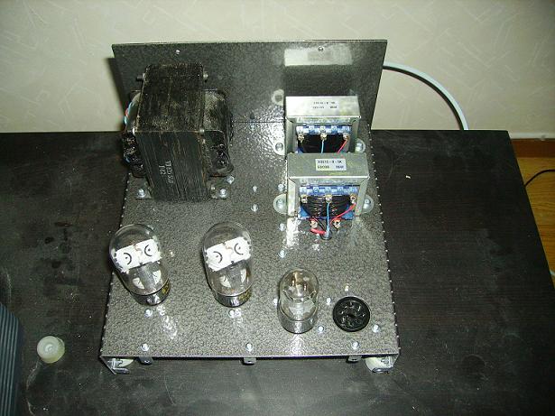

I forgot to drill holes for the plate and grid connectors to the 7193 input tubes before I painted the chassis, so guess what: I changed my mind one more time!
Instead of two 7193s I used a single 6SN7 and left the other octal socket unused.
The amp is almost finished by now and I listened to it a couple of minutes ago, except for a (quiet) hissing sound there is nothing to complain about. No audiable hum.
For the moment I run the output tubes fairly cool, about 270V plate to cathode and 50mA. The original plan was to push them a bit harder (300V 60mA) but I got nervous and installed cathode bias resistors (390R + 1000uF) to drop some voltage and get a mixed bias arrangment. I will increase the plate current later on.
The next step is to finish the chassis to make it cat-safe, then I will take a closer look at that hissing sound and start playing around with different bias points.

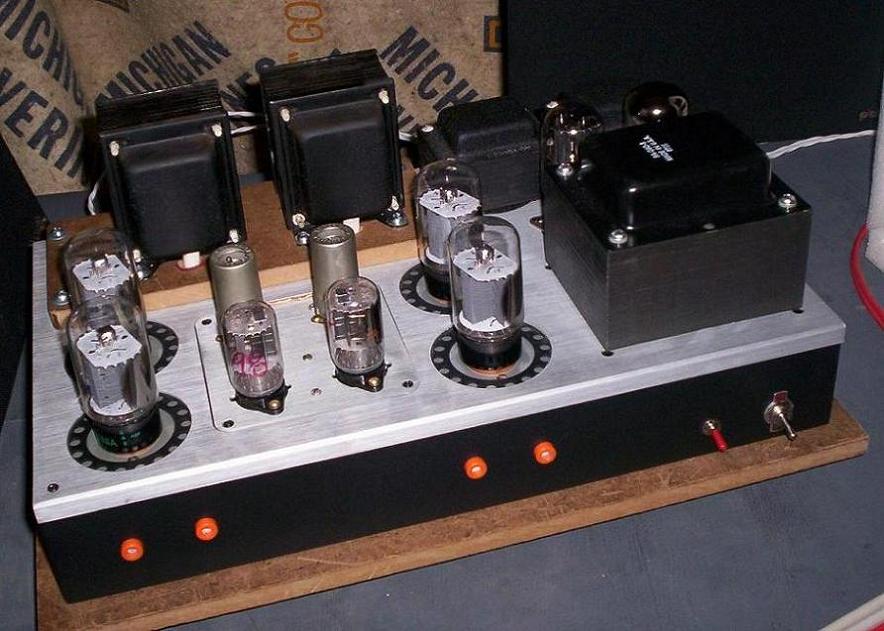

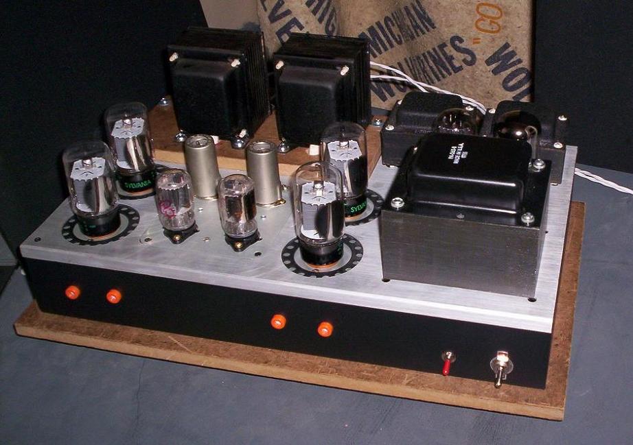

Hey JAY!
Interesting meeting you over here, I'll get with yu soon!
Anyway I had been contemplating building a 6AV5 amp for a while now, finally did it!
These tubes are very nice, (thanks for all your hard work Tubelab) mine sounds great!
Got a few cosmetic things to finish, like routing/painting the base and output trannie board.
Here's a couple pic's if anyone is interested. 🙂

Dude! I thought you fell in lake MI or something. How's everything going? What are your impressions of the sweep amp? How about a peek at the circuit?😉
amp lodown
Jay
I'm at work and don't have a copy of the circuit,
Shoot me an email and I'll send it to yu from home.
It's nothing to Fancy, at the moment no solid state parts and no Global Fbk.
The driver is the beefy/low mu triode of the 6FM7/6FJ7/6FY7 compactron tubes.
The Phase splitter is an Schmidt type LTP using the 6bk7/6bq7/6bz7 type tubes.
As of now I'm cathode biased using 2 resistors in series with the larger one
on the bottom cap bipassed and top smaller not, creating a bit of cathode fbk.
The red switch on the front turns on or off the cap bipass on the driver tube.
300v supply, Choke input running LC,LC to the Outputs then an old ST-70 choke
feeding the front end from there then RC for each triode section, it's a pair
of 5V4 rectifiers wired in paralell for the dc.
Plate to cathode voltage is about 250v (I'll convert to fixed bias later) and
52ma per tube, the outputs are from a Sansui 1000A at I believe about 6k P - P.
(Outputs are wired in triode, no ul taps on the Sansui trannies)
The output tubes are running fairly mild (I have plenty of the Sylvania's) but
it sounds wonderful, full spectrum from top to bottom powering some polk 10B's. (New Polk Tweet)
(Tried the amp on a few other sets of speakers and works just fine there as well)
I'm sure there's still some tweeking to be done, but it's rock solid and very quiet.
Overall I'm very happy with the way it turned out.
Later,
Jay
