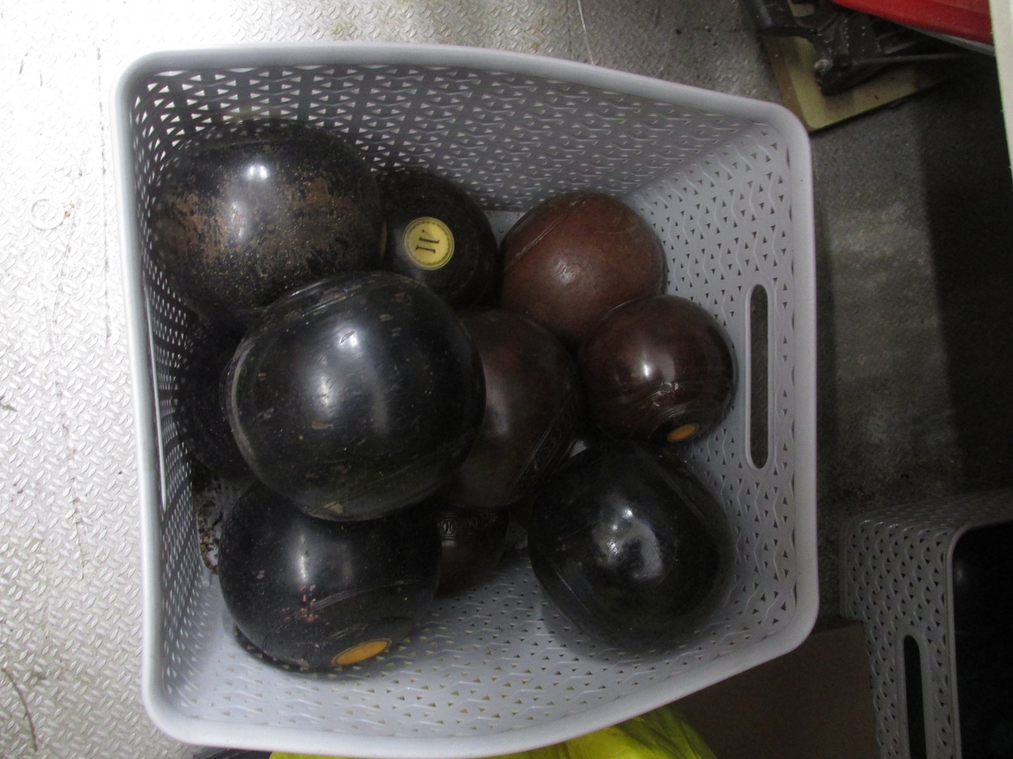

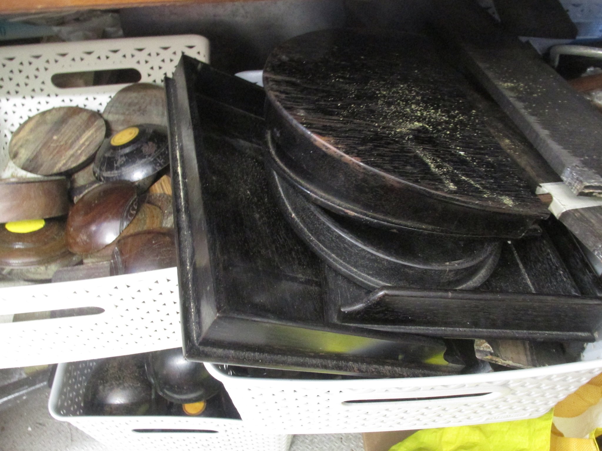

90% of the hard woods that I use are upcycled from damaged and discarded antiques and in the case of lignum Vitae mainly old bowling balls, the very fact that these materials are old with many years of use mean that all the stresses have long dissapated them selves which make these materials so suitable for my use.
On the few occasions that I have had to resort to buying hardwoods from timber suppliers, I have used certified suppliers of at least fourty year old stock.

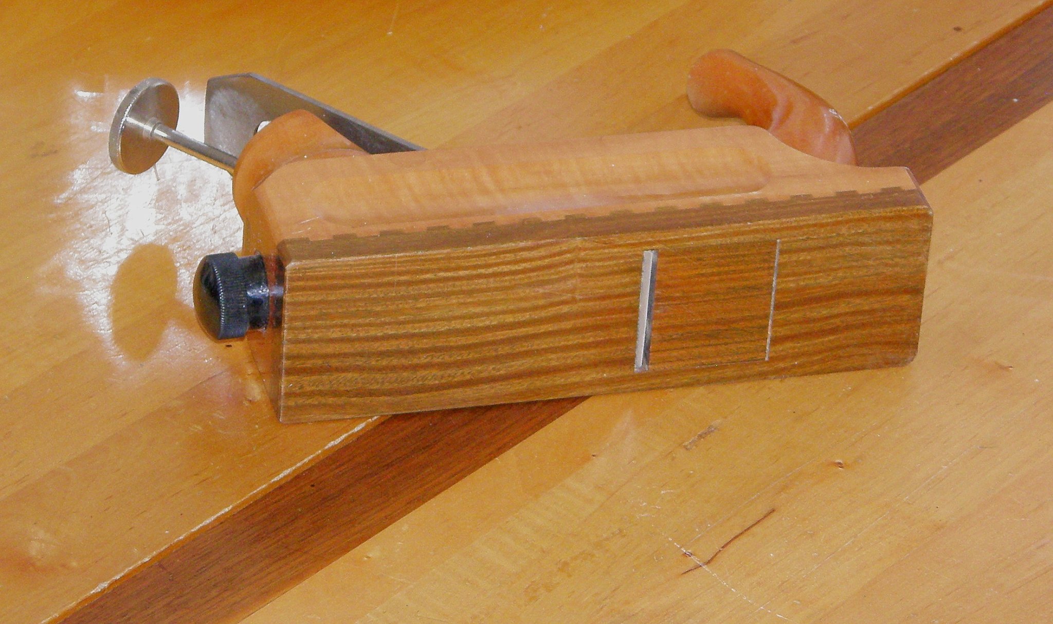

Engineered wood, known by it's commercial name Permali® is a suitable alternative to lignum vitae. It is made from European beech wood that is scientifically farmed . It has cross grain structure and a high density of 1.3gm/cm³ . I have already developed components such as stacking platters , damping ring for Lenco platters , turntable plinths etc.
Permali® was originally a British brand, but since the late nineties ithe ownership transferred to an Indian business who were already manufacturing it since 1960 under agreement with the original British company.

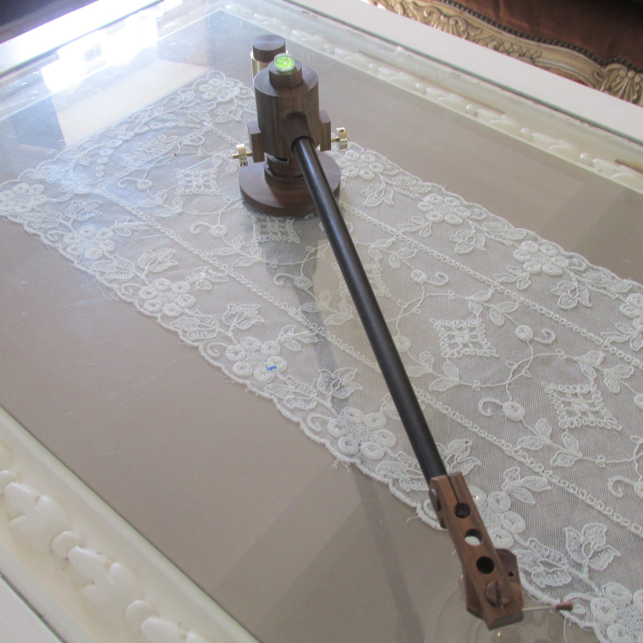

Hi again I found no shielding issues with the Ebony Warrior, it was a concern but once I had the prototype up and running I found it was not a problem.
I hope that the next arm is the same.
I am a full time carer so it is hard to find as much time in the work shop as I would like. May be a few hours over the weekend.
For now thank you all for your interest.

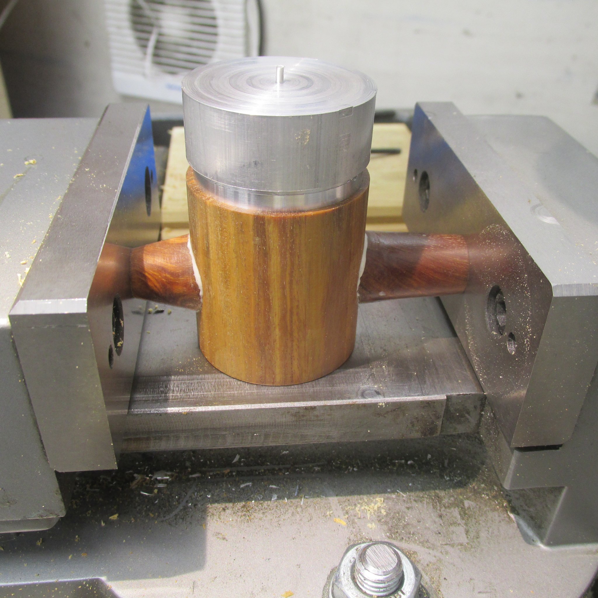

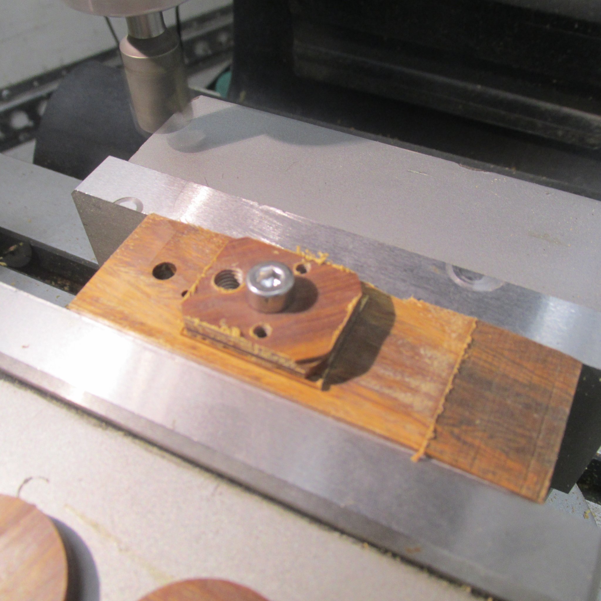

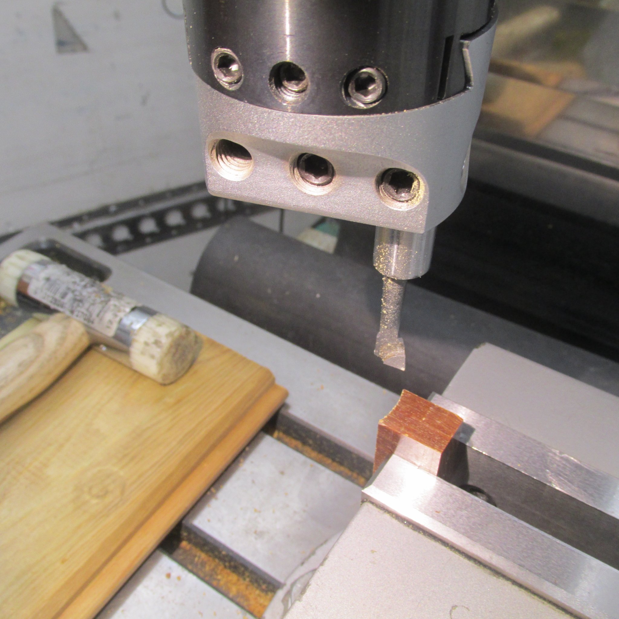

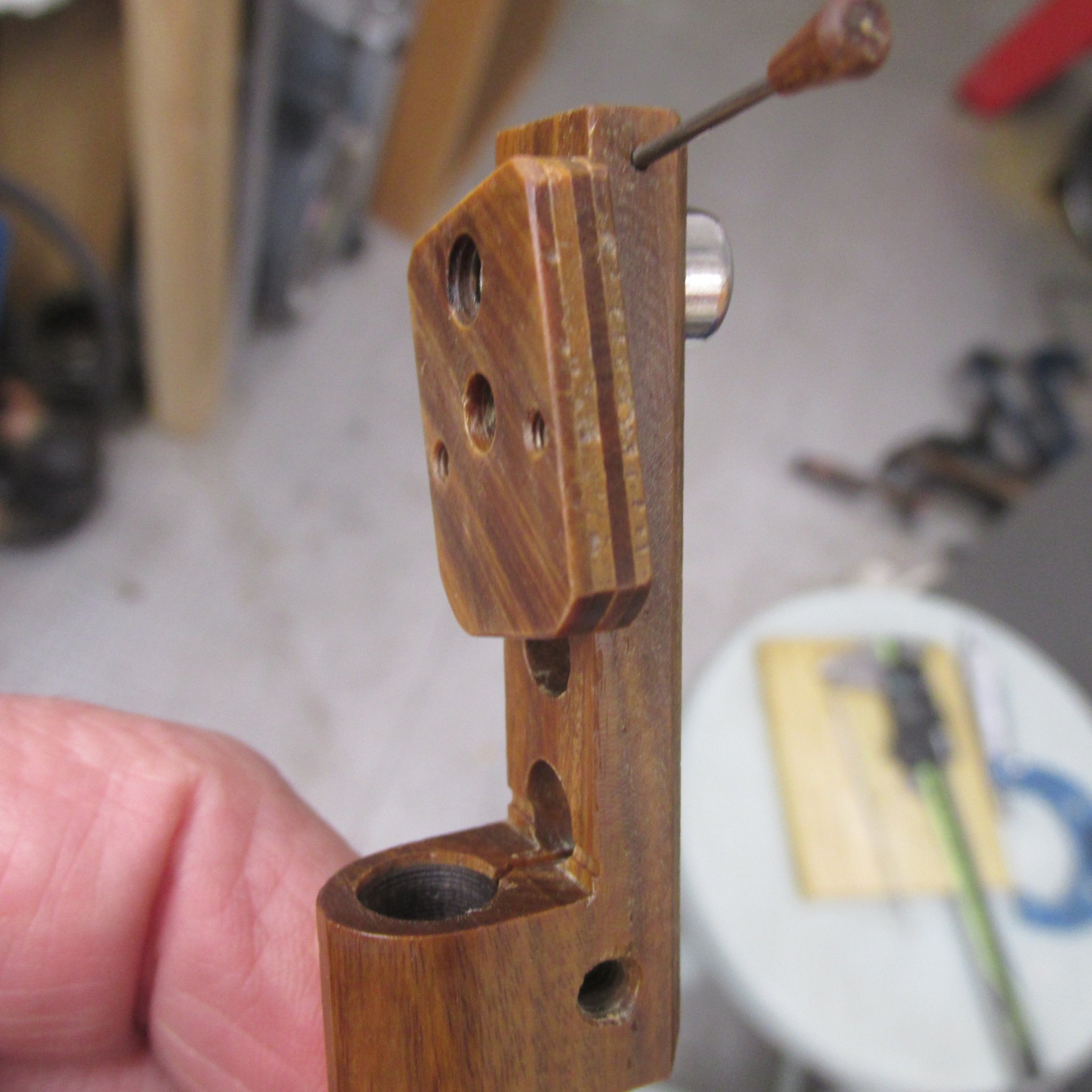

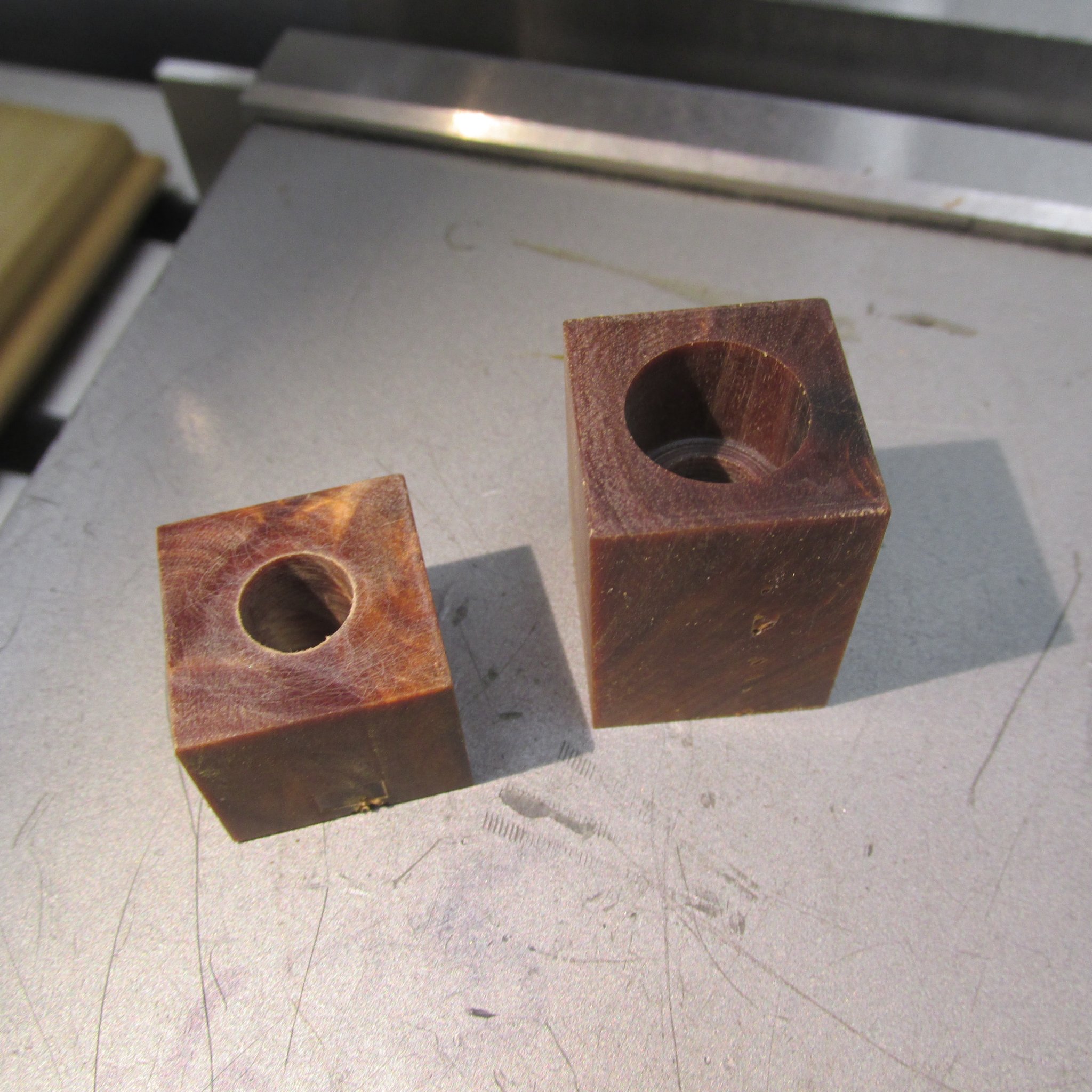

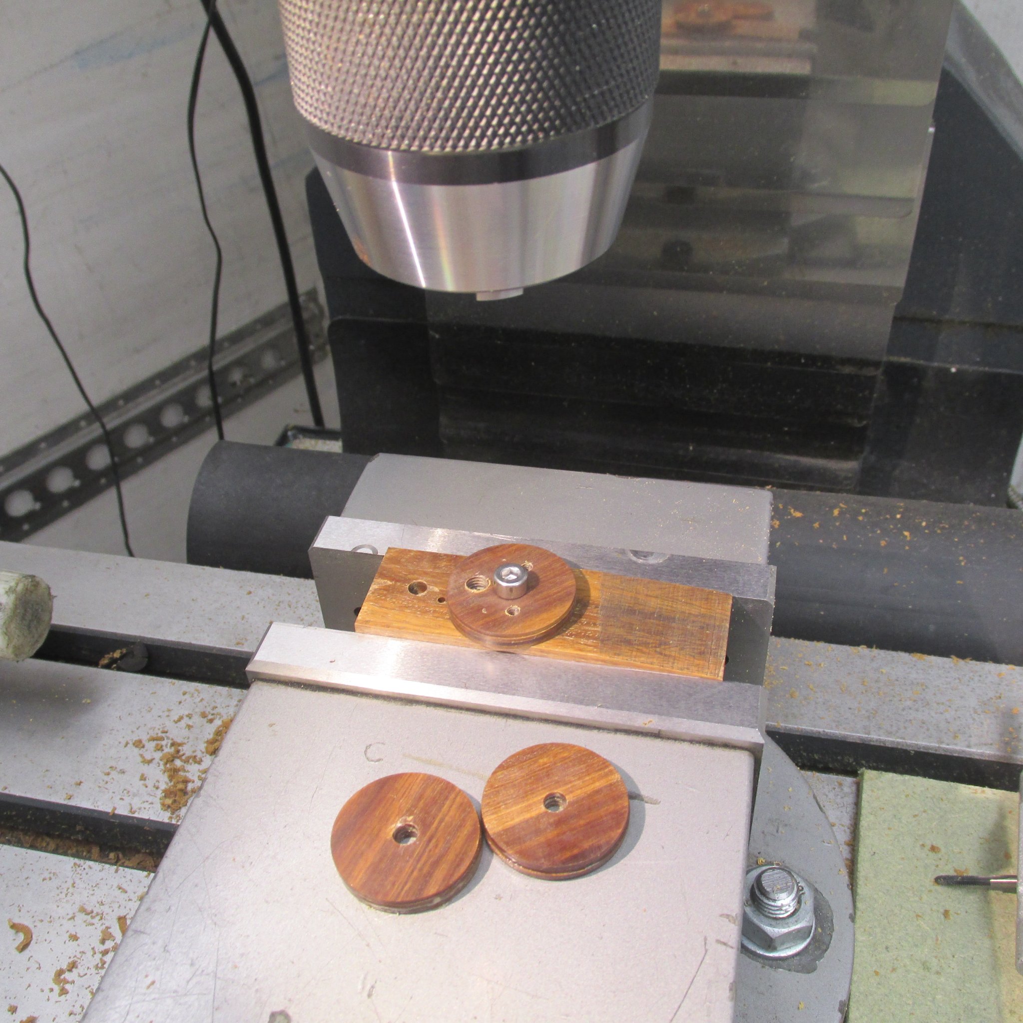

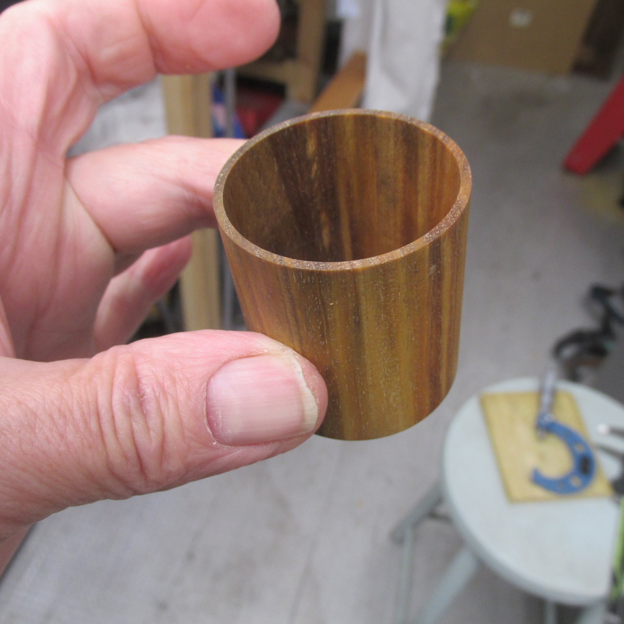

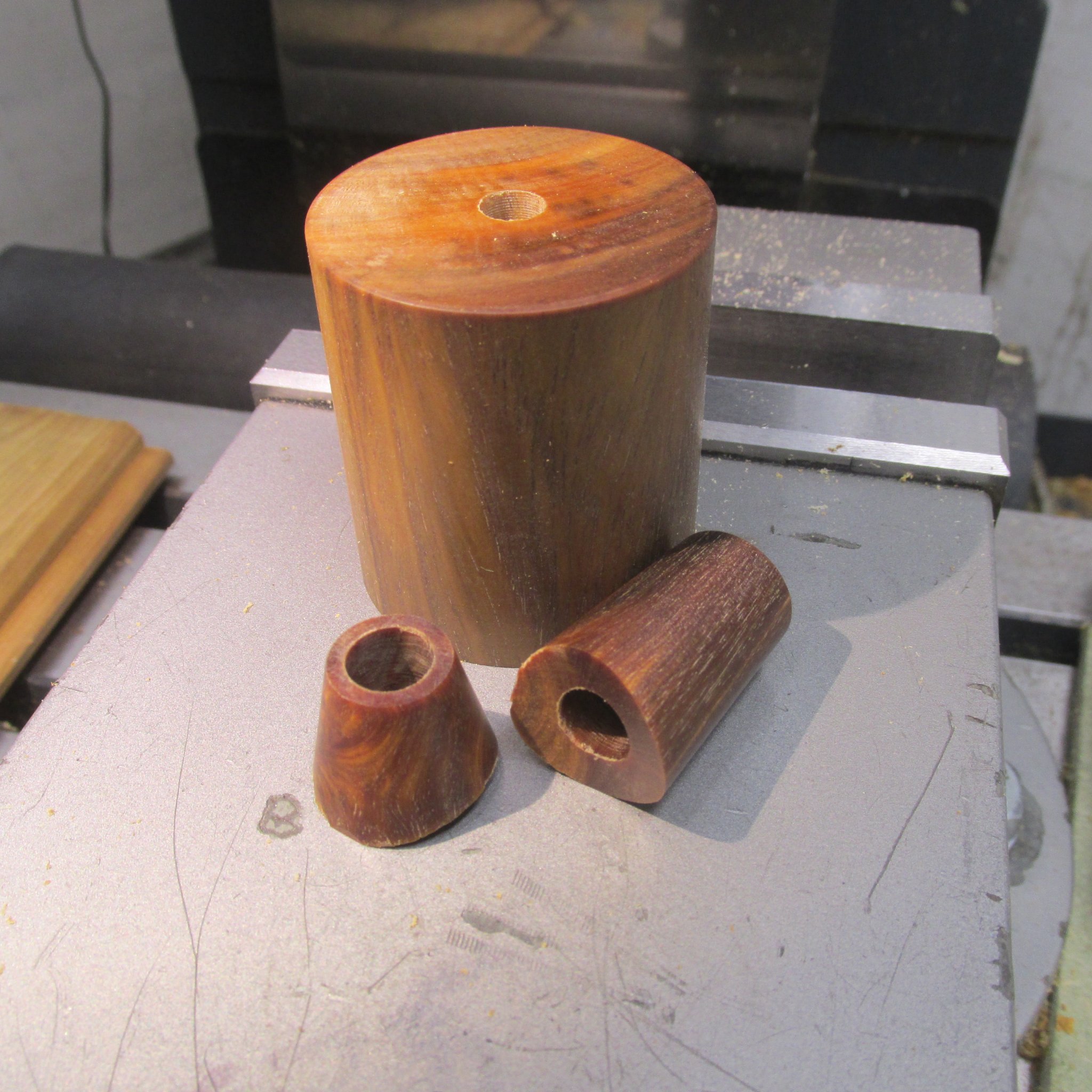

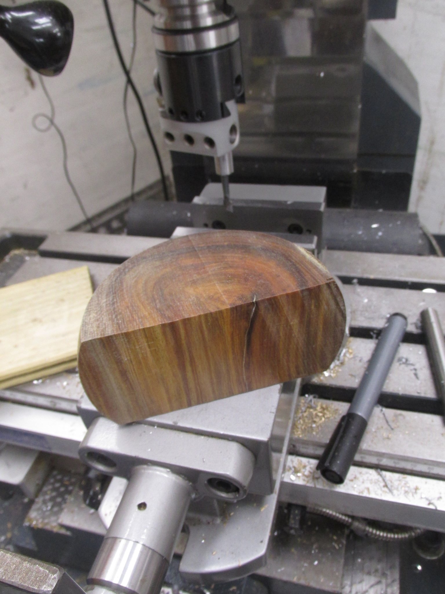

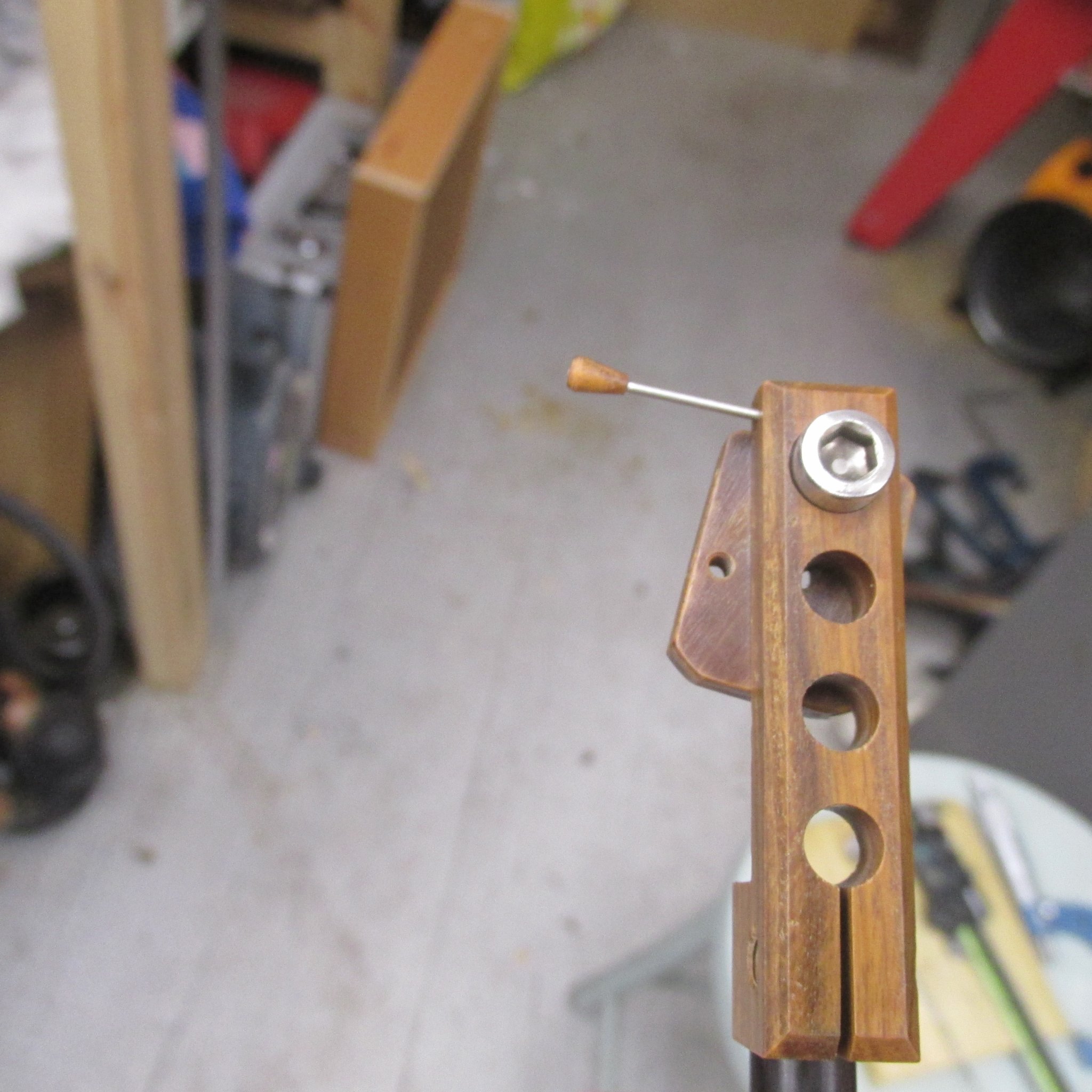

Hi I managed to get back to my spiritual home in the workshop for a couple more hours today which almost got the final part of the headshell's finished.
Luckily I made a spair laminate piece as the first attempt chiped which always a problem when working with small laminated parts in lignum vitae, note how L have designed this part to place the stylus close to the centre line of the armtube.
I did some research to ascertain the average distance between stylus and mounting screws on common cartridges and came to the conclusion that 9mm was about it.
I am expecting my new turntable to arrive from Japan in the morning and hoping that there will not be an extra charge for inport duty. The only turntable that I posses is a vintage Sondek which is not a good candidate for a twelve inch tonearm,
note the stainless cap head screw will eventually be replaced by a hollow titanium version.

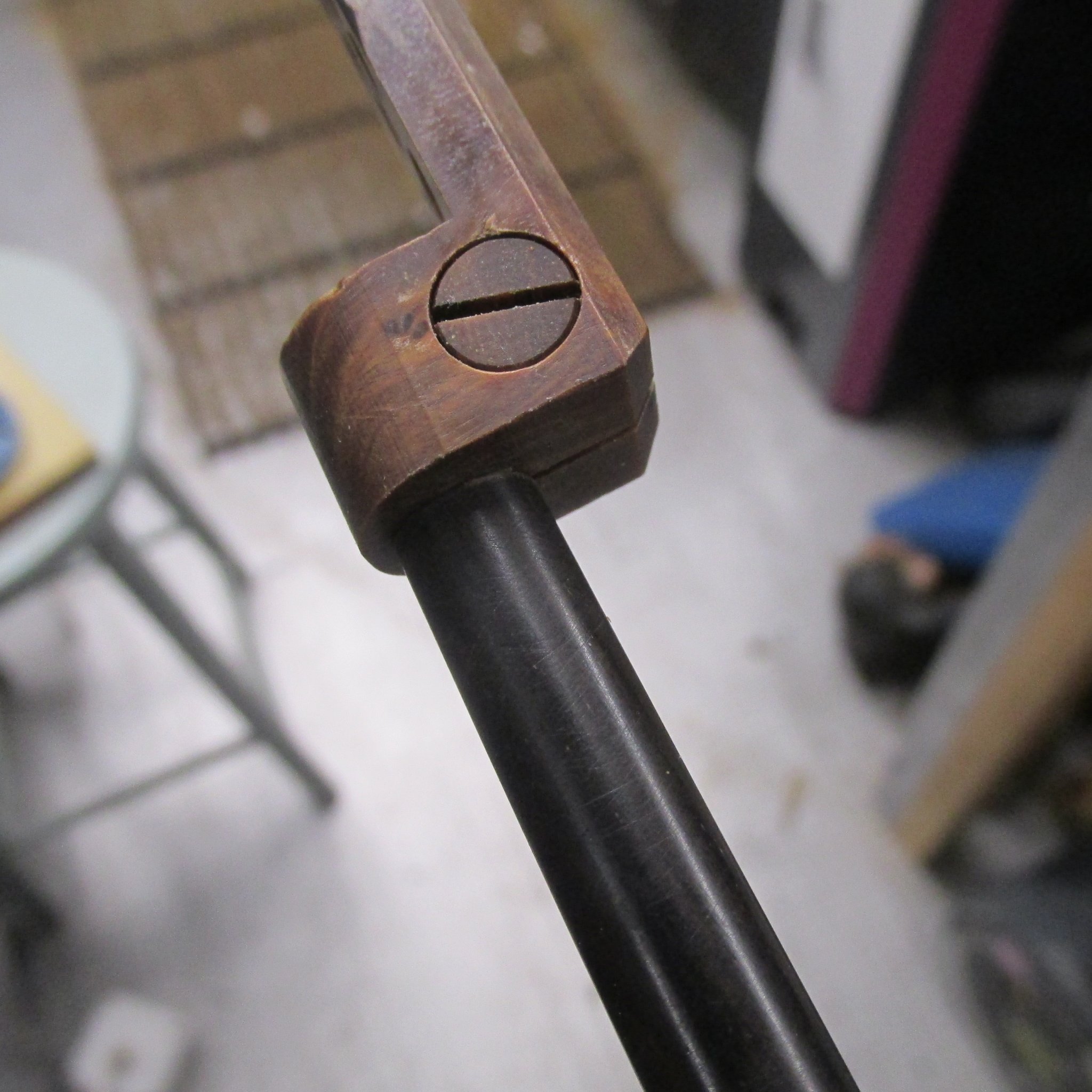

Hi back again They say a picture tells a thousand words so to day I am just posting pictures!.

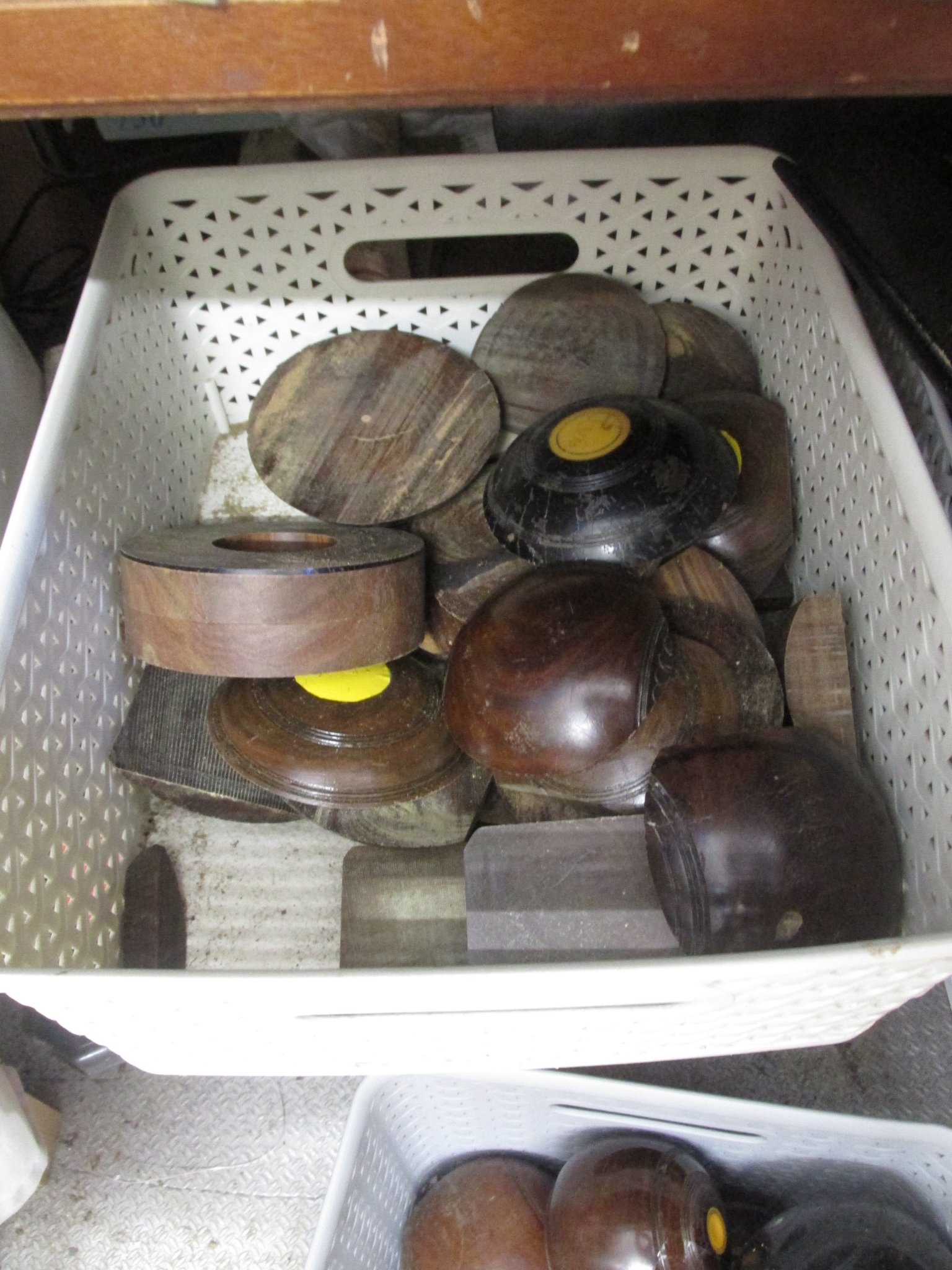

No bowler would have ever guessed what might have become of his favorite bowling ball. Indeed, the photos are very telling. I just can't imagine how sharp the turning tools must be to get results such as these.

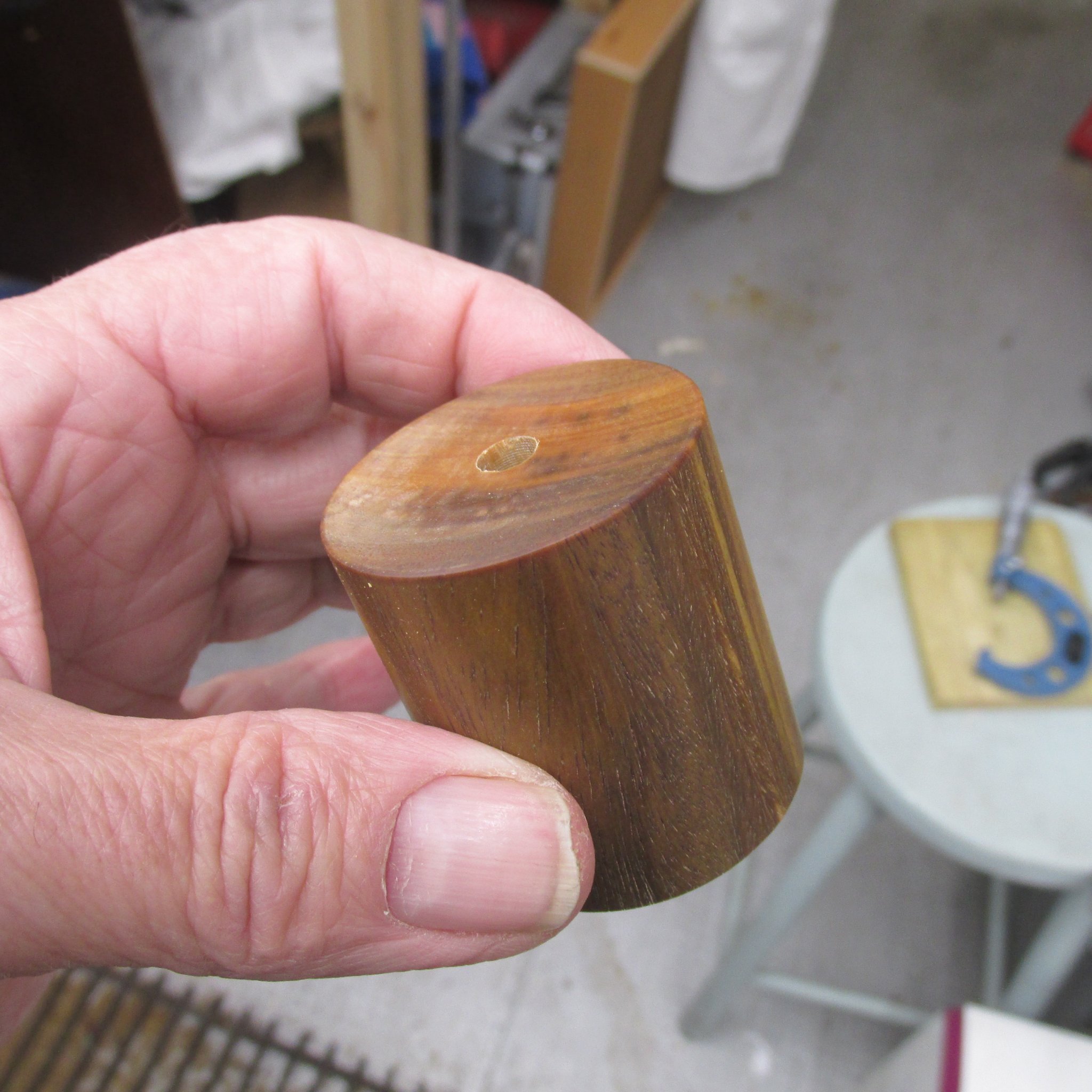

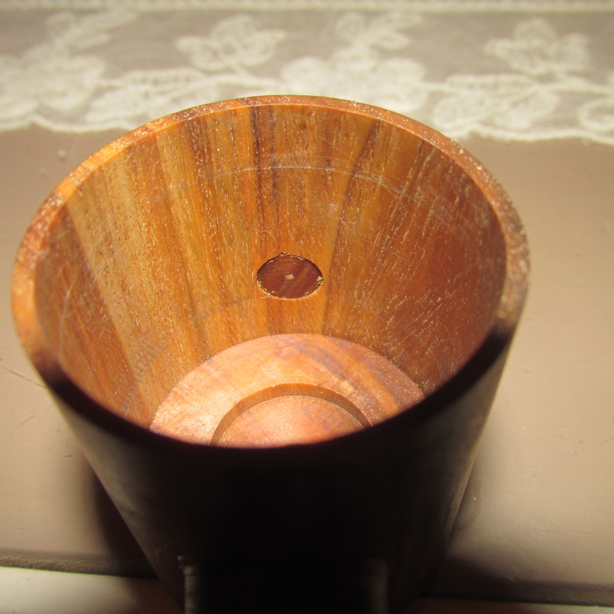

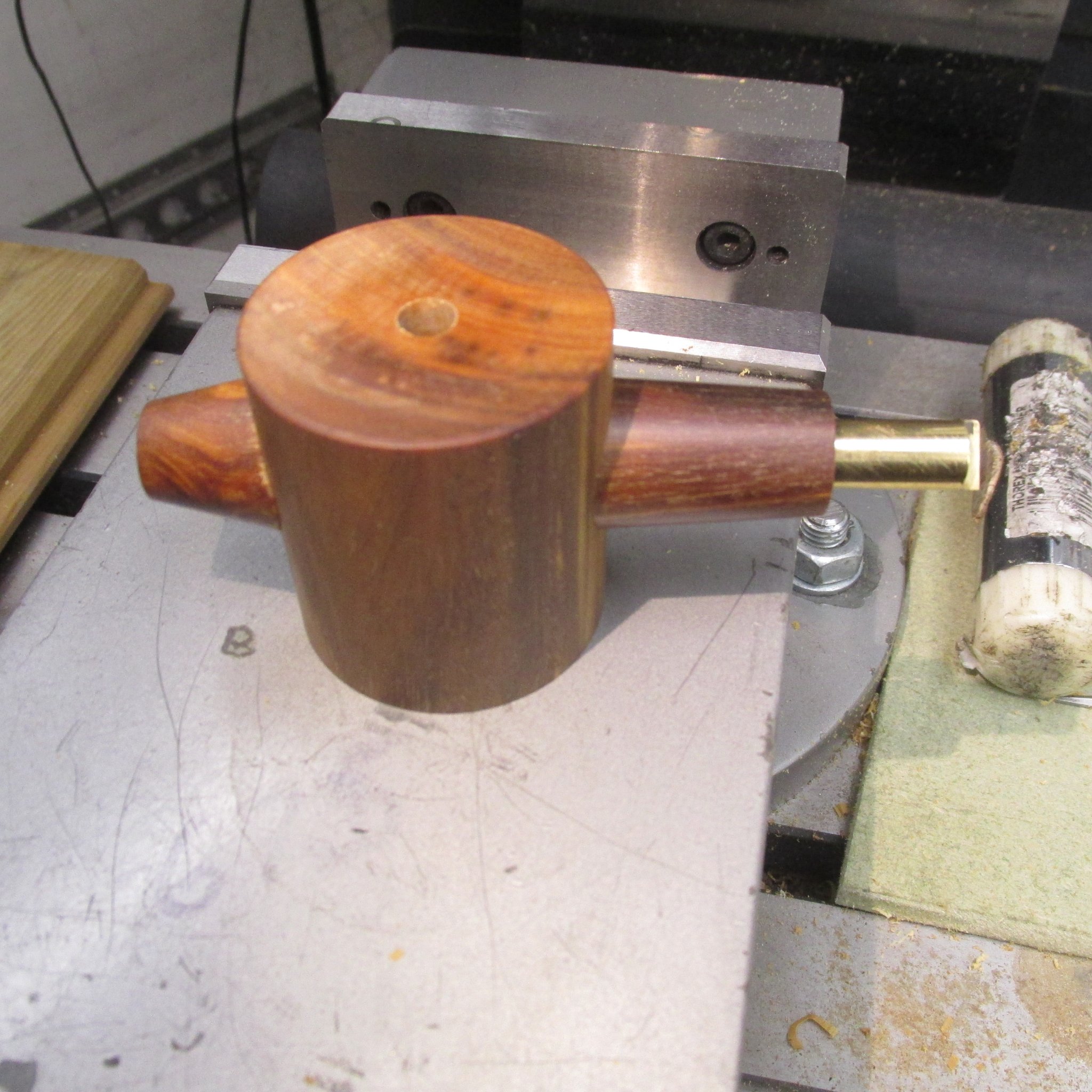

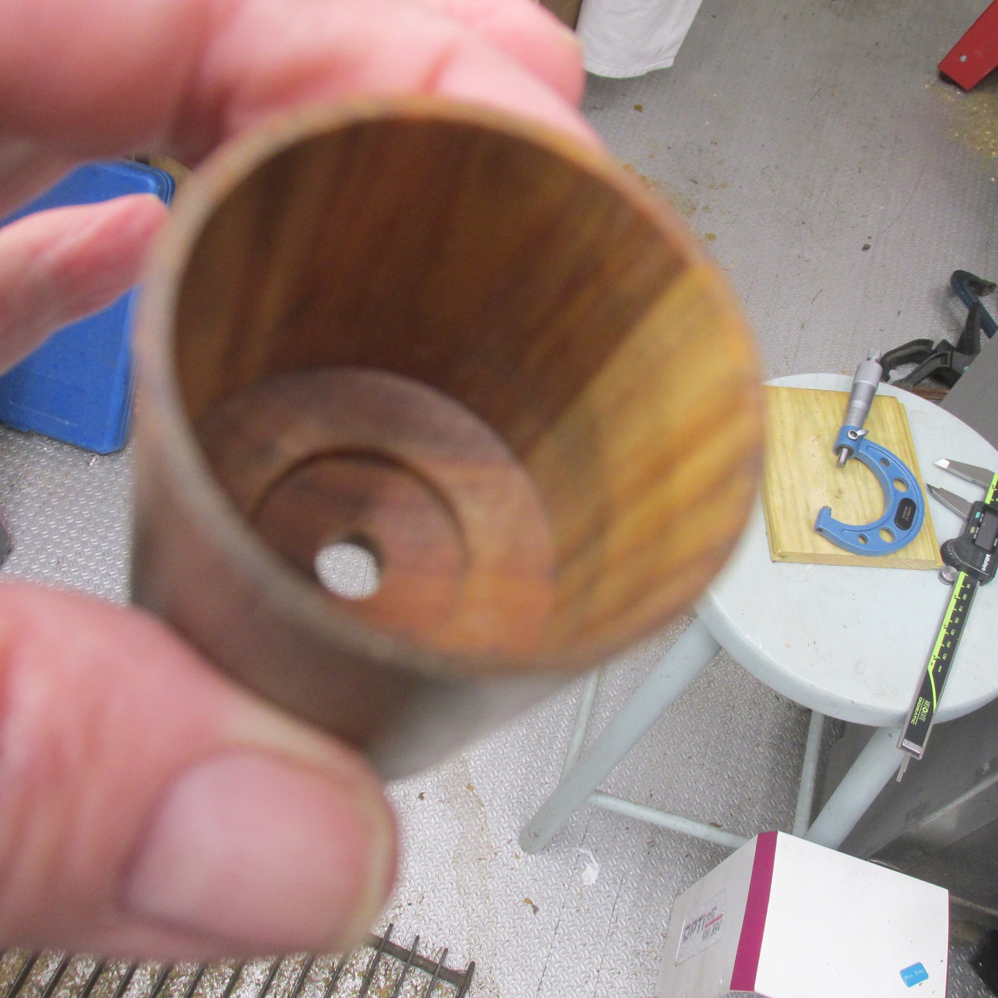

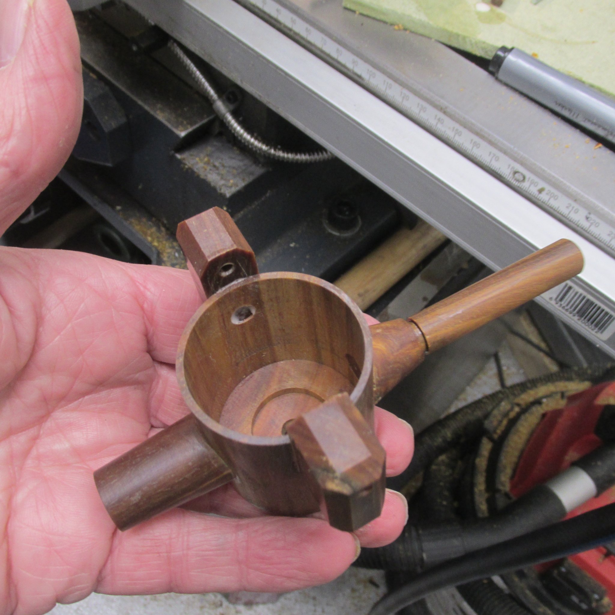

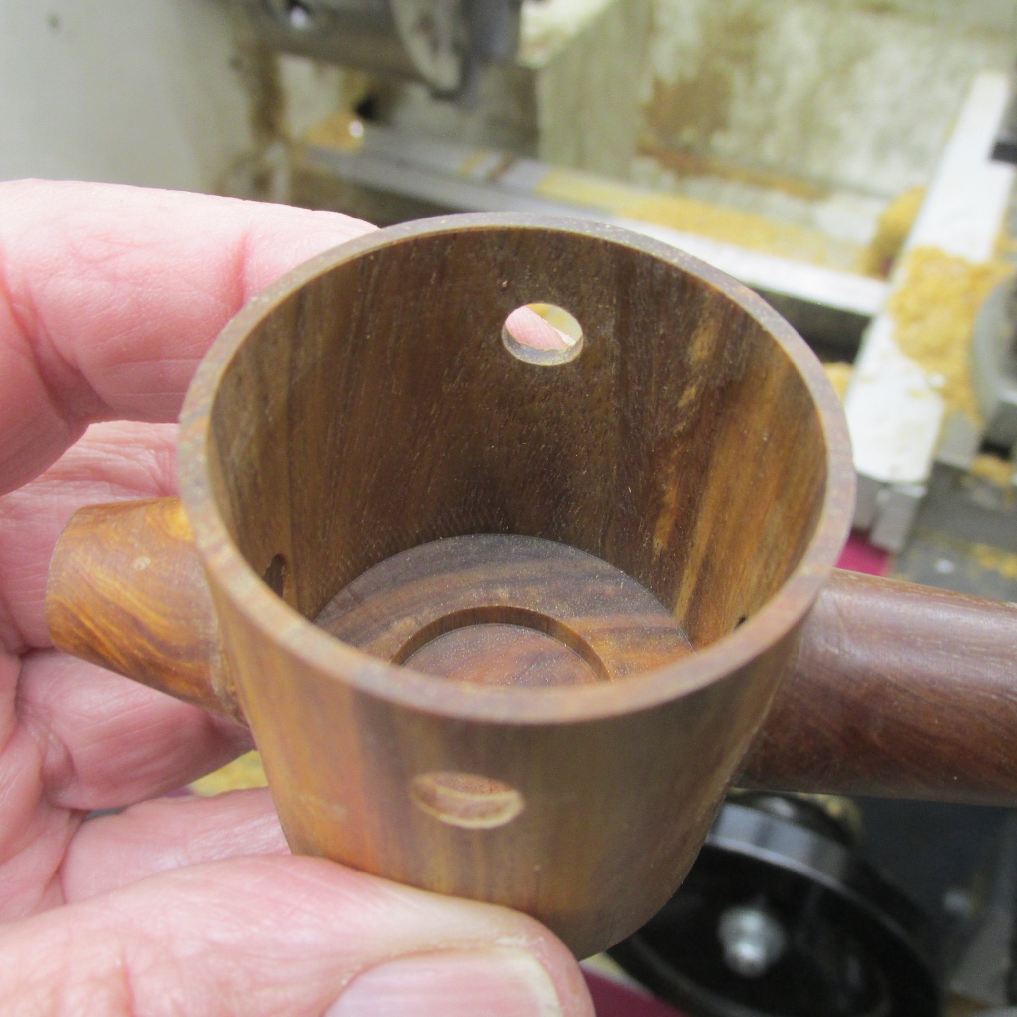

Well I have now got the most complicated part almost fabricated, there is still a great deal to do. I supose about 25% of the work is done but once there is some'thing to look at it becomes much easier to visualise all the other parts that make up the whole thing.
There are no drawings just the odd sketch to work out the spacing so it all fits together.
Here are some more pictures of the work as it progresses.
One question that I have is how are you completely sure about drilling a hole at a 90 degree angle, i.e. perpendicular to the other hole positions? And is it hard to get the right 'lack of angle' on some pieces? It all looks pretty basic from one perspective, but I know differently with this sort of project. A tonearm would be the ultimate challenge for everything to right on....
I guess that a lathe and mill take out some/most of the guesswork, but still, even the wood doesn't want to be drilled straight at times.

1st of all the to answer Laxny, squareness is no problem but I have been doing this sort of thing all my working life and now it all continues into retirement.

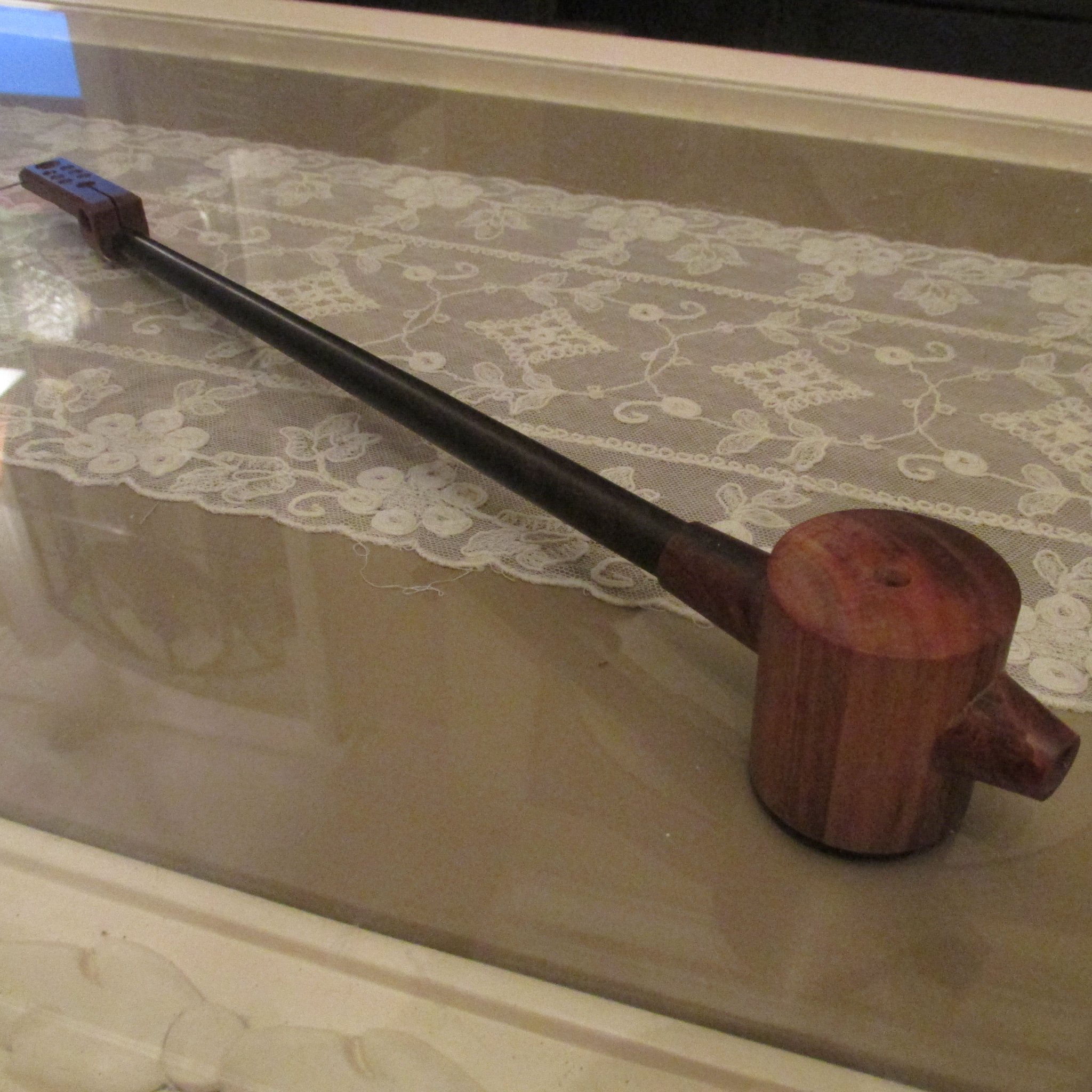

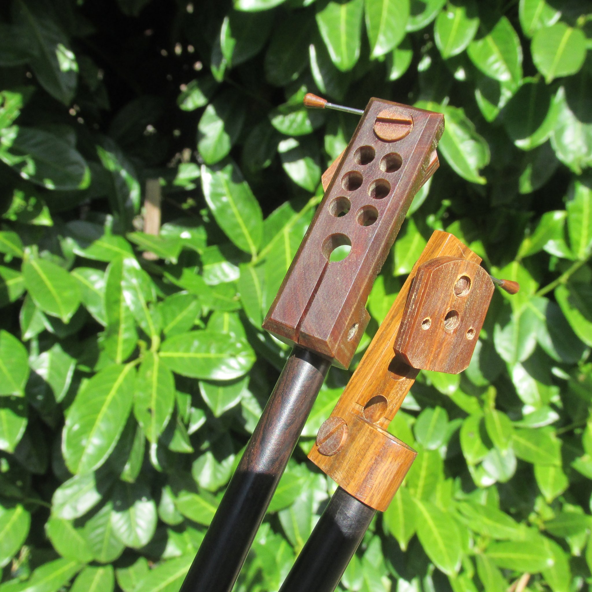

Hi as I said earlier I am building two tonearms to see which suits my new bearing design the best. Type A and Type B the type a arm is finished apart from wireing and polishing see photo, I am now working on type b which I expect will work best.
On type b the bearing is exposed so there will be no finished photos until I have at least a uk patent pending.`
