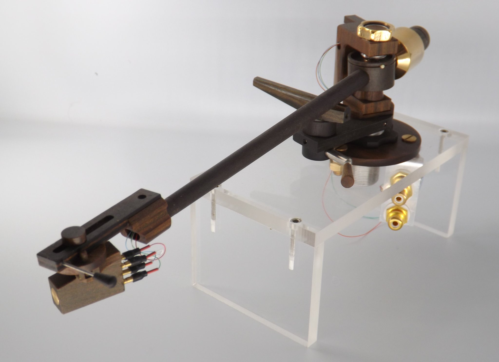

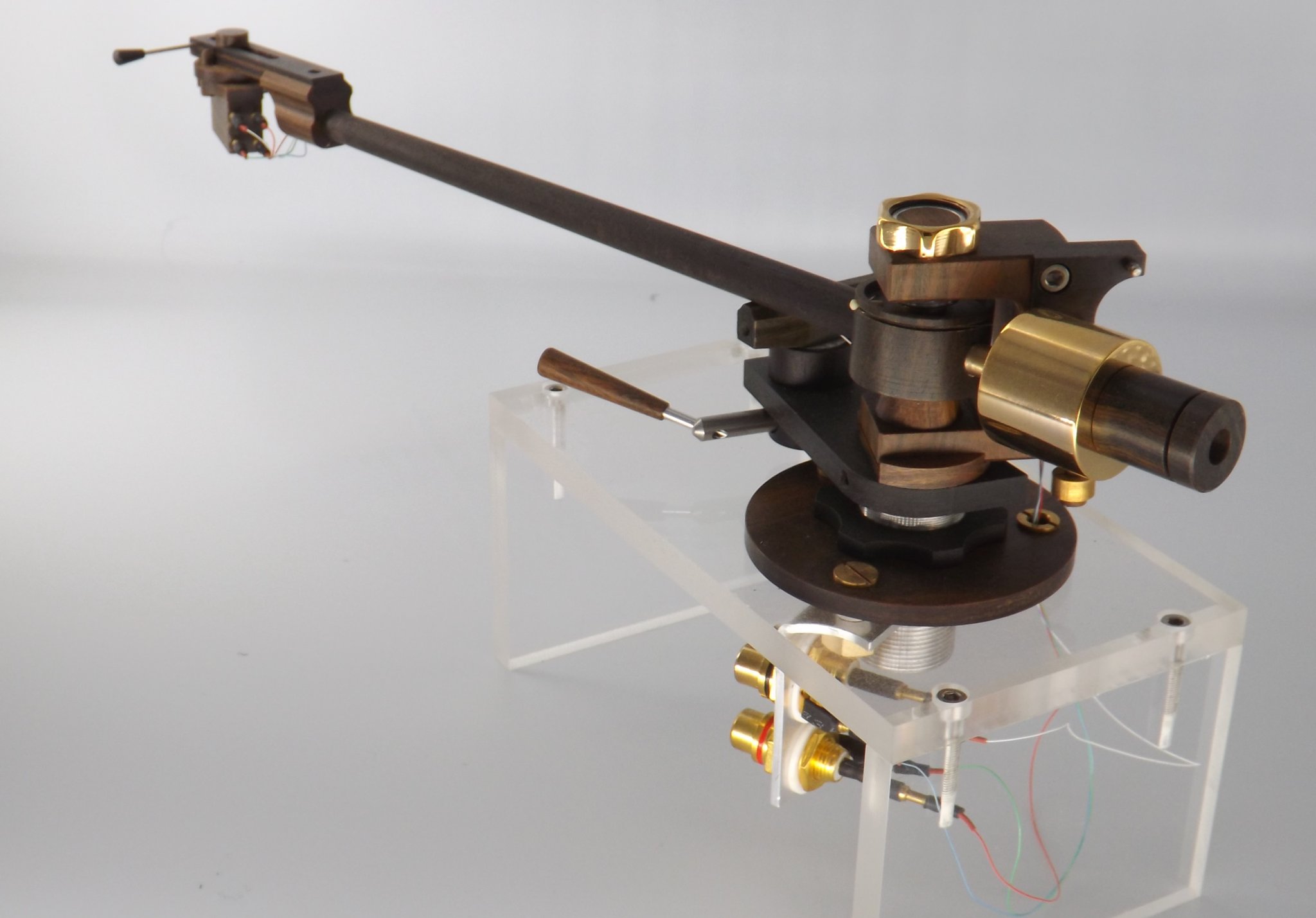

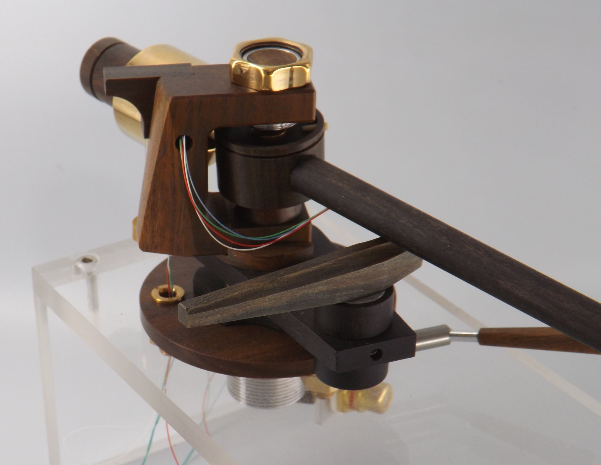

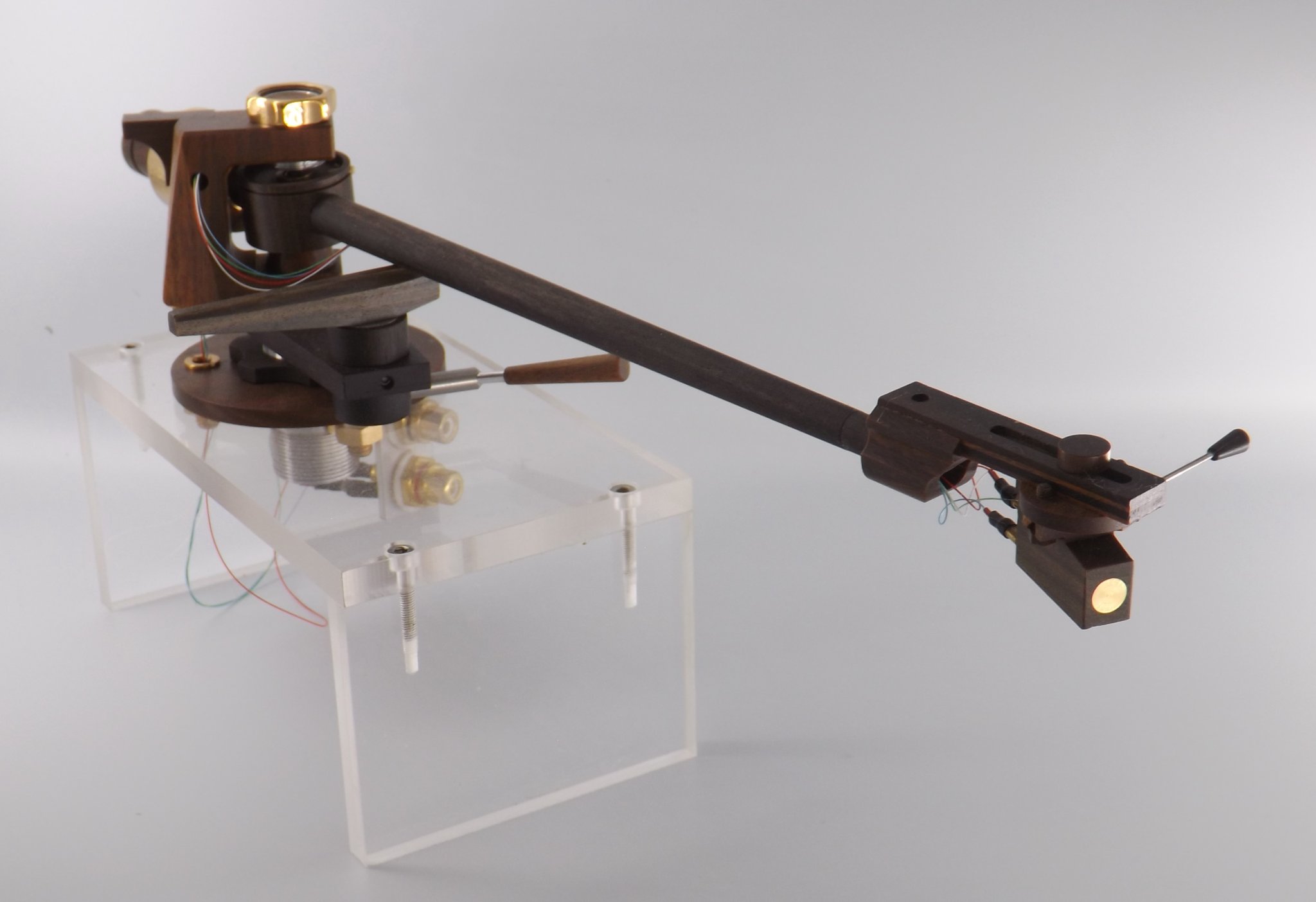

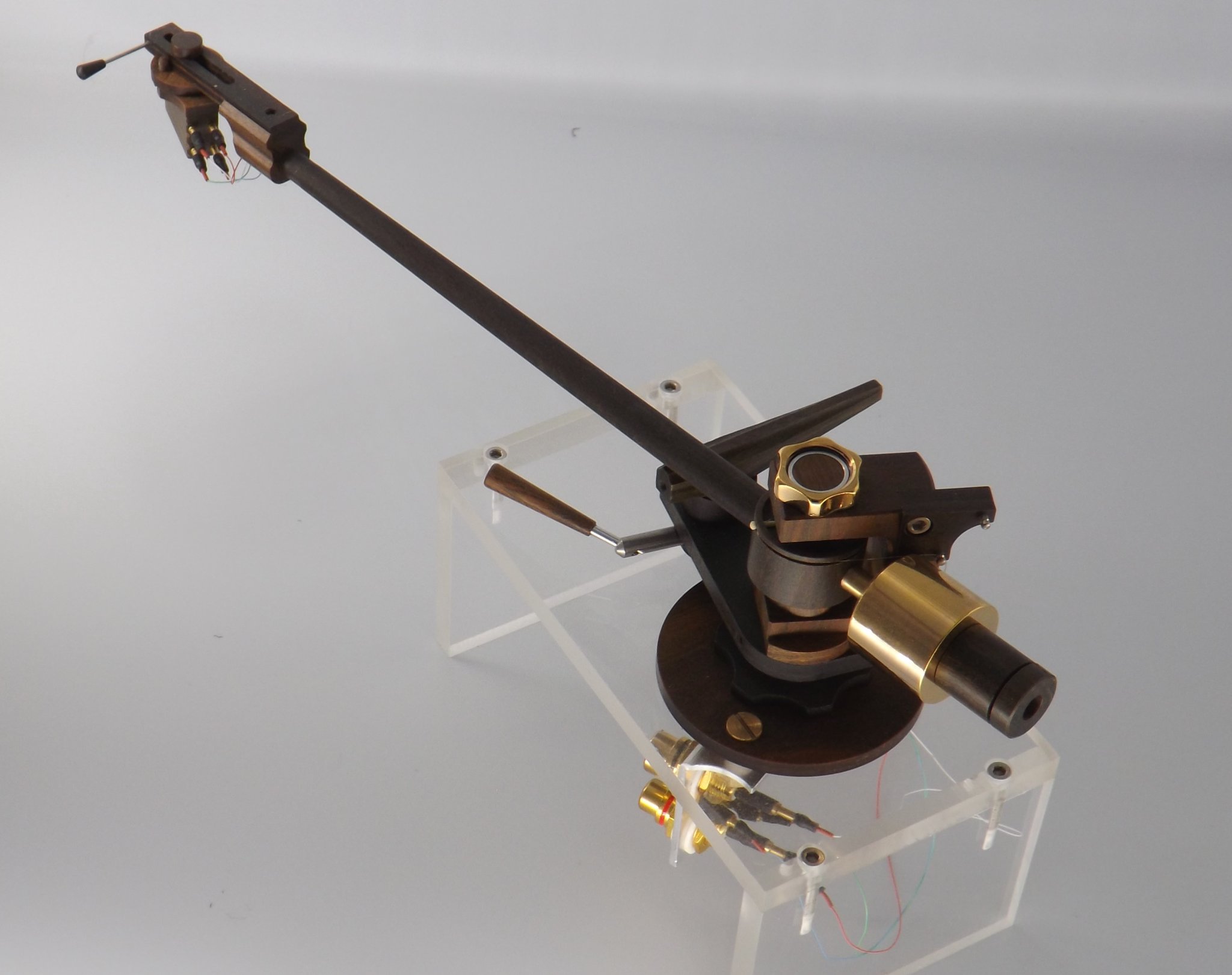

The Ebony Warrior. magnetic tonearm made in Huddersfield UK
It's wood jim but not as we know it!
i wood like to team up with a inspired turntable maker
Hi I am pleased to see a few people have looked at my tonearm, I spent about two years of my spair time developing it and it came out far better than I ever expected it's strengths being it's ability to track anything at 1.5g and transiat response that leaves my dac in the darkage, the sound stage is also pritty amazing but really complicated passages with lots going on do show up its only sonic weaknesses.
Now it is time to start again from scratch and put all that I have learnt into a completely new design, I have an idea for a tonearm floating on a film of ferowfluid.
Can I pull it off ? who knows ???
I found a piece of lignum vitea on huddersfield market the other day, just about long enough for a 12 inch arntube (see photo ) in the morning I will make a start.
Call this a kind of blog, catch you all in a day or two. Bob.

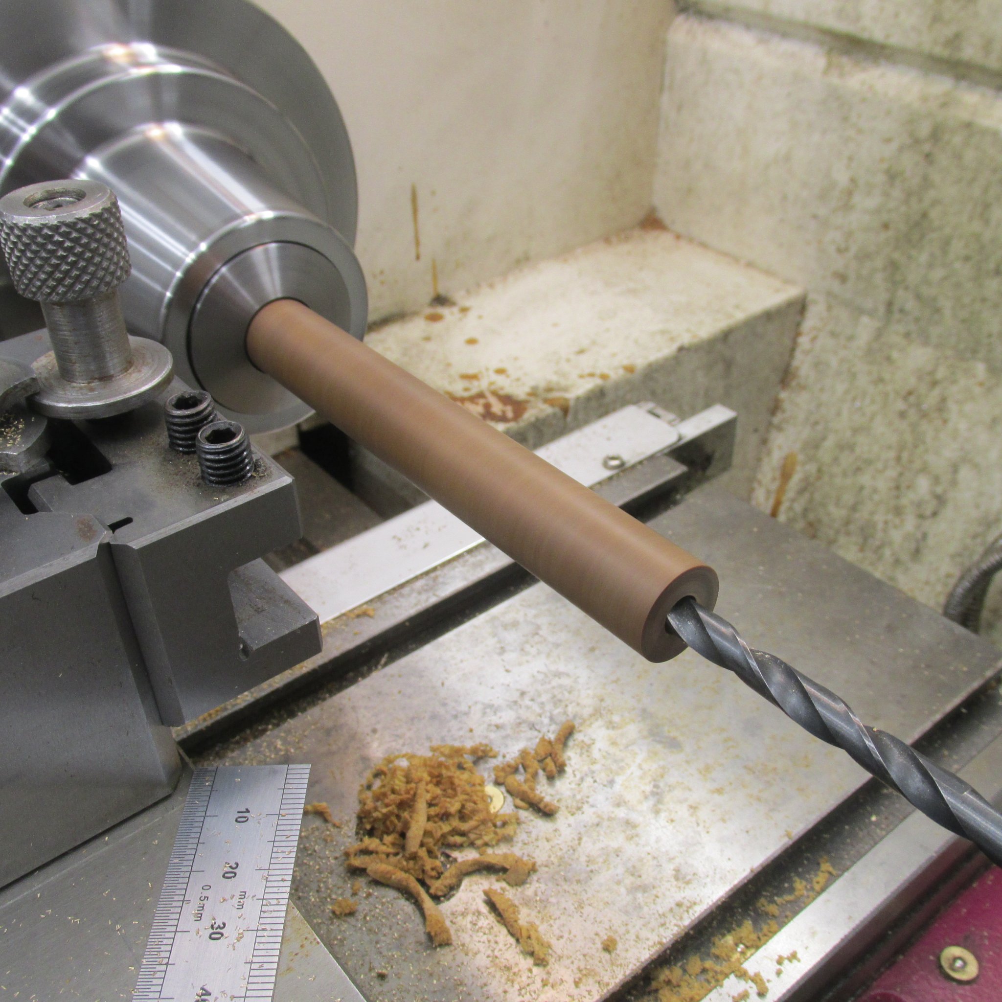

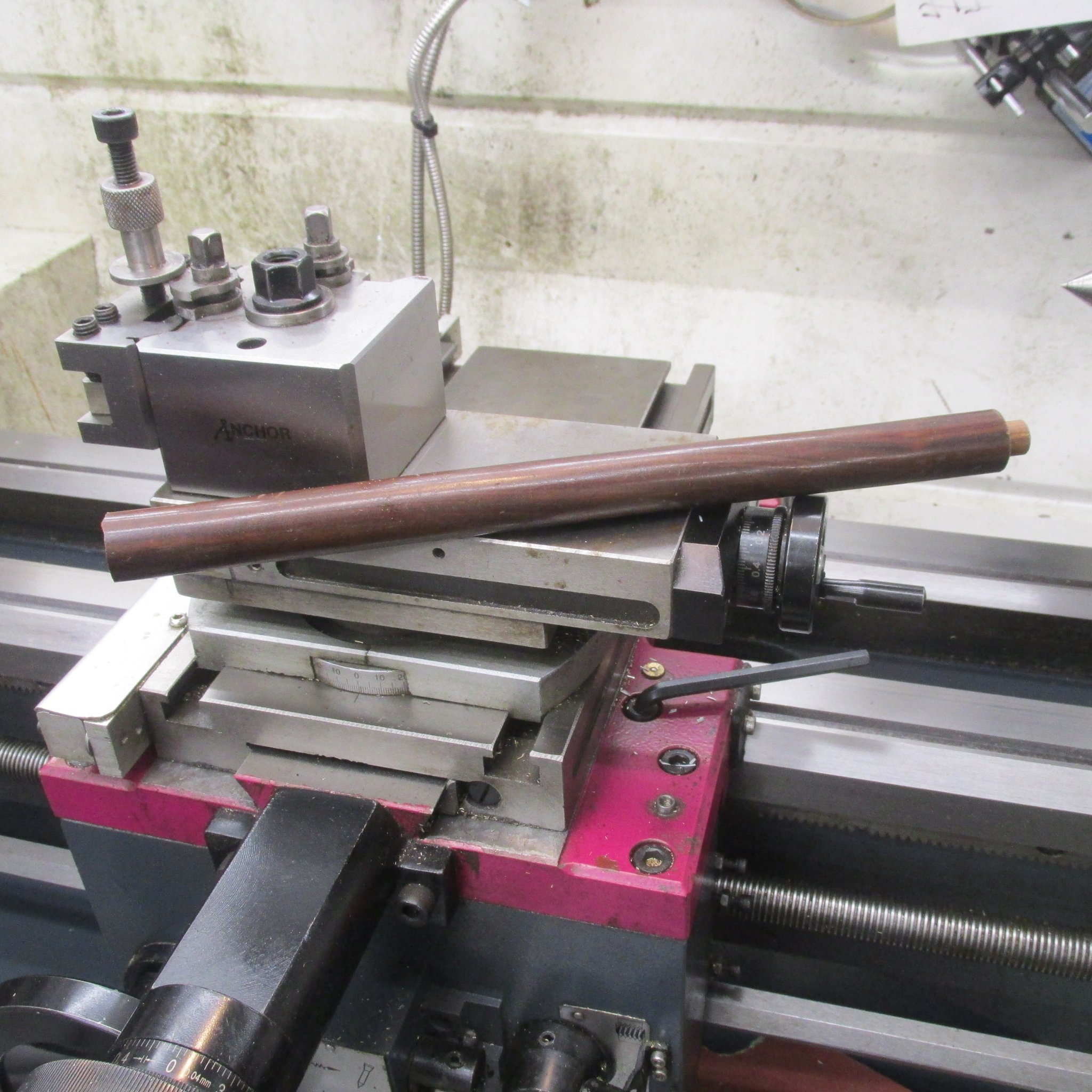

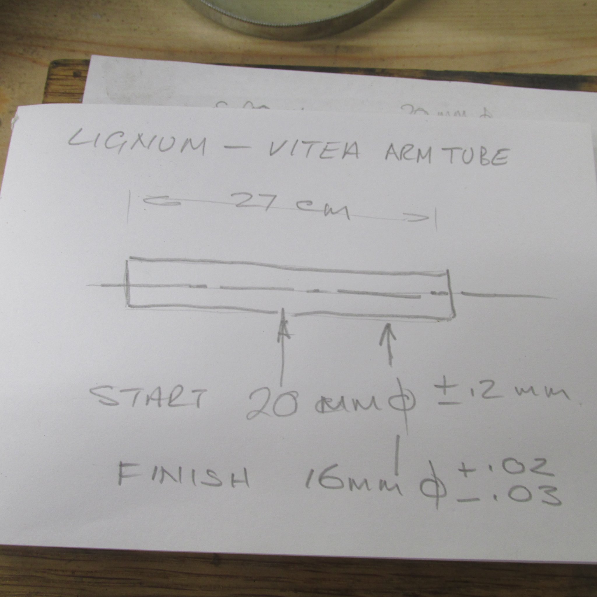

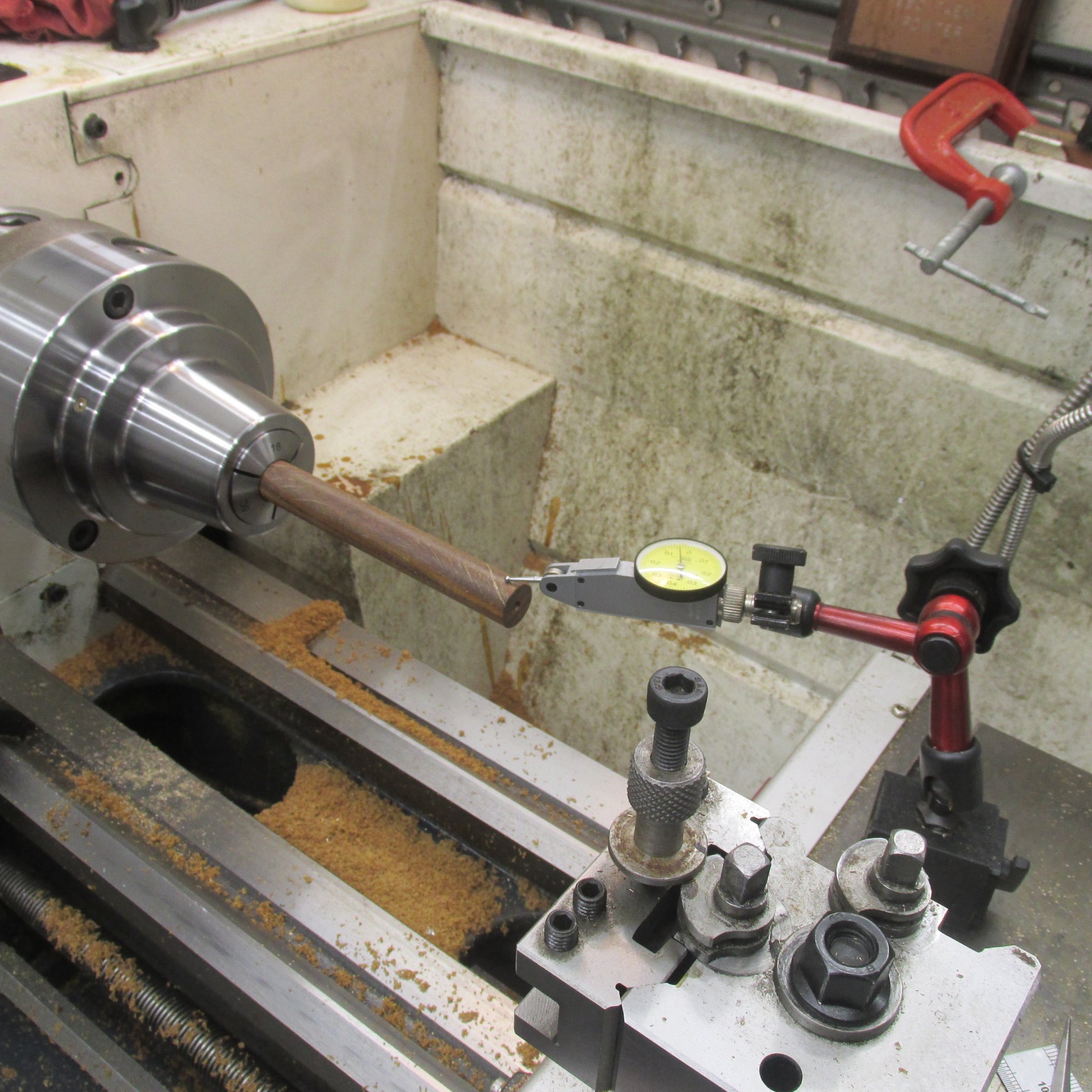

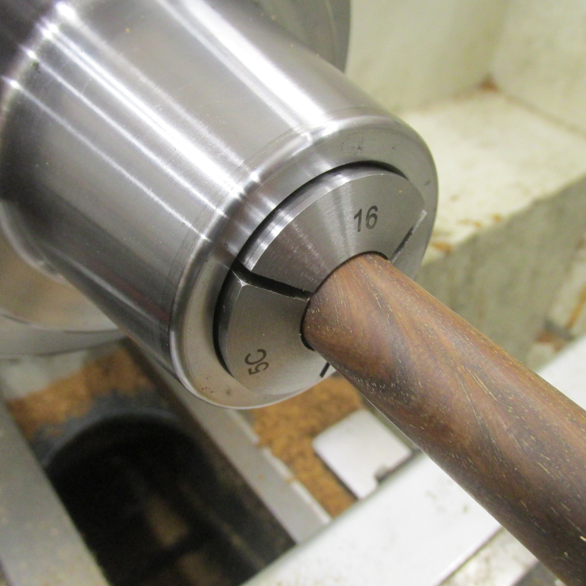

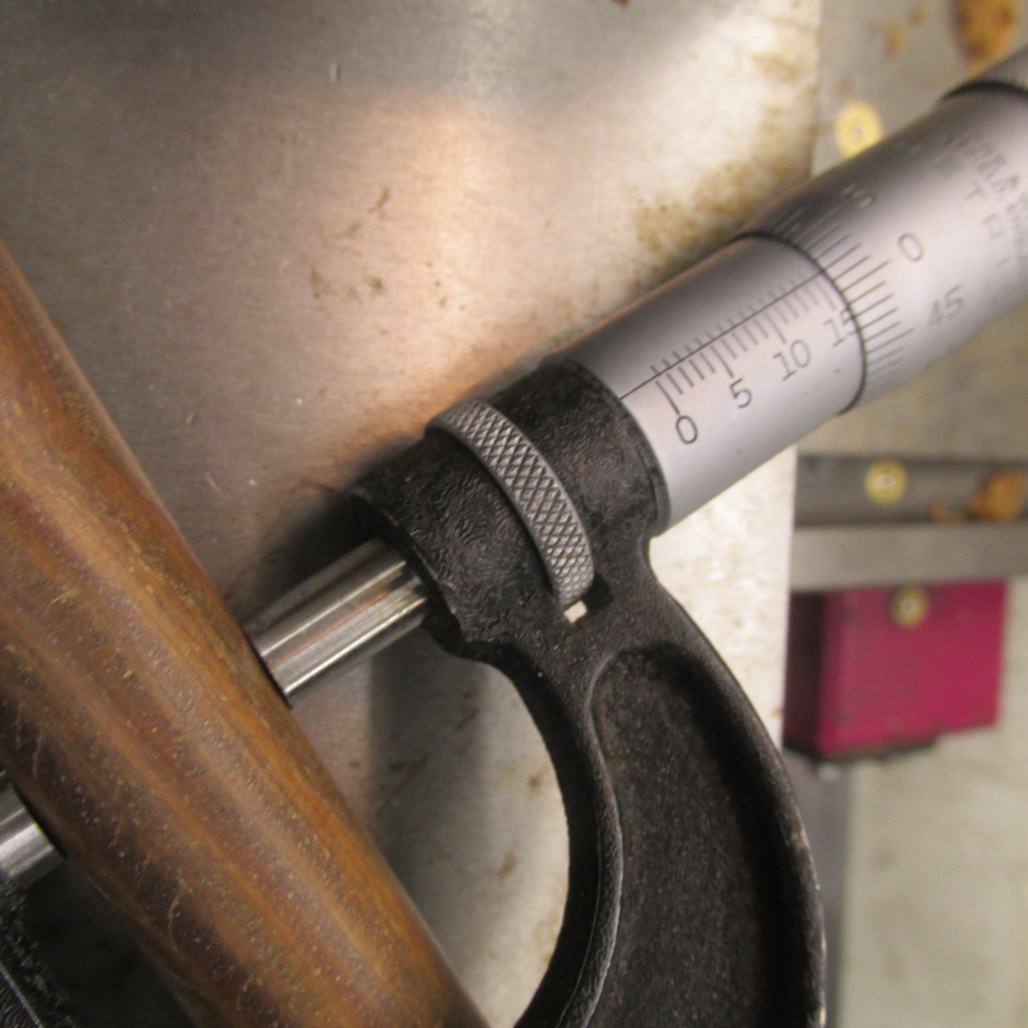

Hi I made a start on the new armtube this morning
First job turn the blanc to a constant diameter so I can hold it in the collet chuck and drill from each end
Reactions: Netlist

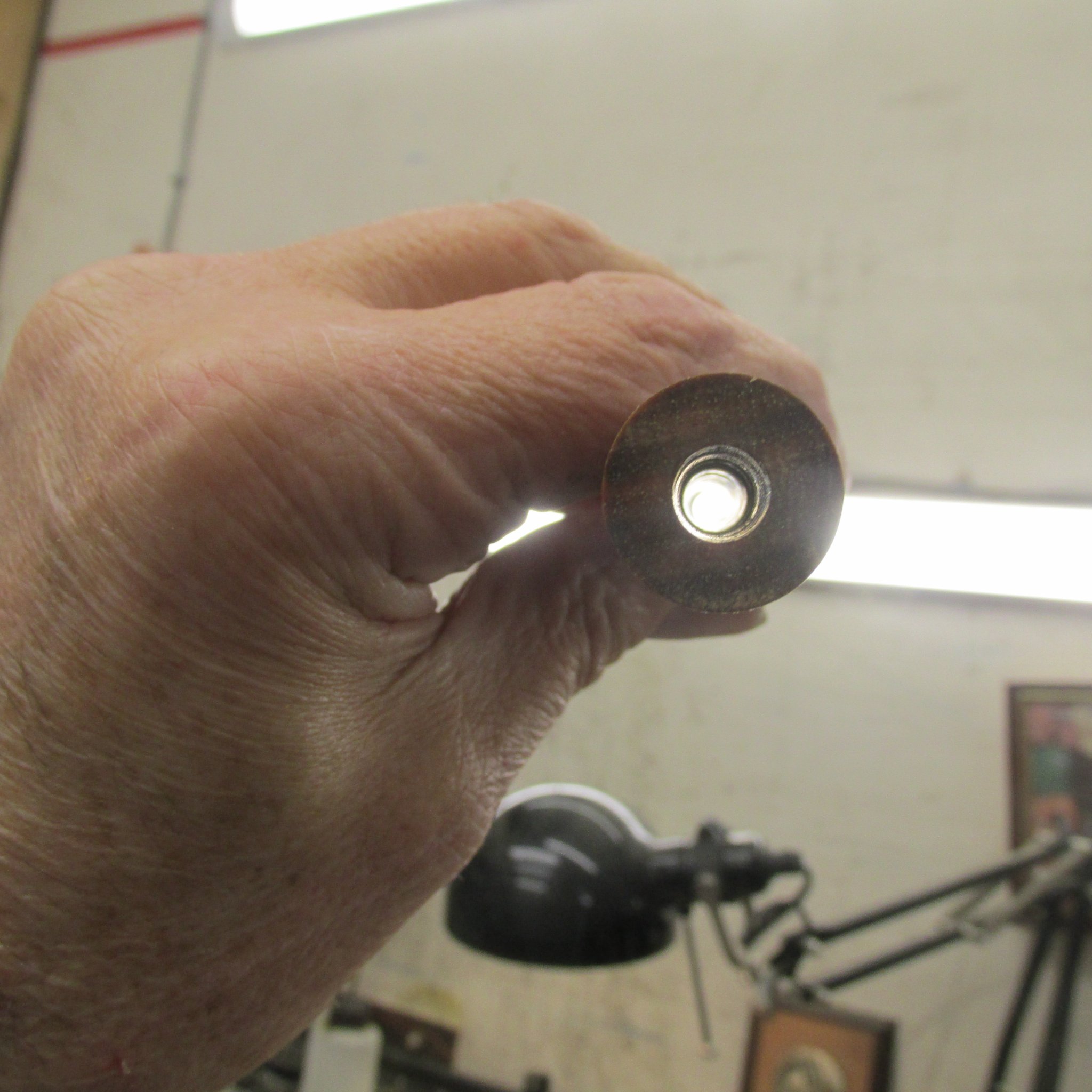

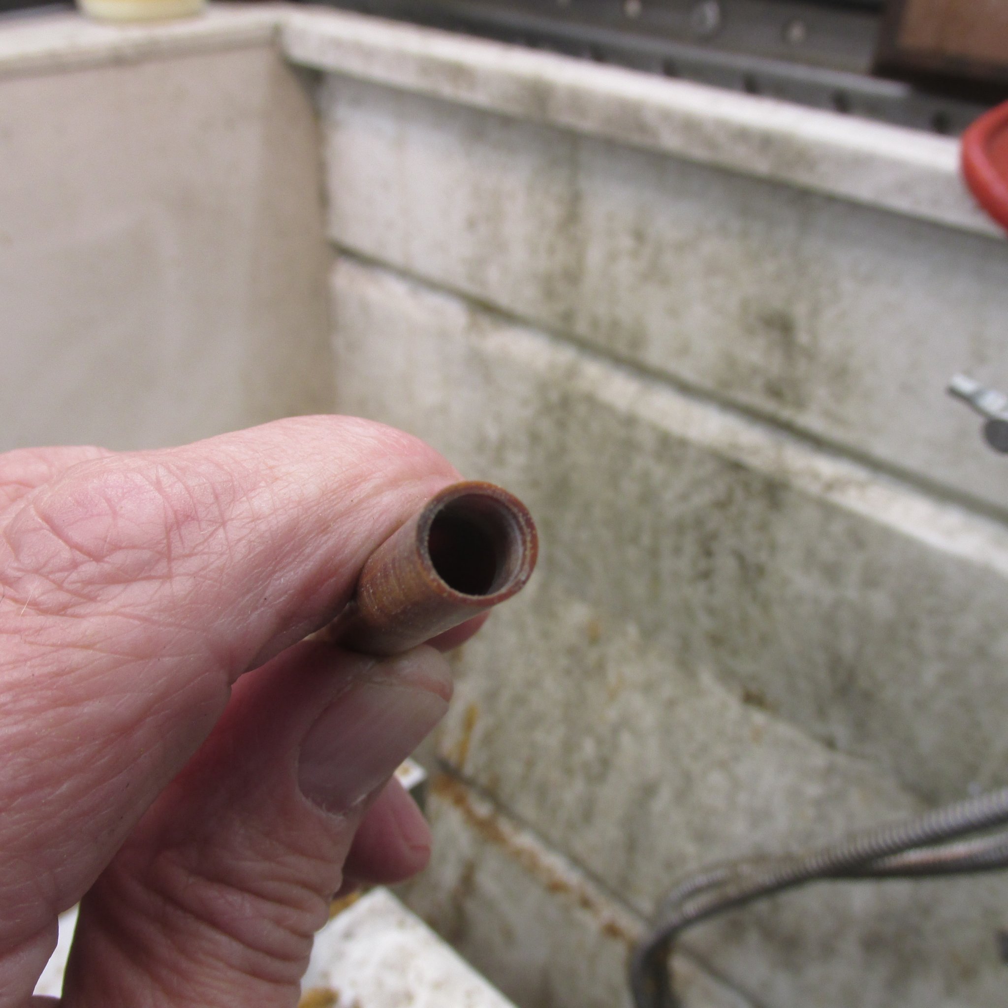

I managed to find another hour before tea
so I set up the collet chuck and got on with the drilling "not a nice job" I must have made about twenty arm tubes by now and scraped at least three on the drilling, you can never be sure the drilled holes will meet in the middle as the drill always follows the grain of the wood to one extent or another and this armtube being made of lignum vitea with a grain is runing all over the place.
So to cut to the chase the holes drilled from each end did not line up as well as I was hopeing, I reckon the misalignment is about .3mm
But considering it is my first attempt at a twelve inch arm and also my first attempt at making one out of lignum vitea I am not too unhappy.
It will probably be midweek before I can get back in my workshop.
Bob.

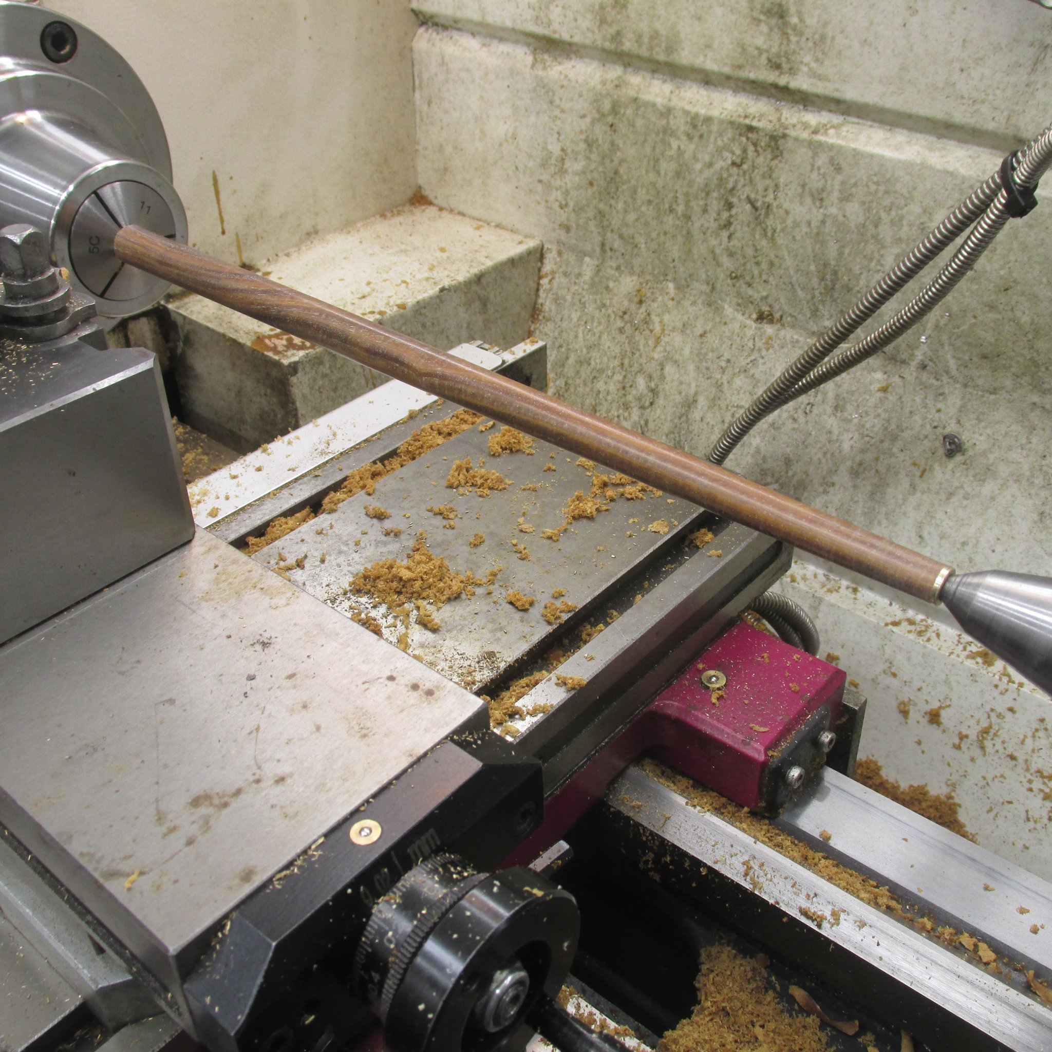

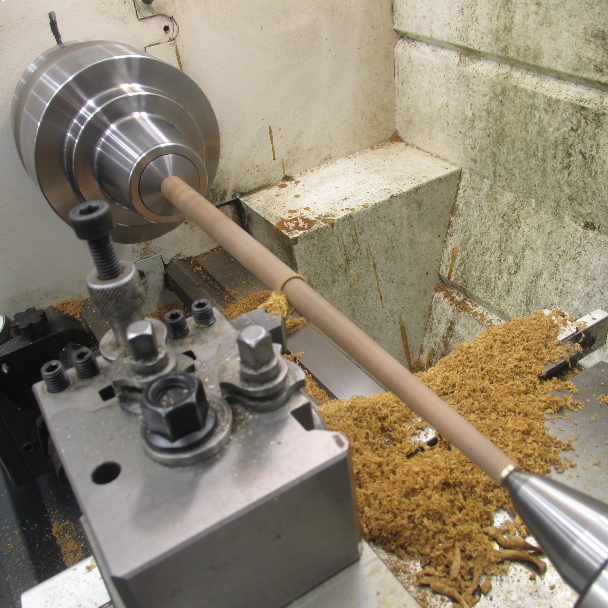

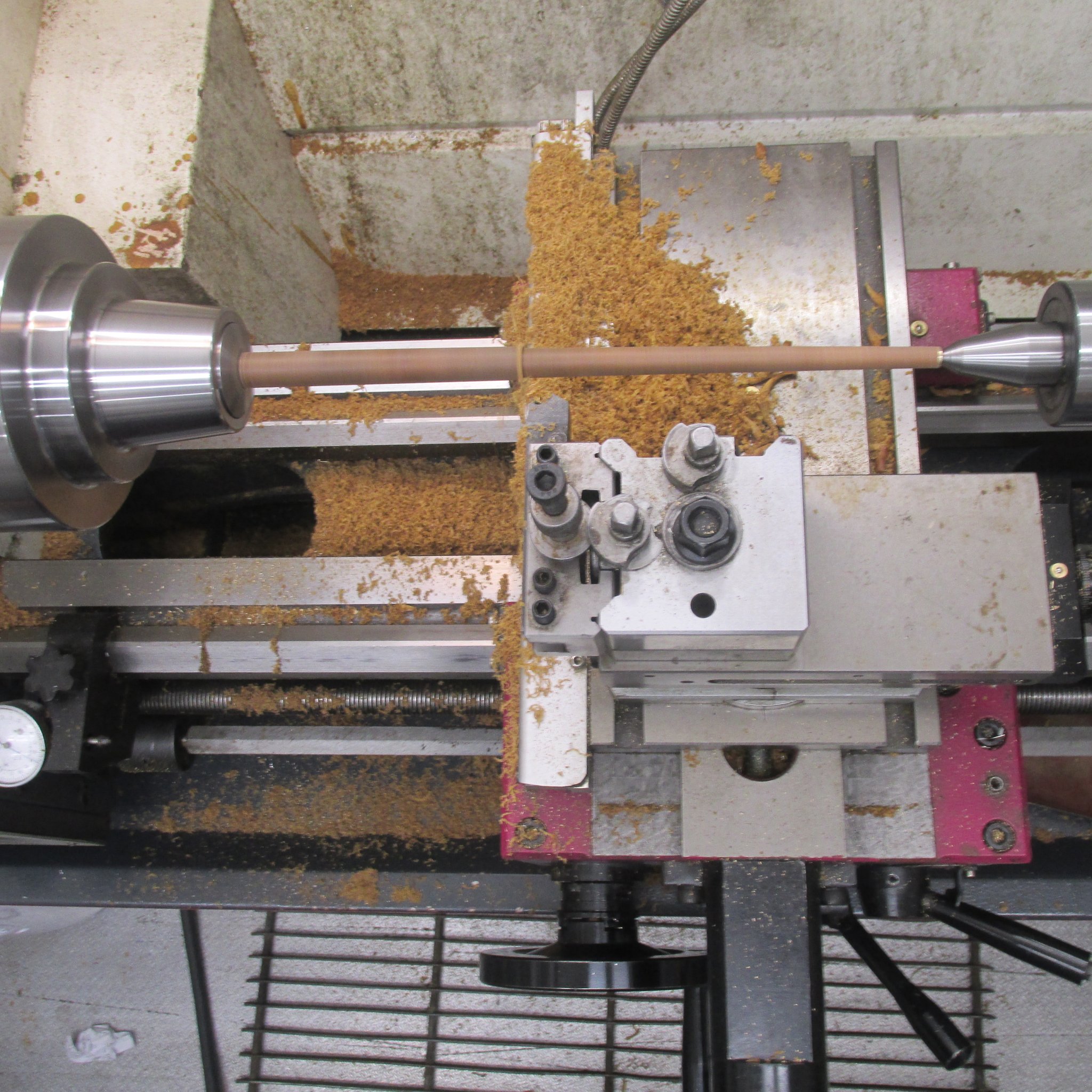

Hi I got another hour or so in this afternoon
the turning of the armtube is now more or less finished
I turned a taper by offseting the tail stock by 2,5mm to produce a 5mm taper over the full length
see attached pic's

Hi Bob,
It is a nice lathe you have, who makes it? I love the collet chuck. Is it a Bison? Drool drool!
I didn't know 5C collets are popular in England.
You could drill the hole slightly under size and finish with with sandpaper on a mandrel.
Sincerely,
Ralf

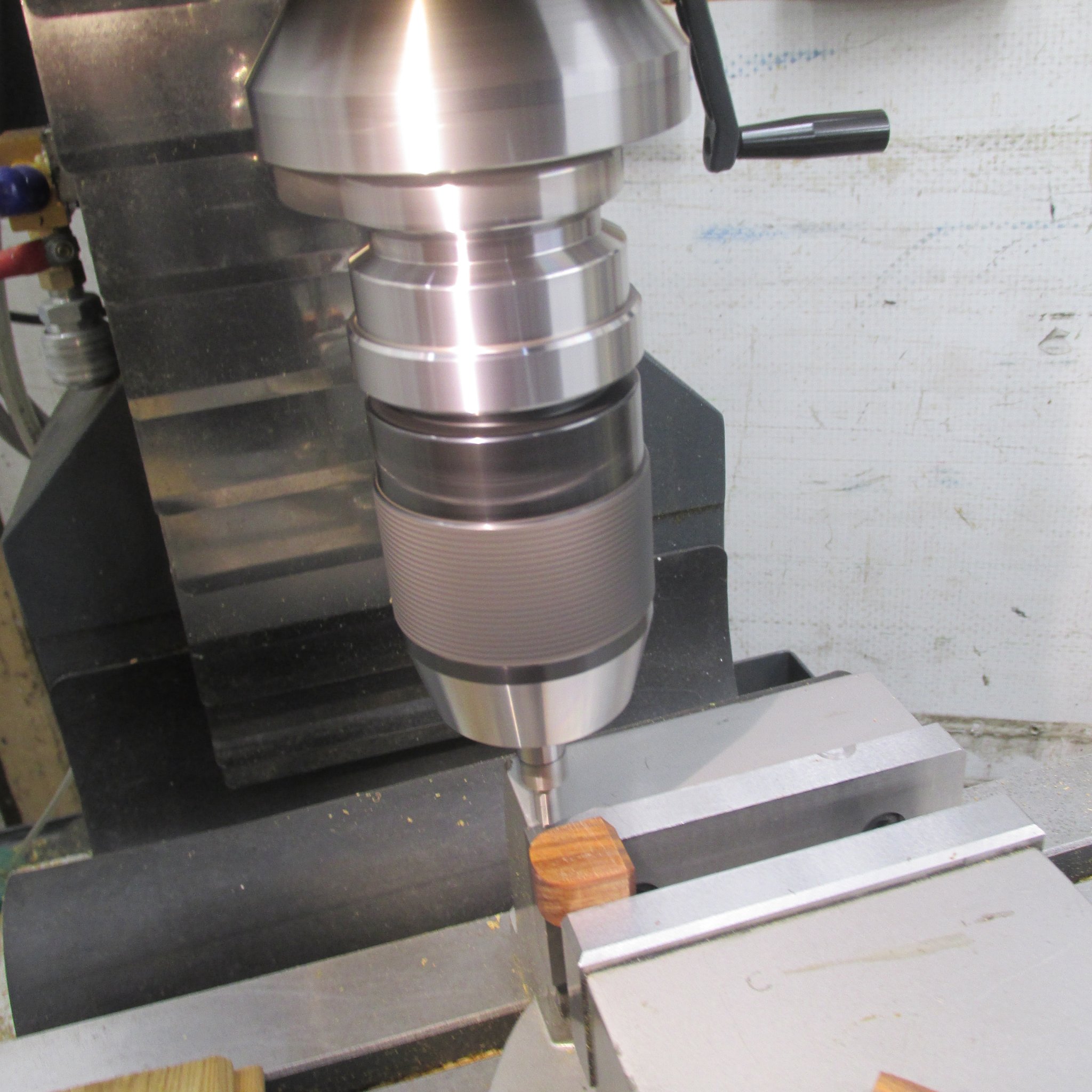

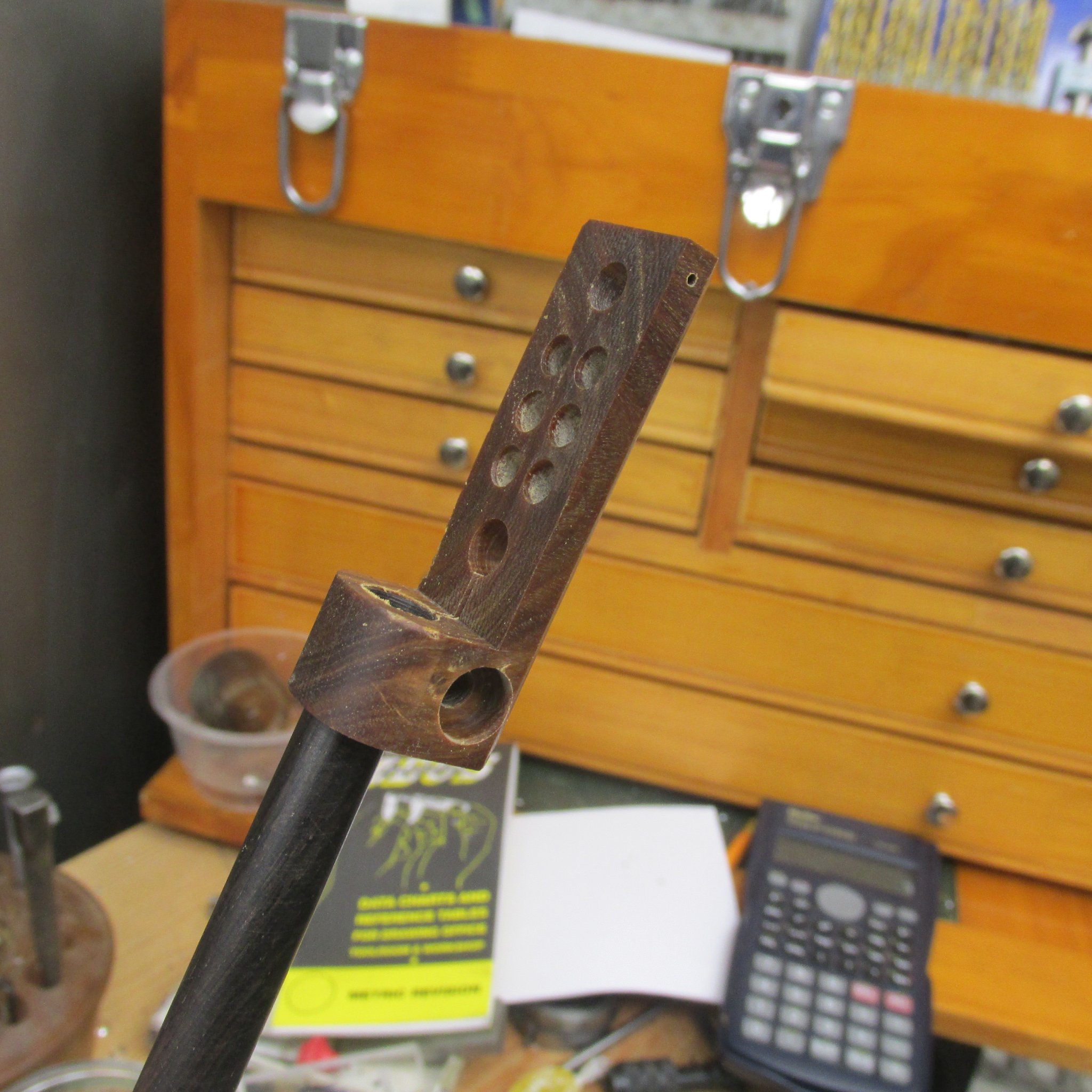

Hi I managed to get about four hours in the shop today which gave me a chance to make a good start on the headshell. there are three more parts of the headshell to make and a good bit of polishing and I need to send off to China for some titanium screws to make it look good.

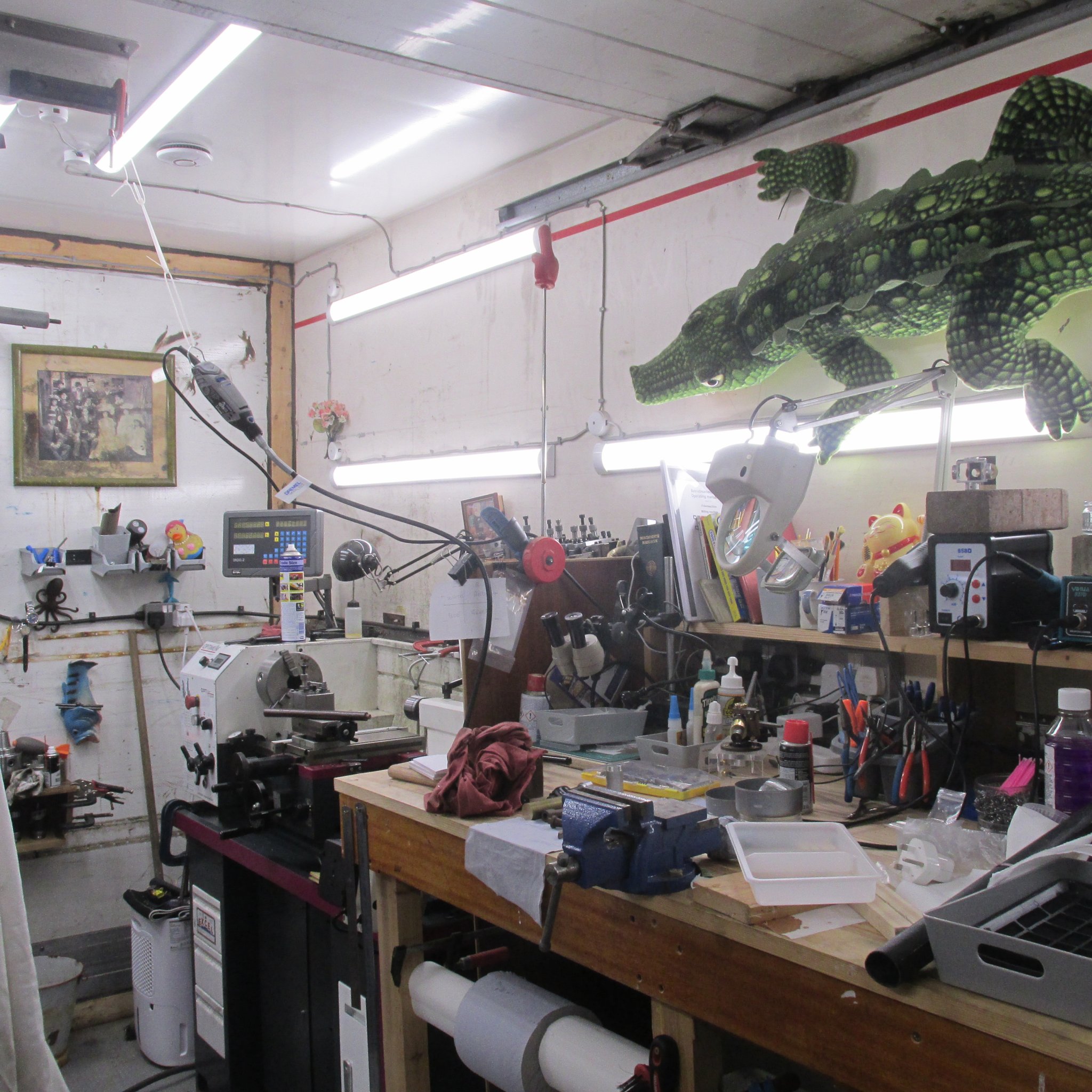

Hi the lathe is an Optimun made in China, not a very good machine but just about good enough
Before I retired I worked for near on fifty years in aeropsace. much of which was on a Hardinge c/lathe HLV????
regards Bob.

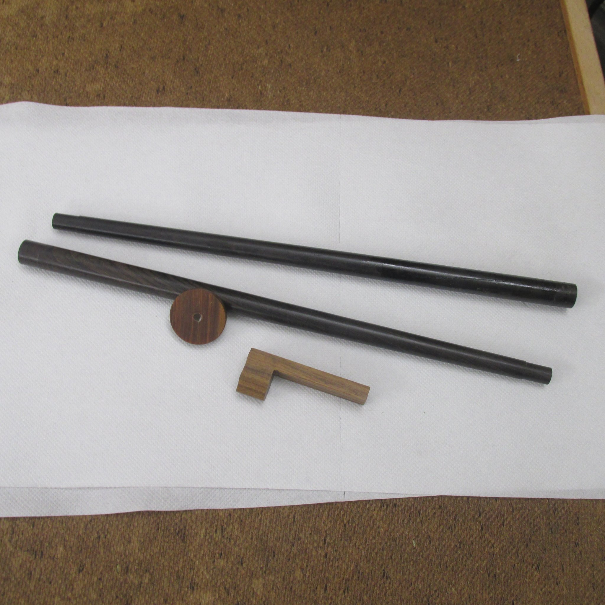

As I said in my last post I now have a working prototype bearing but it needs lot's more work to turn it into a working tonearm, I have two possable idea's but no idea which is best so I have desided to put the lignum vitae armtube and headshell aside until I know which of the two possabilities is the best way to go.
To day I turned two armtubes in African Black wood and started making a pair of simple headshell's towards testing the two possable design's.
See Photo's.

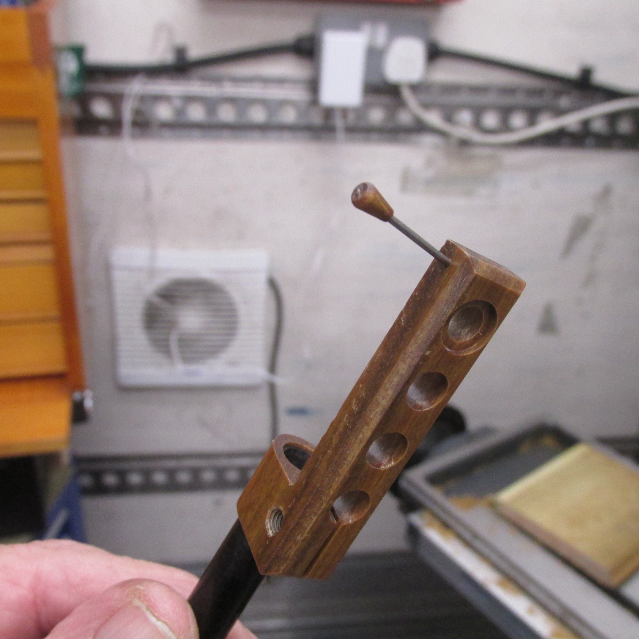

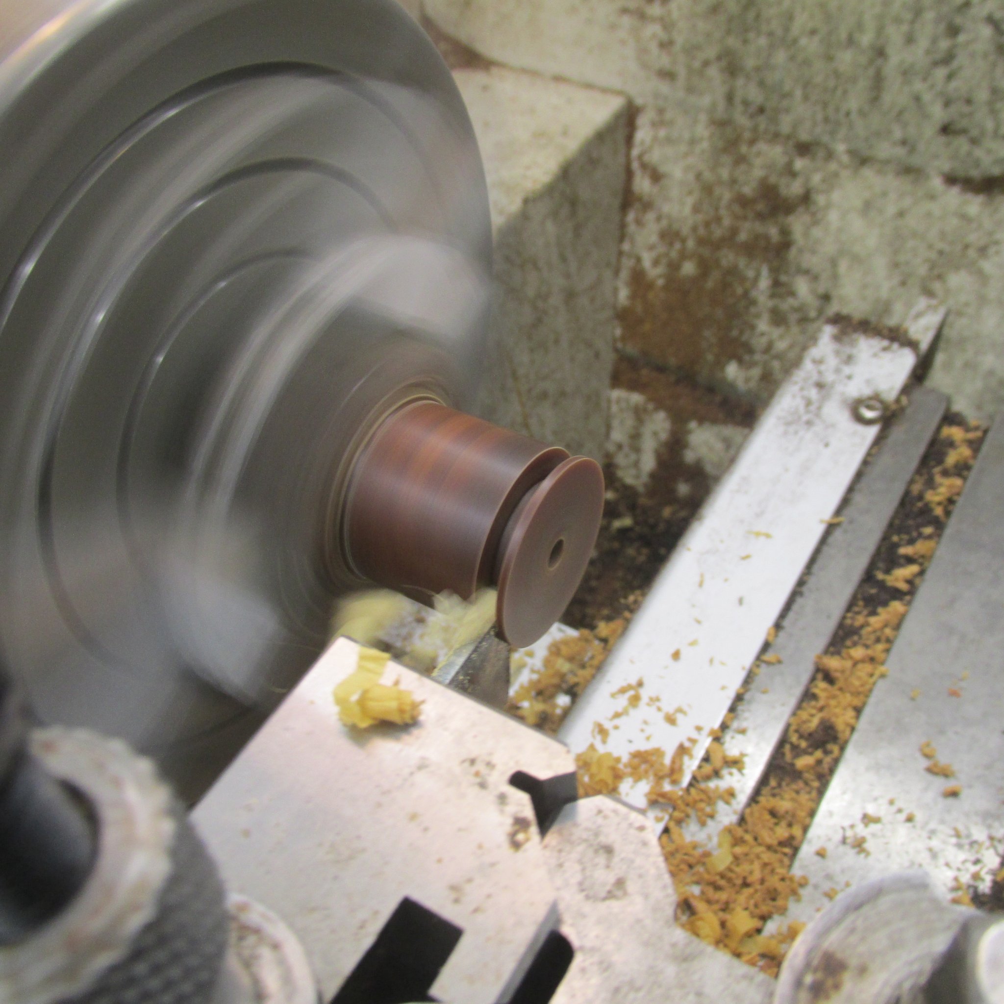

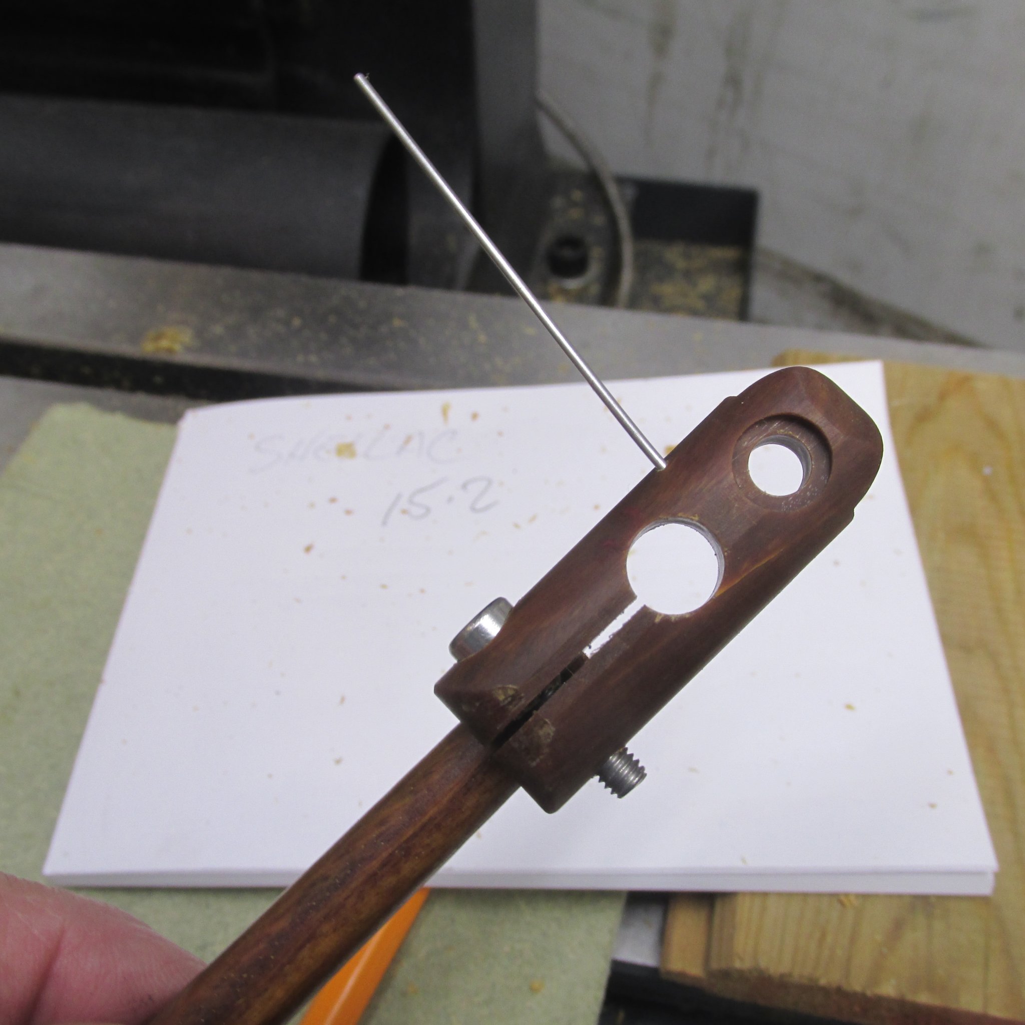

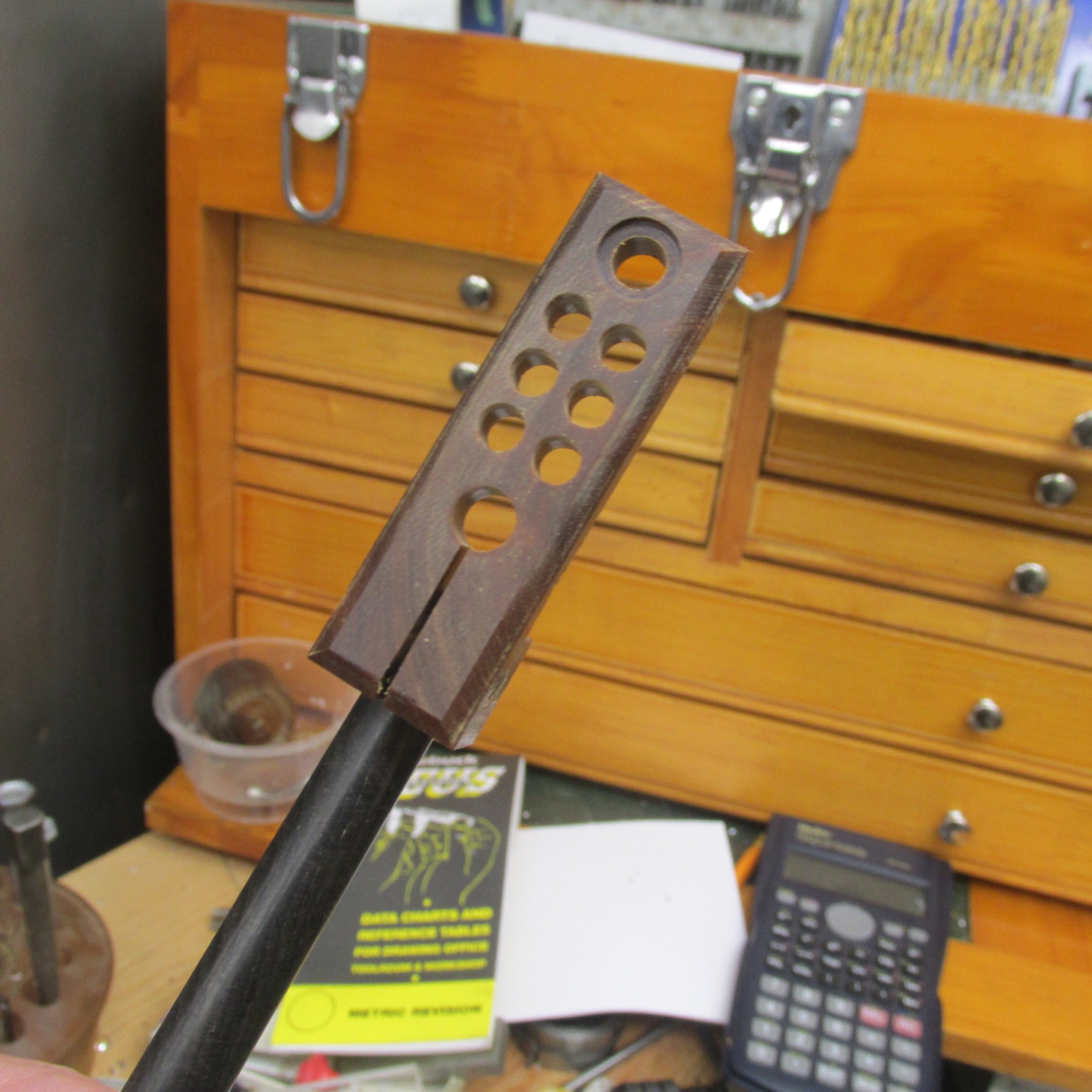

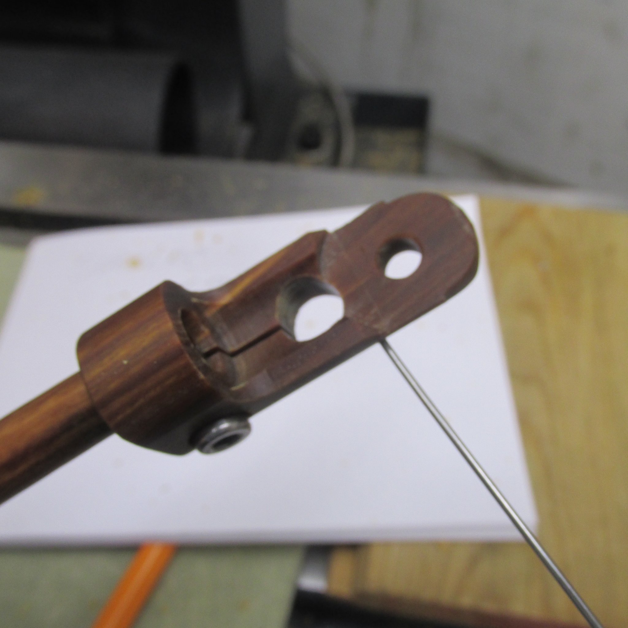

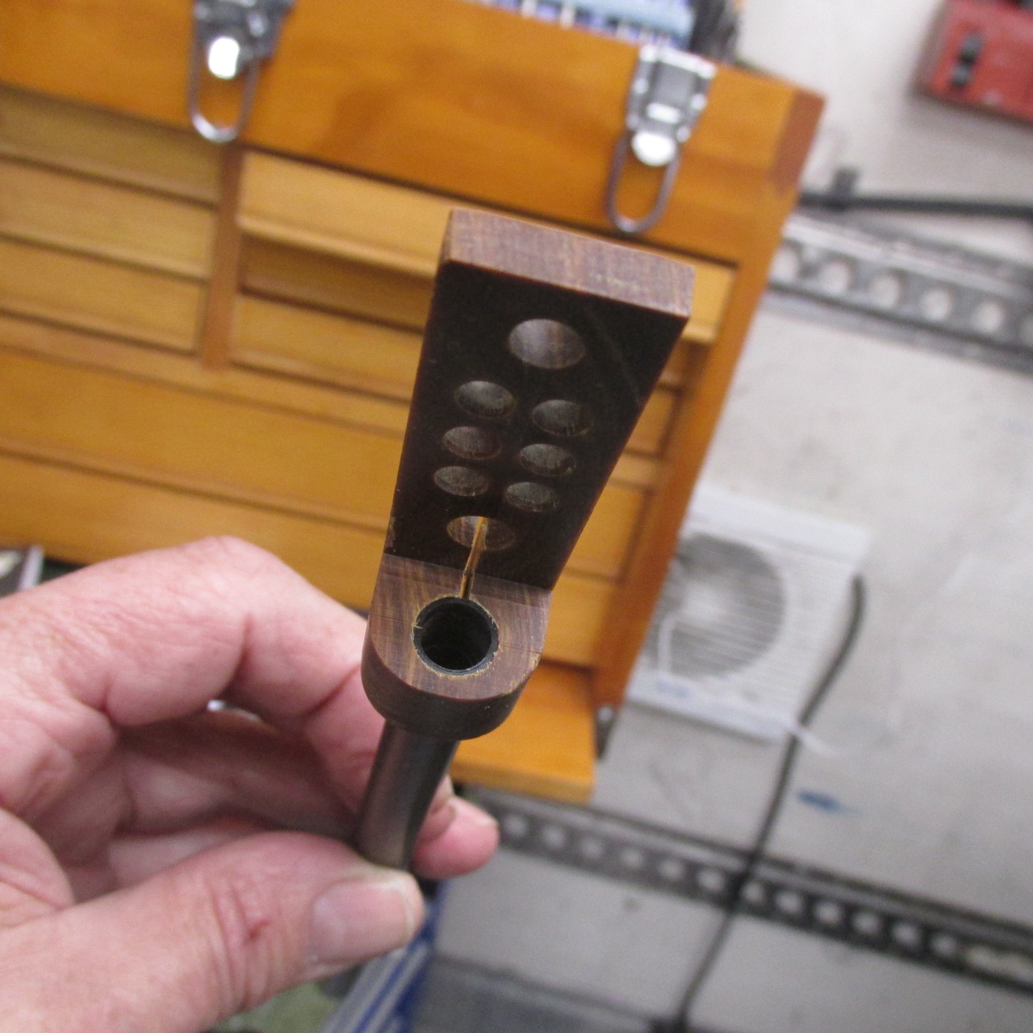

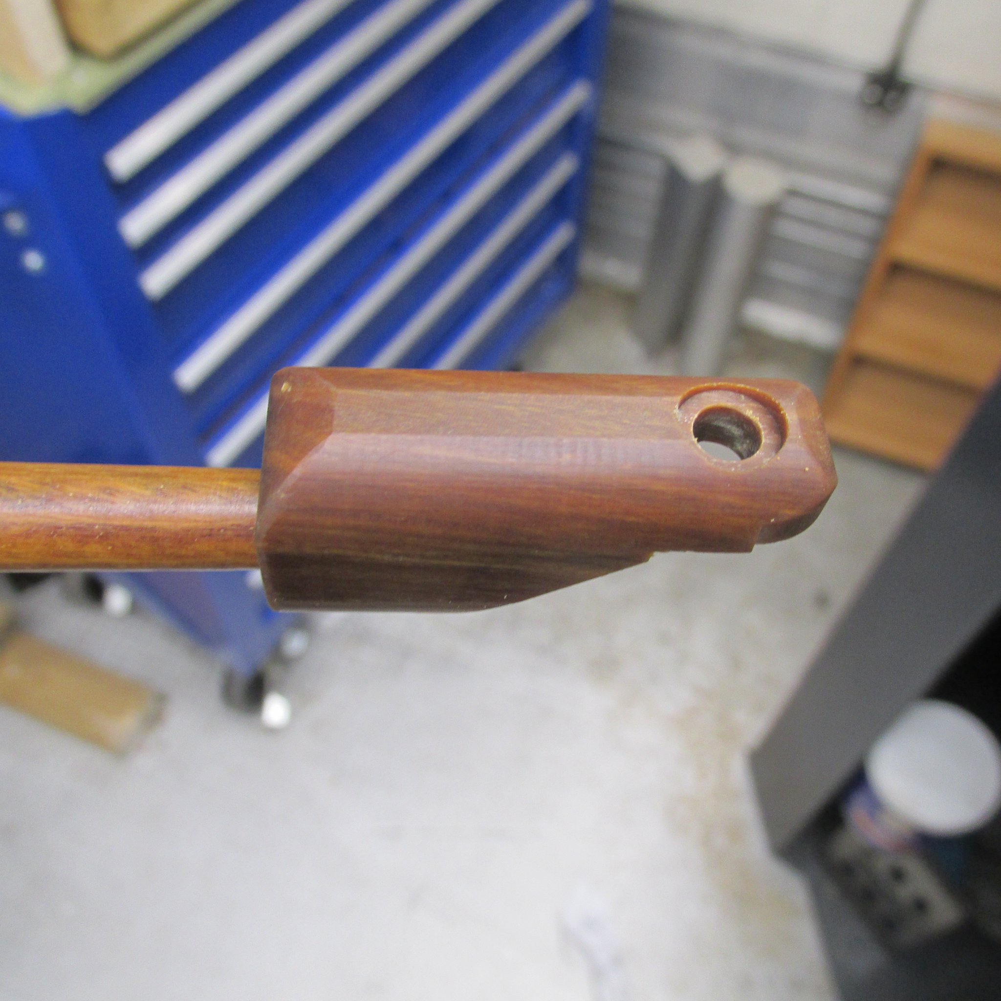

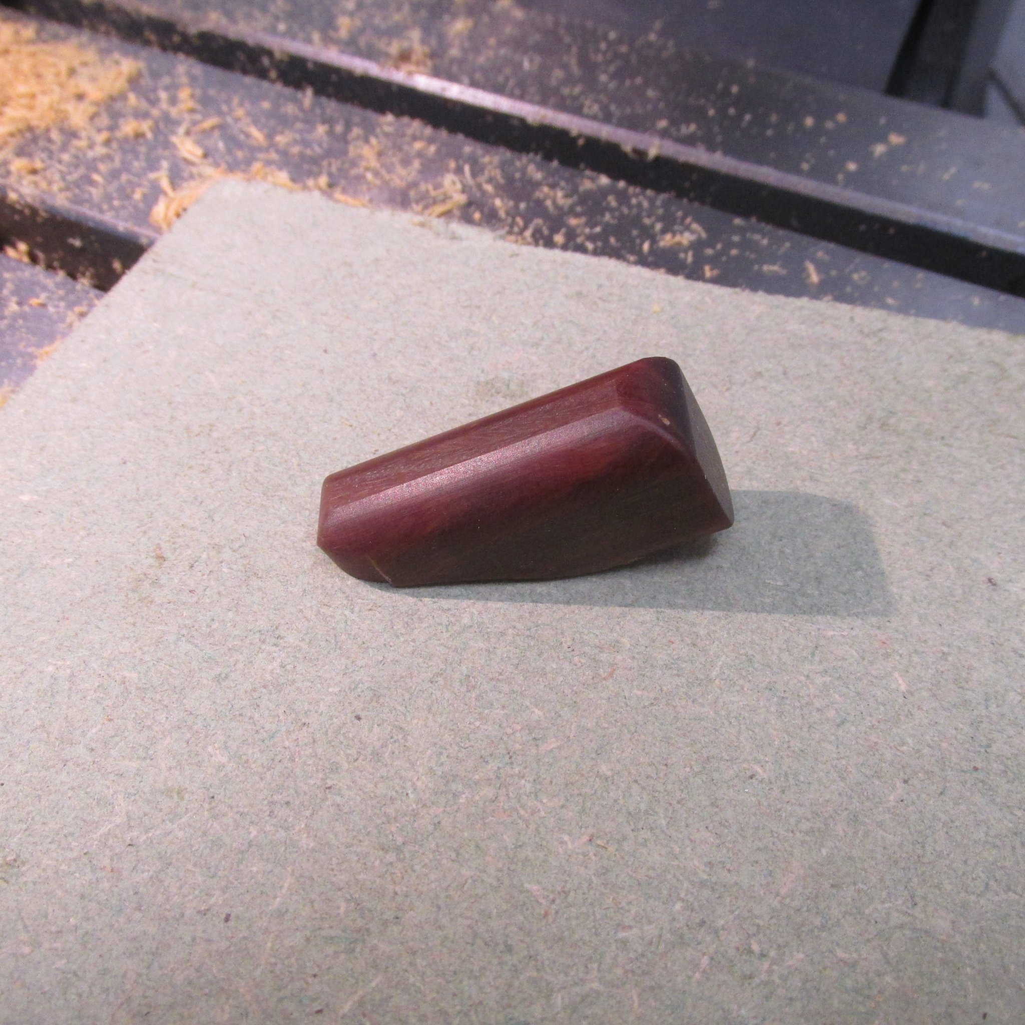

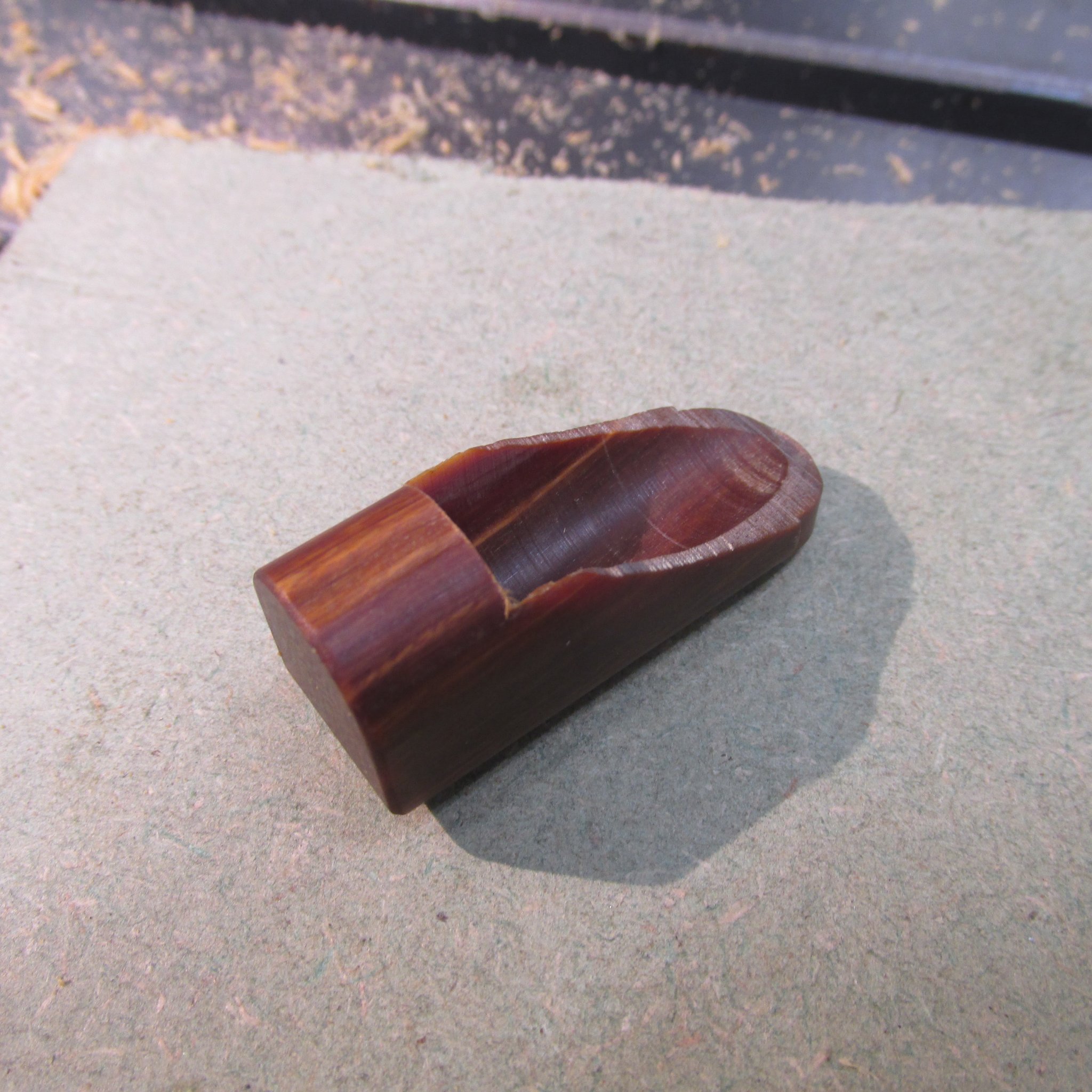

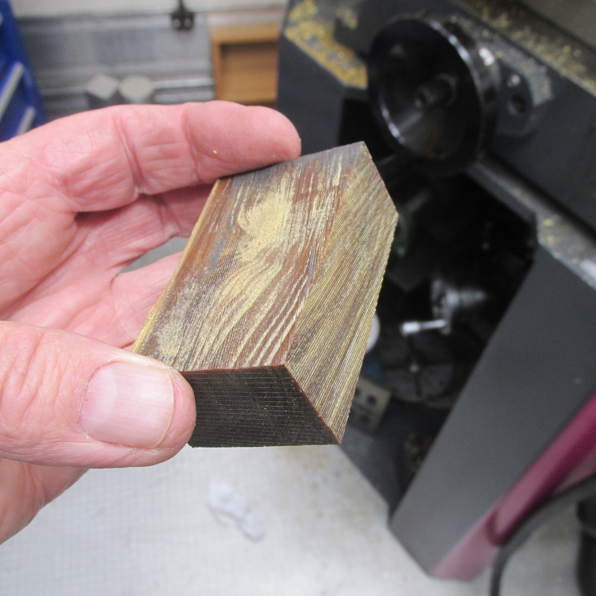

Hi this afternoon I got about three and a half hours in which got all the machining done on one of the new headshells, with the armtube it weighs 26 grams so far.
the headshell is made of lignum vitae cut from a bowling ball.

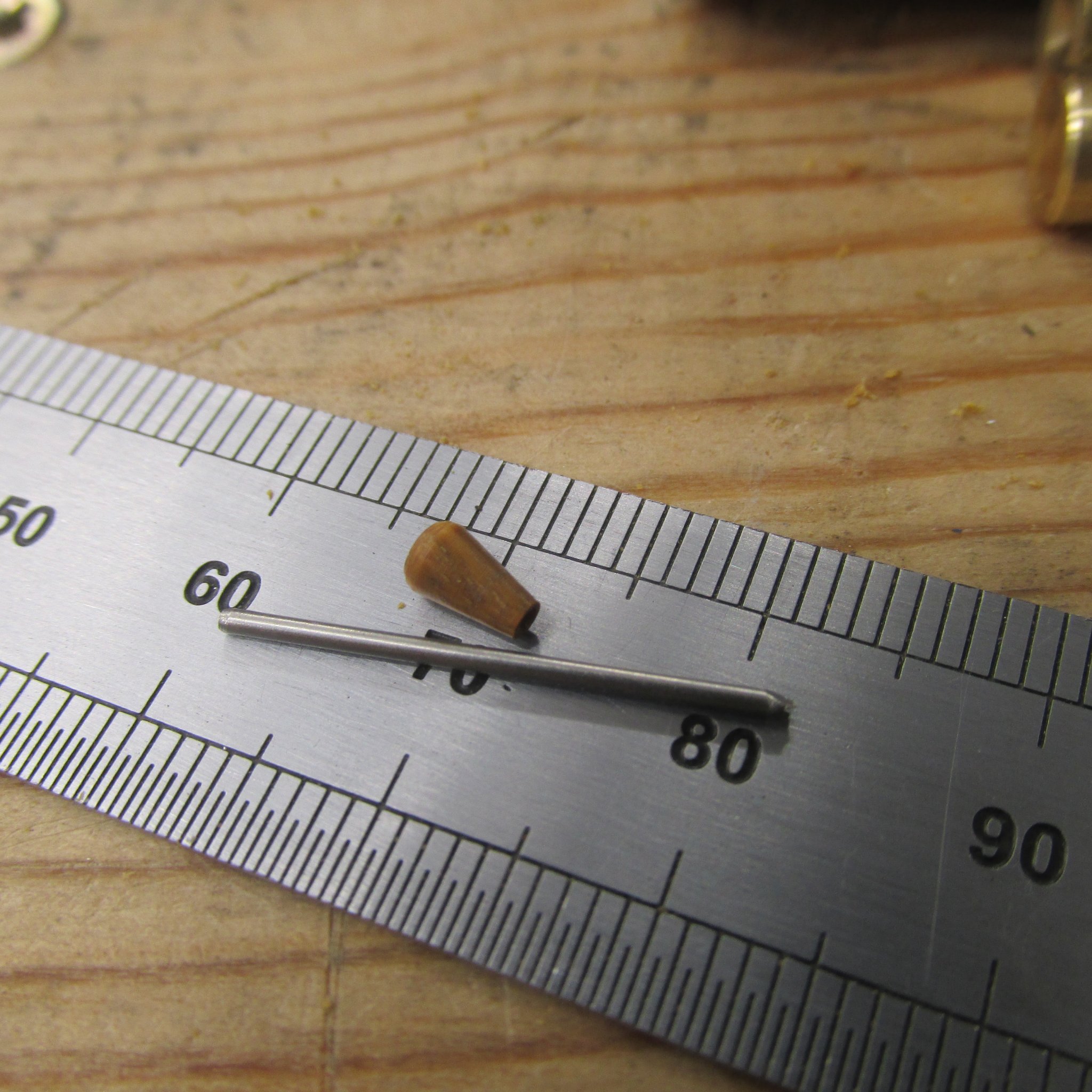

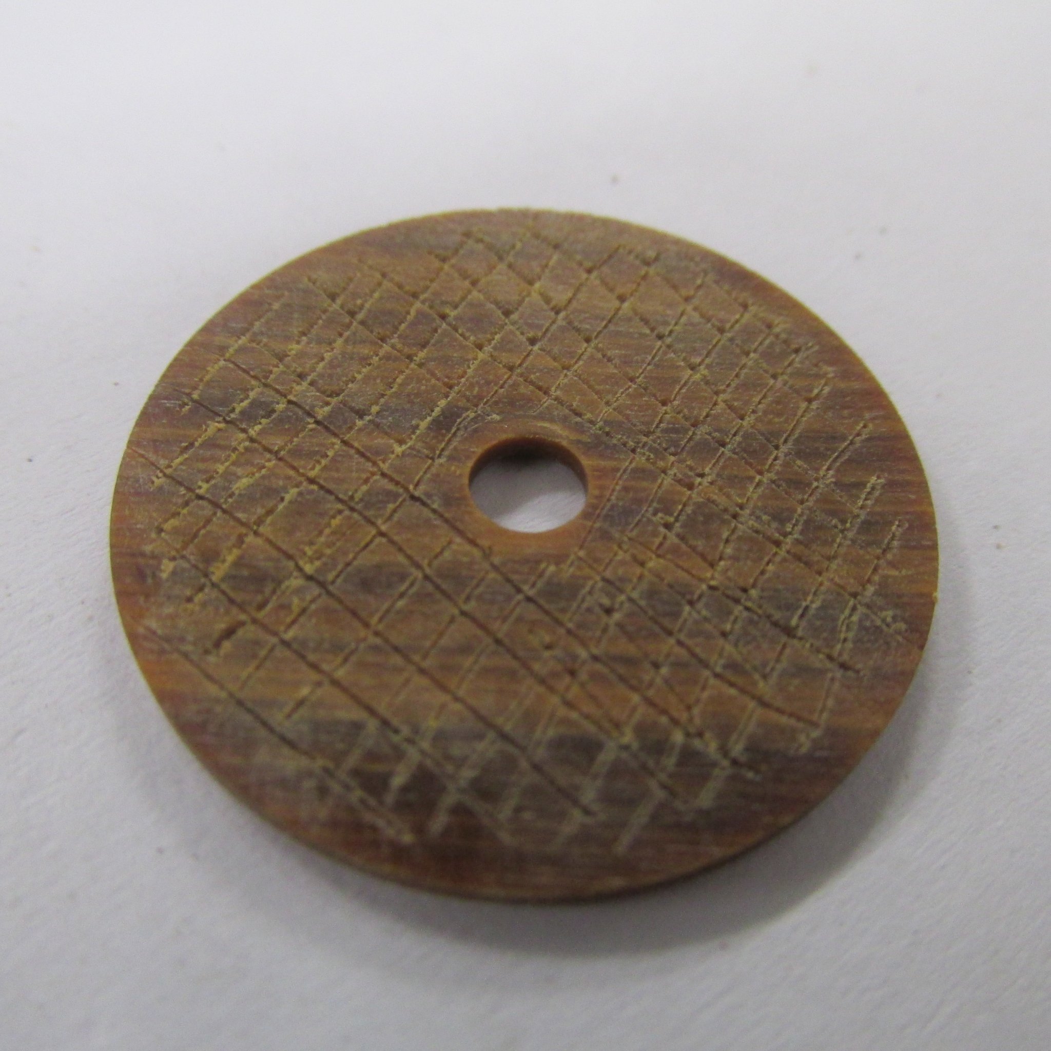

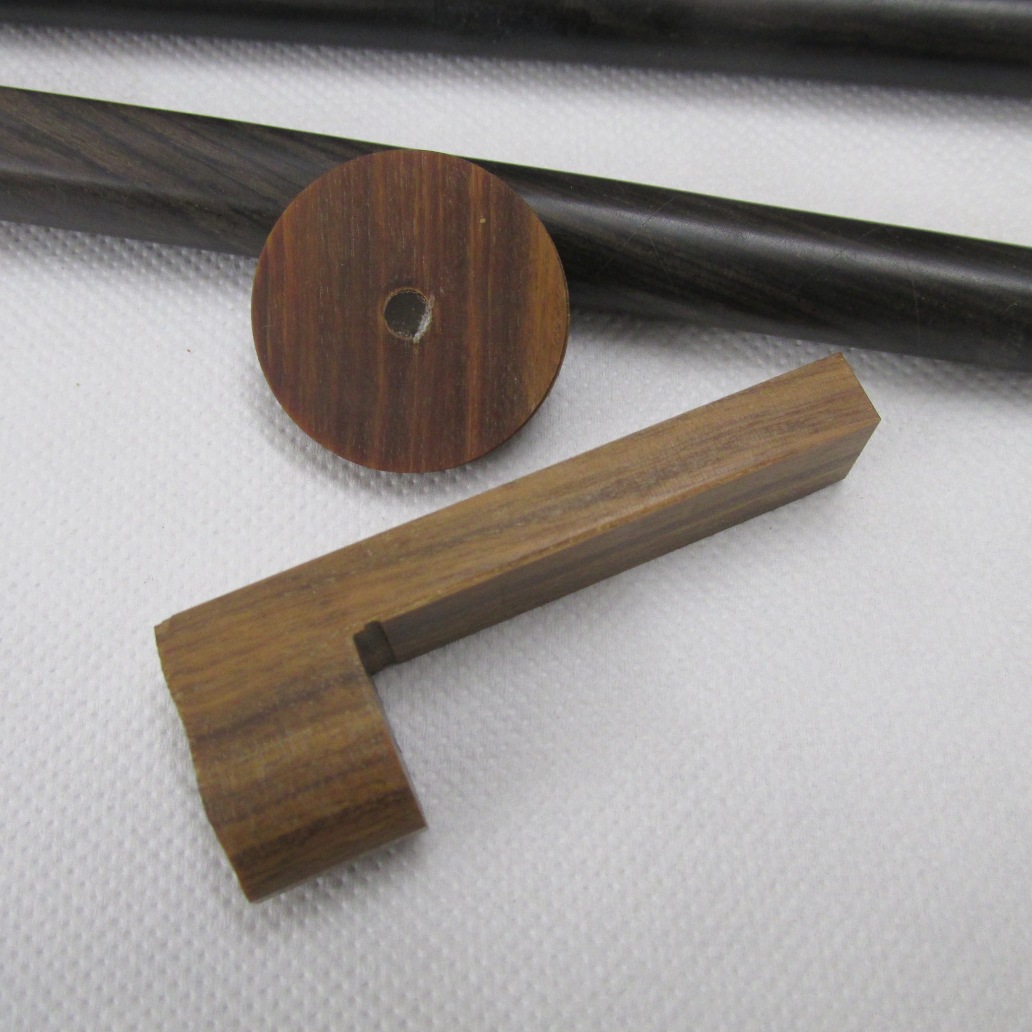

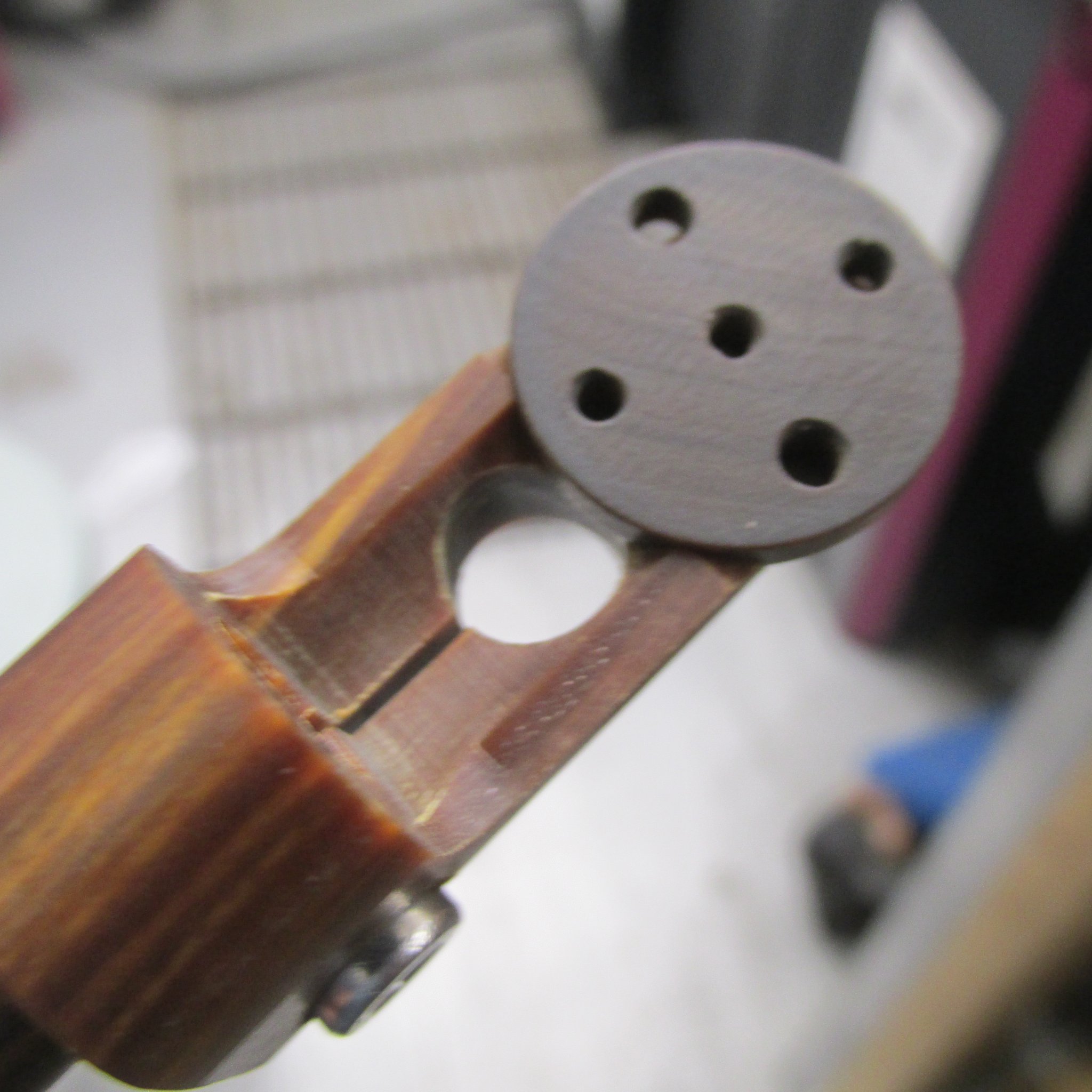

Hi again it's all the little bits and pieces that take the time, but I believe they are the most important thing when building high end audio.
Every last detail that may in some way enhance the final sound is well worth the effort, all the little details that by themselfs make a negligable difference to the overall sound, all work together to make high fidelity.

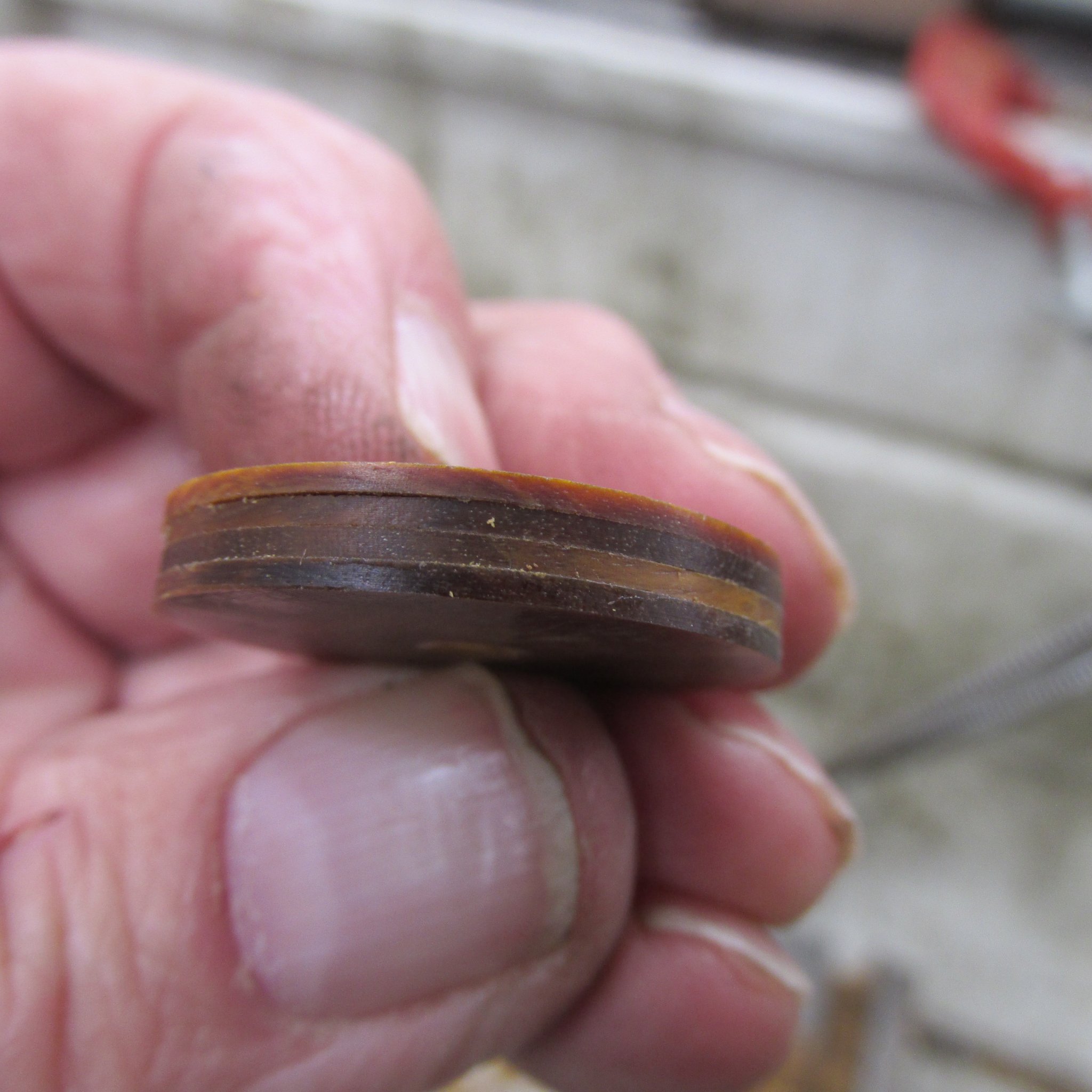

The headshell on my last tonearm was made from a laminate of ebony and lignum vitae bonded together with a secret adhesive the idea was to construct a very low mass with both high ridgidity and good damping. With this arm I am changing the balance a little in fabour of ridgidity by making the headshell from solid lignum vitae with a laminated damping pad between, to mount the cartridge also made from four 1mm layers of lignum vitae and my secret bonding agent. see photo's 1-3

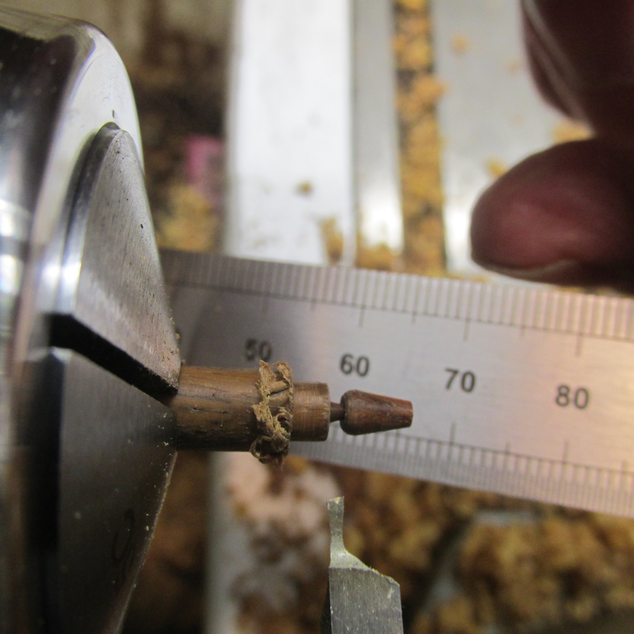

I also made the finger lifts using 1mm stainless steel wit a tiny turned lignum vitae head, there is no other wood that will allow itself to be worked like this, I am amazed it is no longer used as an engineering material as it once was, i have long searched the net for others doing precision work in this incredable material and apart from a couple of guys in the USA making clocks, I seem to be on my own.
