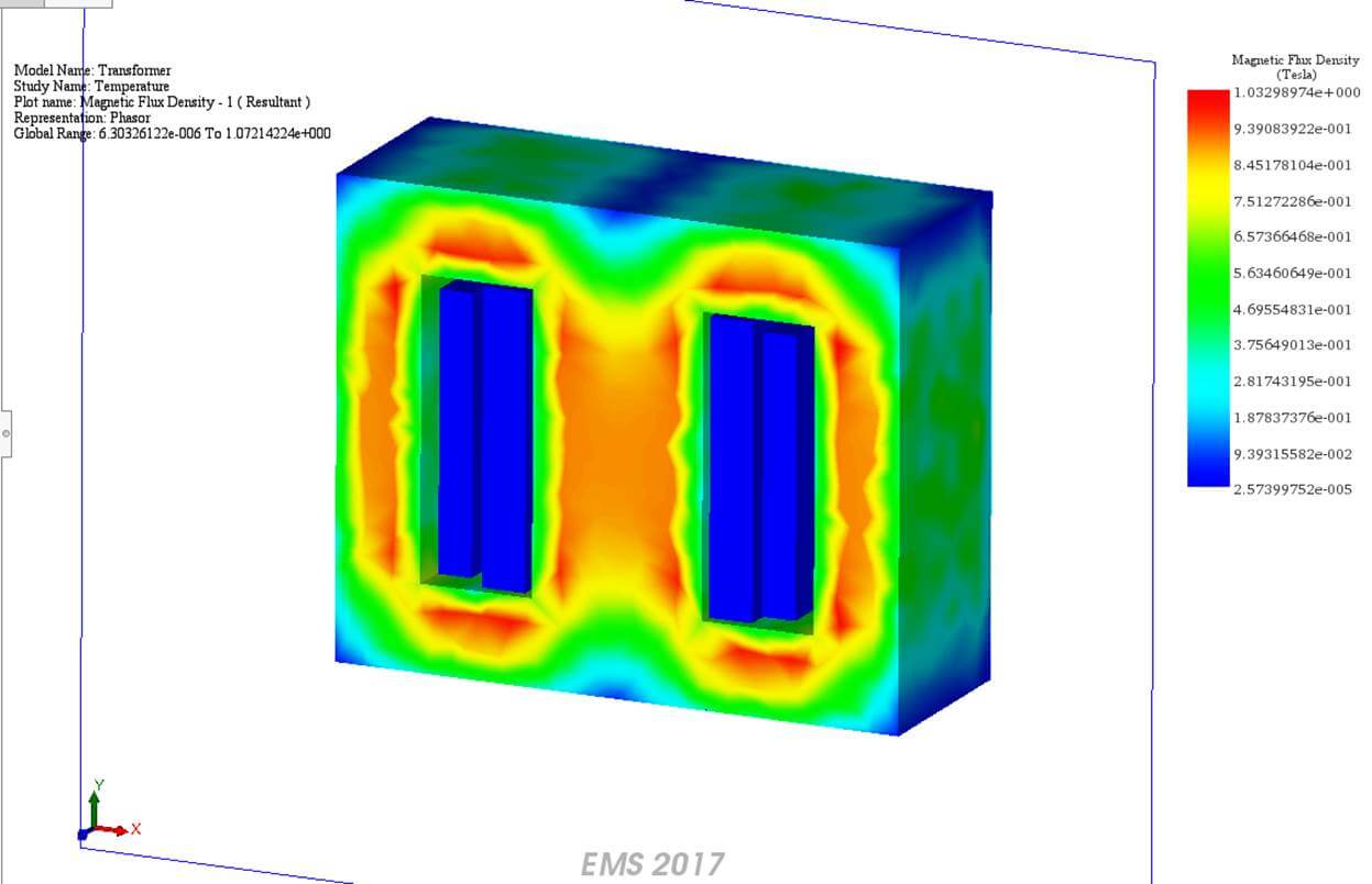

As I said earlier, the answer is to be found in Maxwell's equations, and a suitable software program that uses them to model flux density in a transformer core.
I found out that Solidworks (a very popular 3D CAD program normally used to design mechanical parts) also does magnetic flux simulations. The attached image shows a simulation of the magnetic flux inside a conventional E-I core. (Not my simulation, I found this on the 'Net here: Open & Short Circuit Transformer Simulation Tests inside SOLIDWORKS )
Long before computers and FEA (finite element analysis), scientists used a simple concept called "magnetic lines of force" to try to visualize and describe magnetic fields. It is not quantitative or exact, but the imaginary "lines of force" were found to have certain properties that always seemed to hold.
One of those properties is that the lines do not "like" to make sharp bends, and so I was almost certain, based on this old nineteenth century visualization aid, that the outside corners of a transformer core would have relatively low magnetic flux density. The lines of force would not travel right to the corners of the core.
I was right, but I did not anticipate just how dramatic the effect would be. Leaving the nineteenth century aside, let's look at the Solidworks simulation, a very 21st-century way to look at the same problem of magnetic flux density in a transformer core, but this time with considerable accuracy.
Look at the image closely. According to the scale on the right side of the image, the red areas correspond to a flux density of just over one Tesla. Meantime, the outside corners, in dark blue, correspond to a flux density of about 2.6 x 10^(-5) T.
That's 0.000026 Tesla. Which is thirty eight thousand, four hundred and sixty two times weaker than the 1 Tesla flux near the centre of the core.
Eddy currents are driven by the magnetic flux. If the flux is nearly forty thousand times weaker at the corners, so are the eddy currents there.
In other words, there is so little magnetic flux at the corners of the transformer core that you could weld them all solid, and it would make a negligible difference to the transformer.
Peavey's decision to weld their transformer corners was not stupid at all.
The microwave oven engineers who specc'd welded transformer corners are not stupid, either.
The worst we can say about these welded cores is that they make life difficult for DIY transformer rewinders. True, but hardly a unique case; manufacturing has been moving towards non-repairable products for a long time now. My entire Fender SuperChamp XD guitar amplifier was described as "not serviceable" by Fender Corp themselves - they want you to pitch it in the recycling bin if it ever stops working. 😡

I'm glad that this has actually stimulated some intelligent discussion. I've even learned more in the process.
BUT....going back to Maxwell's Equations for magnetic flux saturation, I must ask, are you taking the operating frequencies of the transformer into account?
Those equations are VERY frequency dependent. Flux will be most concentrated at the center of the core in any event but as frequency is decreased, the differential in flux density will reduce.
Now find those equations, if you care, and run the numbers in the audio frequency range as is suitable for a guitar amplifier. Let's say the range from 80 Hz to 8 KHz.
I think you will find that welding the edge of the laminations on an audio frequency transformer has much greater consequences than you might have thought, if you were basing your original estimation on doing the same thing on a microwave oven's transformer operating at 2,400,000,000 Hz.
Ultmately, I AM right, but the level to which it actually MATTERS to the performance of an audio transformer is still a matter of debate that won't be solved until someone actually takes the time to work it out mathematically using a reasonably accurate mathematical model of the transformer.

Everyone in this thread agrees with what you said so far. The question is, how much will it alter the eddy currents, and how much change in efficiency will it cause? 10%? 1%? 0.1%? 0.01%?...electrically connecting the plates will alter the eddy currents for sure causing more heat and thus less efficiency
In post #42, we found out that the magnetic flux density at the outer corners of the transformer core is four orders of magnitude weaker than it is near the coils. In fact, for the particular transformer being simulated, it was nearly forty thousand times less.
Since it is the magnetic flux that drives the eddy currents, and there is no magnetic flux to speak off at those outer corners of the core, welding them at that location will have minimal impact.
It would be a very different story if you welded the laminations solid in the regions in red in the image (in post #42). That would cause enormous eddy current losses.
-Gnobuddy

Actually, one weld bead will not be a problem, even if it's in the red area. The problem arises when there is more than one weld bead, and the flux goes between the beads.Everyone in this thread agrees with what you said so far. The question is, how much will it alter the eddy currents, and how much change in efficiency will it cause? 10%? 1%? 0.1%? 0.01%?
-Gnobuddy
Two beads on the outer edges should not be much of an issue.
What I have not seen mentioned yet, is that a weld bead will bond all the laminations electrically together. That means that all you have to do is bond one lamination or the bead to the chassis in order to prevent any of the laminations from becoming electrically hot to ground in the event of a mishap with the windings.
