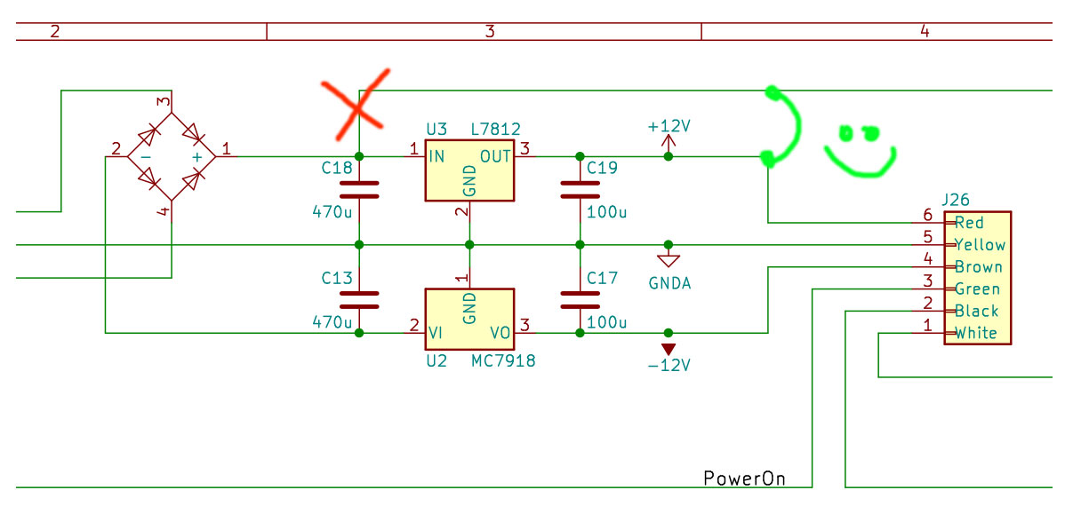

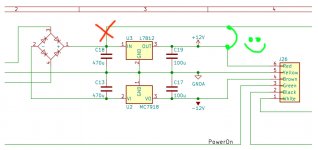

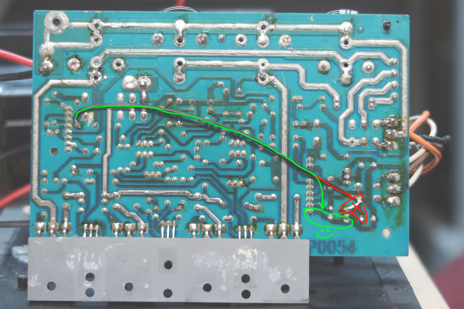

Finally fixed my 120hz hum. I had already tried:
-replacing bulk capacitors for the +/-80v rails
-replacing +/-12vdc voltage regulators
-replacing +/-12vdc regulator capacitors (4 total)
-twisting primary and secondary windings on transformer into twisted pairs
-adding tiny tantalum capacitors to the +/-12vdc regulators
The things above helped revive the amplifier and get it working again, however I still have a 120Hz hum that was clearly audible from my couch.
The solution was changing the 12vdc supply for the speaker protection relay from the input side of the +12vdc regulator to the output side. See pictures below.
I believe the factory originally had powered the speaker protection relay from the 80vdc positive rail and decided that was a bad idea. You can see where the trace was sanded off the board on the left side of the picture. The factory appears to have added a black wire to power that relay from the +12vdc but they soldered it to the input side of the +12vdc regulator which has a strong 120Hz ripple from the rectifier. I think the ripple went through the relay coil and into the (everything) ground and resulted in noise (everywhere).
When I moved that wire to the output side of the +12vdc regulator, the 120Hz noise stopped and the amplifier is dead silent now. Hooray! I hope the pictures below help.
Also, I made a schematic of the amplifier board if anyone wants it. It's a rough draft and I likely made a mistake in there somewhere, but it should be useful.
--> Find the schematic over here <--
