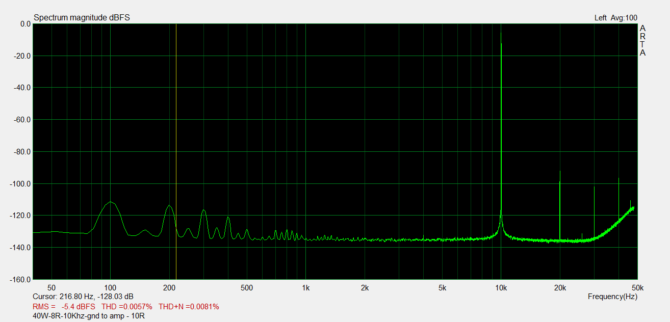

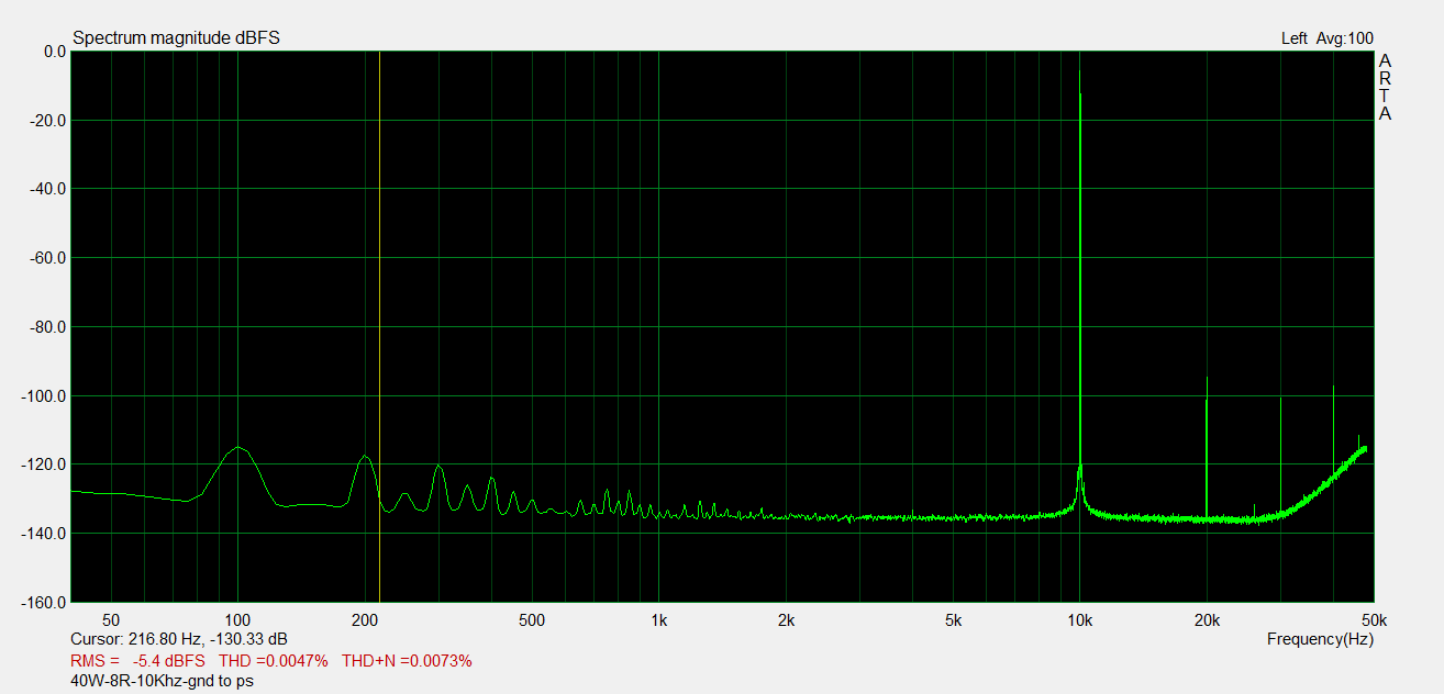

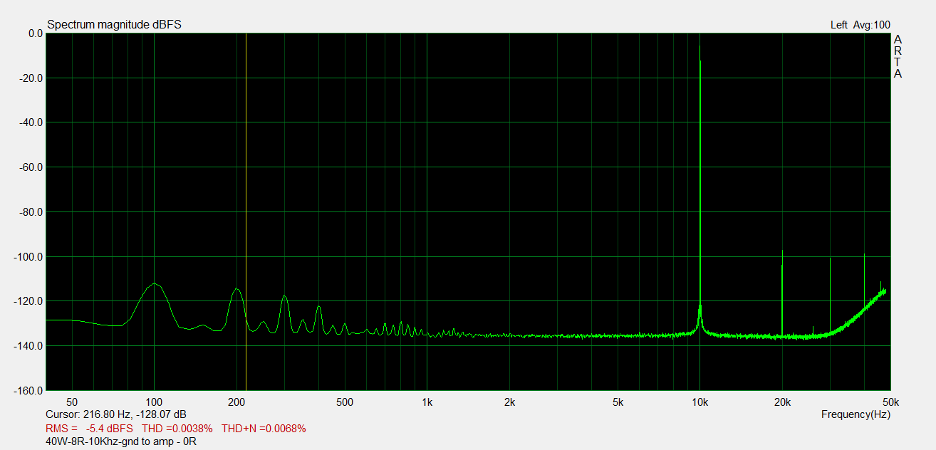

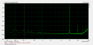

Nothing like testing stuff yourself.
Here are three measurements made on ARTA. All are made at 10khz, 40W, 88.2khz sample rate. They are made on exactly identical amps (two channels of a lm3886 stereo amp, measuring the same normally). At 1Khz, differences were too small to measure.
The first shot is made on an amp on which the speaker return goes back to the amp pcb and without hum breaking resistor. 0.0038% thd, 0.0068% thd+n.
The second shot is made on the same amp but moving the speaker return to the PS. 0.0047% thd, 0.0073% thd+n.
The last shot is made on the second channel, which has a 10r hum breaking resistor between signal and power ground, with the speaker return going back to the amp pcb. 0.0057% thd, 0.0081% thd+n.
I don't think you are performing the kind of measurement that would probe the effect of these changes to the circuit - at 40W I doubt that any hum or other interference will have a large enough contribution to change your distortion readings. So the result is not surprising to me.
What would be more revealing is a test of what is happening with no input signal (but all interconnects and speaker cables connected) to look for differences in the noise floor under the three different scenarios you mentioned.
Well, I wasn't after hum with these. I was rather trying to see the impact of where to return the speaker's return on thd and if the HBR had an impact on the performance of the amp. Some (Tomchr among others) have discouraged the use of HBRs.
So I needed heavy currents flowing through the various return and ground wires. Hence the 40W. And the impact shows mostly at higher frequencies, so 10Khz.
At this point (but it needs further testing), it looks like the use of HBR might be an exercise in balance: a bit more thd at HF but less susceptibility to ground loops. The value of the HBR is worth investigating too. I'm a bit surprised at Mark's suggestion earlier on; it seems a bit low when most places suggest 4.7r or 10r.

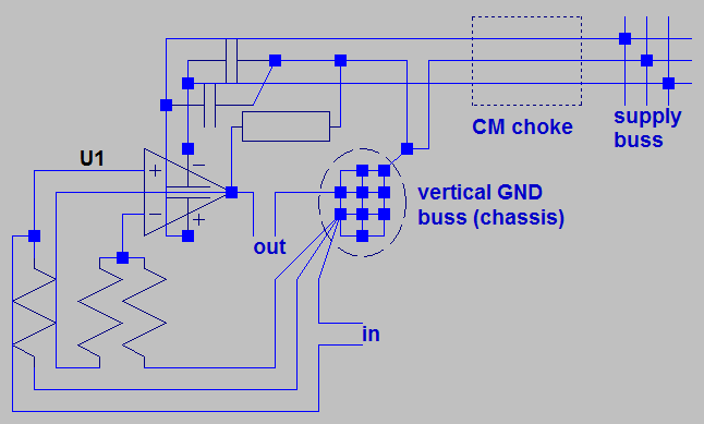

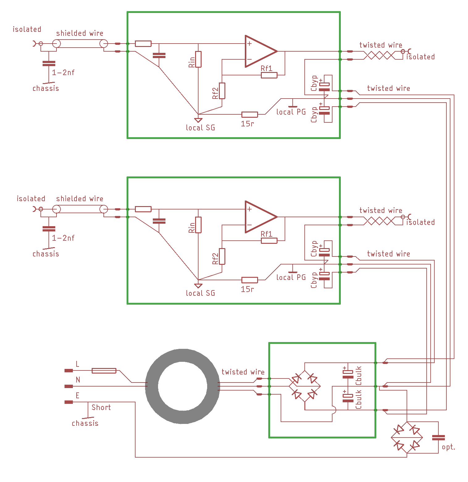

See drawing below how I layout and wire simple multi-channel (chip-)amps, eg for active speakers, when all inputs are fed from the same unbalanced source multi-channel DAC. All the input cables are tightly bundled together to minimize loop area, no pickup of external hum fields that would force ring currents along any two cable shields where the I*R drop then could cause an error signal.
The unbalanced connections automatically leads to a scheme were input and load reference must be at the exact same location with no other shared currents for lowest possible errors. And for EMC considerations this reference should be the metal chassis in the connector area which could be backed up with a piece of copper/alu sheet metal for lowest resistance and inductance, in fact a fat GND buss bar. The two signal GND connections to the amp core (input bias resistor GND and feedback network GND) are separated from the input shield connection to the buss to avoid errors from shared currents.
Not immediately clear from the drawing is the layout of the small signal components and wiring so that there is minimal area of receiving loops (an excellent testing tool for immunity here and elsewere is a tape head demagnetizer) and the high impedance traces are short or shielded for low capacitive pickup as well.
Right at the amp chip there is a rail-to-rail cap for stability, plus local bypasses, their center point also is the return of zobel/boucherot cell. After that point the local "power GND" has a path to the GND buss which is considerably higher Z than the buss bar. This is alse the return of the speaker current to the local bypasses for mid/high frequencies.
The supply bus is decoupled with a common-mode-choke which forces the net current through the choke to zero which confines recharge currents in that area. Note that the supply loop area for spiky recharge currents is minimal, for low coupling into signal lines (including the output).
The output return loop is larger (but still designed to be compact in absolute terms in order for stability into capacitive loads) and will emit a bit of audio-frequencies magnetically but since this current is very signal-correlated there is little harm done when some microscopic amount of this field might find a way back into the amp. The section of the loop which is prone of receiving fields itself is made as short as possible (amp output to GND buss) because it is outside of the feedback loop. Not shown is a L//R-cell in the ouput "hot" to prevent RF entering the amp from the speaker line.
Interconnect cable shield balancing current from the source directly enters the GND buss and will find a way to the AC-line only through the CM chokes which helps reduce it for higher frequencies. The supply itself is floating with respect to PE, that is, necessarily a class-II supply (preferably with low mains coupling by winding design), and the metal chassis is floating as well so there is little balancing current to mains line to begin with.
If one wants to use class-I supply where all its metal surroundings must be bonded to PE and the secondaries also must have path to PE than can stand fault current long enough to trip a panel breaker then the supply needs a separate PE'd metal enclosure to fulfil class-I requirements and a RCD isolator from its 0V-output to PE. But the main chassis and GND still is *not* bonded to PE directly, rather the balancing current PE path is through the chokes and the RCD. This is a form of functional earthing as opposed to safety earthing. Balancing current now has a rather low-Z direct path to PE (at audio frequencies) and this might cause I*R drops in the interconnect shields when the source has a low impedance wrt PE and the PE potentials differ. There is no way to avoid this other than with a true floating supply and chassis. Further, cross balancing current between different sources can arise even when the sink (amp) is fully floating, this can be mitigated by using complete mono-block construction where every channel has its own shielded (and preferably floating) enclosure.
Unbalanced interconnects make life hard as we must strive for zero balancing current on the shields, this is of paramount importance.
Balanced inputs looks easier for obvious reasons but the devil is in the details, especially when connected to unbalanced outputs.

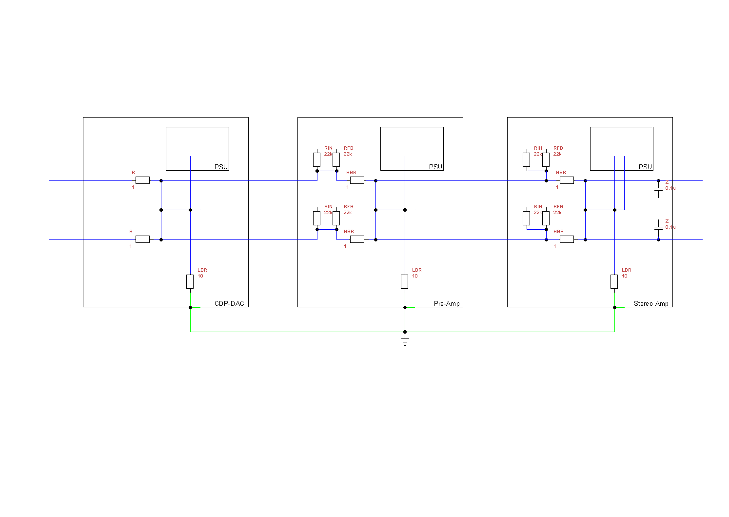

Two other schemes. One is based on Cordell's book. Speakers return to PS, zobel at input/output.
The second is hifisonix's. Speakers return to amps pcb, ground loop breaker.
If I understood Mark correctly (a caveat for all schemes btw, correct me if I've misrepresented someone's position), it would be close to his, but with 1R HBR (+ diodes across the HBR) and a resistor in // with the groundloop breaker ?
Edit: I explicitly added the input rf filter to the amps this time.
Edit: we're missing AndrewT on this thread. Maybe would I have finally been able to put into a schematic exactly what he meant with his MAG. 🙁
