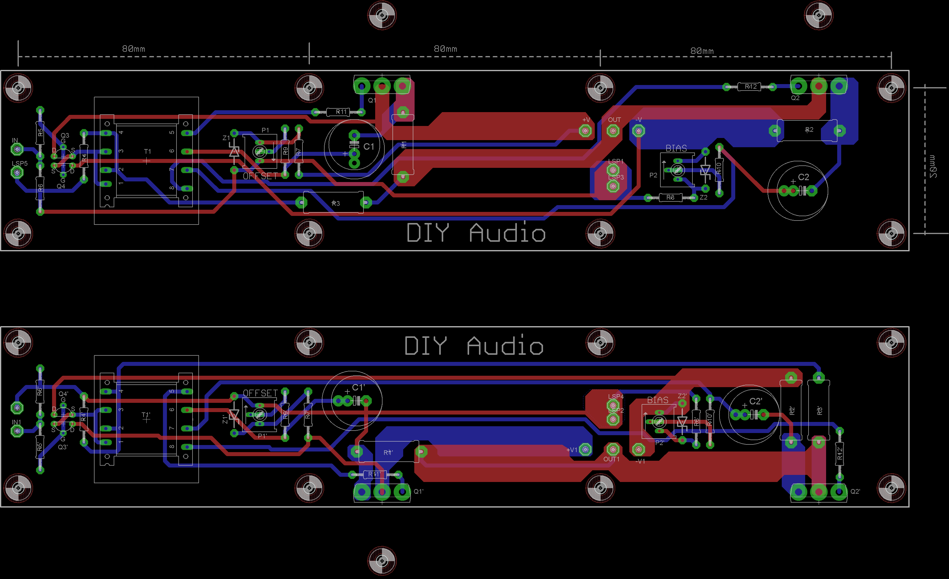

maybe move the inner transistor 40mm closer to the transformer, for more effective use of the sinks?
For clarification, for inner transistor you mean Q1 ? And by mean transformator you mean Jensen or toroid ?

Yes, I was mostly concerned about the soft voltage regulation with such low current. The gate bias voltage would drift around somewhat with power supply variations. Maybe 3 series red LEDs could be used in place of the zeners?
yes. Q1. and Jensen transformer.For clarification, for inner transistor you mean Q1 ? And by mean transformator you mean Jensen or toroid ?
Didiet
I would move the trace for the Q2 gate resistor (R12) to the top of the board, so you don't need to bite a piece of the source trace. You can easily do it in the center of the board, nothing on the bottom layer there.
Ok, I see the difficulties, but give it a though! 🙂
1) Move Gate traces on the top?
2) Make a turn around 7 and 8 pin of the input transformer to put that gate trace above. Does it make any sense? (Still at work... brain is melting) 🙂))

Member Didiet78 has done some preliminary layout, (Thanks a million! It looks wonderful!!)
The floor is open for discussion. 😀
How about a pair of test points for each source resistor, for easier biasing?

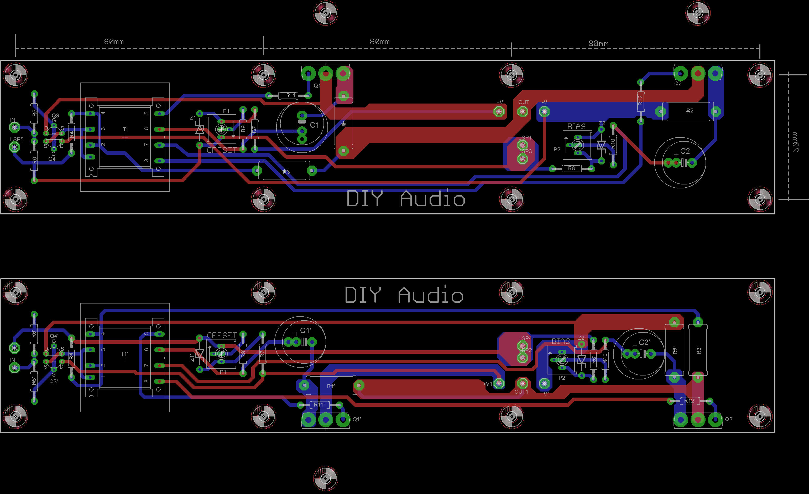

Did i got it right ?
Yep! Top one is good. The bottom one is a bit too crowded around Q1. I think we can try to work it out. Will look carefully tomorrow, too late tonight.

Looking nice already, ...but since we are asking: what about placing trimmers in paralel to R1 and R2 for variable second harmonic adjustment ?
That would be even nicer 😀
what about placing trimmers in parallel to R1 and R2 for variable second harmonic adjustment ?
If you want that type of adjustment, use the Tea-Bag PCB - they have pots in the output source resistors.
I do have those PCBs and they are about to sing...but this is for these mosfet ones 😉...just a thought.
Change to use both transformer styles?
Would it possible to set the board up so it could use either the leaded or the pcb transformer versions similar to what was done by Permaneder on the VFET amp board?

The PCB will be designed to only mount the specified Jensen transformer, but I'll look into the possibility of a second set of pads, if possible, to mount a Lundhal or something... No promises.
