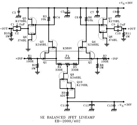

OK, let me be the first one to place schematic here. I didn't try it so I don't know (actually I don't have any experience with preamps because I don't use them) how it sounds. It looks good on paper, it is SE, it is different than Nelson Pass designs and it comes from Erno Brobely. It is ALL-JFET design so Harry should be happy, it has balanced in and out, it has current sources and output buffers. It is similar to early John Curl designs for Mark Levinson. Any comments?
For further reading this is the link: http://www.borbelyaudio.com/
