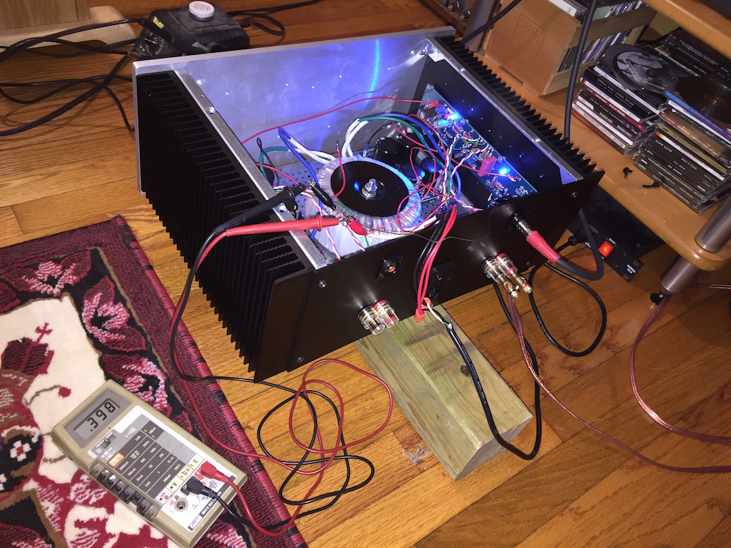

Halfway there! We had some technical difficulties for this build. I didn't see the note about pre-setting the pots until after they were soldered to the boards and then I could not measure them since they were in-circuit.
We powered it up with a Variac to 50V and dialed out both channel offsets to 0V and the bias to 0.35V drop. I then raised it to 70 and one channel behaved fine but the other my bias went to the negative rail (-21V). My fear is that R8 was at one extreme end of its range ... would this fry the JFETs?
I ended up removing the R8 pot from both channels and replacing with a 1K and the good channel still functioned fine but I still get -21V offset on the bad channel and adjusting R7 does nothing. I can adjust bias but not offset. I also noticed the JFETs are VERY hot.
I removed the V+ and V- from the bad channel, set the offset and bias on the good channel and listened and it sounds good albeit veiled. Of course it needs to break-in, but so far so good.
Any ideas on the bad channel? Did I toast the JFETs?
If you have a rail on offset, it's most likely a mosfet shorted to chassis or a bad solder joint somewhere. Check everything.
The last few people who reported a similar problem had a bad solder joint.
