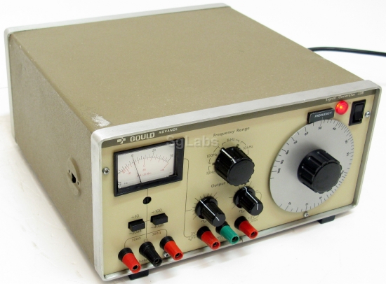

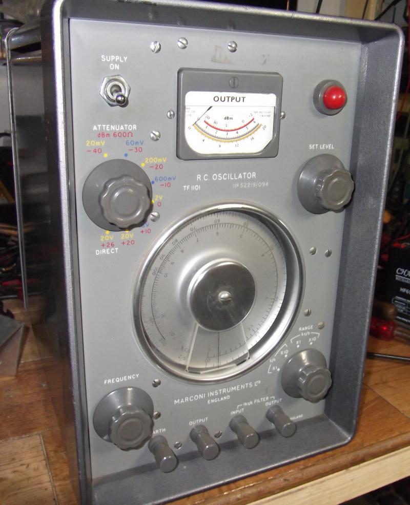

The local hackerspace received a "classic" equipment donation including several HP-200 to HP-202 models. Some people want to get rid of it all. We also have a small solid-state sine/square/triangle generator, but I like an old HP generator with the nice big dial and vernier knob for sweeping to get a woofer's free-air resonant frequency.for basic functionality debugging there is little need for super low distortion sine - eyeballs on 'scope traces are hard pressed to see a few %
the traditional sine/square/triangle function generator is very handy for the eyeball and scope phase
I'm also disappointed that some 'classic' analog function chips such as the 8038 are no longer made (the manufacturer's buzzword is "obsolete"). There were also the more specialized SSM and CEM analog music synthesizer chips that are now collectible. A well-programmed microcontroller can do at least as well, but it needs more than a cap and a few resistors to get going.
While I'm going there, why don't modern digital generators have a knob on a quadrature encoder to control frequency? Must be a little more expensive than pushbuttons. Last I saw one was on a logic analyzer.
can't you find a smart phone app with a touch slider for frequency?
I do understand liking classic equipment but there is also competition for bench space
