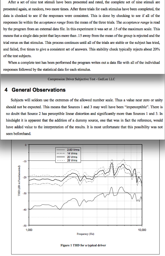

Bear If something works or not with an impulse then it has to work the same for any signal. That's why an impulse is so powerful.
Art - in our test of compression drivers you fail to recognized that the drivers were not compared to each other, but to an unmodified signal - no driver, no distortion. Hence the drivers being different or the distortion level being high would have no impact on the results. The listeners could not detect the difference of the distorted driver from no distortion at all. Your doubts can not be correct.
SPL at driver exit, and in horn throat are well beyond linear properties of air for sound propagation. Speed of sound increases with temperature. Standing waves and traveling standing waves in throat, and further up towards mouth when SPL is raised form complex pattern behaving as diffraction grating.
Signal and intensity allow for continually changing radiation pattern.
According to your test report you compared nine test stimuli, three drivers X three levels, all of which were highly distorted, being run at 14, 20, 28 Vrms (25, 50 and 100 watts in to 8 ohms) only a 6 dB range of differing degrees of THD ranging from 5-10% at 1000 Hz to 10-35% in the 4-9 kHz range.Art - in our test of compression drivers you fail to recognized that the drivers were not compared to each other, but to an unmodified signal - no driver, no distortion. Hence the drivers being different or the distortion level being high would have no impact on the results. The listeners could not detect the difference of the distorted driver from no distortion at all. Your doubts can not be correct.
The drivers were not compared to an unmodified signal, or an undistorted driver, that would have required more than nine test stimuli.
Had you done a comparison of the original recording (unmodified signal) and the drivers at two orders of magnitude difference, say 1, 10, and 100 watts, the results and your conclusions would likely have been different.
My test allows anybody to compare recordings of drivers tested to the original, and those drivers at a range greater than two orders of magnitude, as they may be used ranging from conversational level listening to pro sound levels.
Since my test has the drivers individually equalized flat, it is difficult to tell the drivers apart (or from the original recording) until the drive level is high.
At higher drive levels, the differences in the drivers sound (distortion) character becomes progressively more apparent.
You can hear the HF drivers with the LF mixed in here:
http://www.diyaudio.com/forums/multi-way/212240-high-frequency-compression-driver-evaluation.html
Or the HF drivers alone here:
High Frequency Compression Driver Evaluation
Give the recordings a listen and subjectively decide for yourself what level of distortion is acceptable to you in the various drivers.
The college students in your test 8 years ago did not have that opportunity with the way the test was conducted.
Art
Art
Art - this is where you are wrong. The test protocol was to compare the nine recordings to an unmodified signal and to rate the difference. I always use a reference source to base the results to something.
Your reference only suggests that even the frequency responses may have been undetectable for two of the three drivers, not that real differences could not be detected. That's completely different than what you are suggesting.
Earl,Art - this is where you are wrong. The test protocol was to compare the nine recordings to an unmodified signal and to rate the difference. I always use a reference source to base the results to something.
According to your white paper, "always" "most unfortunately" did not include using a reference source in your GedLee LLC Compression Driver Subjective Test:
"4 General Observations
Subjects will seldom use the extremes of the allowed number scale. Thus a value near zero or unity should not be expected. This means that Sources 1 and 3 may well have been “imperceptible”. There is no doubt that Source 2 has perceptible linear distortion and significantly more than Sources 1 and 3. In hindsight it is apparent that the addition of a dummy source, one that was in fact the reference, would have added value to the interpretation of the results. It is most unfortunate that this possibility was not seen beforehand."
If there was a reference source, why did you write you should have added it?
How do you do the math that you had 9 sources when a reference would have made 10?
I just got a speeding ticket. 8 miles over the limit. I am not happy at all with the metrics used, I think we need longer miles, that way the signs can stay the same, as well as my speedometer. The officer felt that over a period of time the speed limit was adjusted to what a plurality of folks considered safely drivable. I am going to do a small study and attempt to get the scale changed. Bringing this thread as evidence, so please go easy on the new metric point of view until December 3 at 6:30 pm. Thanks.(-:
Art - that's simple. Had there been a "dummy" test where the sample and the reference were identical then the reliability of the listener could have been tested directly instead of indirectly as we did. That is the only reason that I would have added a tenth source.
I used this technique years later at Ford to show that the subjective impressions of the "golden ears" were unreliable.
I just got a speeding ticket. (-:
I always contest tickets - 50% of the time they get thrown out, mostly because the officer does not show up. It's always worth a try. Never have I not gotten a reduced ticket when I showed up. But never argue, I've seen that go very badly.
My last two (con)test results agree with yours 100%, even though we are in different states (of the union).I always contest tickets - 50% of the time they get thrown out, mostly because the officer does not show up. It's always worth a try. Never have I not gotten a reduced ticket when I showed up. But never argue, I've seen that go very badly.
