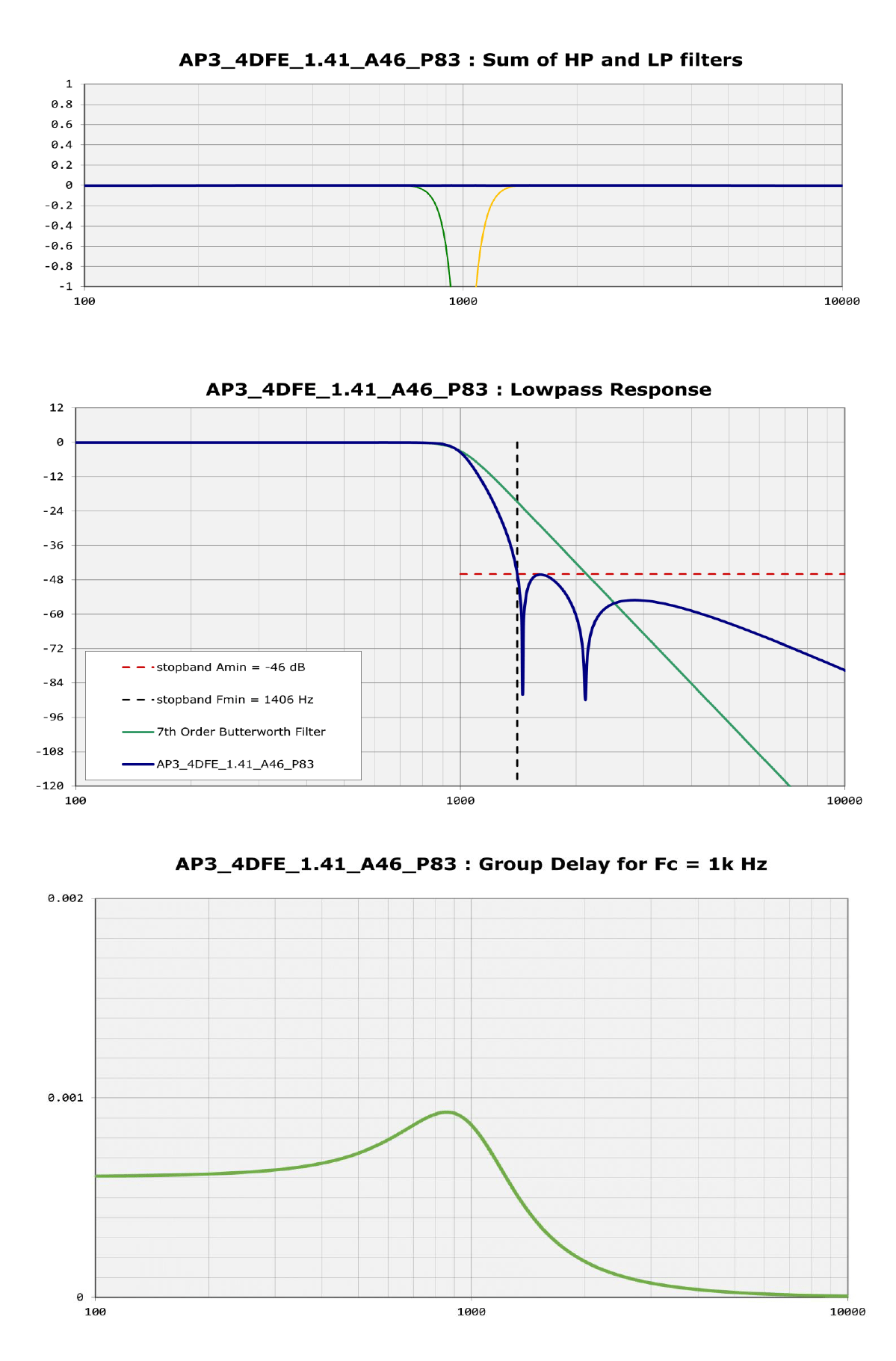

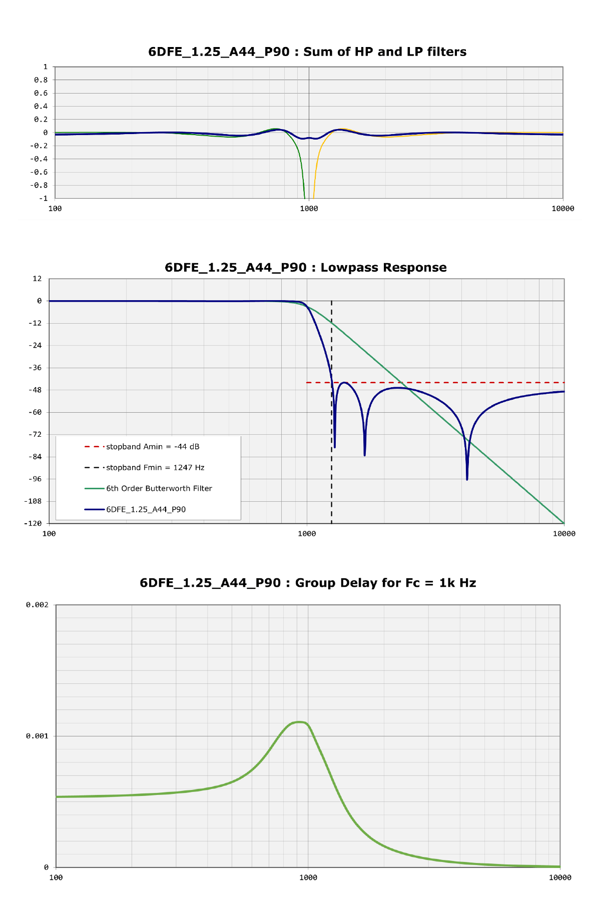

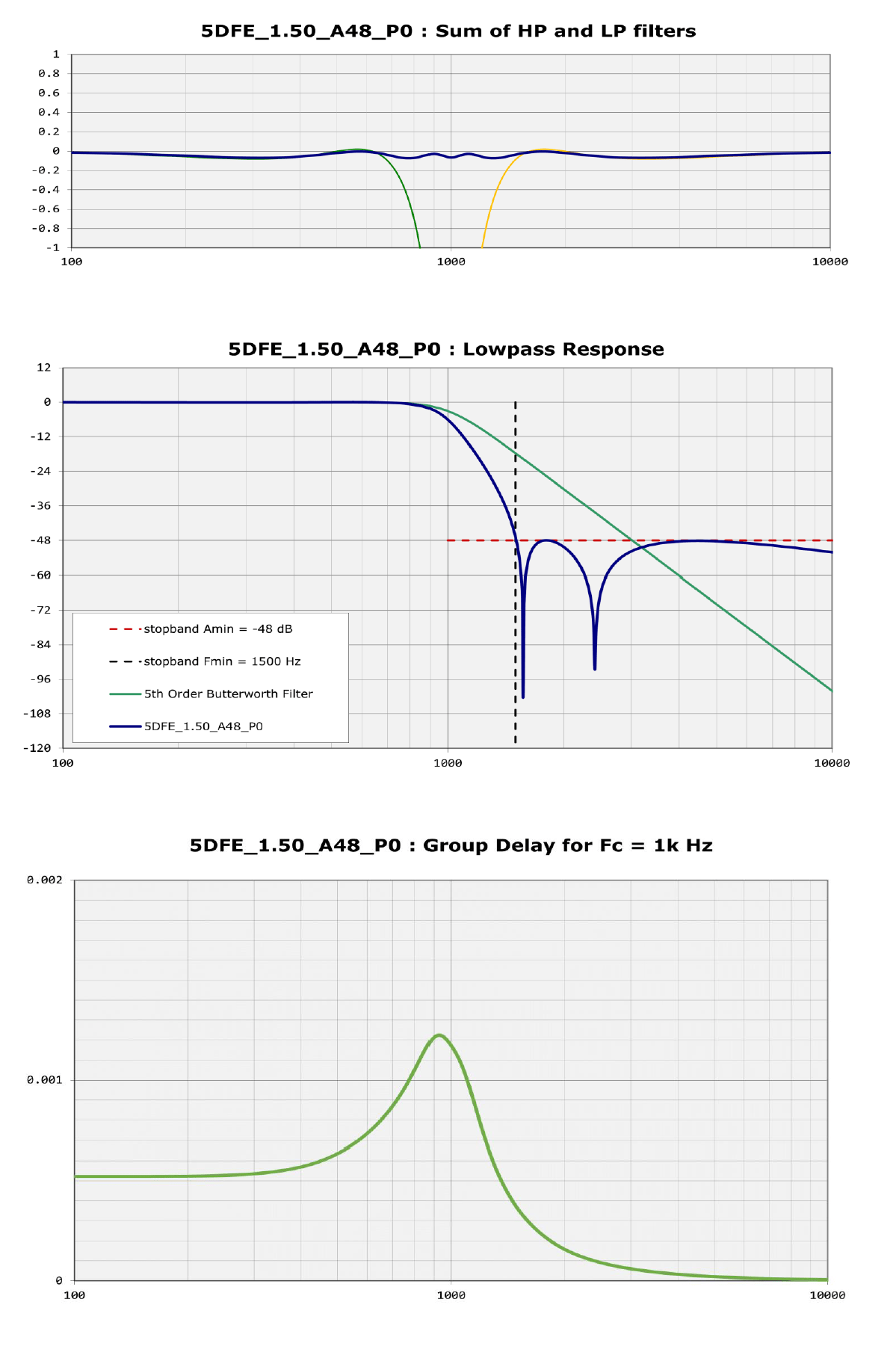

The audioXpress article provides full details on the DFE crossovers, but I will provide a couple of examples below. I typically present the lowpass filter response, a zoomed-in view of the LP+HP sum, and the group delay of the crossover. The highpass filters is simply the lowpass mirrored about the crossover frequency. Please see the following attachments:
Example 1: 5DFE_1.50_A48_P0​
Example 2: 6DFE_1.25_A44_P90​
Example 3: AP3_4DFE_1.41_A46_P83​
The elliptic-like response of these crossovers is well suited to loudspeaker crossovers because stopband attenuation of more than about 50dB is not necessary. Instead it is better is to quickly transition between passband and stopband (e.g. the transition band is narrow). Most non-FIR filters with such narrow transition bands would produce excessively high group delay that would cause audible phase distortion, but I have used the extra degrees of freedom to design the DFE Family filters to have sufficiently low group delay as to not give rise to audible distortion in the time domain signal.
Overall these filters offer an interesting mix of capabilties that has not yet been available except through FIR filtering. The DFE filters can be implemented with analog active circuits or IIR DSP, and remain easy to use and relatively lightweight. You can download information about the complete DFE Crossover family at the following link:

All of these parameters are limited by the group delay. For Fc=1kHz, you want to keep the group delay below about 1.5 millliseconds. But even if you want very low group delay similar to an LR4 (with max GD of around 0.5msec for Fc=1kHz), I offer a 5th order filter with about the same group delay and a narrower transition band in the 5DFE_1.75_A45_P66. It just has a different relative phase angle between LP and HP and the response is 45dB down at 1.75 times Fc (over only 0.81 octaves).
