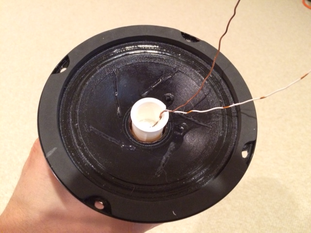

I made a coaxial tweeter mount (hollow to allow wires to pass thru to back via magnet vent hole) with a 3d printer. Then I mounted a small Mylar dome tweeter to it (Weltersys gave me a bunch of these a while back - they are very sensitive and measure flat in an OB above 3.5kHz). With assistance of Byrtt, whom gave me a value of 0.45mH for a 6kHz 1st order LPF for the PA130-8. And using some tables for 4ohm drivers on line, I saw that 6.6uF was needed to get a 6kHz 1st order HPF. I chose 6kHz to let the PA130 do its full range magic in the telephone band and let the tweeter take over the supertweeter duties. I wound my own inductor to 0.44mH (as measured with DATS), added a 5ohm resistor to pad the tweeter and mounted it all up onto the PA130.
Here is photo of the coax tweeter mount sticking out of voice coil bore:

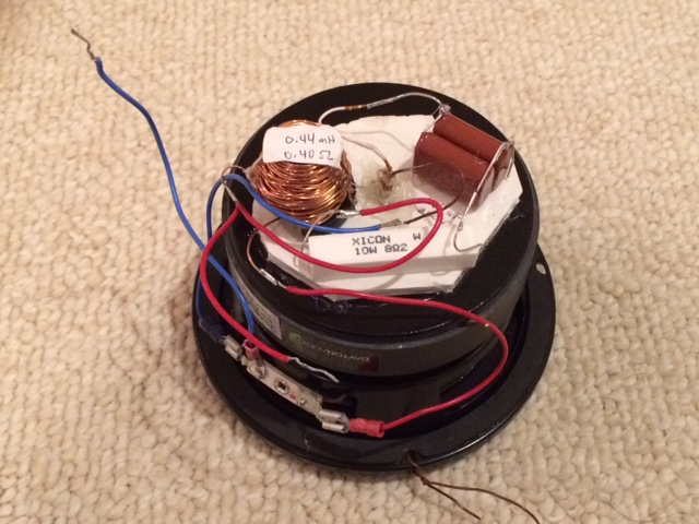

Here is the 6kHz crossover as mounted on back of magnet (actual uses 5R and only single 3.3uF):

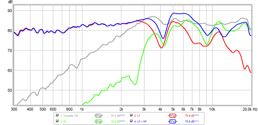

Here is the measured response with a 3.3uF cap (6.6 was too much, and 3.3uF is still too way much as XO freq appears to be in the range of 3kHz still) in a Nautaloss sealed spiral TL (gray line is tweeter in a small rectangular baffle to see native response - the round tweeter body diffraction wreaks havoc (green) on the otherwise smooth response of the tweeter(gray)):

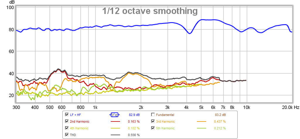

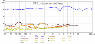

Here is the measured distortion:

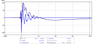

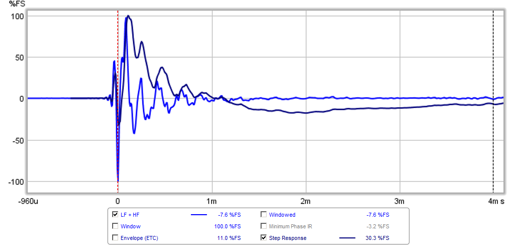

Here is the measured impulse and step:

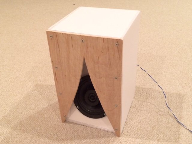

Now, here is the new coax mounted in an XKi:

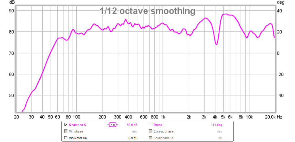

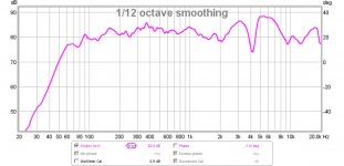

This is the measured response in the XKi without the K aperture:
Initial listening tests are very promising - very clear and sharp percussion, great vocals. A bit bright at the 6kHz peak though, however, with K aperture that smooths out quite a bit. Very loud (sensitive) and doesn't take much amp power for great volume. Nice bass from XKi.

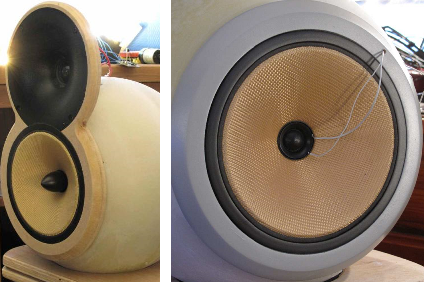

The Vifa coax here looks very promising as an XKi coax. Note the non round bezel on tweeter. I may try that to help reduce the massive diffraction from the round bezel. Round is worst shape for diffraction.

As you talked about, mounting tweeter inside coil diameter 5th element milled down a ND16 tweeter in mod below.
More info that one http://www.htguide.com/forum/showthread.php?38667-B-amp-W-FST-mid and http://www.htguide.com/forum/showthread.php?42114-The-Odd-Couple&p=593742&viewfull=1#post593742.

Thanks for the tip! These are sweet and the perfect size to go into the voice coil bore (0.93in ID). They might even be the perfect depth to let the cone act as a waveguide.
The FST actually has a 30mm diameter voice coil which is a very tight fit for most decent tweeters.
The ND16 is a great little driver for the price but was being pushed a tiny bit too hard with the 2.5kHz xover required for a good directivity match between the two.
As was said in the other thread I have since changed over to some new old stock Aura NS1 tweeters that are far more capable and actually measure much nicer. I should really take a picture of that.
Here though things look quite nice except from the null you're seeing at 8kHz with the tweeter. This is due to it being mounted on a stalk. If you could get a tweeter down into the voice coil that would be ideal.
Interestingly to gain the directivity controlling aspect of a coax you really do have to have the tweeter down in the coil. If it stands proud the wavefront doesn't load the cone properly and all your left with is a tweeter on a stalk to contend with. Of course you will still benefit from having aa c2c distance of nothing.
