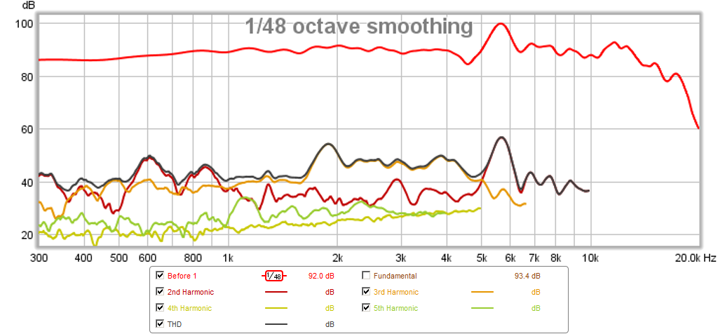

For near field and open-face driver applications, measurements of this driver will reveal that it has a big resonance peak at 5kHz, which is well suppressed when sitting behind a K-aperture. There is also kind of a rough response above 5kHz to the max limit of circa 12kHz to 15kHz. Here is the frequency response and harmonic distortion for a moderate drive level for the baseline (un-modified) driver. This was taken at 0.5m and driver in Nautaloss with trapezoid baffle:
I started wondering if there is anything one can do to improve the response because as we all know, a resonance peak in frequency must be accompanied with significant ringing in the time domain. Sure enough you can see that here with the impulse response. You can see that there are two ring modes at 5kHz (main) and a smaller 10kHz on top of that:

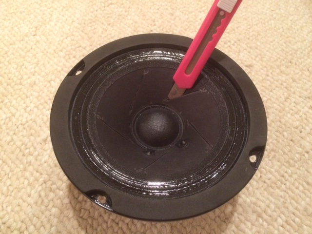

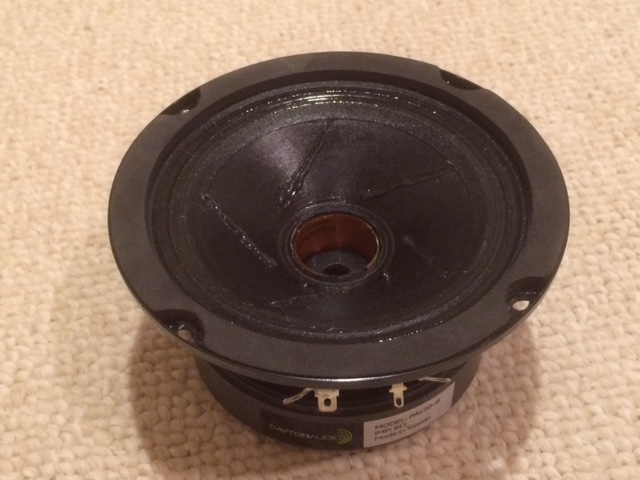

The first thing I tried was to impose pentagonal symmetry like a ScanSpeak Revelator - or a "Daytonator", the PA130-8X. The pentagon prevents reflection symmetry resonance modes from being the dominant cone breakup mode. This took mustering up some courage to take a knife to a brand new PA130-8 (after I measured its baseline response). I cut 5 angled radial spoke slits in the cone from near the voice coil towards the surround - ouch!:

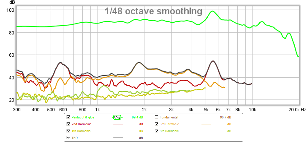

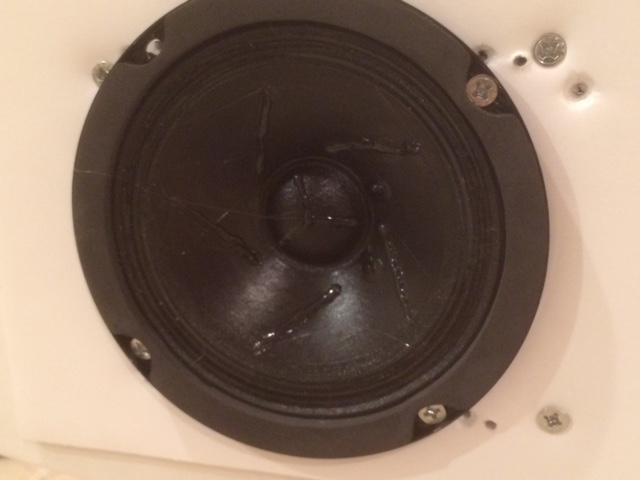

Then I used some PVA-like craft cement that dries semi-soft (waterproof craft textile glue) to reglue the slits - applied with hypo syringe and needle. Once it dried, I brushed a thin coat of same glue on cone to give the whole paper some better damping. I then took a hot melt glue gun and added a bead of hot glue onto the now-reglued slits to give more of a mass impedance discontinuity at the cone in hopes of breaking up any resonance breakup waves:
Here is the result of the above mods in frequency response. Some reduction in the 10kHz peak but not much in 5kHz peak, but the IR showed a reduction in the 10kHz ring (not shown):

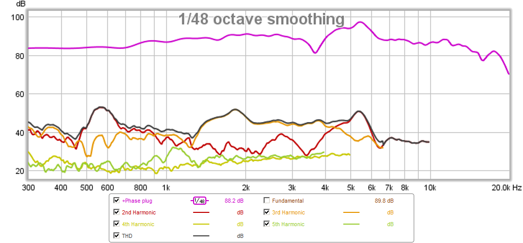

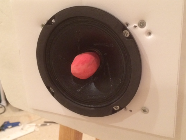

My next step was to remove the dustcap, my thinking is that this may be source of resonance as there is a chamber behind the dustcap vented to the back through a small hole that may be causing a resonance mode.
The measurement without the dustcap was just awful - a huge dip formed at 4 kHz due to the empty air column there - I don't have enough room to show the response, but I subsequently added a plastic modeling clay phase plug to that hole in the dustcap as a stationary phase plug:

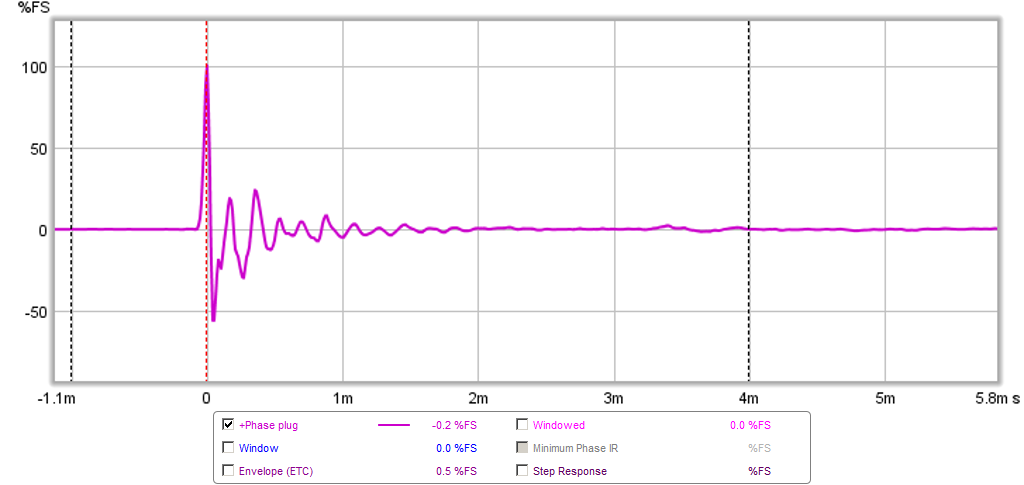

That improved things a lot, and as we can see, the highs above 5kHz are smoother, and the 5kHz peak is smaller but there is a sharp dip before 5kHz - although very narrow and may not be so audible. The roughness above 5kHz is much smoother now, but a bit depressed:

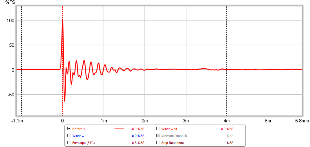

Looking at the impulse response now, we see that there is indeed a much reduced ringing, and subjectively listening, it sounds better - percussion is more crisp. However, the sensitivity went down a bit probably due to the less stiff cone and a bit of added mass:

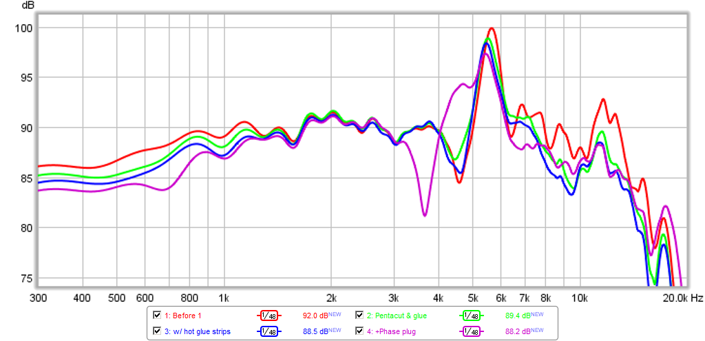

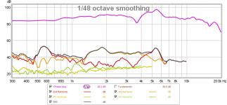

So here are the combined measurements of all the mods on one graph. I took all data with speaker cabinet and mic untouched with just removing and reinstalling driver each time so data is very consistent:
So there is some success and it's a bit of a mixed bag. I think the pentagonal cuts fixed the 10kHz ringing, but the 5kHz ring appears more of a pressure and phase plug air flow issue.
Perhaps not all mods were warranted, but this is exploration stage. There may be some issues with the air flow and reflections in the basket which I will look at next.
