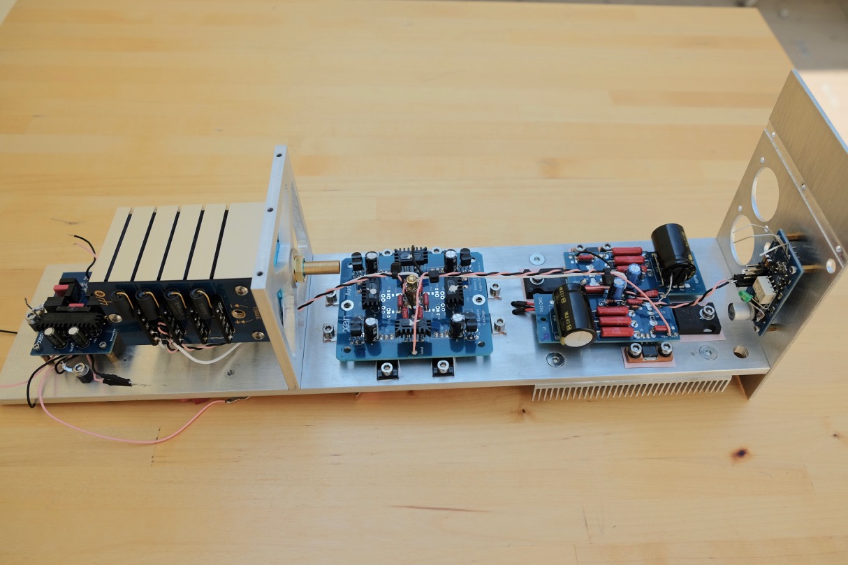

Balanced DAO build in progress

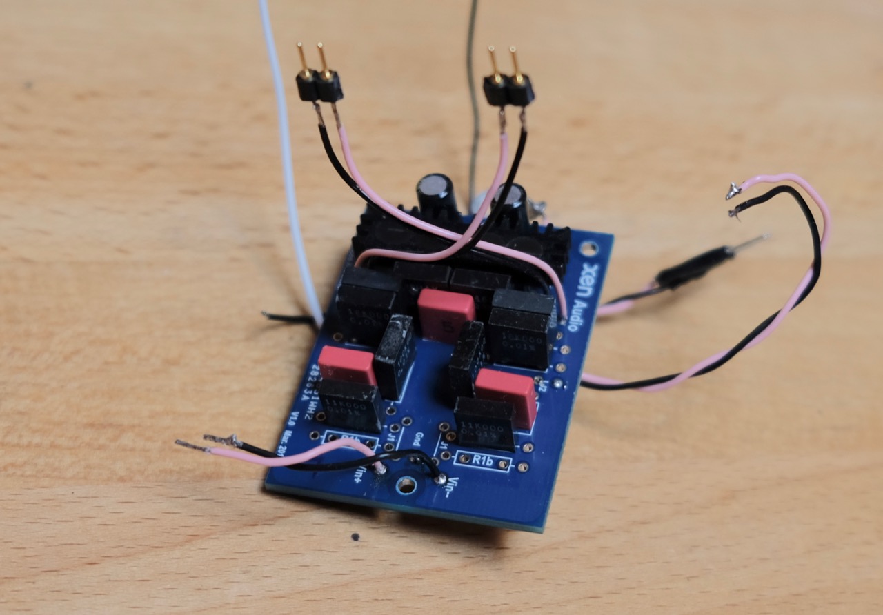

After being under the radar for a couple of years the corona crisis finally gave me the time to finish my balanced DAO build. I'm still working on the case, but I hope to also round this up within the next month or so.
Picture shows the layout of the right channel amp core with the buffered X-feed circuit, Khozmo attenuator, voltage gain stage (HAGS), current buffer (DAO) and head phone protection circuit.

Heat dissipation will be sufficient.
Might as well answer your other question here.

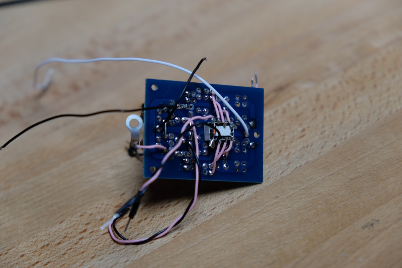

The two channels of the amp are opposing and the Xfeed PCBs some 5-6 cm away from each other face to face. You can see in the picture how the actual X feed signal is wired.
As I wanted to be able to turn the Xfeed on and off I have furthermore added signal relays on the bottom side of the PCBs.
Since we are on the topic, the HAGS for the DAO SE can of course also take balanced input signal.
Two GB1 subscribers want to do exactly that.
So we designed a special PCB for them, shown here with TKD 4CP-601.
For a sense of scale, the shaft is 6mm.

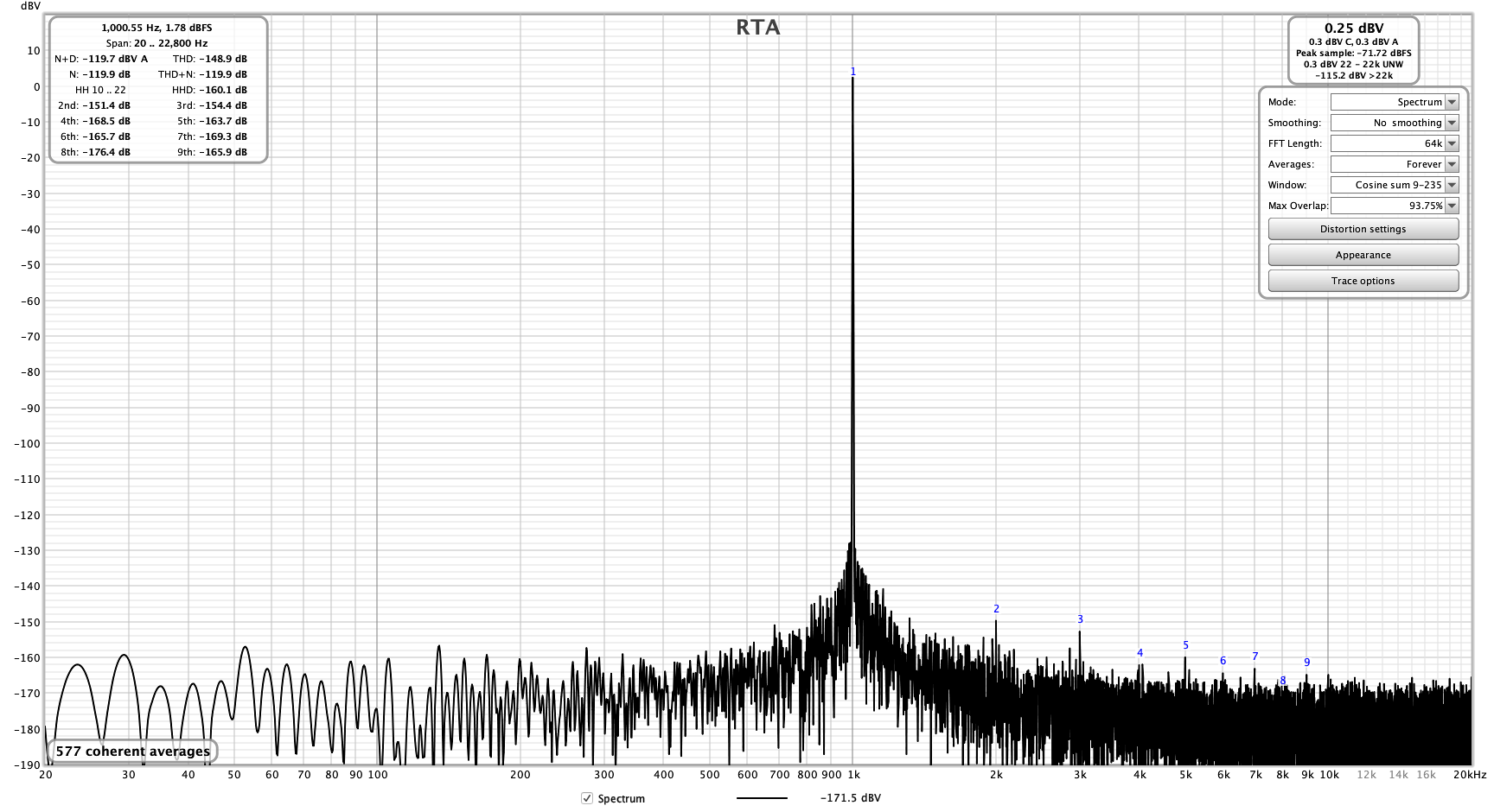

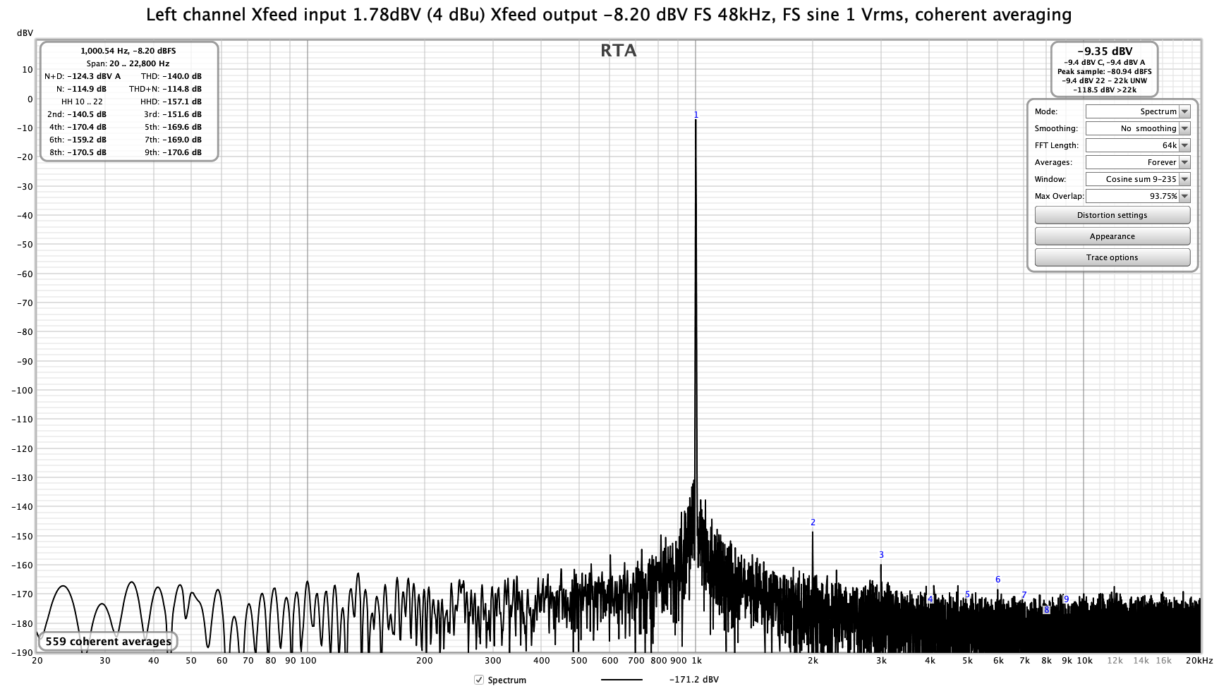

While we are at the buffered Xfeed input.
The distortion added by this module is very low (around -140dB) and somewhat difficult to measure. Attached are the measurements using Victor's oscillator, a notch filter, and software (REW) notch filter compensation. The first graph is the Xfeed measured using conventional level averaging. The second graph is the same measurements employing coherent phase averaging. The third measurement is the input signal (i.e output of oscillator) measured using coherent phase averaging.
Not too surprising.
Especially when the HAGS is not loading the JFET follower much, if at all.
One should bear in mind that all these numbers are achieved without global negative feedback.
Just circuit design and careful selection and matching of devices.
When you are done, you most likely would have a headphone amp better than my own.
Patrick
