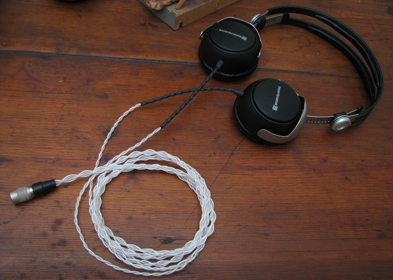

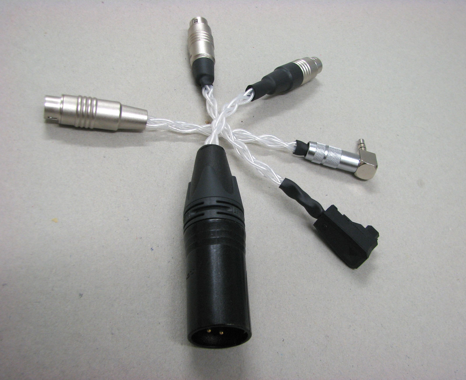

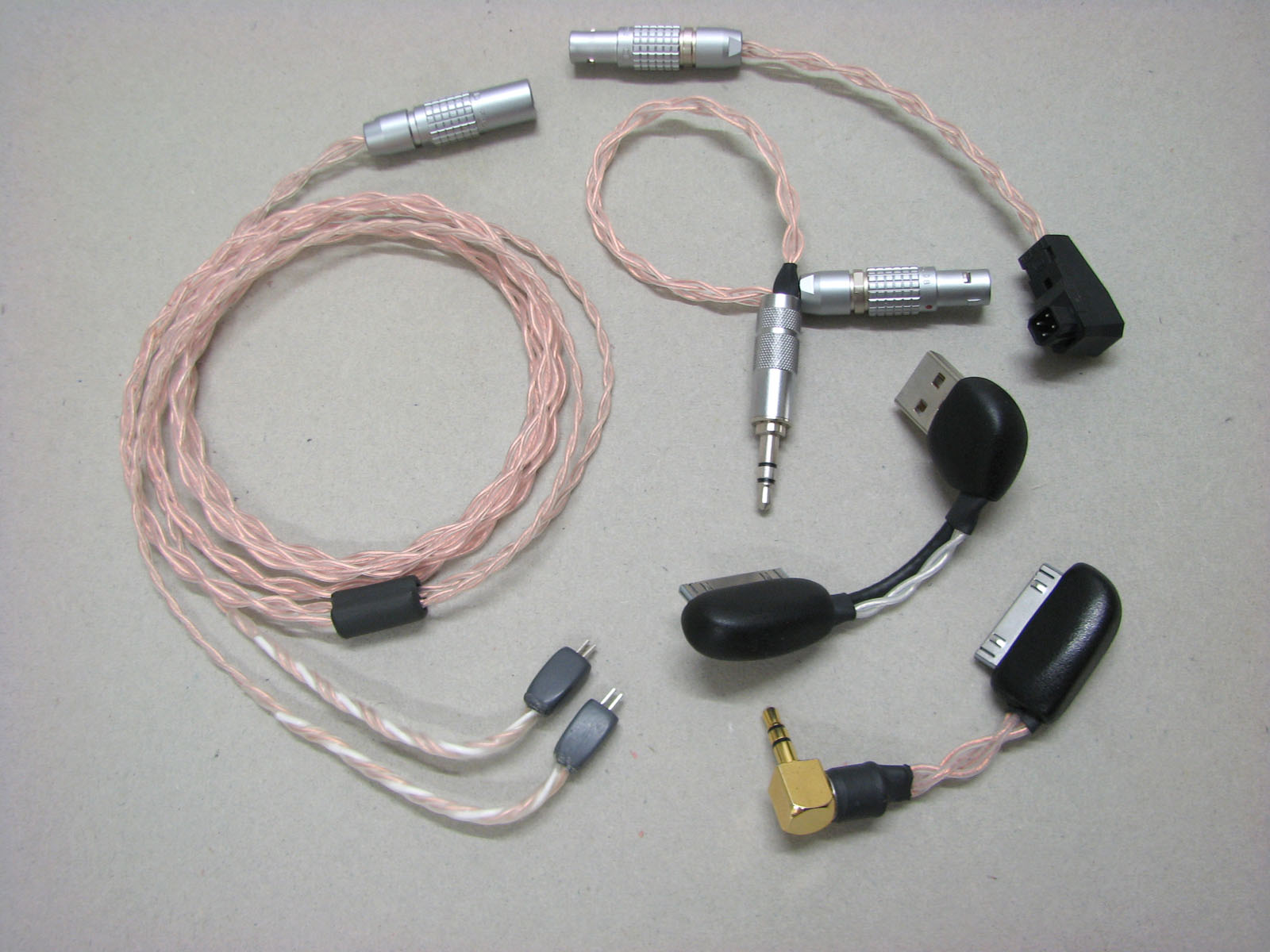

oh sure, I just dont quite understand that solution, I cant think of another situation where you would need to cater for both 3 wire and 4 wire cables on the 1 amplifier and if you have this connector and socket on the amplifiers/headphones, you have either built/modified them yourself, or changed the connectors.
So this means the only situation it would help with, would be people who are willing to reterminate their headphones that have a common ground wire, but are not willing to recable them; every other situation can be handled with 4 pin and suitably wired amp/headphone
and honestly I think the world needs another balanced headphone 'standard' like it needs another Pol Pot....
sorry I dont mean to be a pita about this, people will do what they please as you say. I've made this unholy proliferation of different balanced headphone 'standards' a bit of a pet cause and I get on my soap box every time a new one is introduced. We now have something like 6 different connectors in use because everyone wants to be individual, thats ridiculous....
also Lemo make a 5 pin, up to 6-7 pin I think in that 0B size 😉
it means I end up with jobs like this; which i'm not sure is a blessing or a curse... more work, but it means I have to keep more different connectors in stock.
anyway i'll let the thread get back on track, I know of quite a few people that have been waiting for this amp to be made more publicly digestible, I actually get messages about it on head-fi reasonably regularly. I built it up rough point to point (taylored) and like it a lot, but since I prefer balanced and all my sources are balanced, the circlotron version holds more interest for me.
