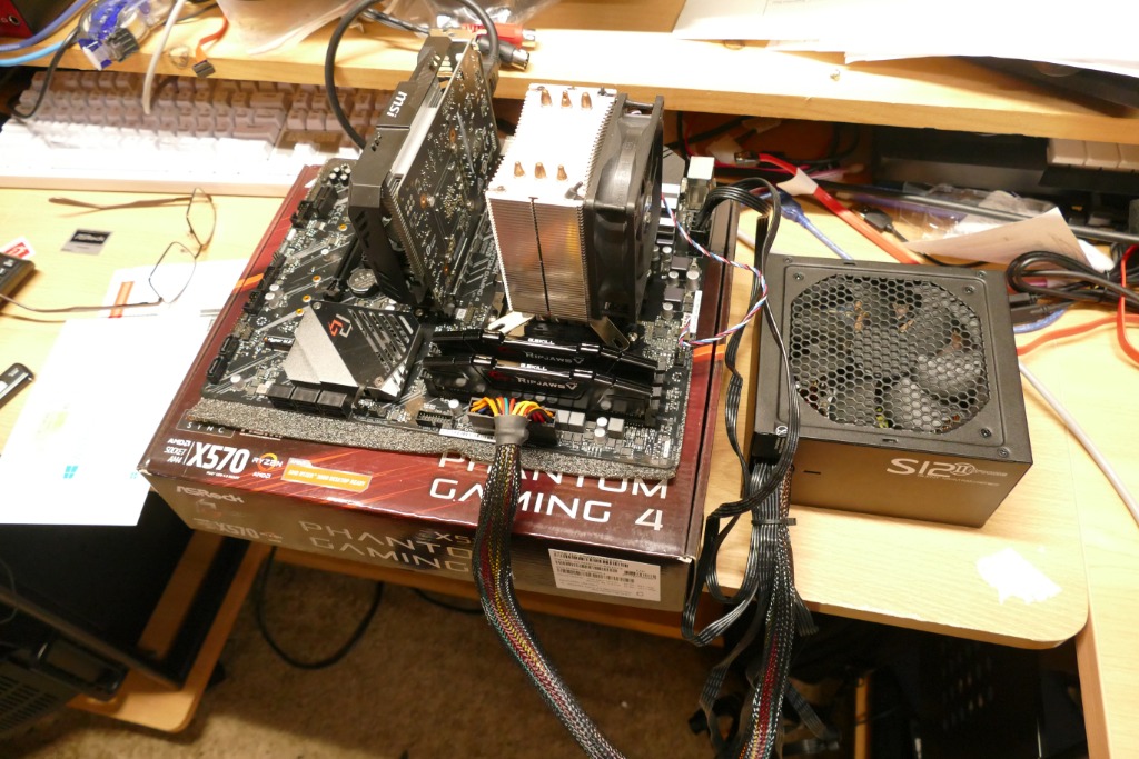

The Ryzen 9 -5900X CPU chip was in my mailbox this morning. I ripped the big rack mount PC from its rack tossed it on the bench for an expected total teardown to remove the MB so I could get that fancy multicolor glowing LED powered CPU cooler off. Popping the lid off for the first time in over two years provided surprise number 1. I partially removed the video card letting it dangle from its 12Volt power cable. This allowed me to get to the clips that hold the glowing circle of color on the CPU without removing anything else. 5 minutes and a bit of Artic Silver later and the CPU's were swapped. I reinstalled the GTX1660 connected up a few cables including a 4K TV, and fired it up. The BIOS screen popped up a warning saying that a new CPU had been detected and the BIOS defaults were installed. I saved, exited and restarted. This led to a looping sequence that flashed some of the red POST error LED's on the MB a few times, then the machine restarted by itself, and booted Windows10. Windows needed some drivers, so I went to Windows Update where it found what it needed and also installed a couple updates and asked me to restart the machine. Upon restarting and returning to Windows Update I found surprise #2. My PC is now suddenly Windows 11 ready, and MS is prompting me to upgrade for free, NOW......UH, not yet.
The only change was the CPU chip, and the old Ryzen 7 3800X IS on the compatible chips list, so again, What's UP? Once I have played with W11 on a non critical machine, I may install it here, but for now I'll stick with W10.

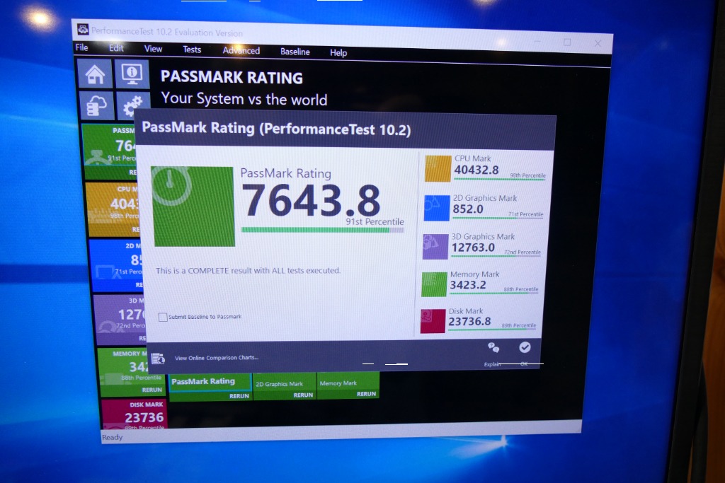

Surprise #3 came when I ran before and after Passmark benchmark tests. As expected, the CPU score improved from 22633 to 40214, both slightly higher than the published Passmark scores. Likewise, the overall PC score improved from 7019 to 7901 which is the 85th percentile VS the world rising to the 93rd percentile after the swap. Surprisingly the 2D graphics score improved a little and the 3D graphics improved about 10%. The memory scores were pretty unimpressive with either CPU chip being in the 63rd percentile even though there is 32 GB of good quality DDR4 on board. The BIOS probably doesn't see the XMP profile for these memory DIMMs so some tweaking is in order.
I need to try some real world benchmarking with the virtual modular synth and some video rendering as soon as I can find the notebook with the testing I did early in the year when VCV Rack V2 came out.

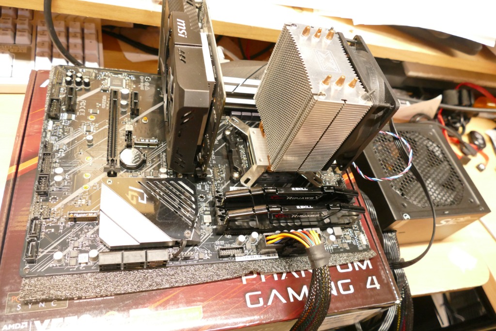

I ripped into the machine again today to swap out the power supply. The computer has worked fine with the supply it had, but it was a 450 watt unit. I stuffed in a hungrier CPU, so I ordered a 650 watt supply back when I got the Ryzen 9 chip but it didn't arrive until yesterday. I also played musical memory DIMMs but as you surmised it didn't make much difference because the BIOS reflash had set the memory speed to 2133 MHz to insure startup. The DIMMs that were in the machine were rated for 3600 MHz so they went back in. This seriously boosted the memory performance in the Passmark tests.
I now have all the parts to build a new PC around the Ryzen 7 that I pulled from the machine, except the cooler. I have a box full of assorted coolers, but not a one of them will fit the motherboard. I ordered one from Amazon that was in stock at the Pittsburgh warehouse for delivery tomorrow, but Amazon just decided that I wasn't in a hurry and changed the delivery date to Monday. I'll probably set the MB up on its box and "glue" a cooler to the CPU with some Artic Silver for testing and Windows installation on the MB mounded SSD.

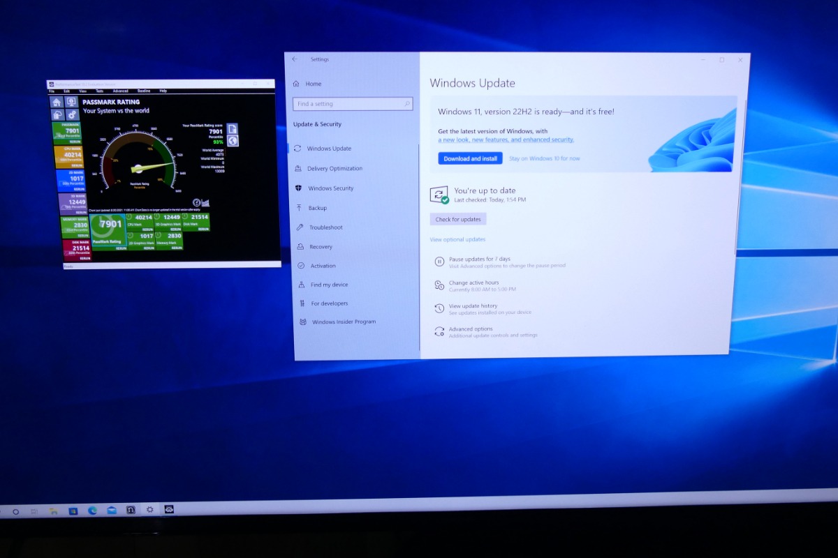

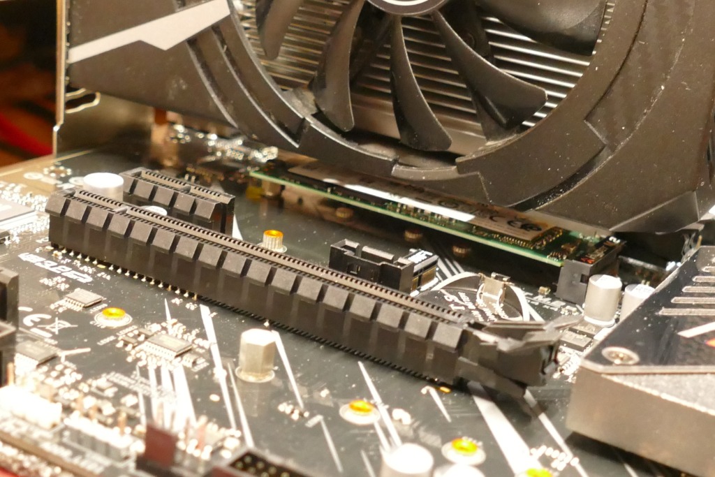

The "Desktop PC" is alive and running W10. I have not yet figured out how to get the secure boot functions to work despite using the exact same BIOS settings I used with the other identical MB and the CPU chip I pulled from that MB. The 1 TB SSD with Windows 10 on it is hiding under the video card. The cooler is from an old Intel based MB. It is just stuck to the CPU chip with thermal paste. Even so the idle temps are around 40C which is cooler than it ran with the fancy Wraith LED cooler that came with it which were 50C or more. Granted it now has unrestricted airflow as opposed to living inside a box with three spinning HD's, wedged between this power supply and a GTX1660. The card used here is a GTX1050 which doesn't even need a dedicated 12 volt cable from the PSU.
The secure boot issue was traced to a statement I found with Google in an obscure thread on a Microsoft forum somewhere. It stated that secure boot only works in GPT / GUID based drive volumes. I had just installed W10 from a flash drive containing an ISO image I downloaded from Microsoft some time ago, but the boot volume on my SSD was indeed MBR. There is a utility called MBR2GPT that will change a MBR volume to GPT, so I used it, then applied the MS W11 Upgrade Assistant and the PC is now running W11. Maybe MS should add that to their list of W11 requirements. The proper CPU cooler should arrive tomorrow.
