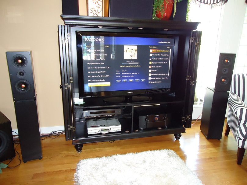

I agree Al, there is nothing wrong with these Tritons, Jeff, I am still loving them and discovering every day how magical they are.
Everytime I take a listen to Pure Direct mode with the Marantz, I am captivated with Songs that I have heard many times before and have skipped, now sounding simply stunning.
Having hardwoods with a medium size area rug in front, I would think reflections would be an issue, but after the post....if in fact it is what it is....I can understand why that is not an issue with the room.
Small or large room doesn't matter the Tritons fill it up with a bold clear sound.

There are in the theater area with a Marantz SR-7005 7.1 125wpc. Usually online with Pandora through the OPPO or some SACDs. I listen in Pure Direct Mode.
Sometimes I move them into the Office/PC and listen to files and online music Spotify/grooveshark/Pandora with a Musical Paradise 301 Mk2 tube 6.5wpc.
