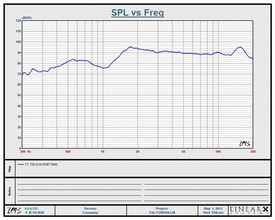

On the looks of it, this is a substantial tweeter with an air chamber, so it should be able to go low. Does the manufacturer publish measurements and do you have a link?
Yes, you are right, the tweeter with a chamber. and the improved sample was finished today by my friend.

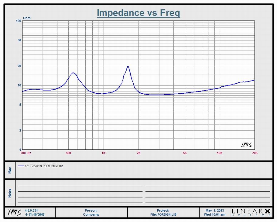

impedance curve

That FR is really very good. In all likelihood, the swings >10KHz are due to diffraction effects, and will look different (better) when mounted with care.
No doubt you could crossover this tweeter fairly low, around 2KHz. On the whole, the lower you can crossover your tweeter, the better it is.

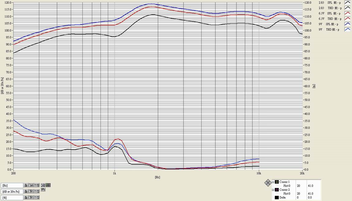

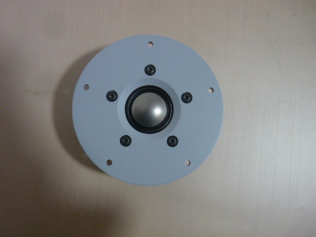

The tweeter has been updated, the diaphragm is fabric with coating. since I have not equipment for THD testing, so it has not any THD data. I guess it can be used for 1.6kHz xover design.

Xmax?
Sd?
The lower you go, the more it has to move. One octave lower requires 4 times the excursion. Also- even if you have a low-Fs, this does not imply you can use it to 1.6kHz without other data.
There are maybe 10 tweeters on the home-market with an Fs of 500 or lower, but some cannot xover below 2kHz due to harmonic distortion rising harshly below there. Fs is not the only indication of performance.

The up plate thickness(the air gap height) is 4mm, and the voice coil winding height is 2.3mm, so the Xmax is around 0.8mm, the Sd is 7 cm2. I know it is challenge for the 1.6kHz, but if the power is less than 30w for using at home, i think it is safe.
