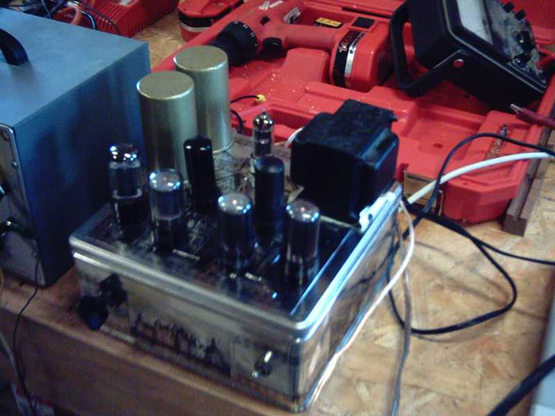

The 6N7 question by Alistair E brought my first amp to mind, so I thought I would post a picture and scheme for it. It is an adaptation of an amp shown in the 1953 issue of Practical Amplifier Diagrams. The 6N7 is used as the voltage amplifier and phase splitter. The 6V6 tubes are wired as triodes. I used a pair of found toroids for the OPT. Very high impedance primary. They have 4 equal windings on the primary, so someday I may even try it as UL. The schematic is for the original as built, I have played with it quite a bit since then, and to tell the truth I am not exactly sure where some of the parts values sit now. When I get a day or two clear I will rebuild it yet again. Great sounding amp, good for about 2.5W. I am currently using it for the rear surrounds in my multichannel setup.

Hi Micheal,
Thank you for your 6N7 circuit. I have some NOS 6N7 & 6N7GT on hand and will try to make one of your crackerbox amp but use 6L6 or 6AQ5A as output tubes. What is your opinion?

Hi Cy,
I really like the 6V6 tube and have several vintage amps that use it as tetrode. That said, I think with a socket change a 6AQ5 would be a drop in for the circuit. The 6L6 would require a heftier power supply than I have if biased normally for the operating point and probably a bit larger of an autobias resistor, otherwise I think it should be fine. I would note that I am using a very high impedance output transformer (~15k) and that may be the secret to the sound.

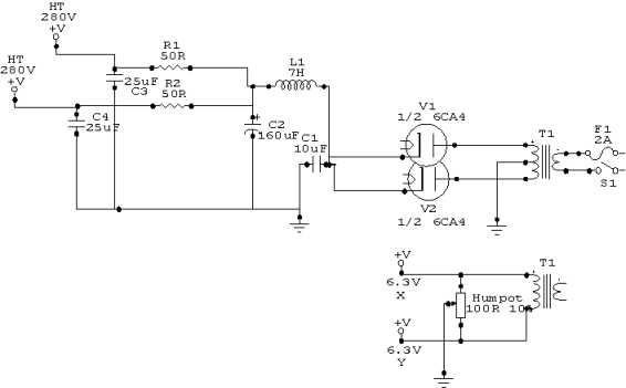

Here is the schematic of the power supply. The 10uF cap is actually two parallel 5uF ASC metallized polypropylene snubber caps, the 160uF is two parallel 80uF Sprague Atoms, and the 25uF (which is also shown in the channel schematic) is a polypropylene/oil. The voltages on the channel schematic are measured, so the 280V output is actually 294V.
