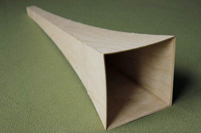

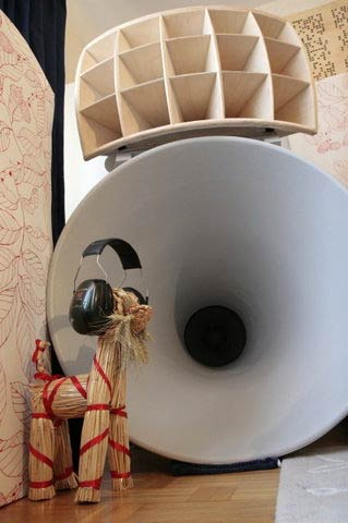

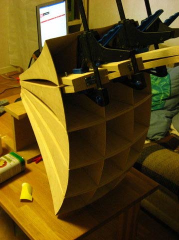

I'll try my best to inspire and to show to you that everything is possible. To do a multicellular horn takes a while due to all different moments but they are all kind of nice and it feels good to see the horn grow with every hour of work.
These horns are NOT a Altec 1505B copy. They are pure exponential with a flare frequency of 183 Hz, the same, or at least what was my and reVintages intentions bacause the throat flare in JBL 2441 and 2445.
The horns are built out of 3 mm Baltich Birch plywood, filled with polyester and the outher sides are covered with polyester and glass fibers.
Enjoy😎
Enjoy😎

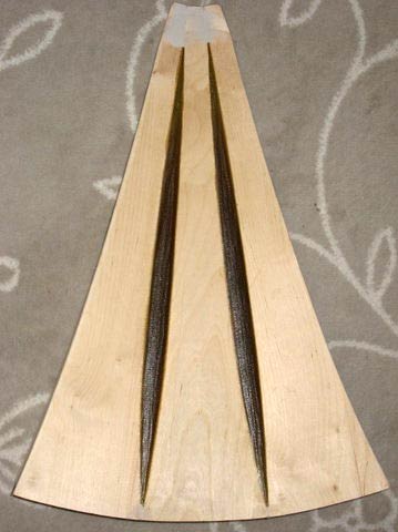

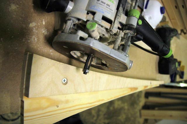

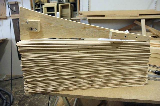

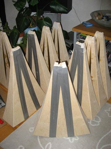

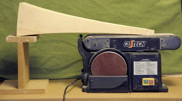

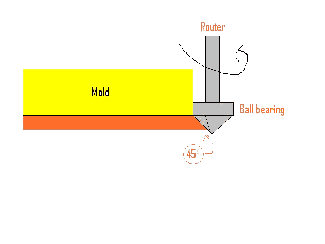

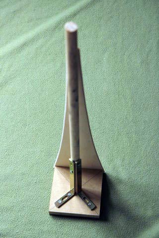

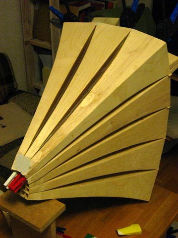

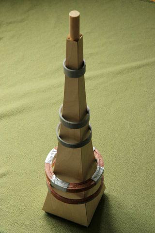

Construction of a mold
Was later copied so the mold became symmetrical

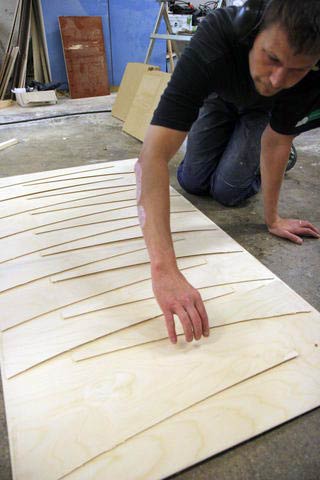

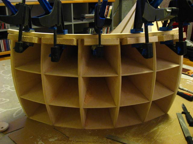

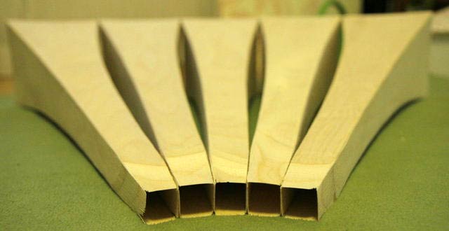

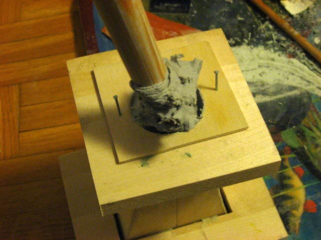

Good start🙂

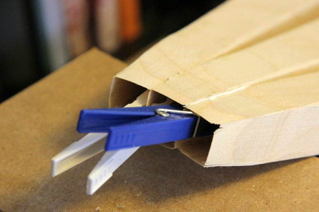

Some help from a friend

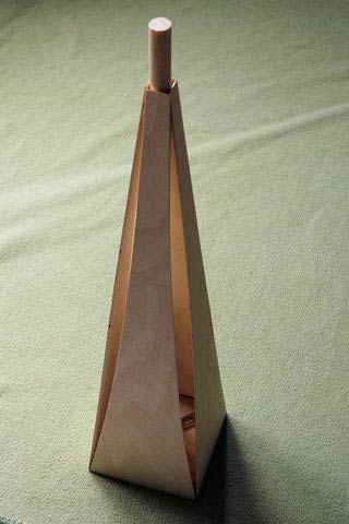

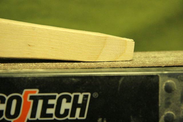

So the cells have zero edge width at their beginning.

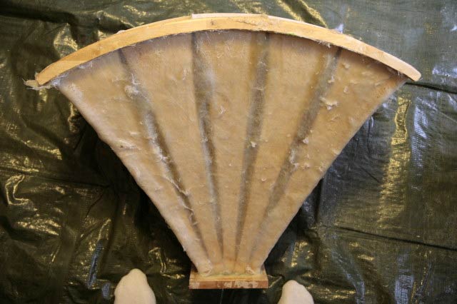

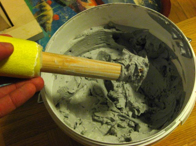

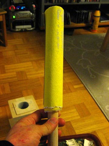

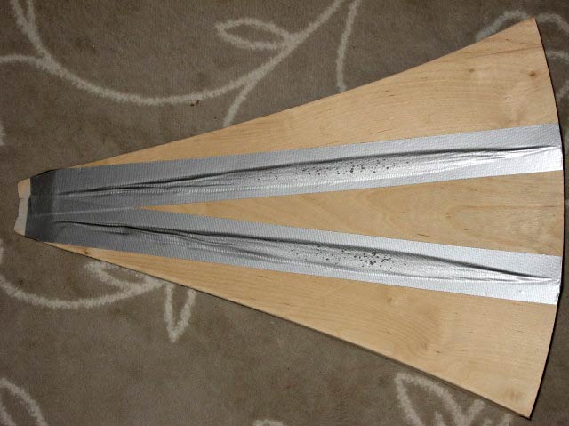

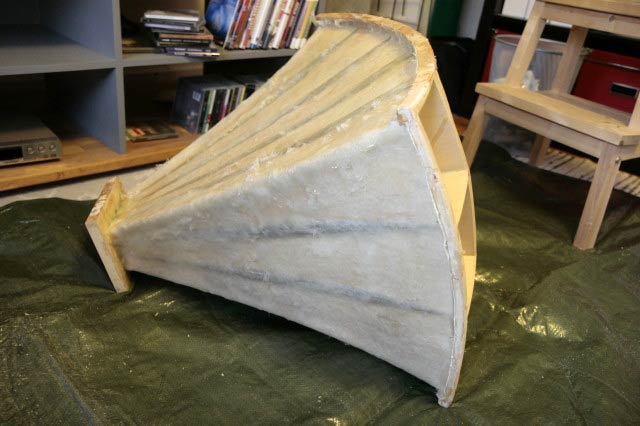

One side was taped
And filled with polyester

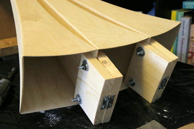

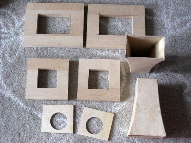

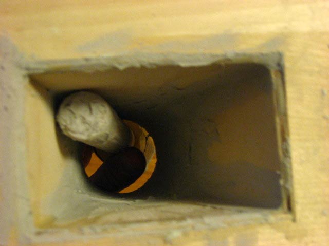

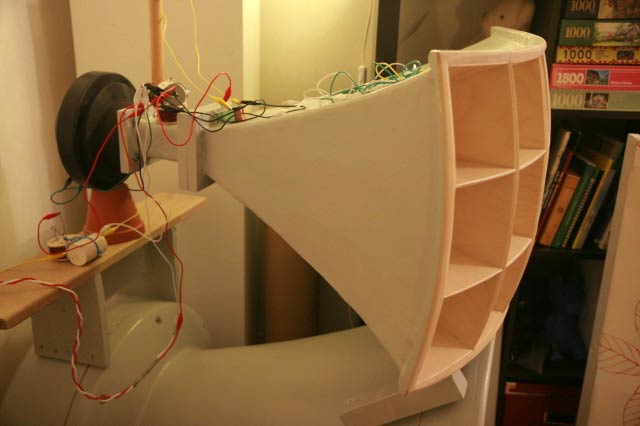

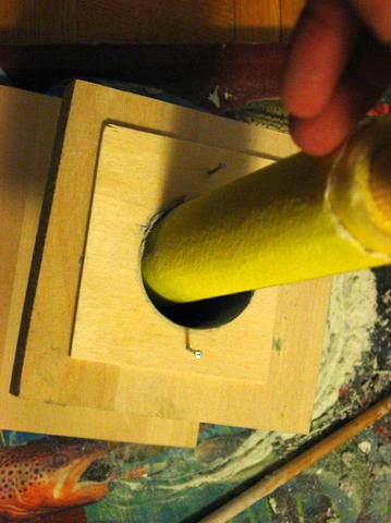

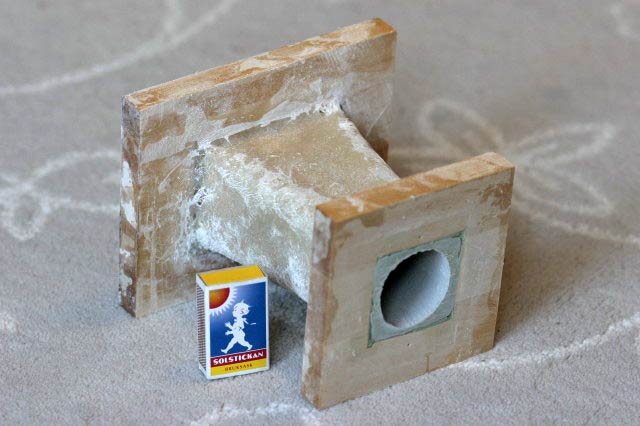

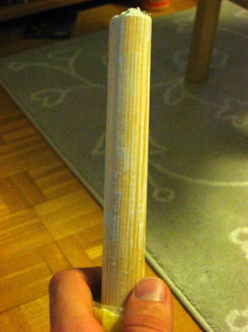

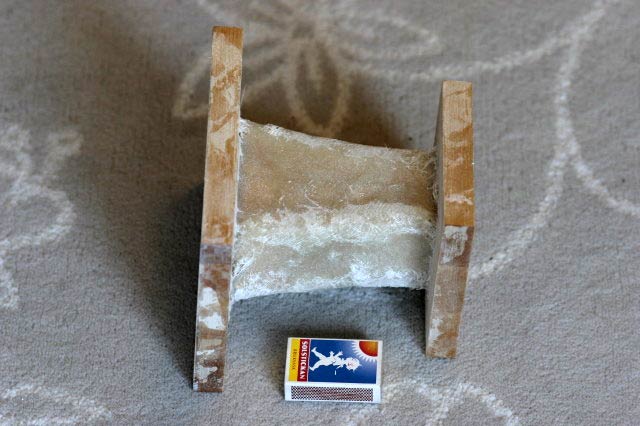

Construction of adapter

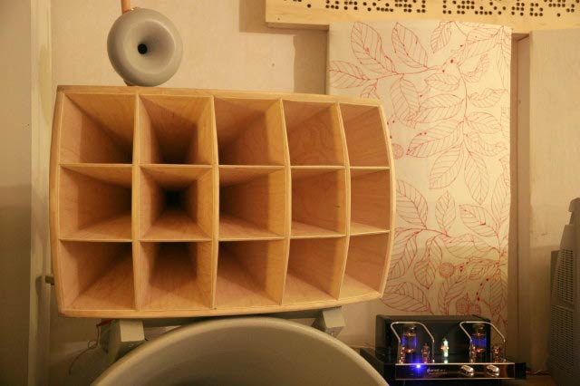

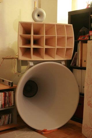

Finish!
Sorry for the filter, the layout is just preliminary and will be changed.
The crossover at 500 (12 db electrical) and 3000 Hz (6 dB electrical)
Sounds like heaven😀
If you have any questions/comments please post them and I'll try to answer.
Thanks! / Petter, Sweden
Finish!
Sounds like heaven😀

I was a bit confused on the throat adapter's construction. I may just need to look at it more closely.

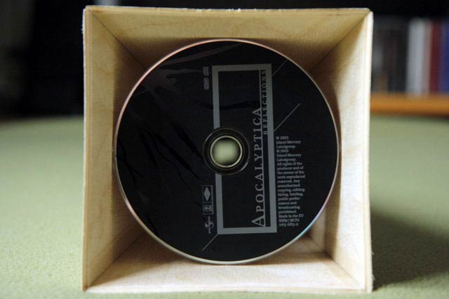

The adapter has the internal throat width and height of 49 mm. I
will upload a schematic of the adapter soon, it will be easier to
understand than me trying to explain.

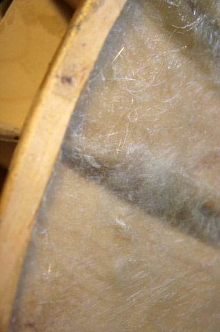

I have no problem with vibrations what so ever in these horns. If
I knock on them they are dead silent. When all the cells were put
together three of four sides were covered vith fiberglass. Then I
poured polyester from above so all the voids between the cells
were filled with polyester. The horns are filled with about 20 kg
of polyester each. With the JBL 2445 they weigh just above 40
kg a piece. You can lift one by your selve but it is not a nice experience.

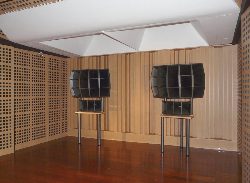

View from a multicell, at a friends house😎

Hello Petter,
Very nice work! Congratulations!
For your eyes only , one of the very first picture of Jean Hiraga's new auditorium with a 15 cells Onken horn.
Best regards from Paris,
Jean-Michel Le Cléac'h

I spent two months, on evnings and weekends building, approx. 200 hours I wouls guess. But it is worth it when it's finish! I like to do carpenting too...

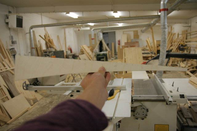

Fine workshop details, very informative

Hi Petter,
Congratulations. It's just breathtaking, I saw the pictures yesterday and is still panting now....
One question: I saw it's a curved 'surface' where the multi-cell joint together near the throat. However the adaptor between horn and driver has 2 flat flanges.
How is the conversion between the curvy side and the flat side?
PS. I saw 2 big BLH behind the couch, is that Jensen's Imperial? You guys do have something!
