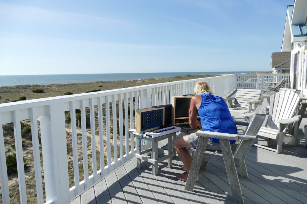

So, I decided to build a portable PC that I could take on the road and use in various places. It was too big to use in a moving car, but it saw use in hotel rooms, various remote locations and even sitting on the beach in Florida several times. It had a 20 inch screen, 4 TB of hard drive space, and a Core i7-7700T chip with enough power for any task, and except for video performance it was the fastest computer I owned. There were several vacation trips where I used this PC, some DAW software, and a DIY music synthesizer I built for some beach side jam sessions.
Last April it went to the outer banks of North Carolina, in July it was on the beach in Florida, powered up to copy stuff once I returned, then stored. In August I took it off the shelf for a road trip, plugged it in and it was DEAD. No boot, no nothing.......
Autopsy revealed a dead CPU chip. In all the years of abusing Intel chips I never had one die. I had a 16 MHz 80386 running at 40 MHz without a heat sink for over two years. The white paint on the chip had peeled. This one ran at the stock clock speed. It was originally a retail boxed Intel CPU with a three year warranty, so I filled out the online service request. About a week of questions and experiments went back and forth, then they asked for the chip, and sent me a new one within a few days.
I had missed my vacation trip, had to take the crappy Asus, as the "box PC" as I called it was disassembled. OK, now's the chance.......I could replace the CPU chip, or remake it into something better.......Is this a DIY forum? OK, it's agreed that it's time to DIY a new PC.

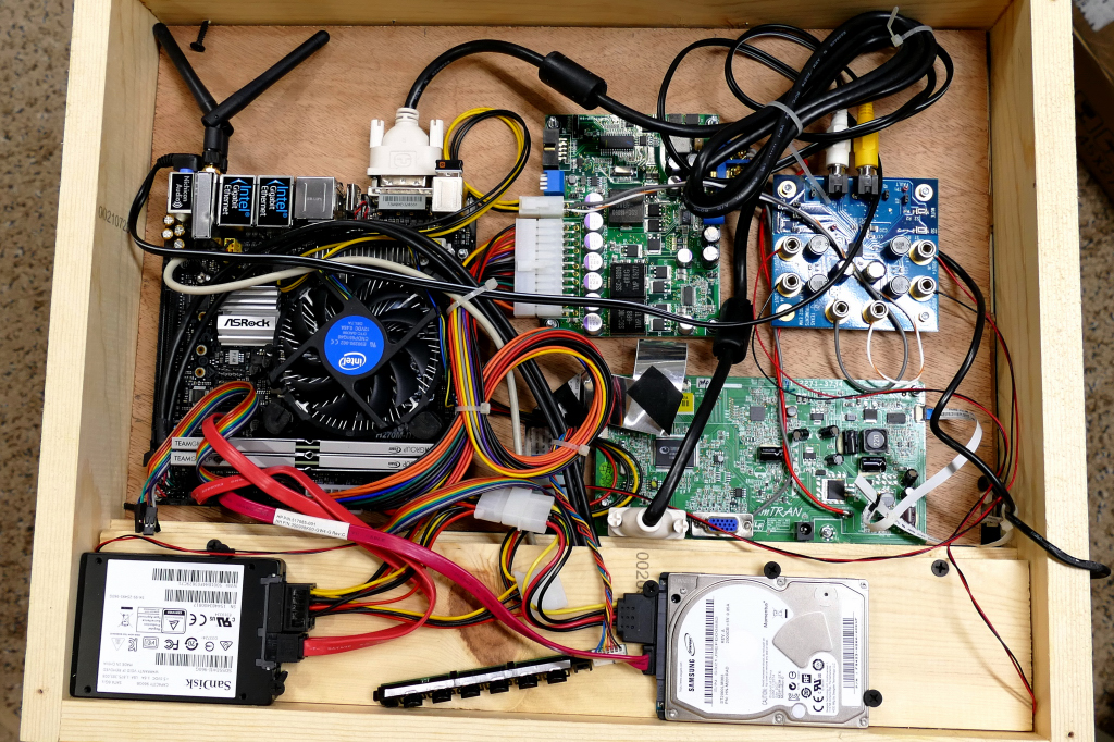

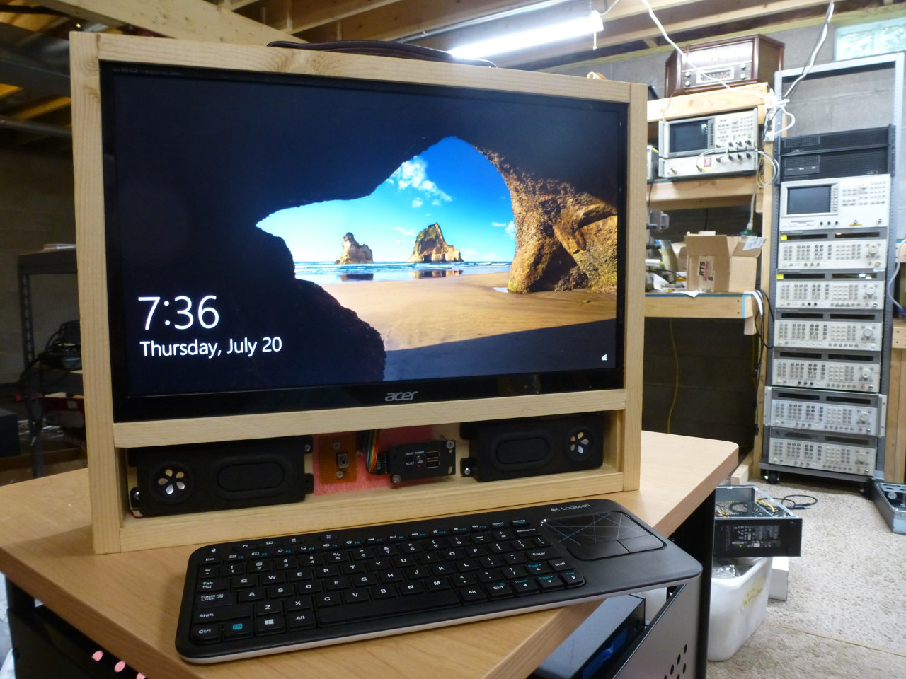

Long before the "box PC" died, I had been thinking of rebuilding it. I really wanted something that I could use in the passenger seat of a car, but we don't travel like we used to, so this wasn't the big factor that it used to be.
I have made non traditional PC's before, dating back to the old 8088 XT mother boards. The cases have all been modified briefcases, hard plastic waterproof transport cases meant for field equipment like guns and cameras, or DIY wood construction.
Most used displays salvaged from traditional sources, gutted CRT monitors in the old days, or modern flat screens with the plastic removed. As you can see, the box PC used a 20 inch ACER screen with the rear plastic removed.
Some of my "portable PC's" have deviated from the traditional laptop form factor with my "box PC" being a simple wood box with speakers and a display on one side. The keyboard is a detached wireless Logitech. I made it in a weekend, and it shows, but it lived for almost two years.
I brought up the idea in the "And what did we buy today?" thread back in March, posts #1120, 1122, 1124, 1127 and 1133. At the time the concept was still in flux, and not much had been decided. As time permitted some experiments occurred, and some parts were purchased. The death of the box PC put the project on the front burner, and some serious progress has been made. Now much more is known, and a lot of it is built. It will be similar to a traditional laptop with a thicker base.

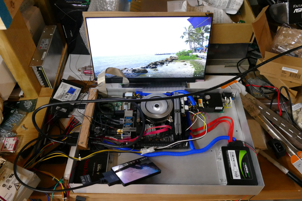

The main interior chassis is 11 X 17.5 inches by about 2.5 inches high, all built from aluminum for strength and shielding. There will be an oak wood outer shell on the final machine. Total weight is about 8 pounds. The CPU is an Intel Core i7-7700T running at 2.9 Ghz with 16 GB of RAM and 5.5 TERABYTES of disk space, divided between 4TB of spinning Samsungs and 1.5TB of SSD. One of the spinning disks contains my entire music library in WAV format, with room for the stuff I haven't transferred from CD and vinyl yet. The slowish SSD is the boot and program disk, and the fast one is for video editing with Blender and Resolve. There is a 10 WPC class D audio amp with some Tectonic Elements 2 inch drivers that defy their size. No decision on the small subwoofer yet pending more testing. The display is a 15.6 inch 4K LCD, and there is an HDMI jack for a separate second display. The video built in to the CPU has been shown to play a 4K @ 30 Hz video on the internal display and a 4K @ 60 Hz video on a TV set simultaneously, both streamed via Ethernet, or from the fast SSD.
there is now enough hardware mounted in the chassis for testing my DIY "laptop." The battery pack, charger, and part of the power supply are not installed, as the power supply is not completely built, and some of it only exists in LT Spice at this time. The only things salvaged from the box PC were the motherboard, memory, and hard drives. A second spinning Samsung was added. Two nights ago I powered it up on an external power supply.
It is seen here copying data from one USB 3 connected SSD to another USB 3 connected SSD, playing a 4K video from the Sandisk internal SSD on the internal screen (unmounted at this time), and streaming another 4K video from YouTube over WiFi to a 4K TV set connected via the side mounted HDMI port, with the YouTube audio playing through external speakers through the internal class D amp......all at the same time without stuttering or glitching in either video. The system is currently running from an external 12 volt source (11.77 volts) and consuming 2.92 Amps (34.4 watts) while doing all of the above.
Today's project was to start cutting wood for the outer shell, but the rain came early and I discovered that my collection of 1/2 inch oak was actually three different thickness, .40, .44 ,and .51 inches thick. My next opportunity for some table saw time might be Saturday.
The progress will be posted here.

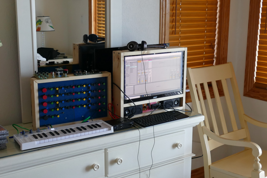

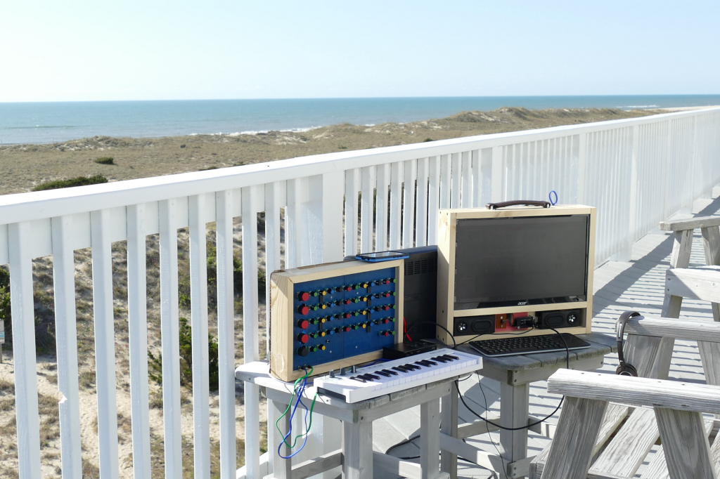

George, the only installation components missing in your second photo ( post 62) are the chewing gum and baling wire.
You forgot the duck tape, but there might be some in there somewhere....I don't remember.
I rushed that one to take it with me on a trip, thinking I would go back and re-do it better later. Two years on it sits gutted.......and I'm wondering if I should take the parts left over from this and rebuild it again. I have another motherboard that's the same size, but older and less powerful.......

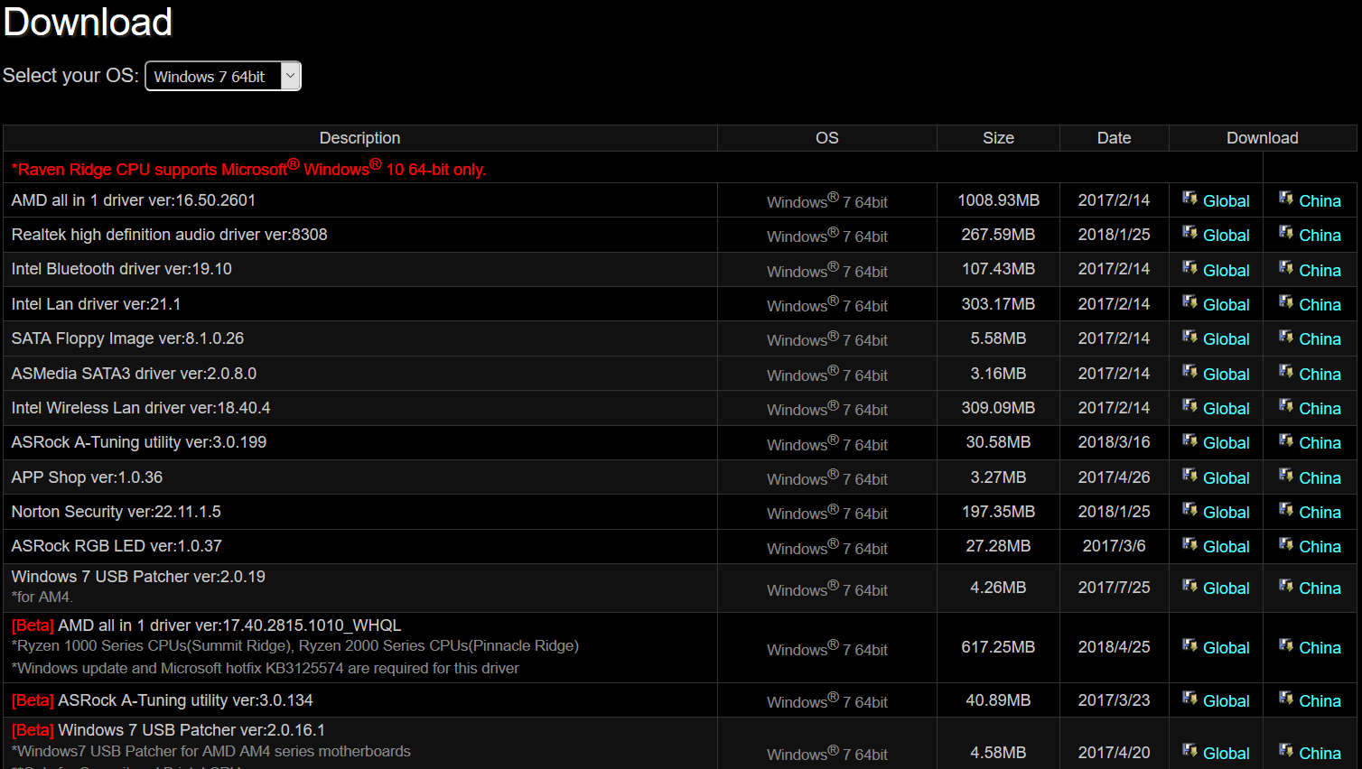

As for Windows 7 running on a Ryzen Zen and Zen+ system. it SHOULD work, I haven't tried it personally myself but I'll give it a go on my AMD Ryzen 7 2700 Zen+ CPU and Asrock X370 Taichi mobo, but you will need a PS2 keyboard and mouse to do the installation, either that or install Windows 7 to the NVME or SSD drive on another system first, or use a utility to make your own custom iso:
Zen+ - Microarchitectures - AMD - WikiChip
How To Get Ryzen Working on Windows 7 x64
The problem with AMD platform at least is just USB drivers. My mobo is the Asrock X370 Taichi and as you can see below drivers are available.
