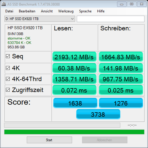

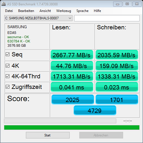

As ssd
As ssd beanchmark is one of the most brutal ssd and hdd(if you have the patience) test.
The first one is Hp ex920 1tb PCIe 3.1 X4 Nvme , second is SAMSUNG MZQLB3T8HALS 3.84TB PM983 PCI EXPRESS GEN3 X4 NVME 2.5INCH and third is sandisk extreme 480gg Sata.
