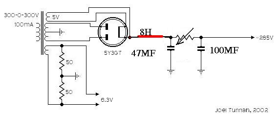

I have plan to built Frank's preampli. I have a question is How to built PSU. And already one tube 5Y3 and a choke 8H/113ma. I can make transformer. Could you help me some suggest for this.

I believe there is a thread of Franks 6SN7 line stage and on it you will find the power supply along with the rest of the schematic.
is it possible to use two triode systems in parallel mode without separate resp. additional cathode resistors ?I've been asked to show the power supply I'm using with my preamp design posted in the "tube preamp" discussion - so here is the circuit first:
