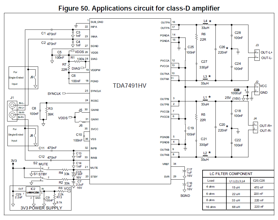

I have built a TDA7491HV amp. I have attached a section from the application note as reference. The LC values I have used (for 4ohm speakers) is 15uH/470nF. Not knowing any better I have use a Coilcraft MSS7331-153MLB inductor (Farnell Ord Code 2526866). This is running at over 60C! Cheepie eBay samples using this same circuit run "cold" So I guess I'm doing something wrong.
I note one comment in the above thread: "That there are specifically designed inductors for Class D use" Should I be looking for one of these? Or am I on the wrong track?
Any advice will be most welcome.
Regards, Martin
PS Although ordered as 15uH, my inductors are marked "153". Can this be right? Should it not be "150"?
