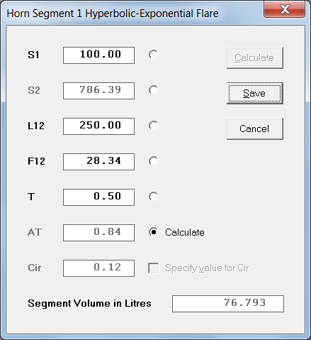

Hi just a guy,

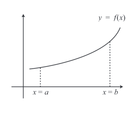

When using integral calculus to find the volume it is necessary to specify the limits of integration. In Attachment 1 the lower limit is set at x = a and the upper limit is at x = b.
Hornresp uses x = 0 (the horn throat) as the lower limit and x = L12 as the upper limit.

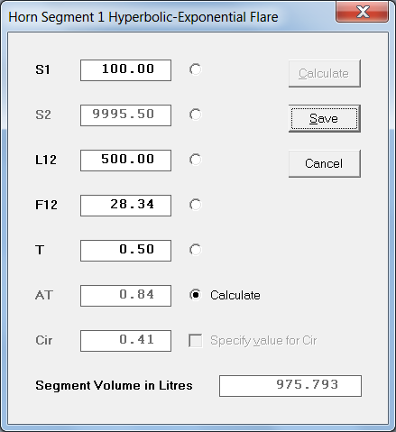

If we assume that the complete horn is specified by the following input parameter values:
S1 = 100
L12 = 500
F12 = 28.34
T = 0.5
Then:
The Hornresp Horn Segment Wizard calculates the volume from x = 0 to x = 250 as 76.793 litres. See Attachment 2.
The Hornresp Horn Segment Wizard calculates the volume from x = 0 to x = 500 as 975.793 litres. See Attachment 3.
The volume of the first half of the horn is therefore 76.793 litres and the volume of the second half is 975.793 litres minus 76.793 litres or 899 litres.
Therefore:
Segment 1 = 76.793 litres
Segment 2 = 899.000 litres
Total horn = 975.793 litres
Note that the value of T does not change.
Kind regards,
David
Therefore:
Kind regards,
David

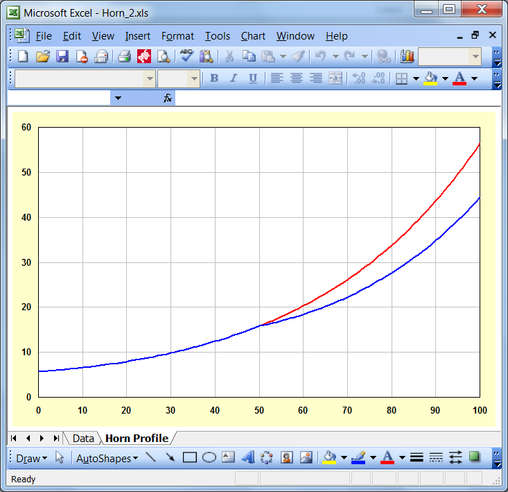

it says the second segment is a 0.5 T flare with 250 cm length and the same throat area as the previous segment mouth area but the volume is quite a bit less than 899 liters. Any idea what's going on here? Hornresp does the same thing if you specify the second part of the flare independently.
See attachment 1. I have used different dimensions to yours to show the difference in profiles more clearly, but the overall effect is the same. The red line shows the complete horn and the blue line shows the profiles when the two segments are specified independently using S1, S2, L12 and T. As you can see, the first segment has the same flare rate as the complete horn, but the second segment is different.
If you specify the throat as 786.56 and the length as 250 and T=0.5 and let Hornresp calculate AT, it comes up with a mouth size of 6185.44, not 10000 or anywhere near 10000 so I don't understand what's going on.
See attachment 2. In this case the segments have been specified using S1, L12, F12 and T.
But if I understand your proposed method, if Hornresp calculates the first flare correctly, all I need to do is calculate the volume of the flare from the throat each time, and do that 6 times with progressively longer flares, and then the volume of each segment would be (starting with the full unsplit flare volume) the current segment volume minus the last segment volume, and so on for each flare.
You've got it!
Rest assured, the Hornresp results are correct 🙂.

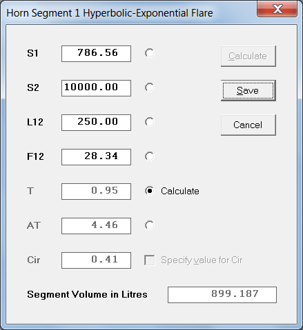

Ok, I figured it out and I was right, at least partially.
The last half of the horn, when viewed alone, is actually not T=0.5.
It's T=0.95.
Take a look at the picture.
At the far right is the second segment calculated independently from the original horn. S1 = 786.56, S2 = 9987.05, F12 is the same as the original horn, and T=0.95. Segment volume is 898.383.
If I could get more accurate (more decimal places for the T) I could get the S2 to 10000 exactly and get the segment volume to 899 liters. Even as it is, it's very close.

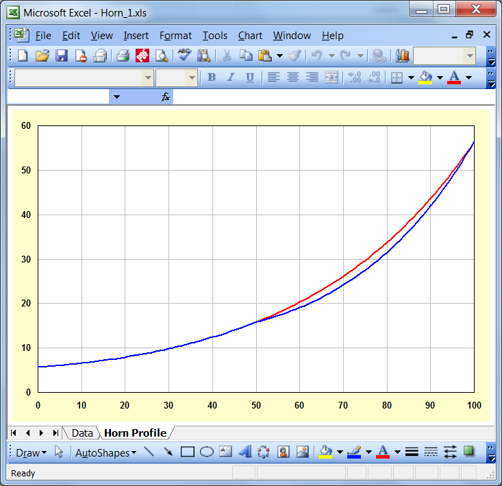

Now look to the left. The far left column is the Horn Export Data for the original flare (I changed mouth area to 9987.05 to match the rounding error) and the right column is the Horn Export Data for the last segment with .95 T.
Note that from the halfway point of the original horn (250 cm length) all the way to the end of the horn the original 0.5 T flare matches the last segment 0.95 T flare cross sectional area matches within 0.5 sq cm (again, the 0.5 sq cm error is a rounding error, I could get it exact if I could specify the flare T to a higher accuracy than 2 decimal places).
Therefore, as I said, two 0.5 T flares placed back to back DO NOT combine to equal a single 0.5 T flare. The second flare has to have a much higher T if you want the two combined flares to equal a single 0.5 T flare.

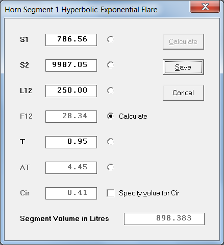

Of course not.
It seems that we may have been talking at cross-purposes initially 🙂.
Given S1, S2, L12 and F12, T is calculated as follows:
T = (Exp(mz) ^ 2 + B1 * Exp(mz) + 1) / (1 - Exp(mz) ^ 2)
Where:
B1 = -Sqrt(4 * S2 / S1)
m = 2 * Pi * F12 / 34400
mz = m * L12
If:
S1 = 786.56
S2 = 9987.05
L12 = 250.00
F12 = 28.34
Then:
T = 0.94999964 to 8 decimal places.
