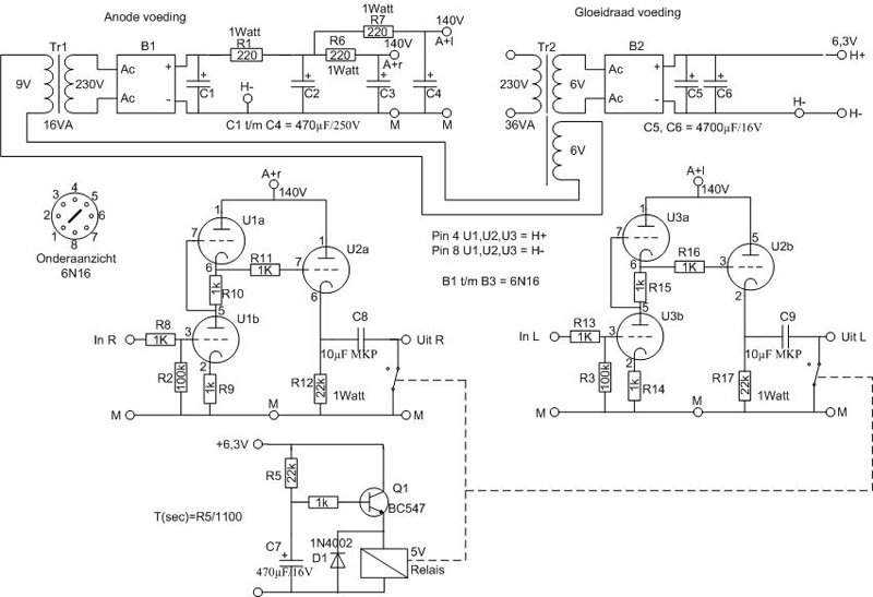

6N16B is a lovely, very linear tube. I'm not a fan of SRPP but I bet it will do very nice in this design with a direct coupled cathode follower.
