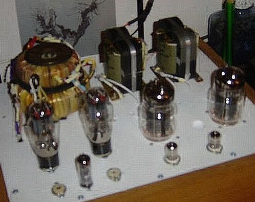

Hi, I have no experience with winding my own OPTs. Maybe when I will get some good core and bobbin.Hi Michal.
Two questions for you:
- Do you have any experience with DIY handwinding transformers?
- do you have good nerves?
I was DIYed myself OPTs for my "second" SET with 6C33C.
C cores, G10 (PCB material) bobin, insulation is a modern paper/mylar and teflon from russian teflon capacitors and Sowter principle of winding with 4 secondarys.
Very old and bad pic, sorry.
But I have no idea how to calculate good OPT. I can only calculate the transformation ratio 😀
by the way great work, how does it sound?
Sounds great. That's SET at my weekend home. I have a 300B SET in the apartment.
My cores are old double-C cores with 0.1mm lammination from Vacuumschmeltze.
I made bobbin myself from PCB material (w/o copper foil, of course)
I used this calculate for OPTs:

Whilst I fully appreciate the desire and interest in winding your own OPT, I make one suggestion:
Using 6C33C, the winding doesnt have to be very good to perform OK. Hey, you could probably use a power transformer, given the low Ra of such a valve. It's a lot easier to wind an OPT when the turns ratio N is small.
Different story using EL84 triode strapped
Doesn't really after a certain, let's say, 5:1 ratio. 🙂
After this, the secondary layers can be considered as almost ground potential. So care in reducing P to S capacitance comes mostly from the potential gradients of the primary layers. The anode is the hottest, because it swings voltage. The layers starting from the anode should be far from from the secondary layers.

You want single ended sound, but better bass. You have a set of push pull transformers that have good bass response. You have single ended transformers that are lacking in bass.
You like the mids and highs of your single ended amplifier.
Generalizations:
For amplifiers without negative feedback:
Single Ended has dominant 2nd harmonic distortion
Single Ended has relatively non-linear damping of the woofer over the positive and negative excursions.
Push Pull has dominant 3rd harmonic distortion
Push Pull has relatively linear damping of the woofer over the positive and negative excursions.
So try this:
Build a push pull amplifier (*):
Set the phase invertor to have a slightly unbalanced amplitude of the in-phase versus the out-of-phase signals.
Now, you have dominant 2nd harmonic distortion; and you have relatively linear damping of the woofer over the positive and negative excursions.
And you have the better output transformers that are capable of good bass.
One more thing, do you have, or can you borrow, an amplifier that has good bass, and test it on your open baffle speakers?
You will not get better bass with a new amp than you get with that borrowed amplifier.
I have heard some very good bass from some open baffle speakers, but not all open baffle speakers.
But I am betting with the proposed push pull amplifier above (*), you are likely to be very satisfied.
Happy Building and Happy Listening.
