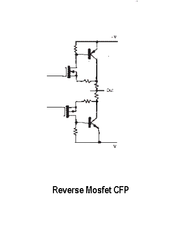

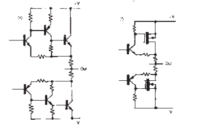

Stee, that output is nothing new, first used in 1966, the triple darlington rotel uses is just as good if not better. Why dont you get a copy of D. Selfs audio book, you can learn a great deal from it.

Stee that type of output is in use by many, have a look at Harmon kardon amps, some even from the late 80s. Like I said it dates from 1966. The BJT mosfet cfp you have there was proposed by JLH as being a superior sounding and dates from 1977.

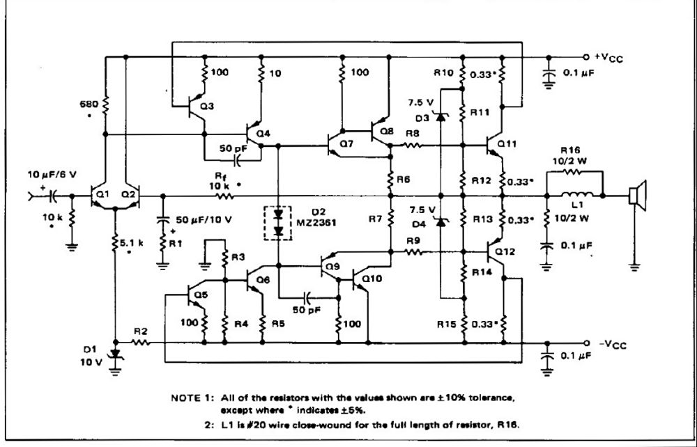

hallo stee.
classic schematic.
do you want to build it? or upgrade it? or anything else?
